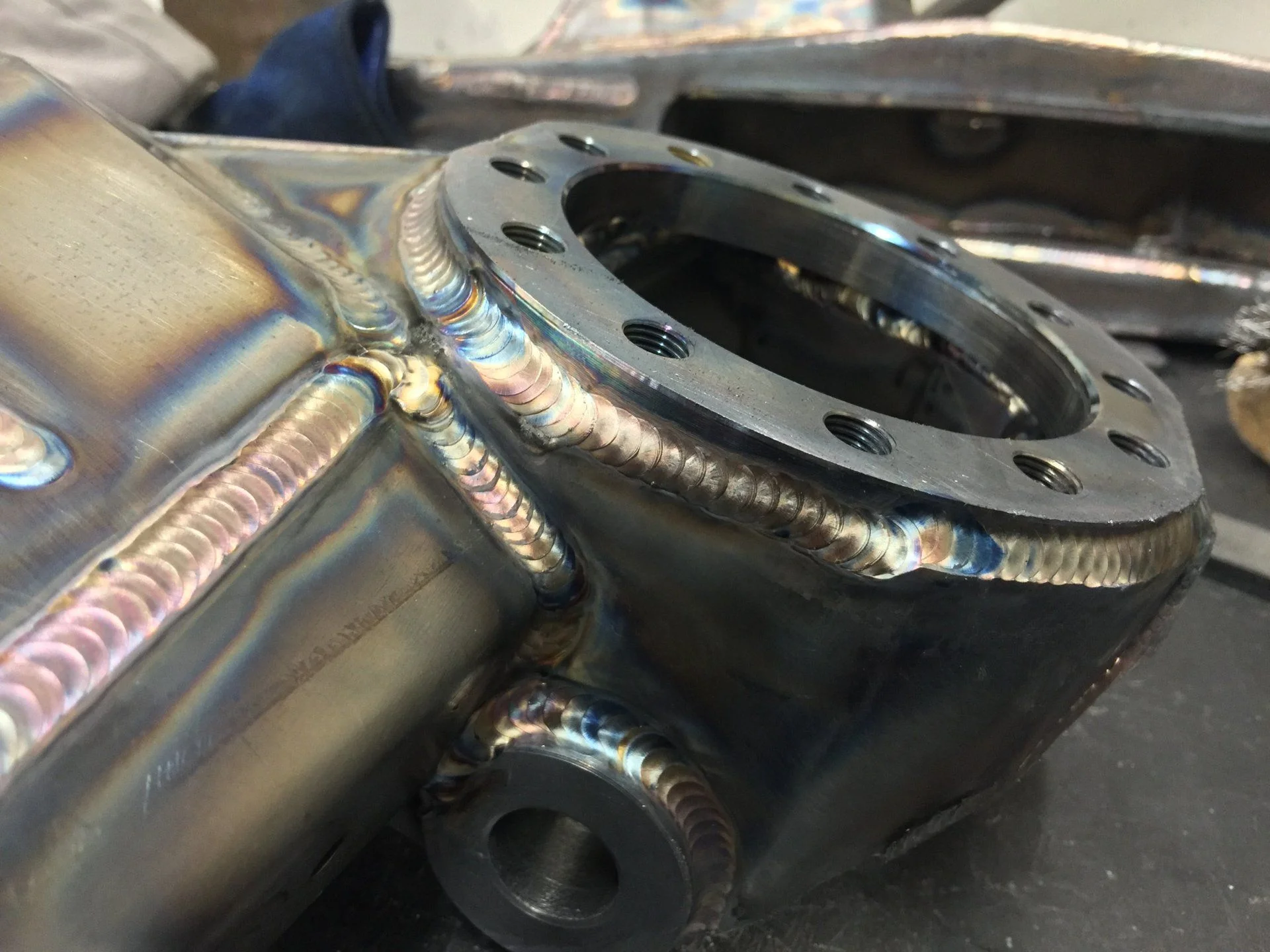

The other thing is to practice. Literally MILES of welding. And a grinder. After a while you can do stuff like this:
