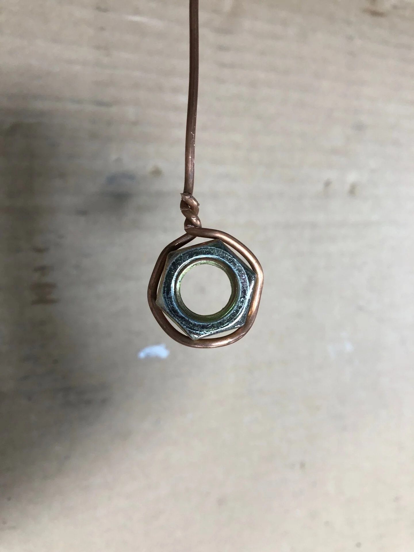

I am trying to weld solid copper wire (electrical ground wire) tied around a 19mm nut. I would like to snake the wire + nut inside an access hole in my frame so I can thread in a bolt from the outside. The problem is I can't seem to get a weld to hold.
Do I need to find steel wire or do you suspect this is just a skill/experience problem?

Correct, I was trying to keep my braid of the wire from unraveling and keep it very tight to withstand the force of the ratchet. My goal was to not damage the nut and keep it strong since it will hold my rear bumper.

Wasn't trying to weld the copper wire to the nut. The goal was to weld the copper wire to itself to prevent it from unraveling. I went to a small hardware store that didn't have the steel fencing wire I was originally looking for. Had I got the steel fence wire or copper welding wire, it should have worked with similar metals even if not the best method. I don't have any problems doing simple things with the flux core welder.
