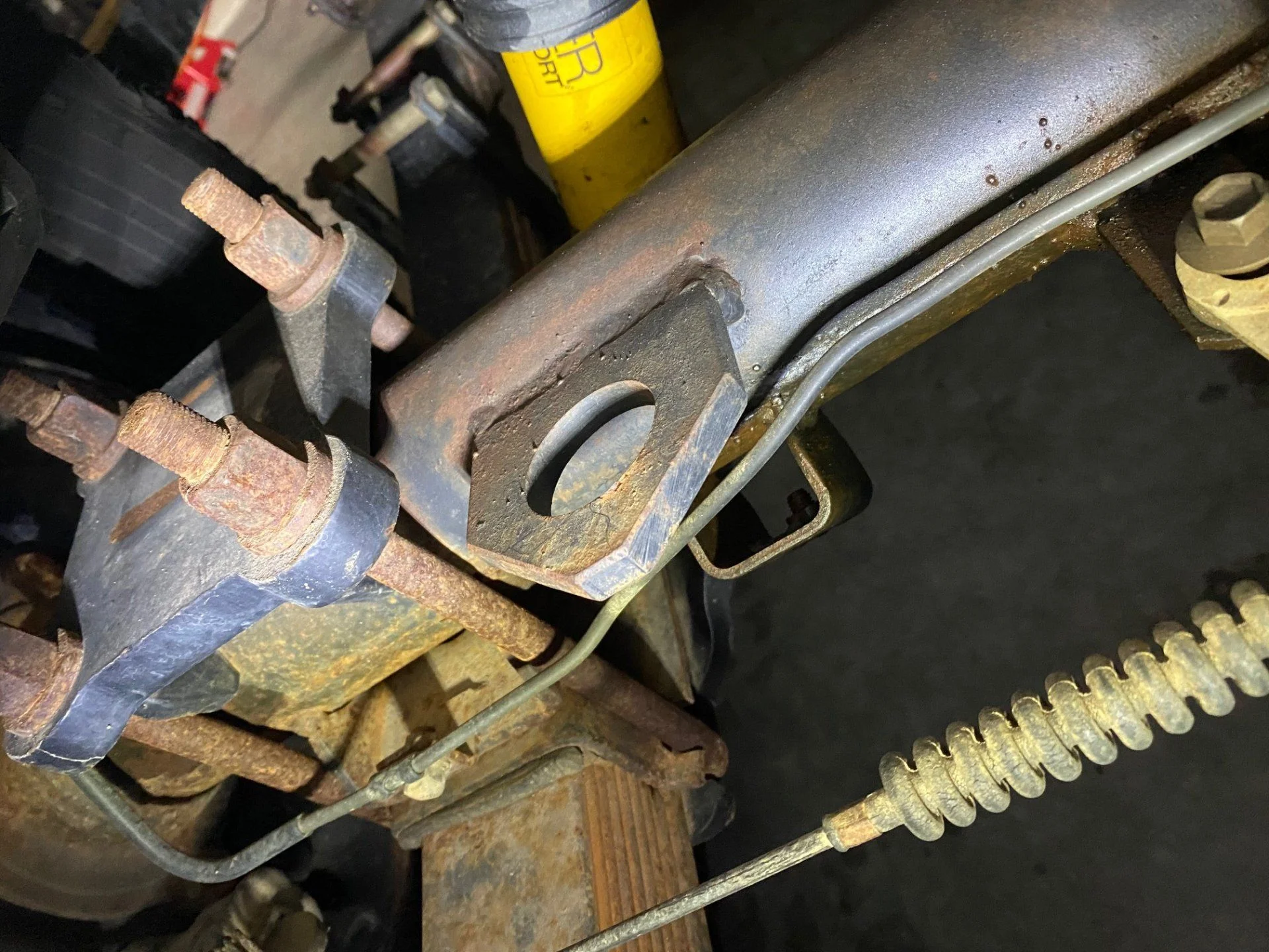

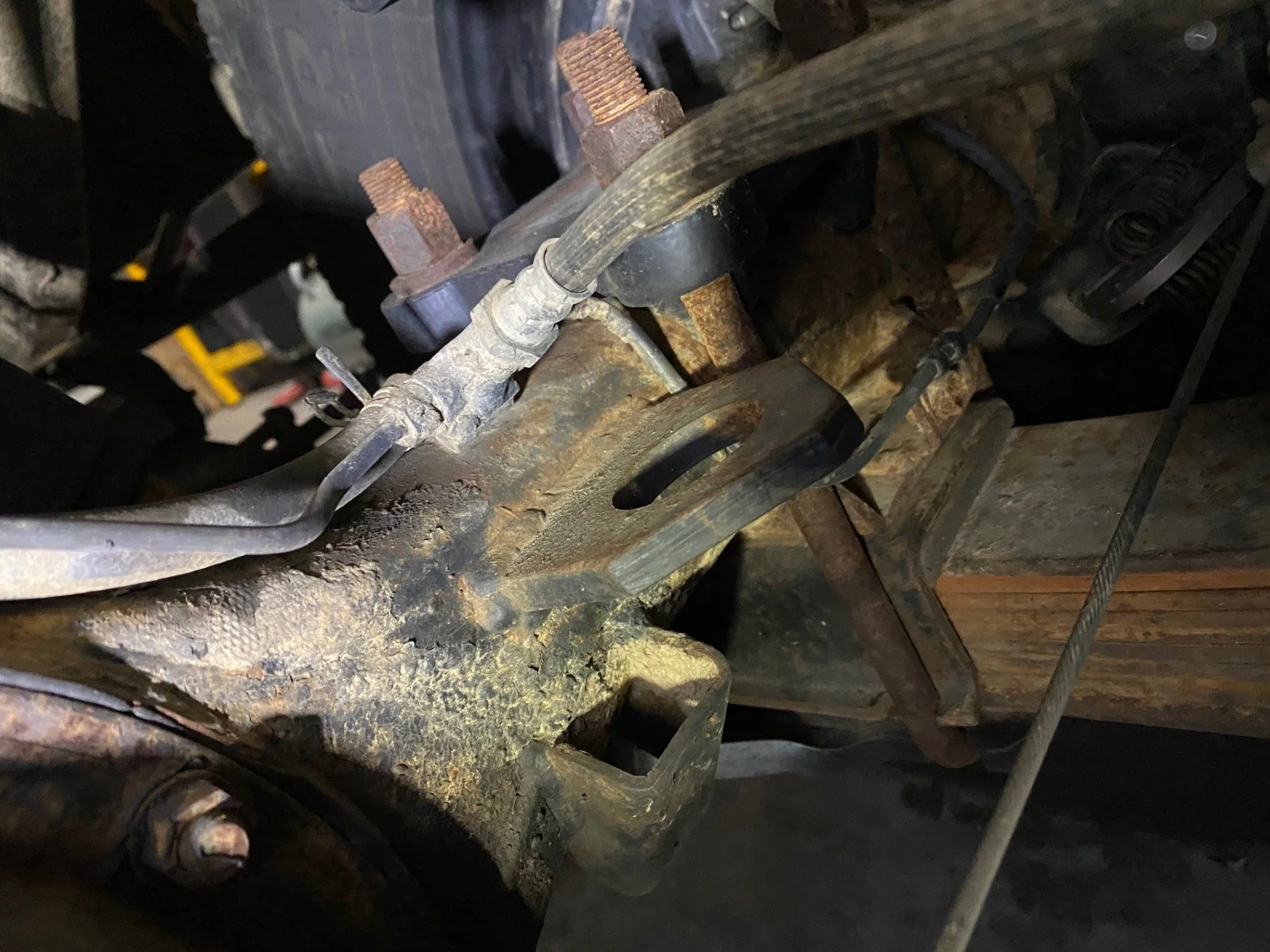

I crawled under the truck and took a few pics, apparently I have a oil leak of some type...likley the rear pinion seal. 1st group of pics

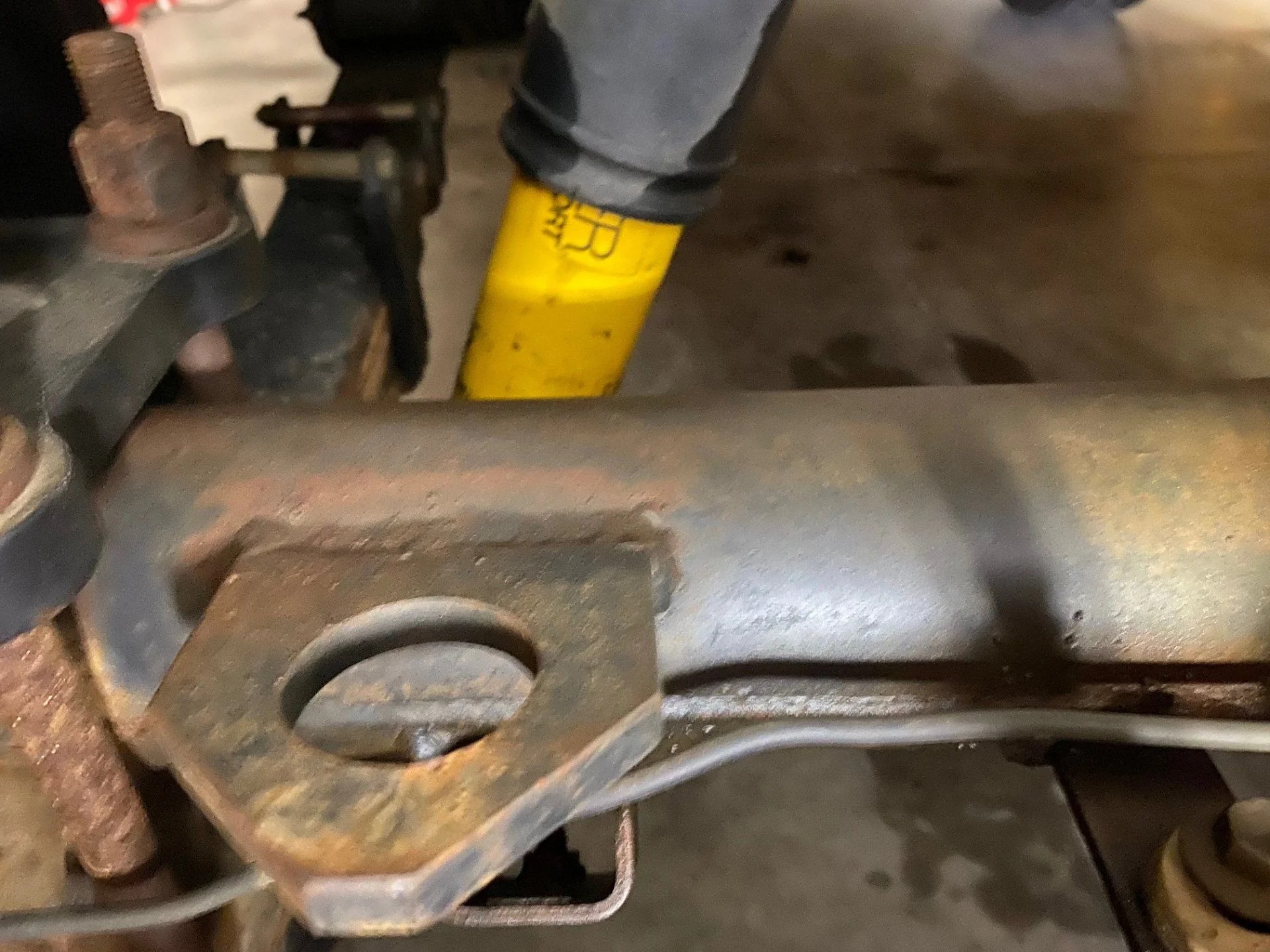

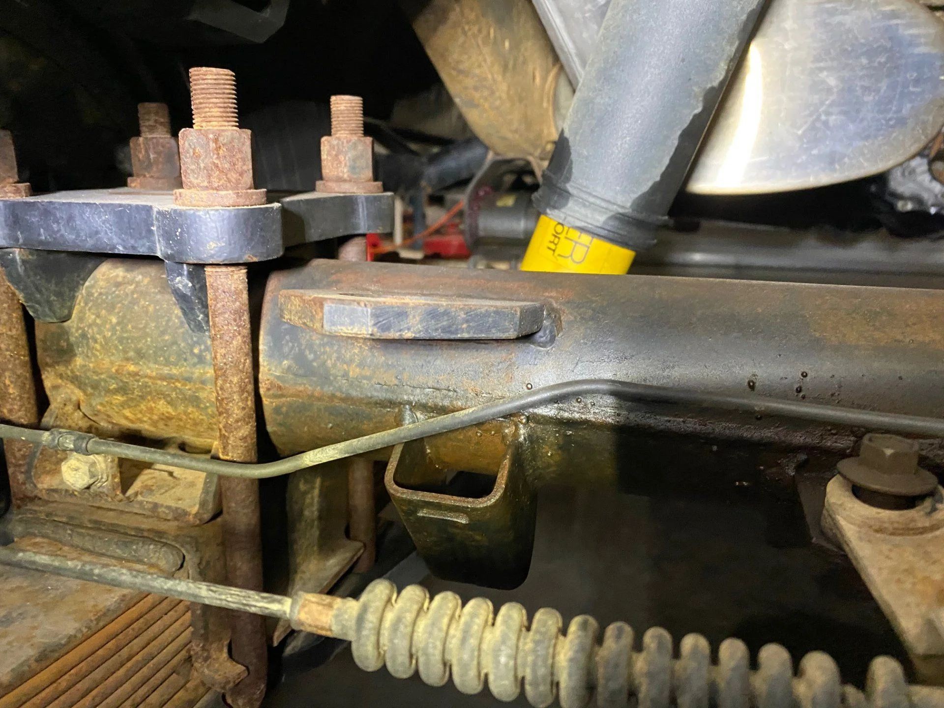

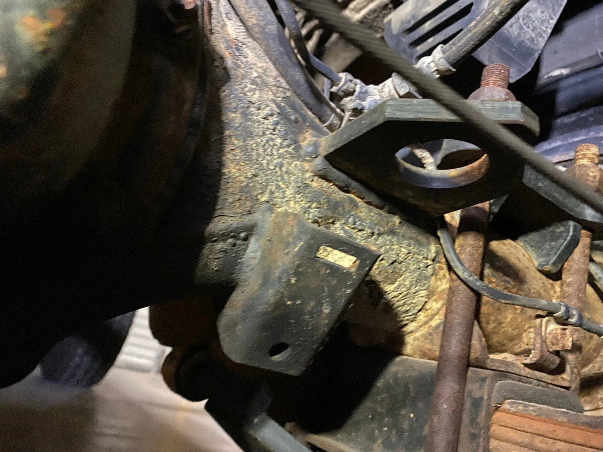

2nd group of pics. these show the pull down points on the rear axle that my friend installed for me.
I use something like these to hold the front axle for the tie down ratchet straps to grab, and then the tabs welded to the rear axle as noted above to tie down with ratchet straps.

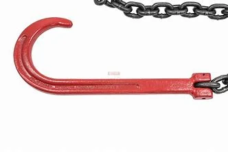

Chains attach nicely to my trailer's side pockets (straps are awkward unless they're running straight across the deck). I used axle straps with chains a few times before I went to these hooks. I found they would abrade, and crawling under a muddy rig to get them in place sucked. The hooks are easy and clean to work with, just reach in around the tire from beside the trailer.
My hooks and binders both display a WLL of 5400lb, 3/8" grade 70 chain has a WLL of 6600lb.
Here's a hook setup with grade 80 chain (7100lb WLL rating tag attached to the chain):

I'm sure you set up works well and most likely well never be a issue. I prefer not to use open ended hooks, I am glad you chains rated. I find that most chains are made in China and I don't trust them. Lastly chains are heavy and make a lot of noise, if I am loading early in the morning I don't want to bother my neighbors.
Ouch $90 each, My hole set up, all fore corners was about $ 120 made in America, Have spring loaded enclosures that are super easy to use.
It also appears the these hook are design for recovery not tie down 🤷‍♂️
