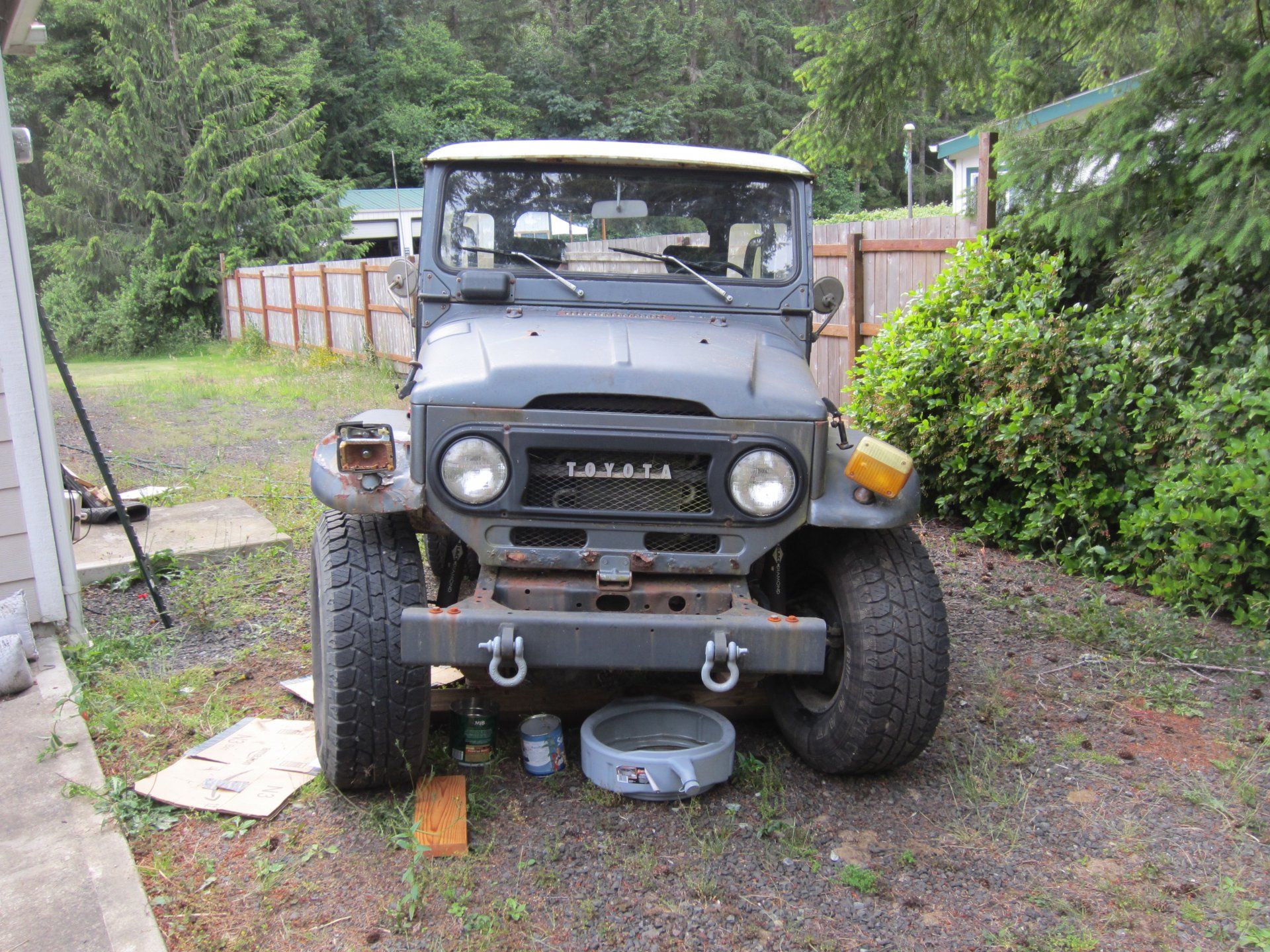

So for the first pictures will be the day i brought it home. I did clean the wind shields up a bit. 4 years of pollen and dirt took a bit of elbow grease but cleaned up nicely!

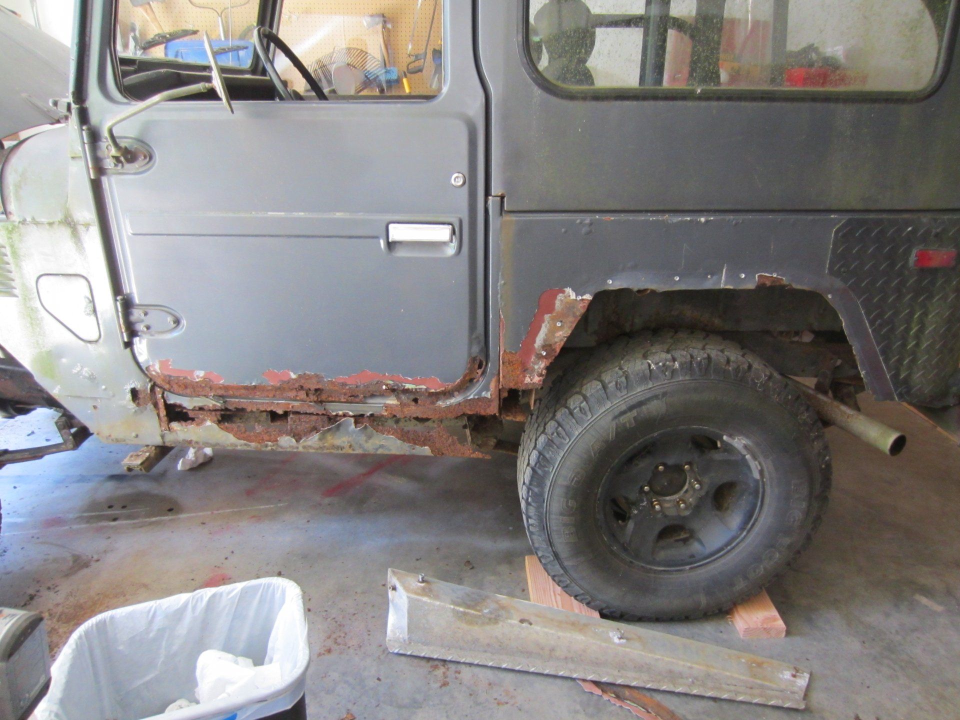

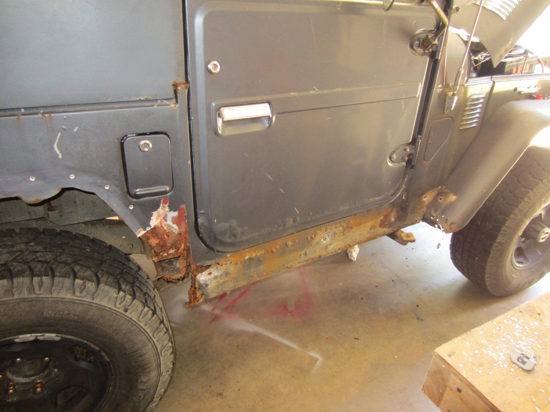

Well during and after the oil change I kept taking things apart. Which was both a high and low emotionally. I discovered A LOT of what the previous owners had done. Which was basically dont fix the rust. Instead use a fiberglass cloth and bondo to make it look good. They also put diamond plating running boards and rear quarter panel protection. Well I removed that and then peeled away the bondo and discovered this......
Drivers Side running board removed....
full
The passenger side wasnt quite as bad

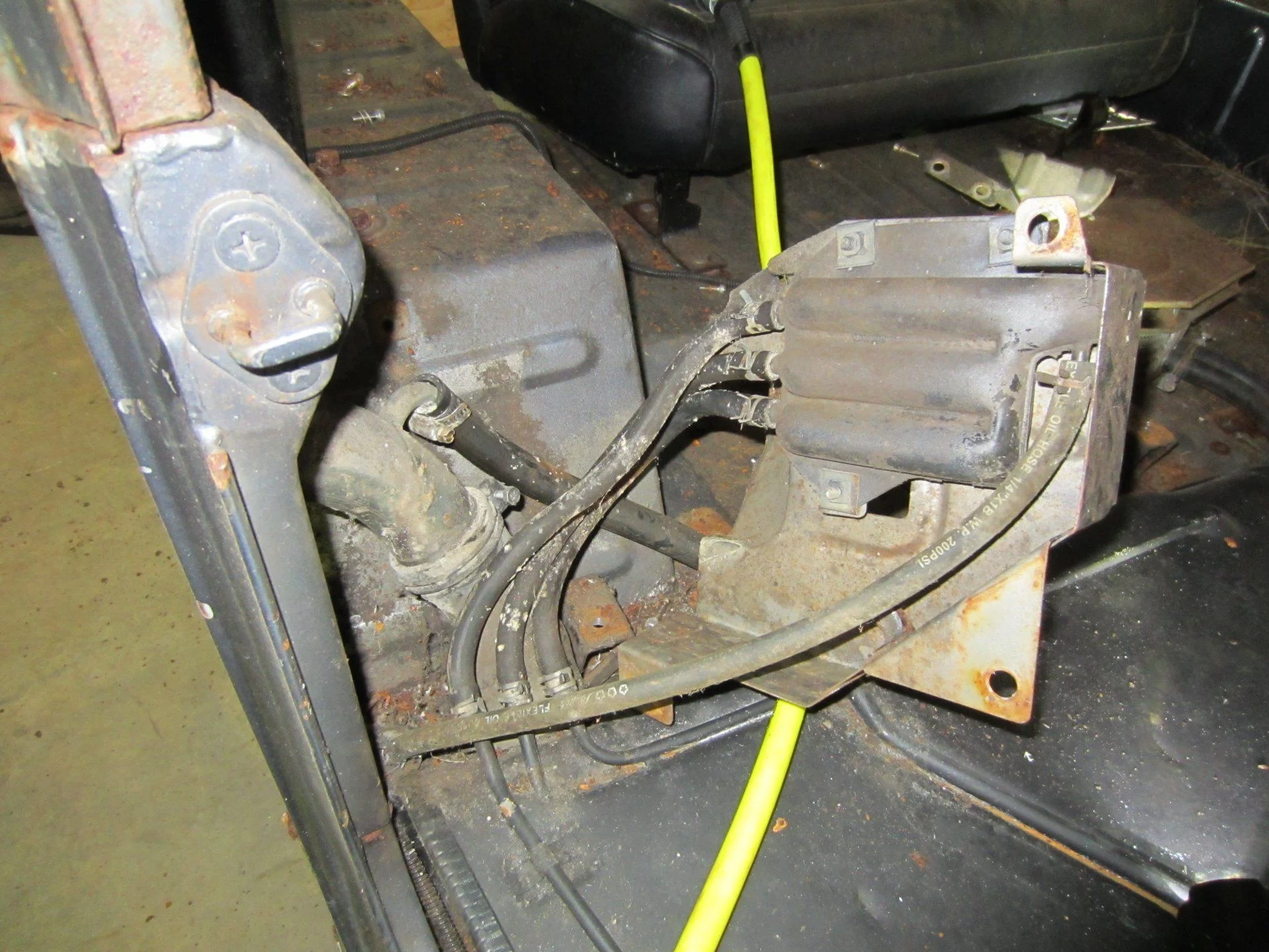

First thing..what exactly is this? A fuel separator/charcoal filter? Is it something that needs to be replaced/checked?

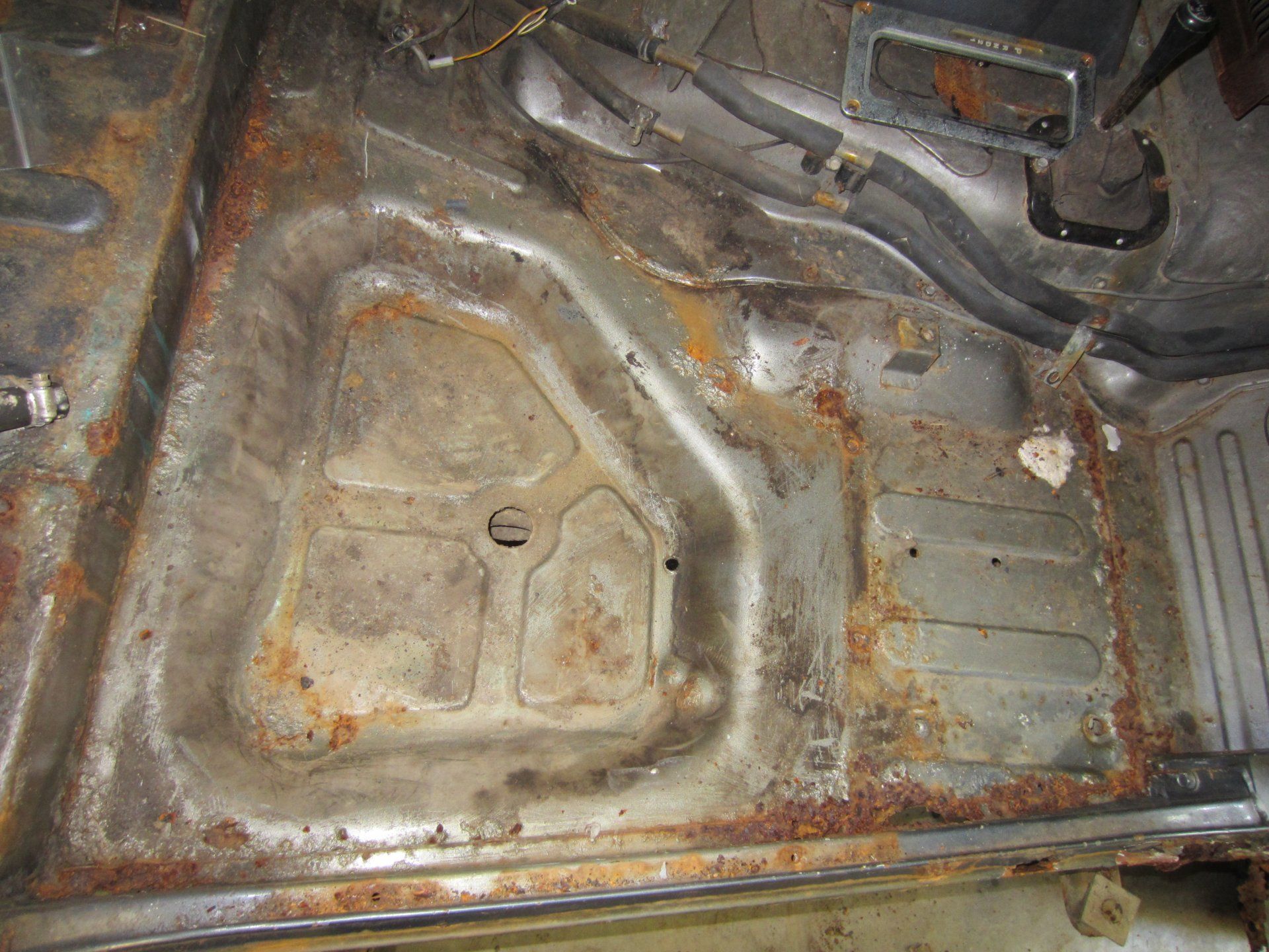

After fuel tank removal and clean up I got a good look at the floor pans. The passengers side isnt to bad. Just a bit of rust through by the rocker panel as far as I can tell. So that is the positive!
full

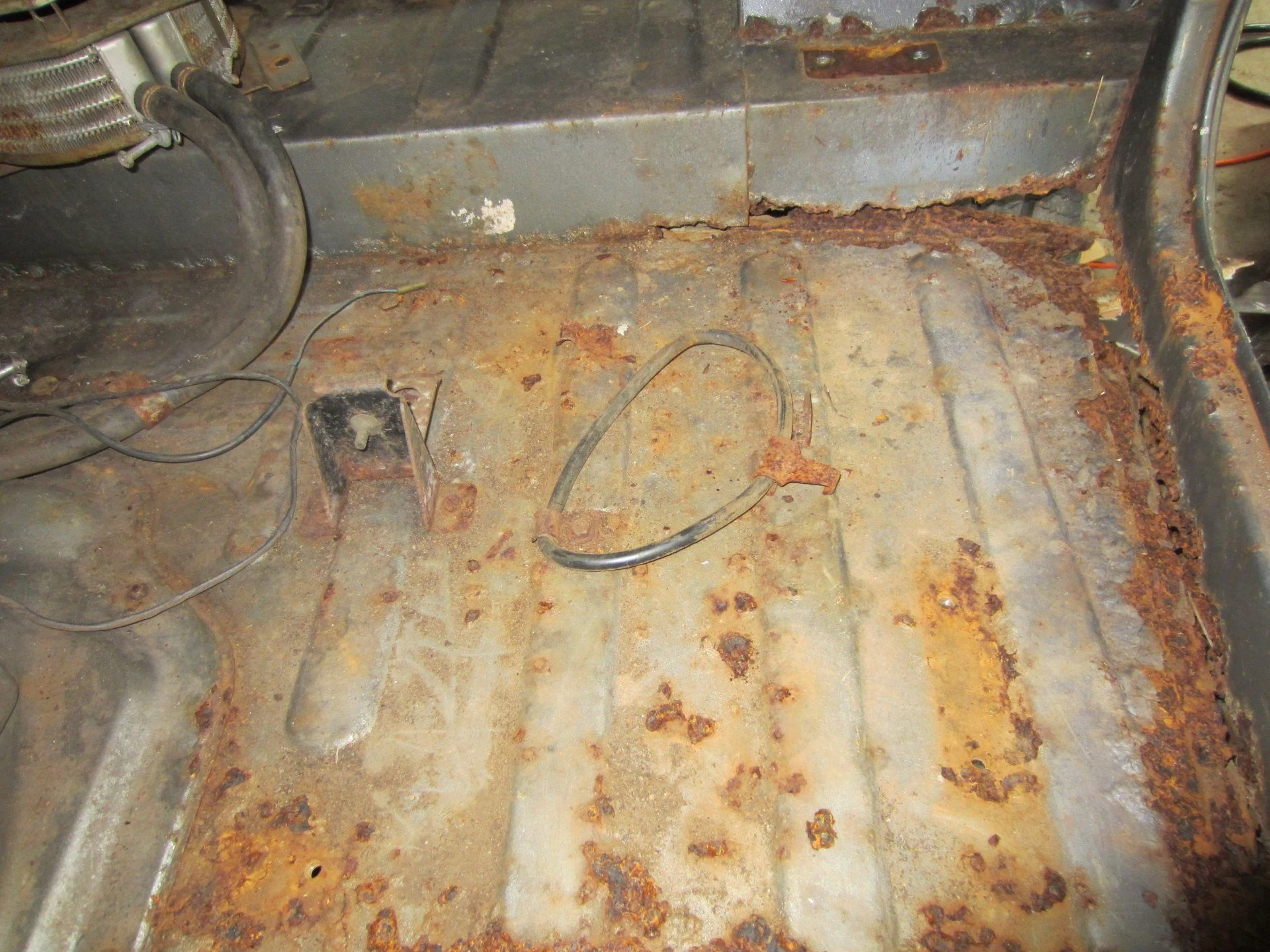

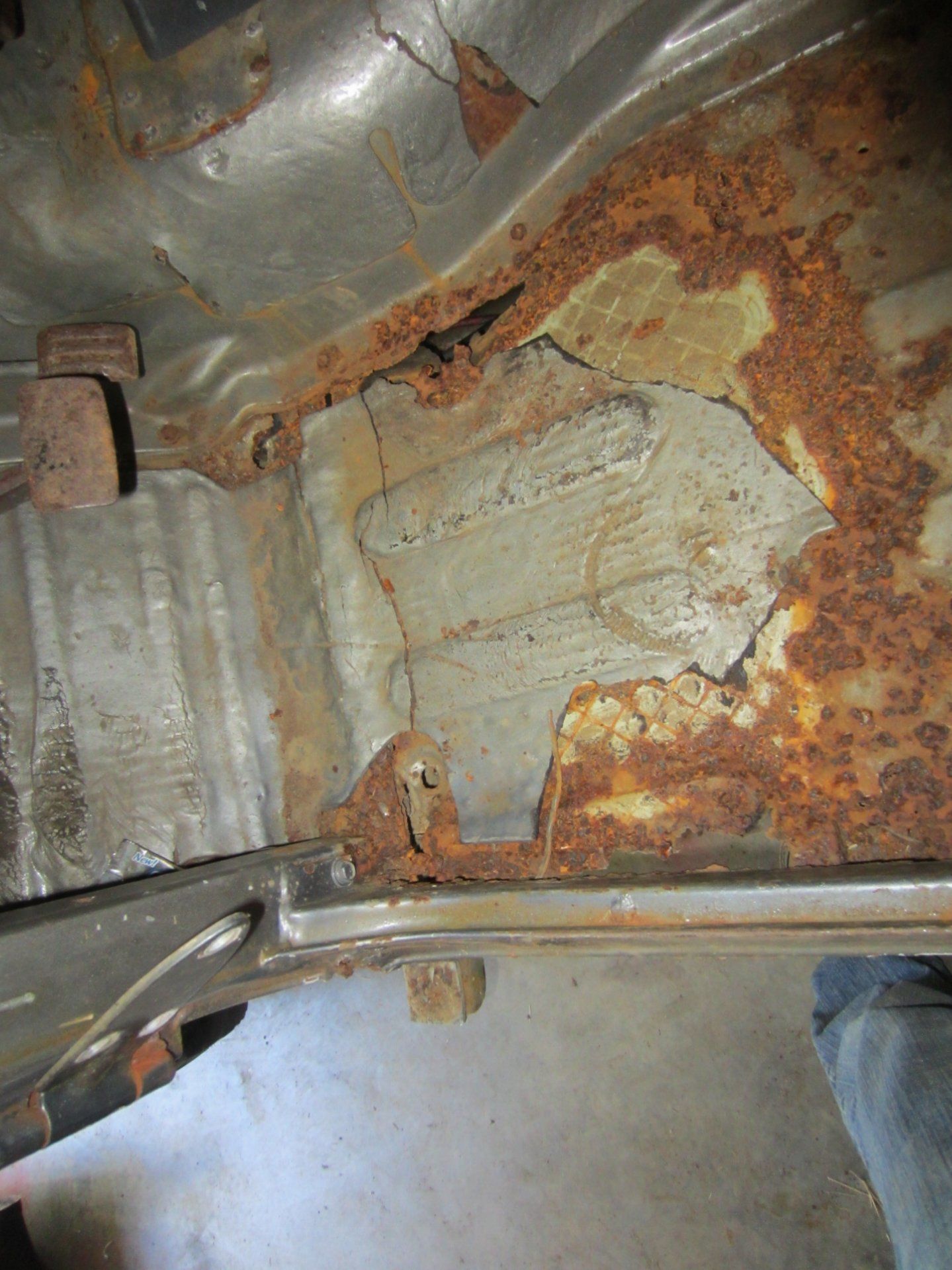

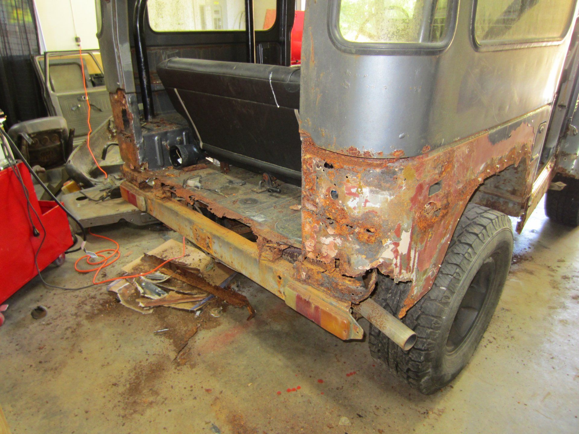

The drivers side is a lot worse then I thought. Its rusted pretty much all along the rocker and then along the rear "wall" portion.
full
full

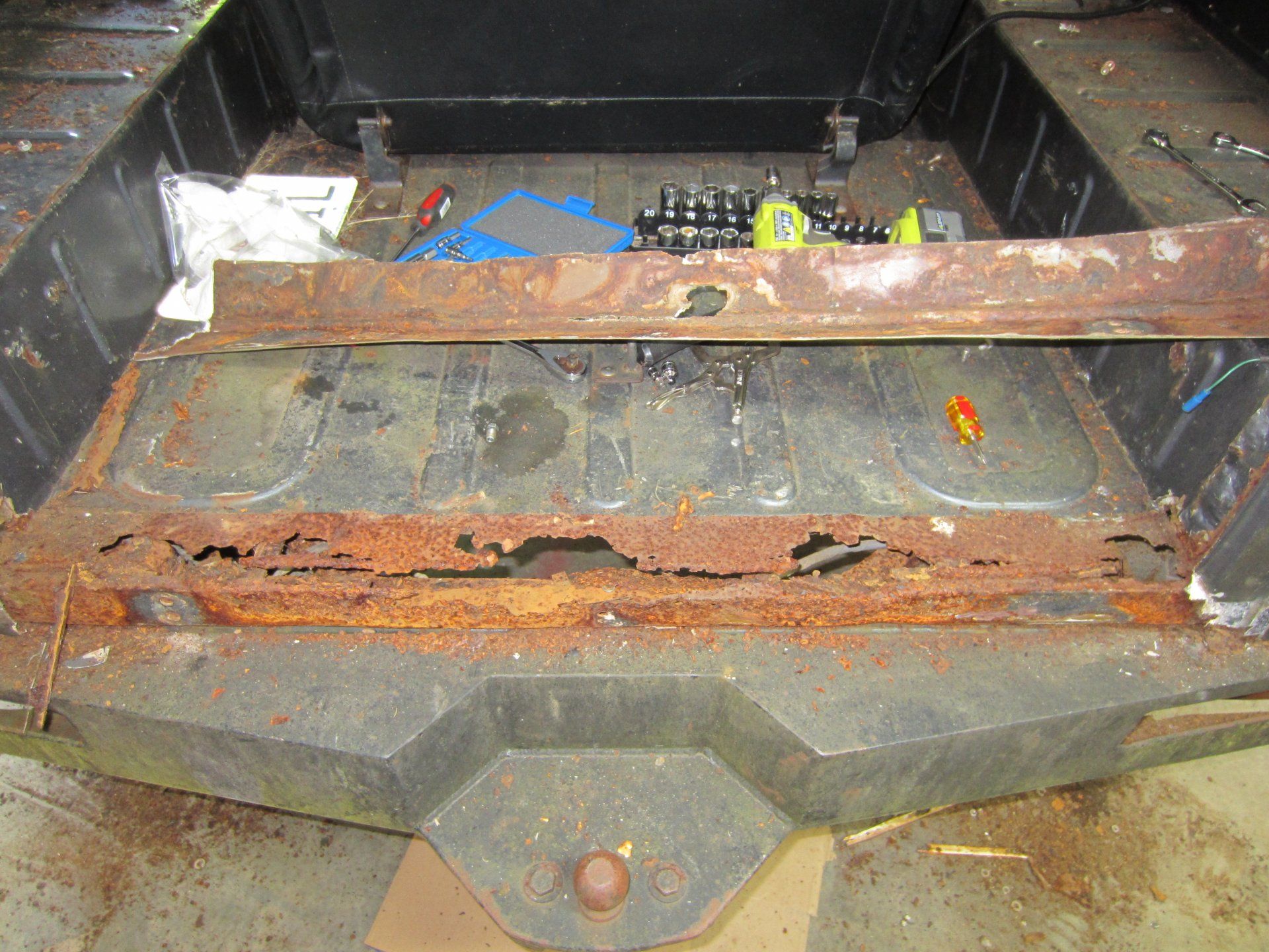

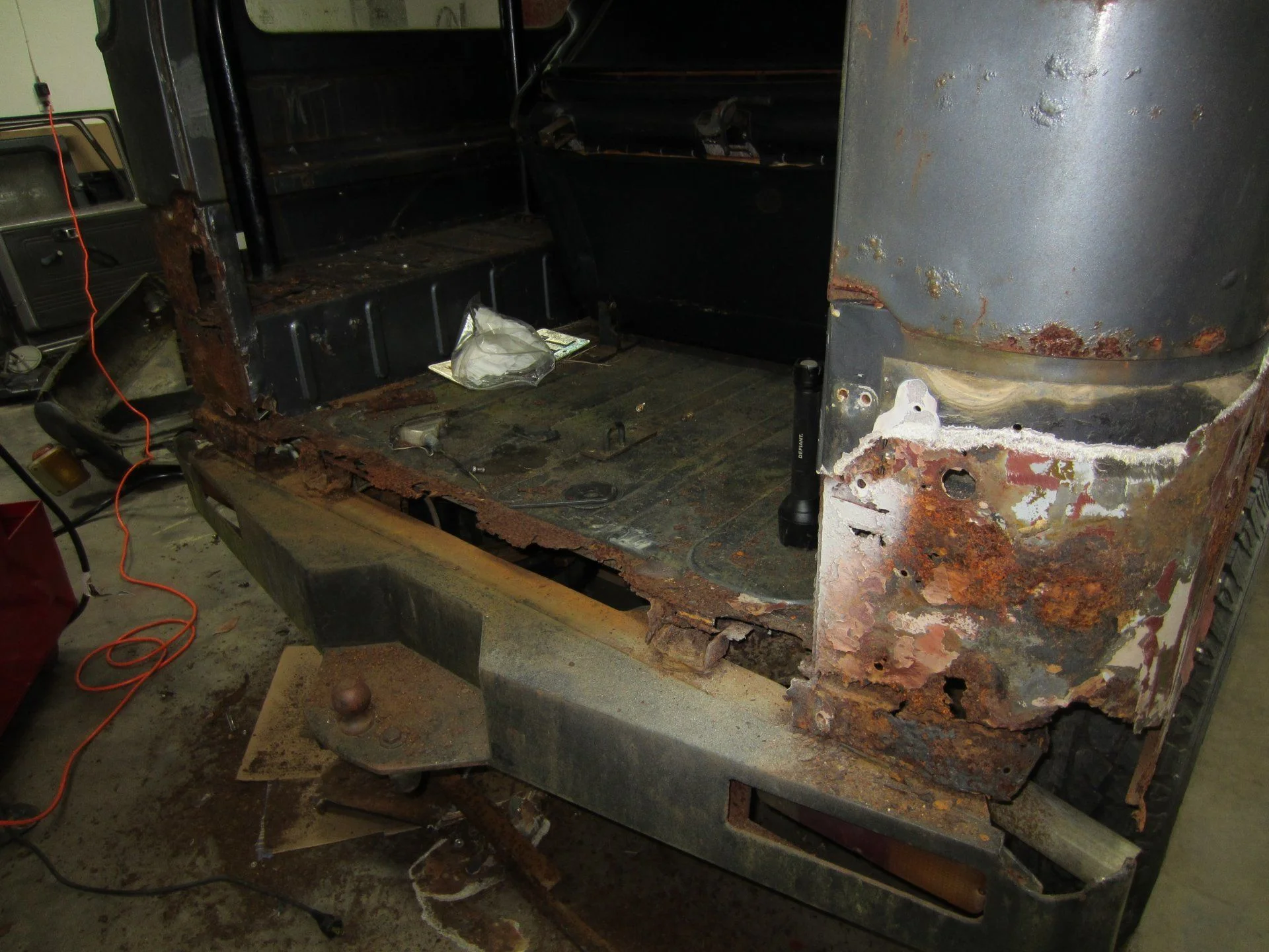

Then the rear had both a positive and negative. I got the aftermarket bumper off. The frame actually looks quite good so Im happy there! The negatives.....the screws holding the lights are striped. And the rust on at least the passenger side quarter panel is worse than i thought. THe rust goes all the way to the lip where the upper parts sit and also around on the "b" pillar as ive heard it called. The wheel wells also have some rust to deal with. They have some spots that i punched a hole right through.

So basically lots more demoralizing things. But thats part of tearing it down I suppose. With so much body work though Im not sure what Ill do. Either find another tub in better shape....or fix it up. For now though....keep taking it apart
I agree with you and would keep an eye out for a donor tub. Will save you a ton of time and $$ in the long run.
Luckily you live in the part of the world where rust free tubs do come up for sale every once in a while.
Keep at it, keep posting, we are counting on you :steer:
