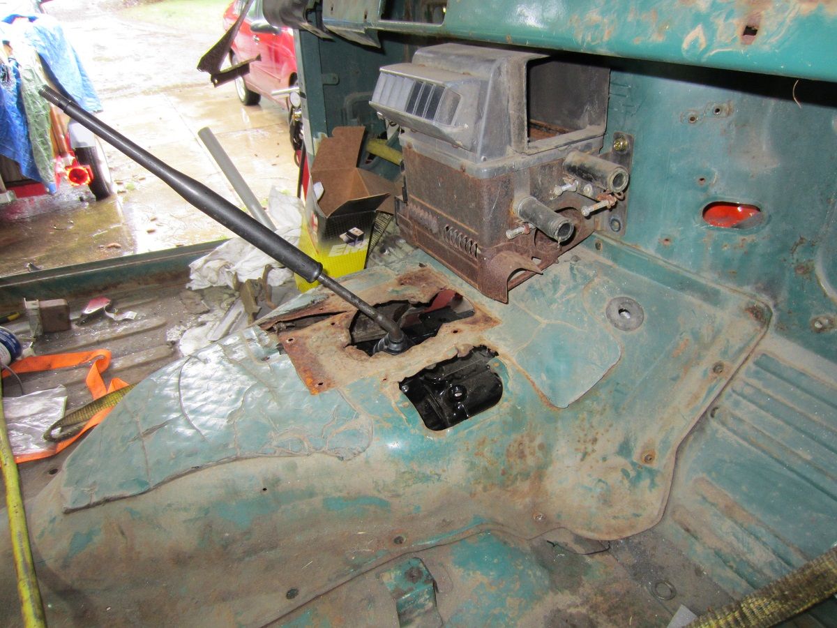

Also took the PO's automatic shifter off the trans tunnel. Thankfully he left the holes for the shifters pretty much intact. I used that to help located the engine. Its pretty well centered in the hole, if not a tad bit towards the rear. Theres still a good ~3" of clearance from the back of the engine to the firewall.

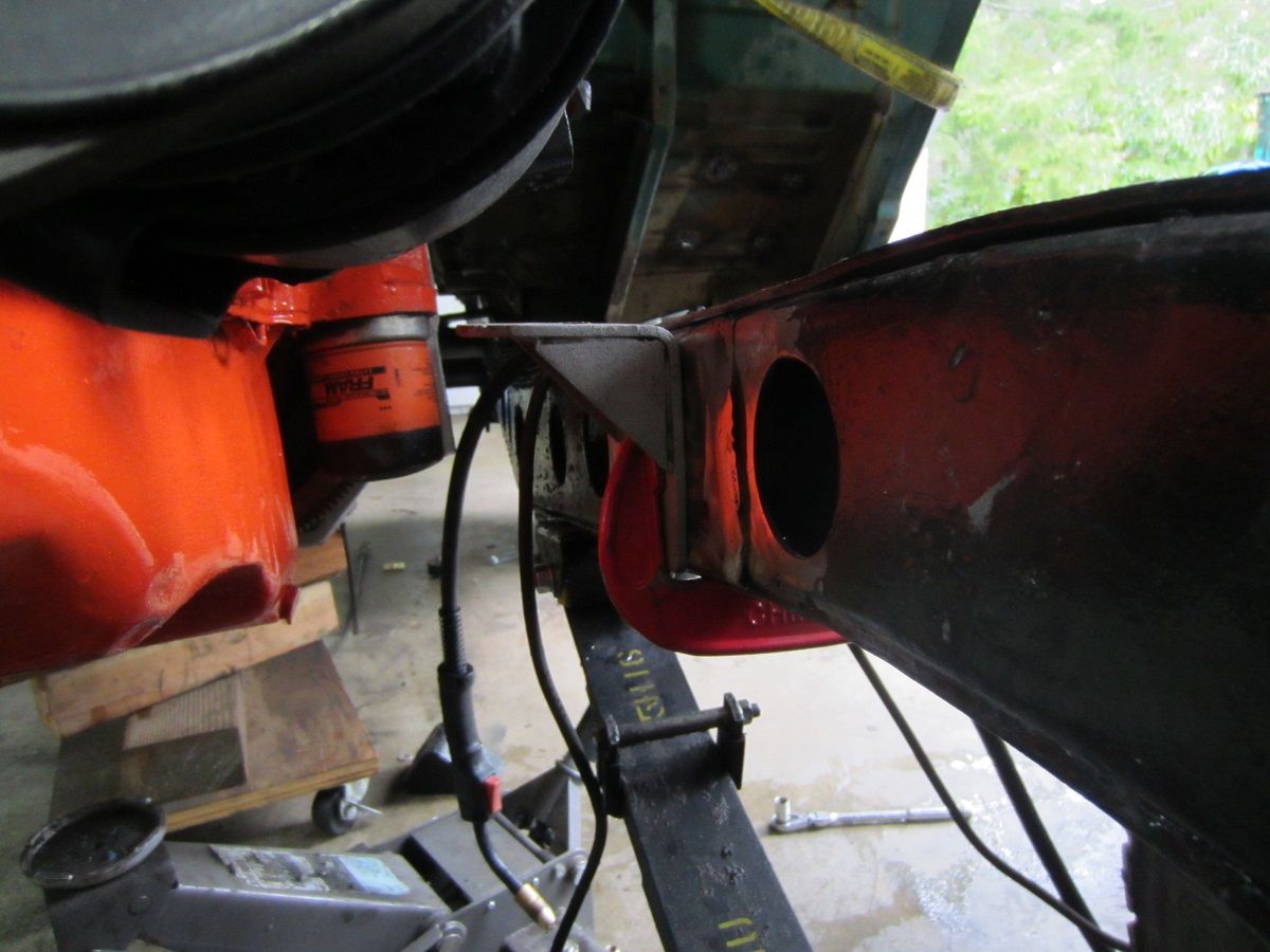

Probably wasn't the best way to do things but got all four scab plates welded in, all for mounts welded in, the engine bolted down, the new AA propeller installed, and the propeller loosely bolted in. Got the engine mounts all painted up. For the transmission mounts I only got some primer on them for now. Once I pull the body and have better access I may end up doing some better clean up of the welds and then top coat. The drivers side trans mount wasn't bad to do at all but the passengers side had some...interesting challenges. The welders I always work with joke around about how you aren't really a welder till you can make a weld upside down, reaching around something, and able to only in one specific position which is of course painful to be in for more than 2 seconds. Well outside of the upside down part I got to experience that! Reaching around the top of the transfer case while looking between the housing extension and propeller. And trying to weld right handed (im left handed). But its done!

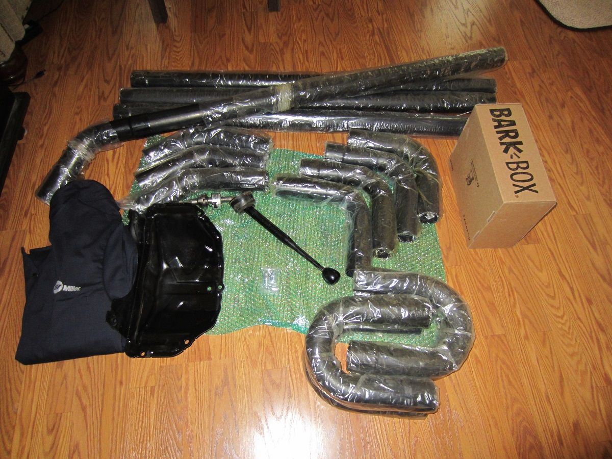

-Got a 2.5" exhaust "kit" that all has expanded ended on one side. Should make welding them together easier than butt welds (for me at least!) It isn't everything Ill need but is definitely enough to get going.
-Picked up a Fj60 H42 inspection cover and shifter (package deal). Not totally sure if the inspection cover will work with the AA bellhousing or not. Its definitely going to need some modification in the quick test I did....exactly how much is to be determined.
-New Aisin Clutch Slave. Its not pictured as I already amounted it. Works perfectly with no bracket needed for mounting. BUT ill need to figure out something for the return spring.
-Fittings for the FJ60 power steering to go to -6 size hose. Not super happy with PSC over them (fittings themselves are fine) but that's another story.
-Miller "welding" long sleeve shirt. Got tired of grinding debris and weld splatter ruining sweatshirts and flannels so figured id give this a shot. Supposed to be better for grinding sparks and the such.
-Lastly the barkbox for the dog showed up at the same time so it got to be in the picture. The pup will be happy with his two new toys and treats.
