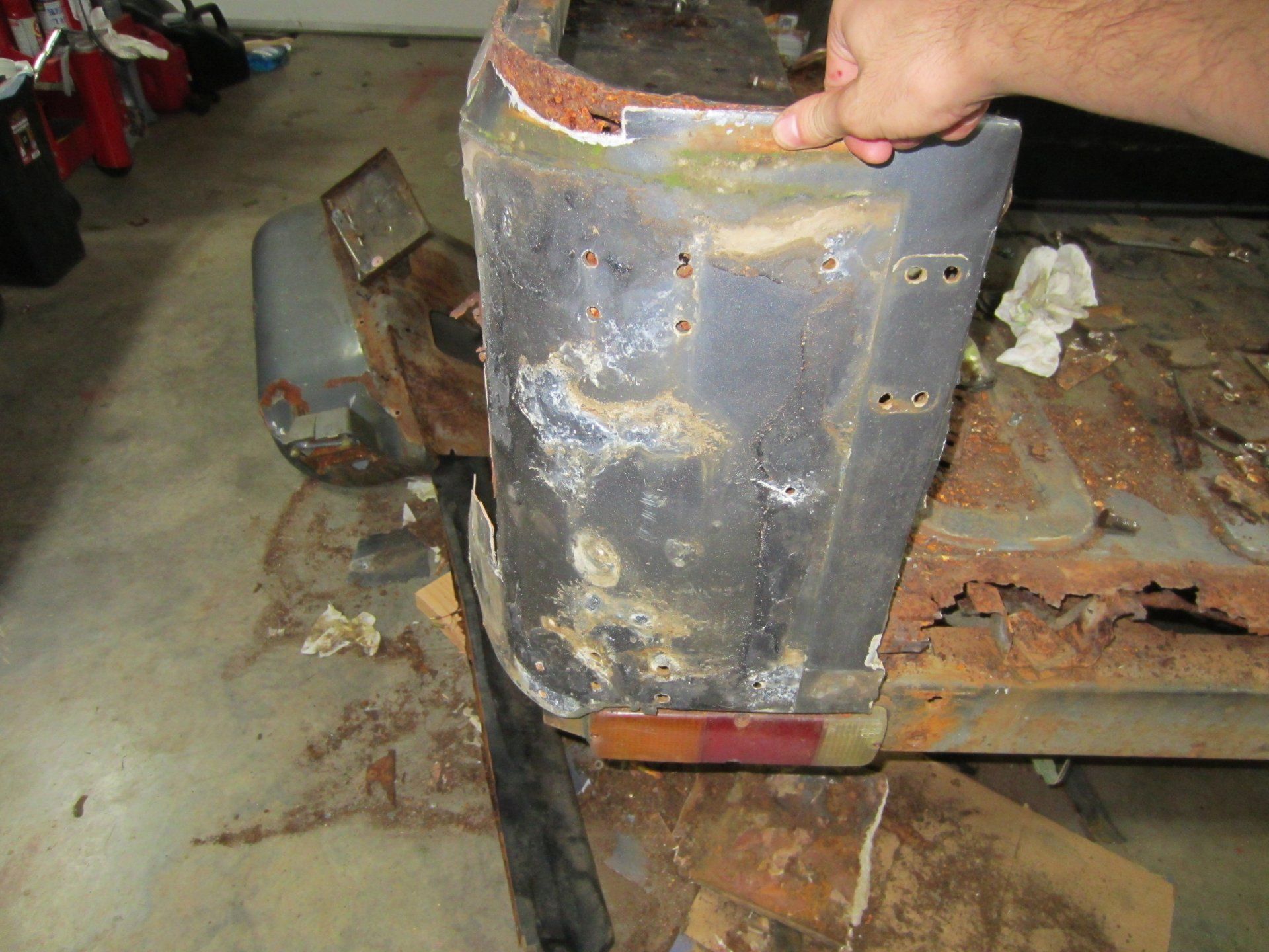

But on another noted here is basically why I "thought" the body was actually in decent shape.
Doesnt look bad even for peeling this part off. Tapping it both inside and out felt pretty solid.

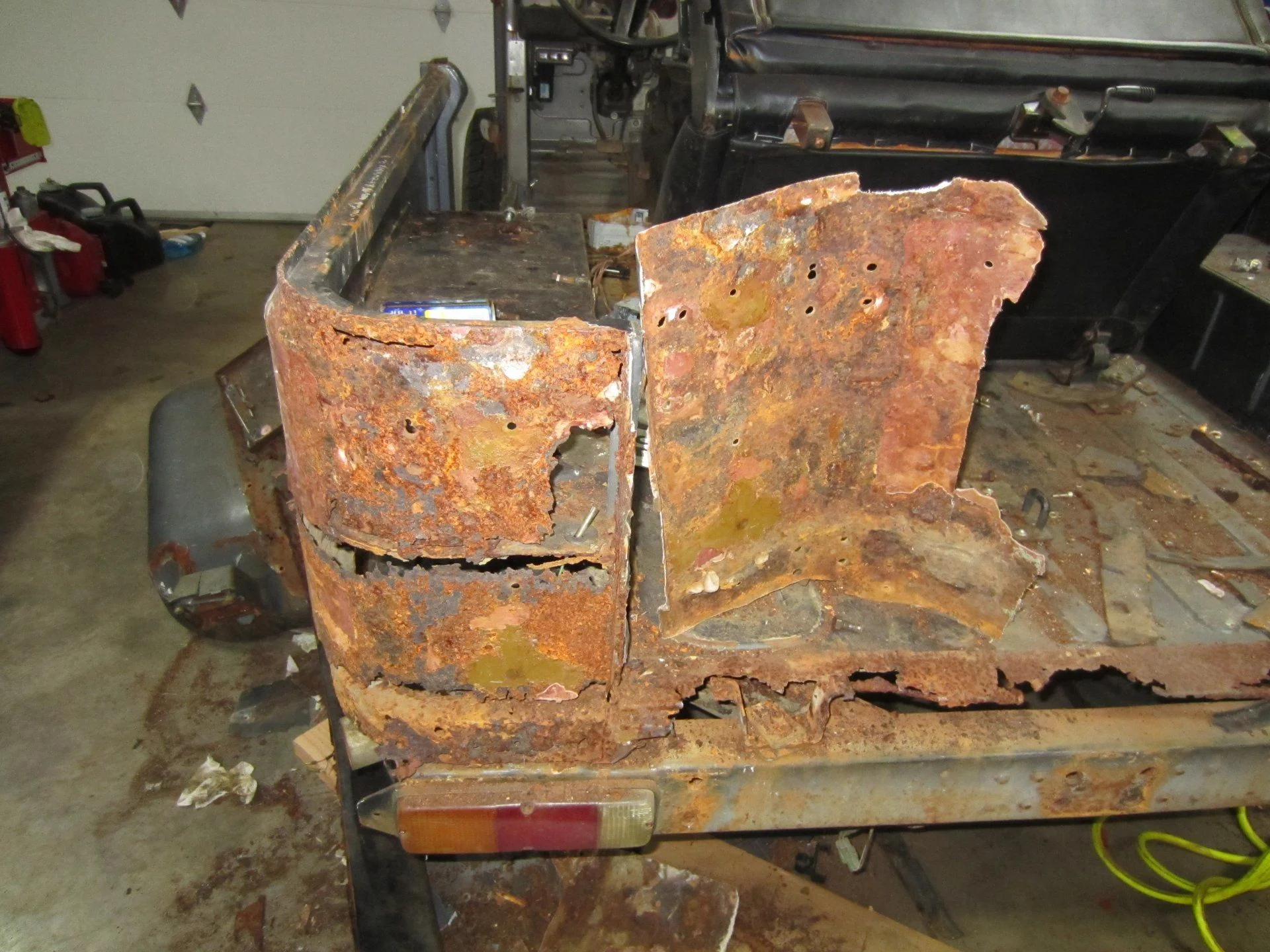

Well pull that bondo/fiberglass piece off and Im left with this. So basically rather than fix rust the PO just fiberglassed/bondo'd over the rust. Which wasnt bad for him since it was just a vehicle to go from point a to point b from what I understand.
