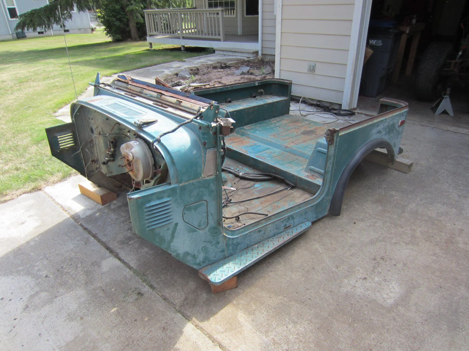

Wow that thing is RUSTED! I'll leave whatever wiring is in the tub to help out with time if you want.
Up to you on the wiring. If you leave it great. If you pull it that's fine too. Whatever works for you as so far the harness I have is in slightly rough shape but that's mostly do to poor splicing and can be pretty easily fixed.
And yeah this tub is a mess. Which surprised both my gf and I since we actually did a pretty through look and even had looked at some of the spots and they appeared just fine. Just shows fiberglass cloth and bondo can really hide things so lesson learned on my end

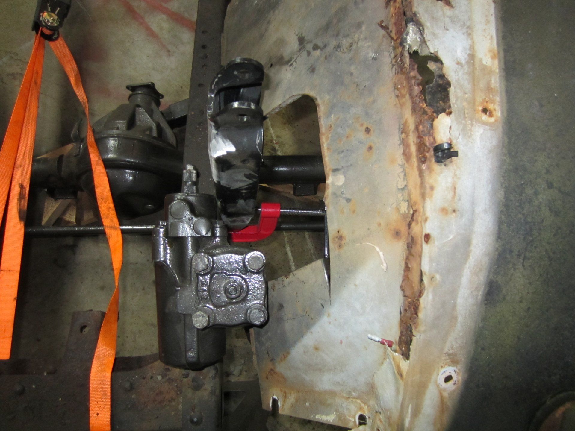

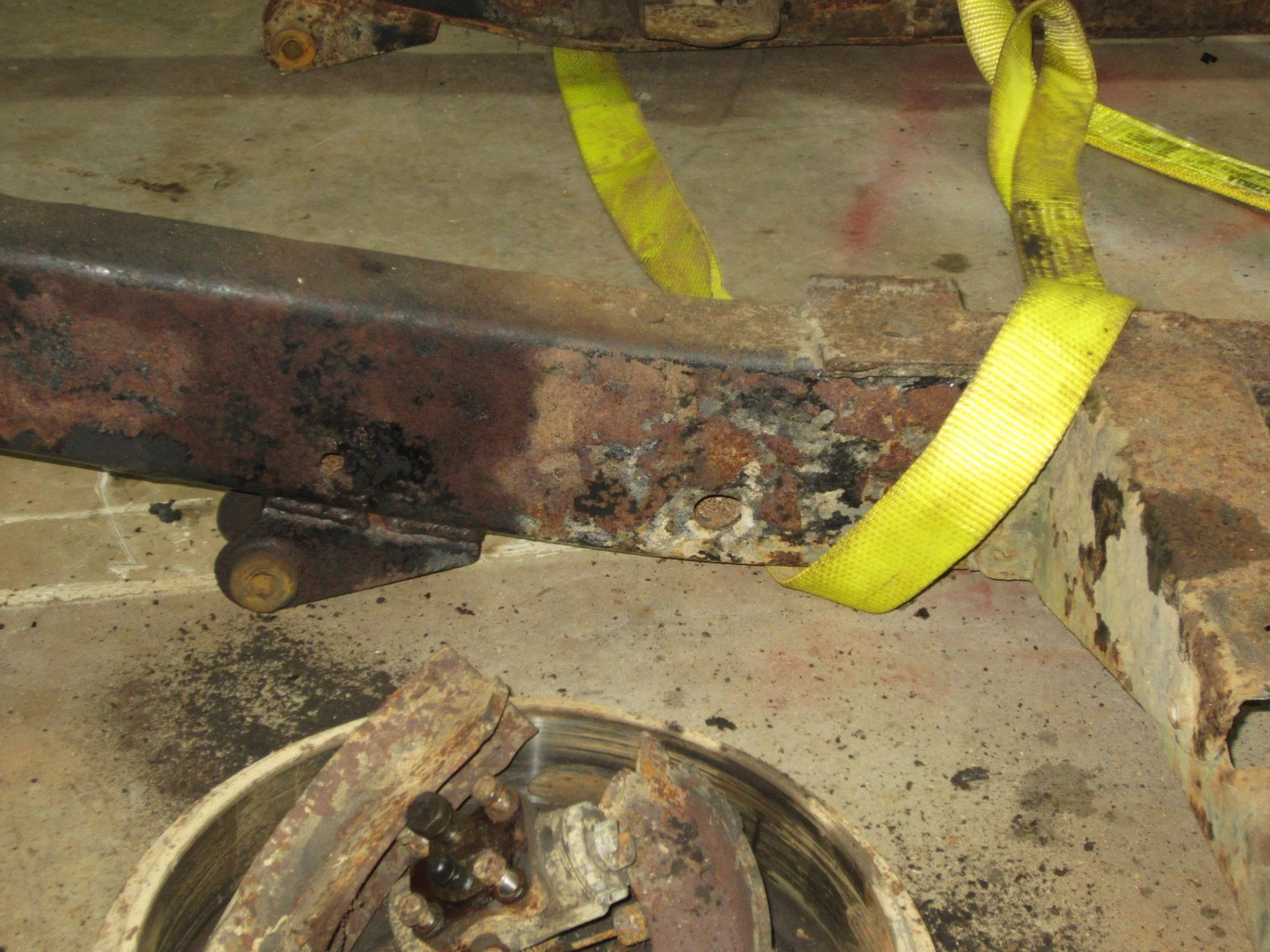

I REALLY dont like how the PO ran the exhaust. Its in the way of pretty much everything. Oil drain plug, Tranny bolts, and just run funky IMO. Its dual pipes and for some reason rather than running the passenger side straight back they crossed it under the engine and ran it next to the drivers side and then split it out in the rear. Just funky but it does keep it away from the fuel line i guess.
And now before i move on its clean up time. Pretty much every bolt take out was shaking things and causing rust to fall. So nice to be able to finally be done with that! Then i need to build shelving in the new shed and move parts out to it. Hopefully by end of Monday Ill have the frame and engine back in the garage and be able to pull my truck in too.

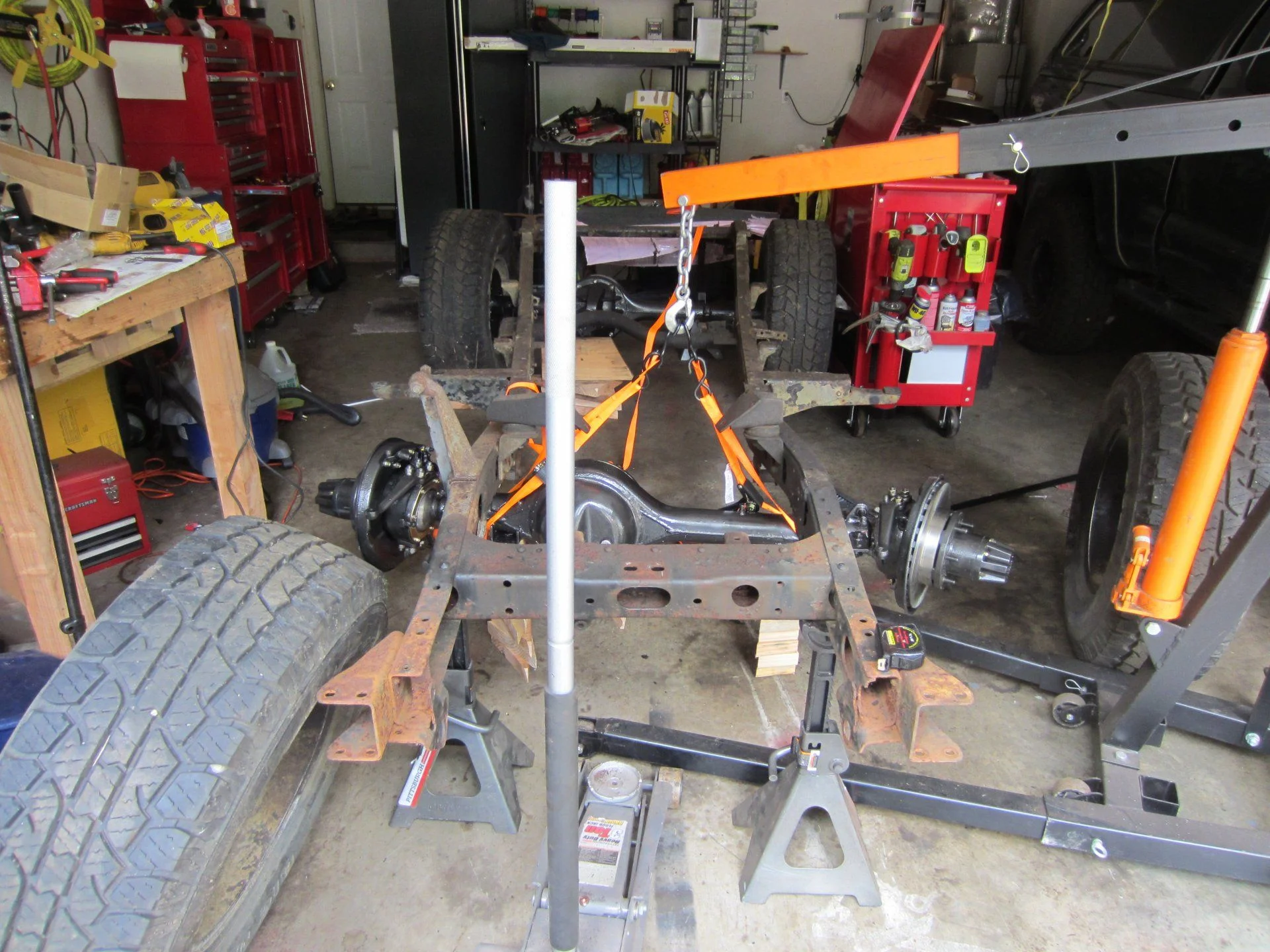

But got the transmission and TC out. All thats left is a little bit of lines (fuel, brakes, and rear harness) and the engine. Then i can take the axles off and start working on them!

On another note I received a new tub from @hopdup95! Its leaps and bounds above my old one. Most of the repair is pretty small and really is just holes here and there. The rear sill and bed being the worst and those arent even that bad really.

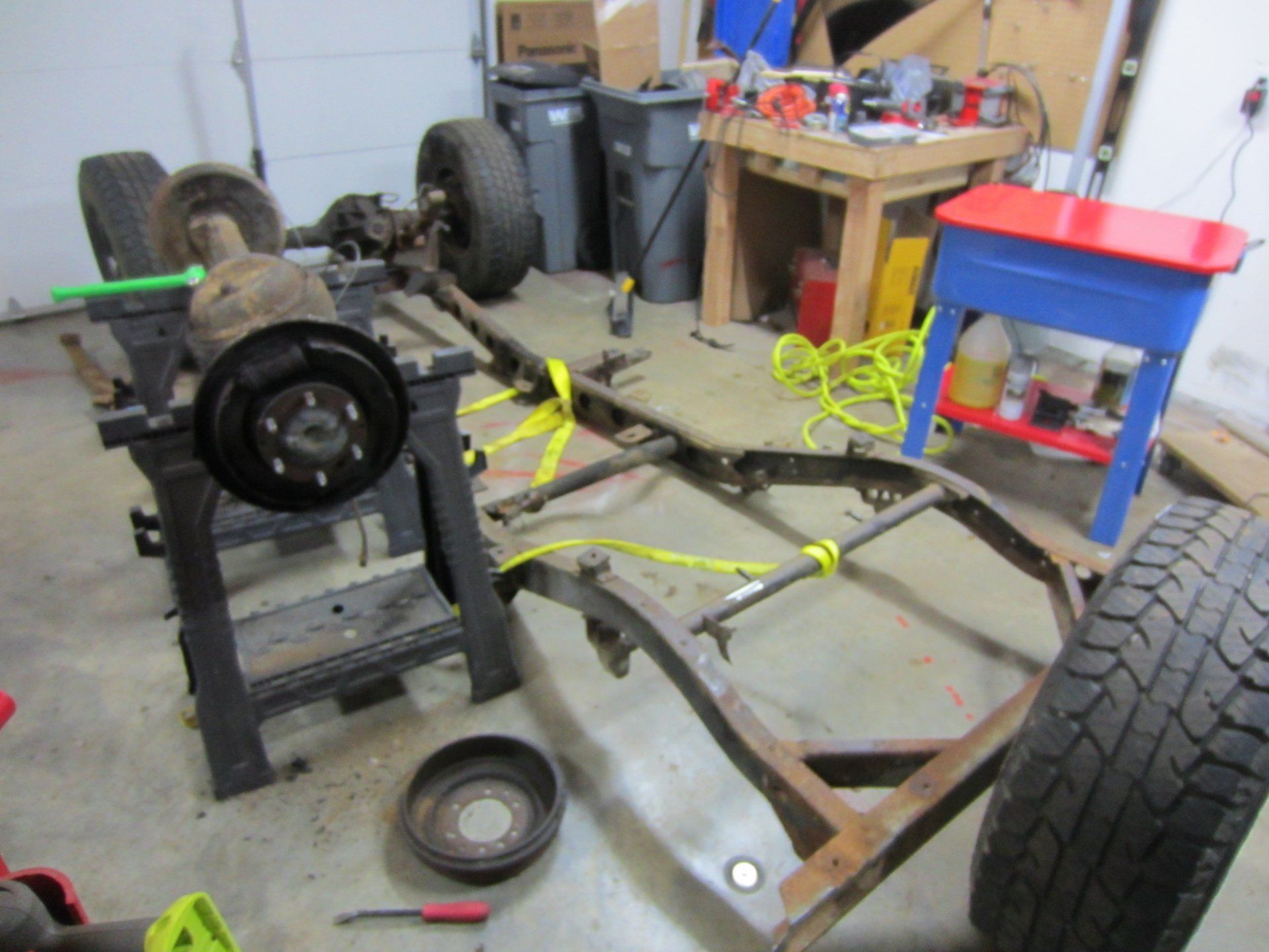

Well got more free time and got the 40 take down to just the axles.
Got the rear on stands and ended up taking it all apart (funny how just 15 more minutes turns into an hour of working)

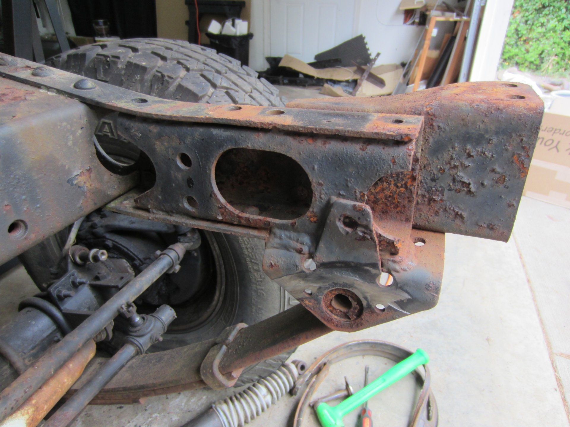

I did run into something im not sure about. Which is the front spring hangers. Both sides look a bit off compared to other pics and the random "tab" sticking up with a hole im not sure what its for. The fram reinforcing looks different but based on other pics looks like its normal? (in relation to the just "L" on passenger side vs the "c channel" on drivers)

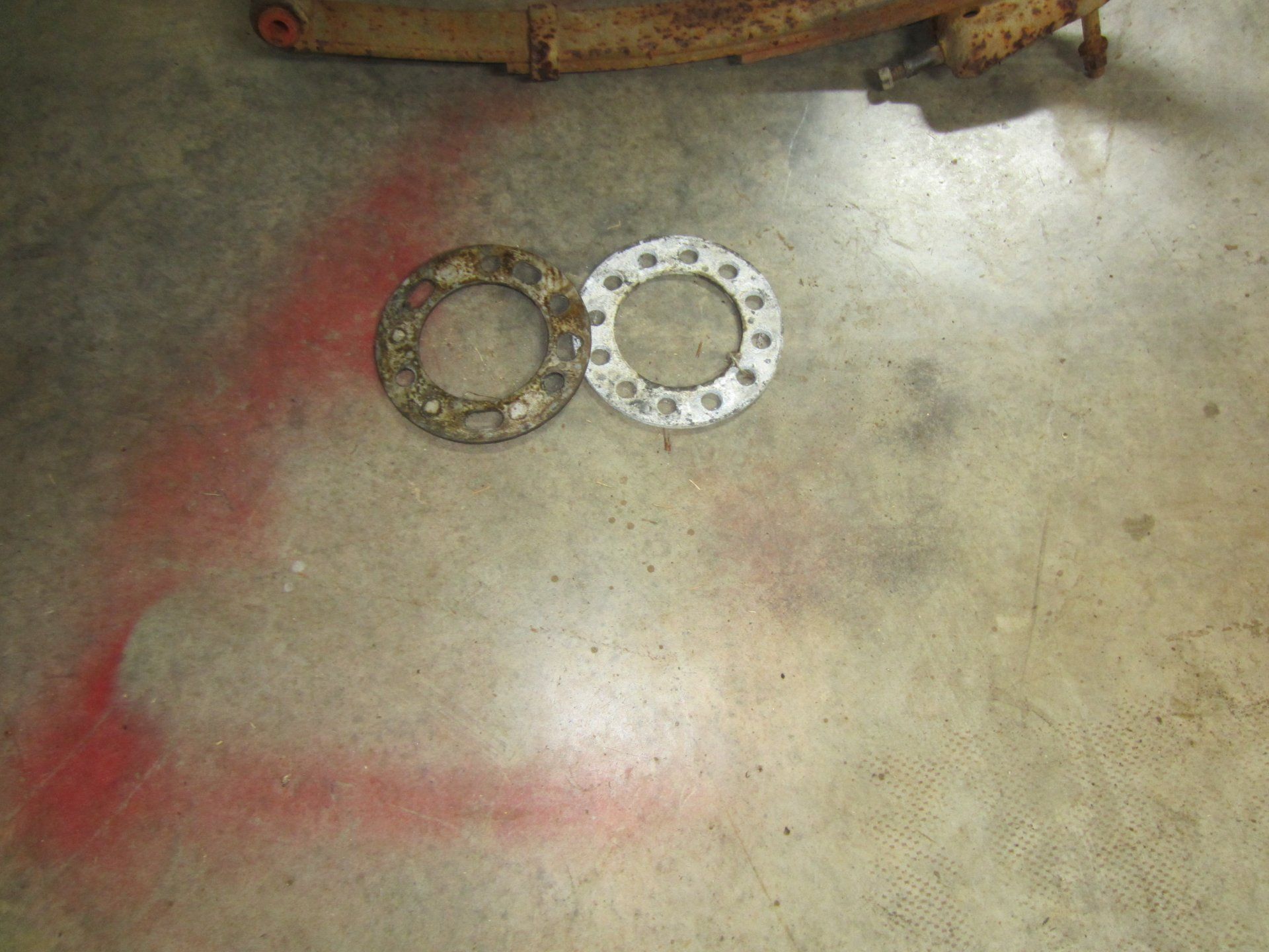

And lastly....apparently the tires and rims the PO had didnt quite work spacing wise. SO rather than use 1 spacer....he used two small ones. Only real problem i had was this didnt leave enough threads on the wheel studs for my comfort level.
full

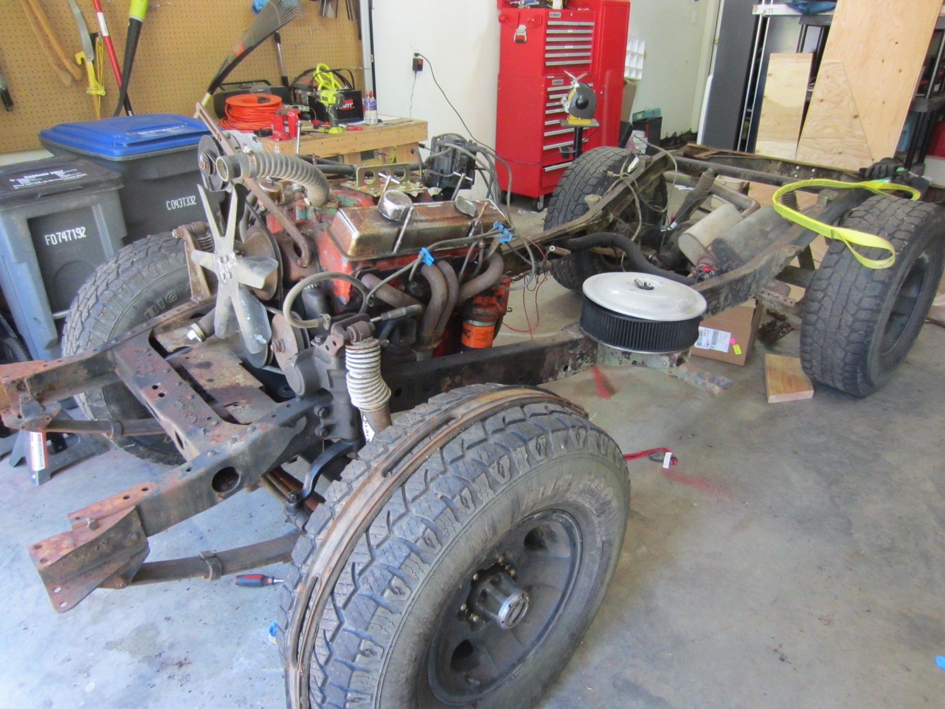

I can't tell from your photos - but looks like you might have a fixed fan with a short spacer, and not a lot of room where the radiator sits.
I made the mistake of assuming the person who put the SBC in my frame (in the 70s) had done it right. For me that has caused a lot of additional work, time, parts to resolve running hot issues.
Take the time to make sure the engine is where it should be.
The fan is a fixed fan (ie no clutch). Im not sure if there is a space or not but what is there, needs to be there to clear the pulley for the power steering.
The radiator is the stock radiator and sits in the stock position. With the engine installed the fan was ~3-4" from the radiator. I might end up with a different radiator in the future as the stock one did have a leak...and id love to get one with AN fittings. The engine also had a few inches to the firewall so it seemed pretty well centered in the bay.
The engine seems to be mounted right the best I can tell which was just measuring the mounts to make sure the engine was centered but other than radiator clearance and making sure its centered I dont know what to look for to be honest.

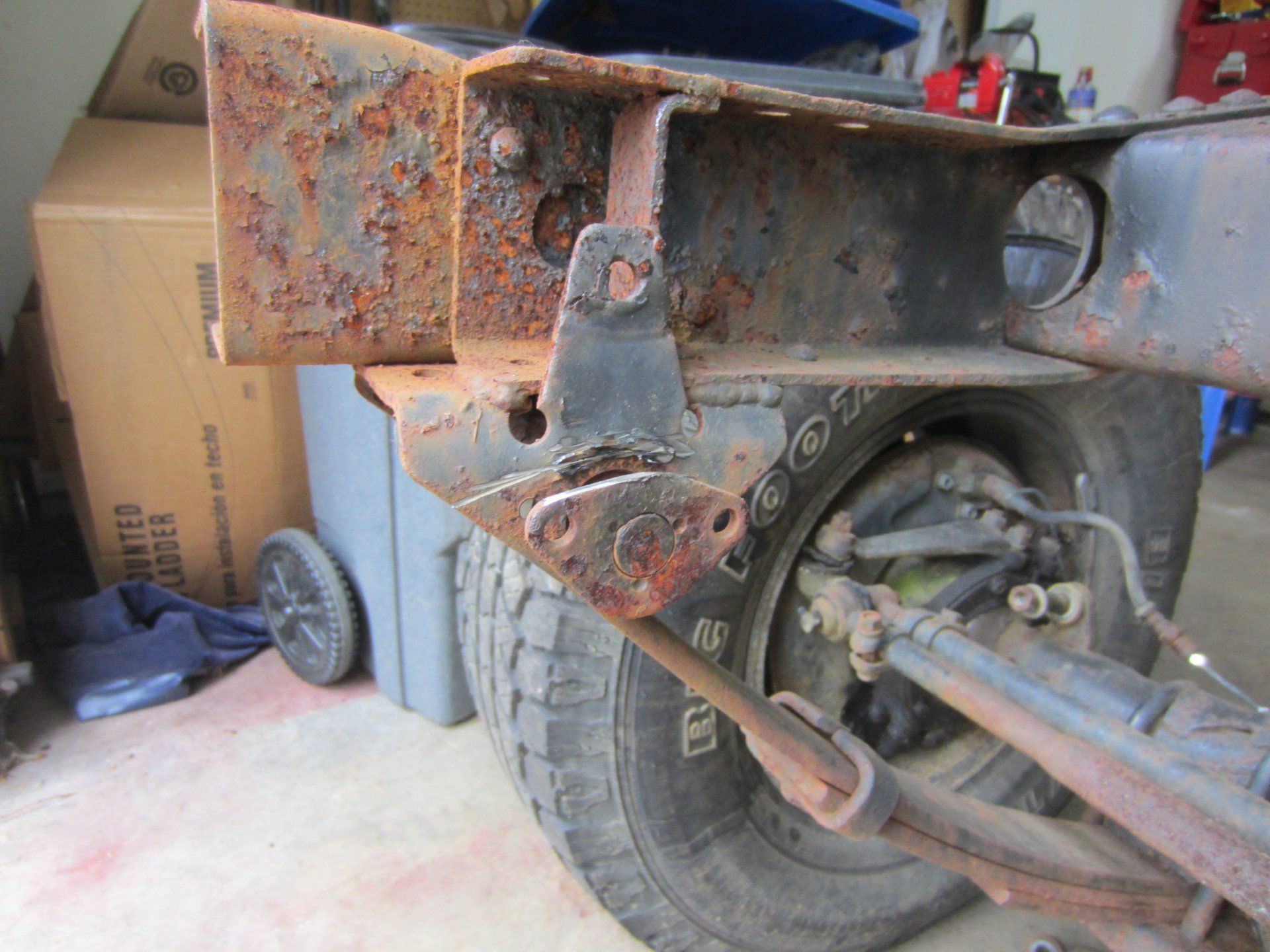

Your frame has had a shackle reversal done to the front springs. Those front mounts were the rear hangers that were rivited to the frame rails. The ear that sticks up was attached to the outside of the frame rail originally. Also what do the rear shackle mounts on the frame look like now? Were they recessed into the rails? If not you may have pretty bad caster angles in the front end...

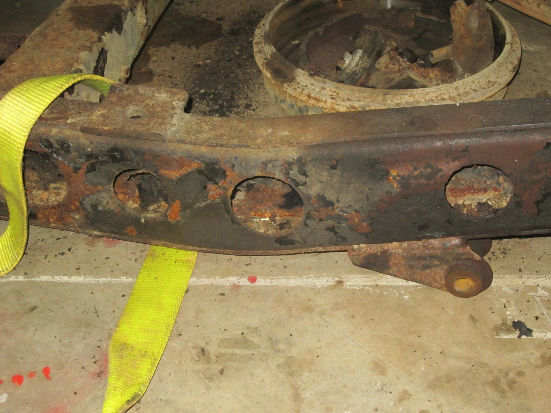

Now that you mention it it makes a lot more sense. Here is what the drivers side rear hanger looks like (the passenger side is the same)
It really looks like the PO just removed the hangers and swapped them and welded them back in in the same places (for the most part)
looking outwards
full
Looking in
full
Looks like they just flipped locations on them and that was it. Looks like something else Ill be fixing....
Yep they just flipped the spring mounts front to rear. From what I understand when you flip the fixed mount to the front the upper shackle mount is recessed in the frame rail to maintain caster angles. The kits sold by LCAH/Man-a-Fre have a front tower that extends down from the frame and use a standard shackle at the rear. As a result of this there is a 1.5/2" lift built in to the shackle reversal... I had one from Man-a-Fre 20 years ago but have since removed it
Good to know and the little bit of googling for pictures I see what you mean. Seems like 75% of the reversals put the rear mount up into the frame a bit. The other 25% seemed to just do what this PO did.
Ill have to do some research on how i want to do the springs now. I had planned on just getting the OME kit so id need redo the perches if i go that route. Which shouldnt be to hard...just a matter of cutting them and rewelding them.

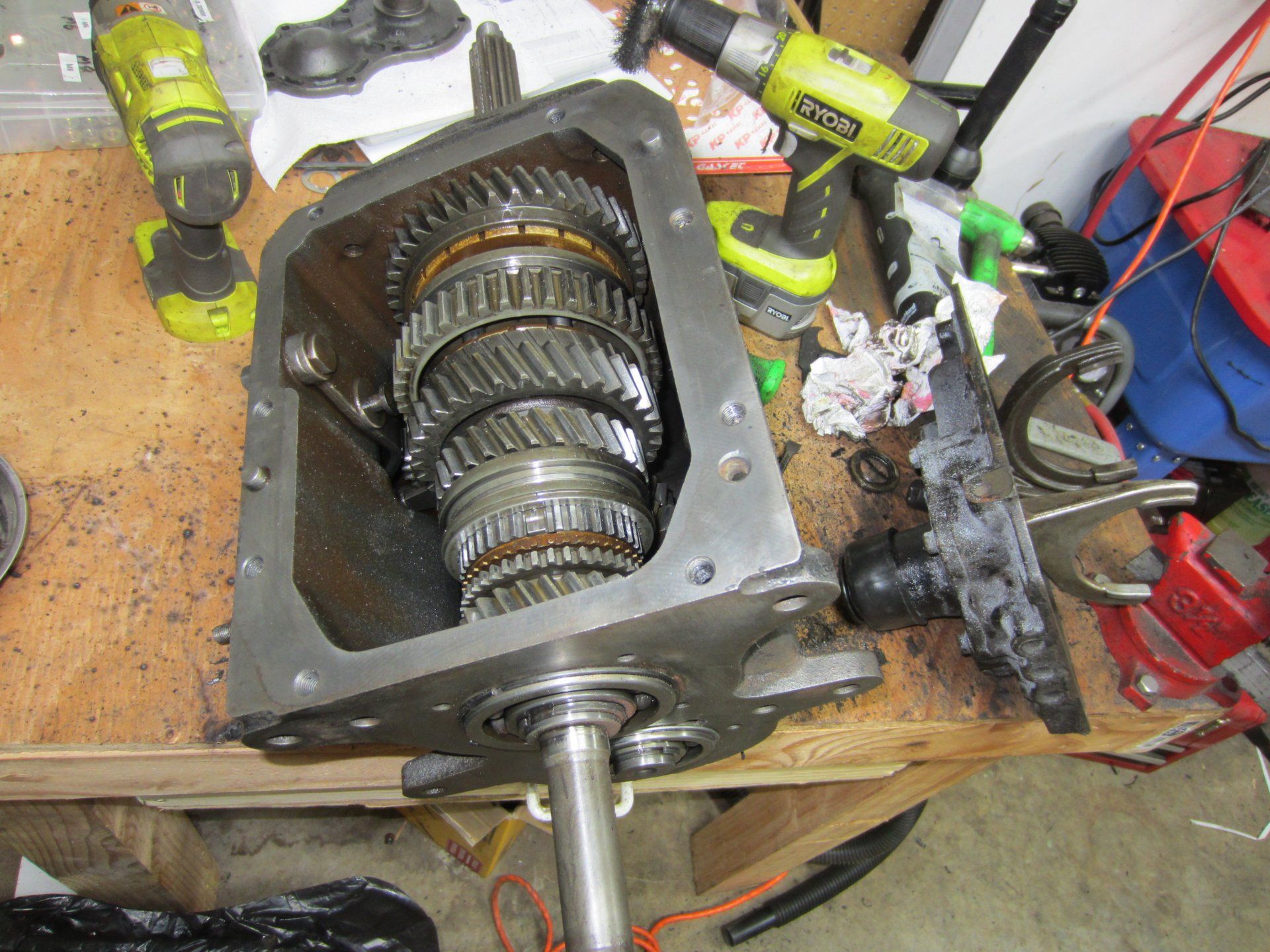

I then felt like staying somewhat clean so I tore into the transmission. I was told it was rebuilt in 2002 and only used till ~08 with under 15k miles on it. I still ordered new seal and gaskets and wanted to get a look inside just to see. It looks to be in good shape overall. I didnt notice anything worn out really. So pretty happy with this purchase!

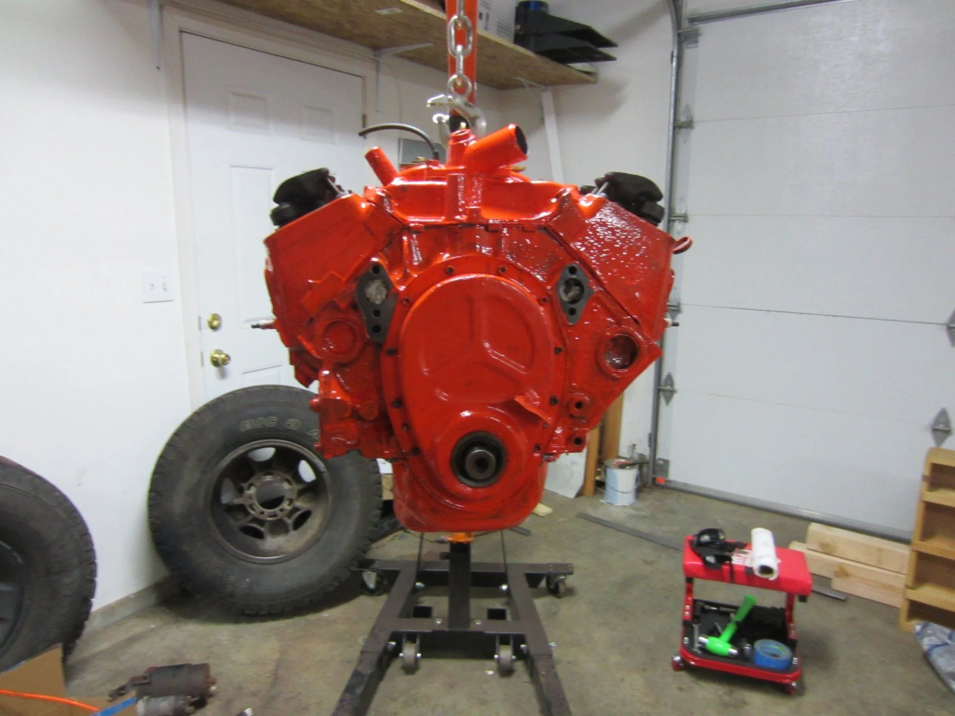

But during the winter i managed to get the old 283 cleaned up and give it a "polishing the turd" paint job. I replaced most of the gaskets but didnt do the head gaskets or touch the oil pan. New water pump as well.

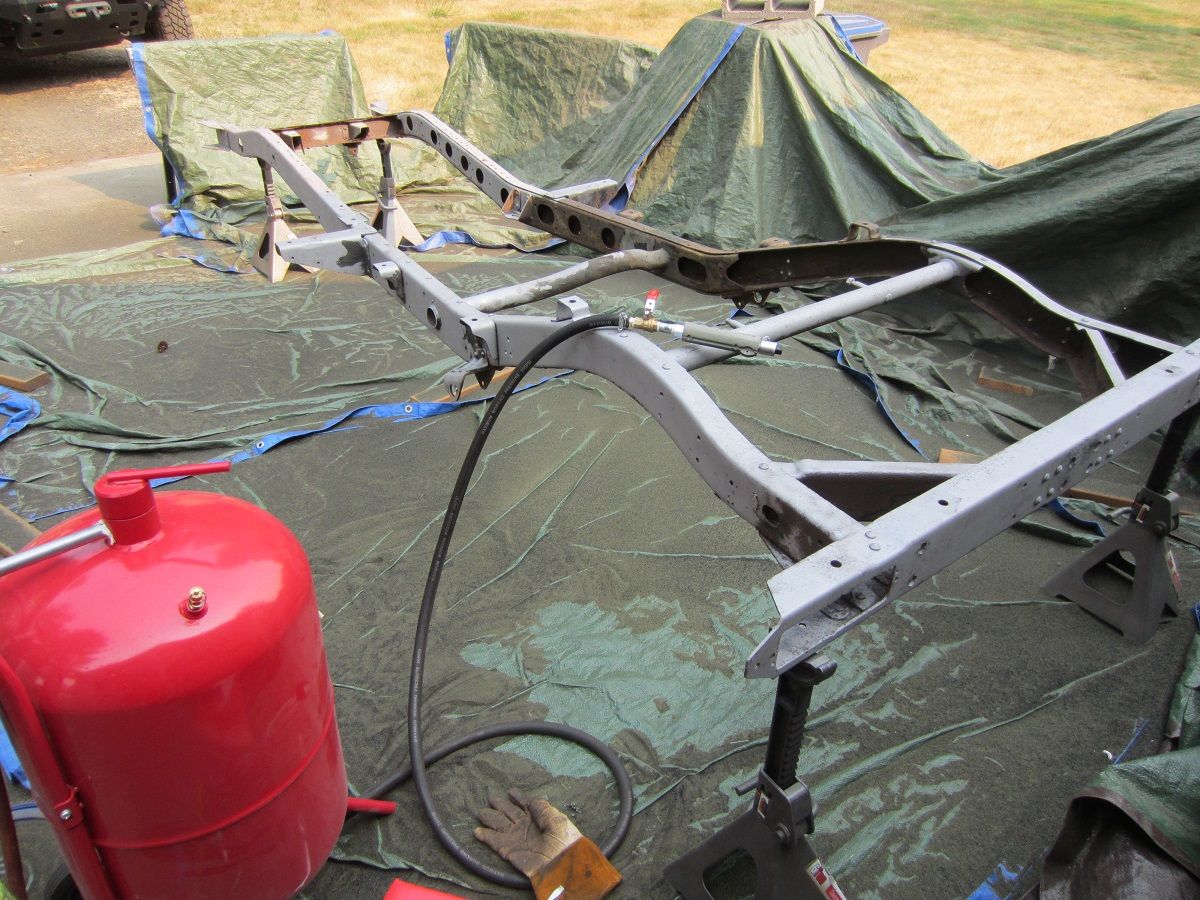

Things sat for a few months after than. This past July i picked up a sand blaster and started really get after things....starting with the frame.
full
Once i finished blasting the frame, it got two coats of POR-15, a coat of POR-15 tie coat, then two coats of rustoelum farm implement gloss black (i mistakenly bought the gloss and not low gloss but dont mind the gloss).

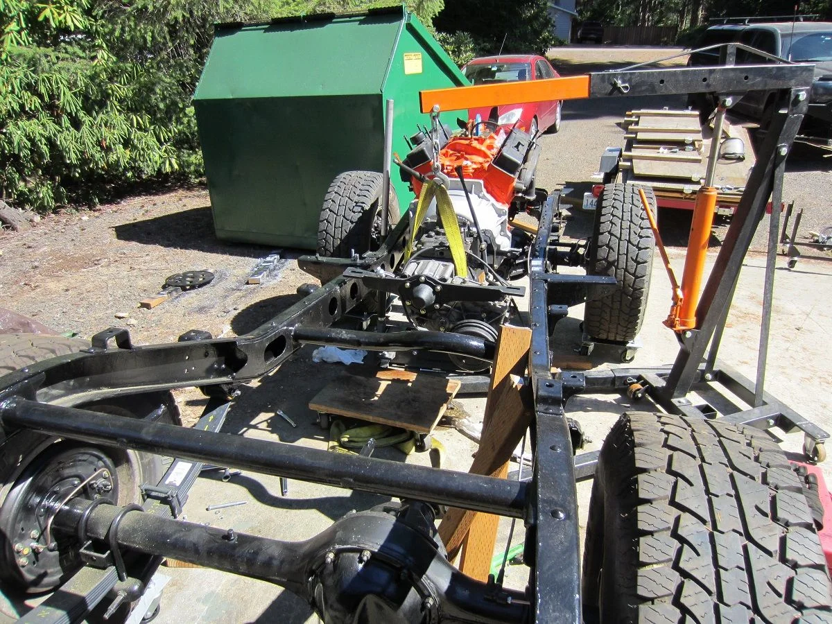

After painting I got both the front and rear axles under the frame and the OME springs attached. For some reason i couldnt find the front u-bolt plates so had to order news ones of those. Also got the engine mounted to the frame.
From there i put the advanced adapter bellhousing on and put the H42 in place ot see where the mounts would need ot be placed....only to discover the stock bellhousing support bracket is in the way...D'oh! O well be easy to fix and i still saw where the new brackets would go.

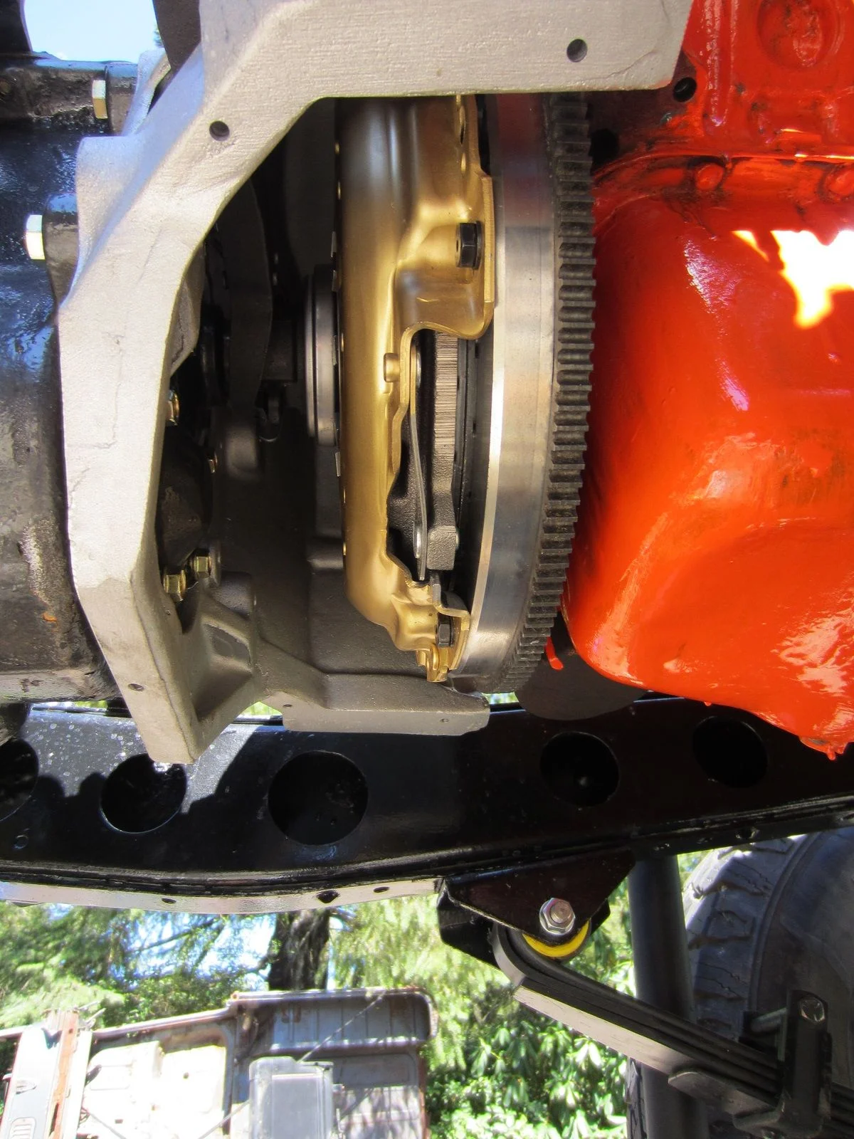

I got the flywheel and clutch installed. Used a well reviewed, cheapish flywheel off summit racing. Then used the centerforce clutch and pressure plate that are recommended by Advanced Adapters with their kit. Used all new ARP bolts. Also got to buy a new socket set since the flywheel bolts are 12 point and i didnt own any 12 point. I do enjoy a reason to buy more tools so dont mind!
After the clutch I put the AA beelhousing on. Then used my engine hoist and some muscle to get the transmission in. Also picked up some 5" long bolts to use as a "guide". If i were to do it again I'd have picked up all thread so I could have "walked" the transmission into place but tightening nuts. But really it wasnt to bad.
I did have to make my own dowels. Not sure why but the H42 i bought didnt have them. So it was a bit of an adventure to get something that would work. Meant to take a picture but forgot.
The AA bellhousing also left me slightly disappointed. Id still give it a 8/10 but the holes for mounting the transmission had gunk in them and also were rough threading in the bolts. I ran the thread chaser through a couple times and they cleaned right up. Just a bummer to have to do that one something brand new. My other complaint was with the directions. Honestly they are pretty worthless. Its more just a parts list and a diagram. No torque specs or something. For a first timer it was a bit of a bummer to have to go research things like bellhousing to engine bolt torque specs. (the engine mount and transmission mount directions include torque specs)

And one last look from below. Hopefully nothing looks wrong lol. Ill need to find an inspection cover at some point but that can be down the road.

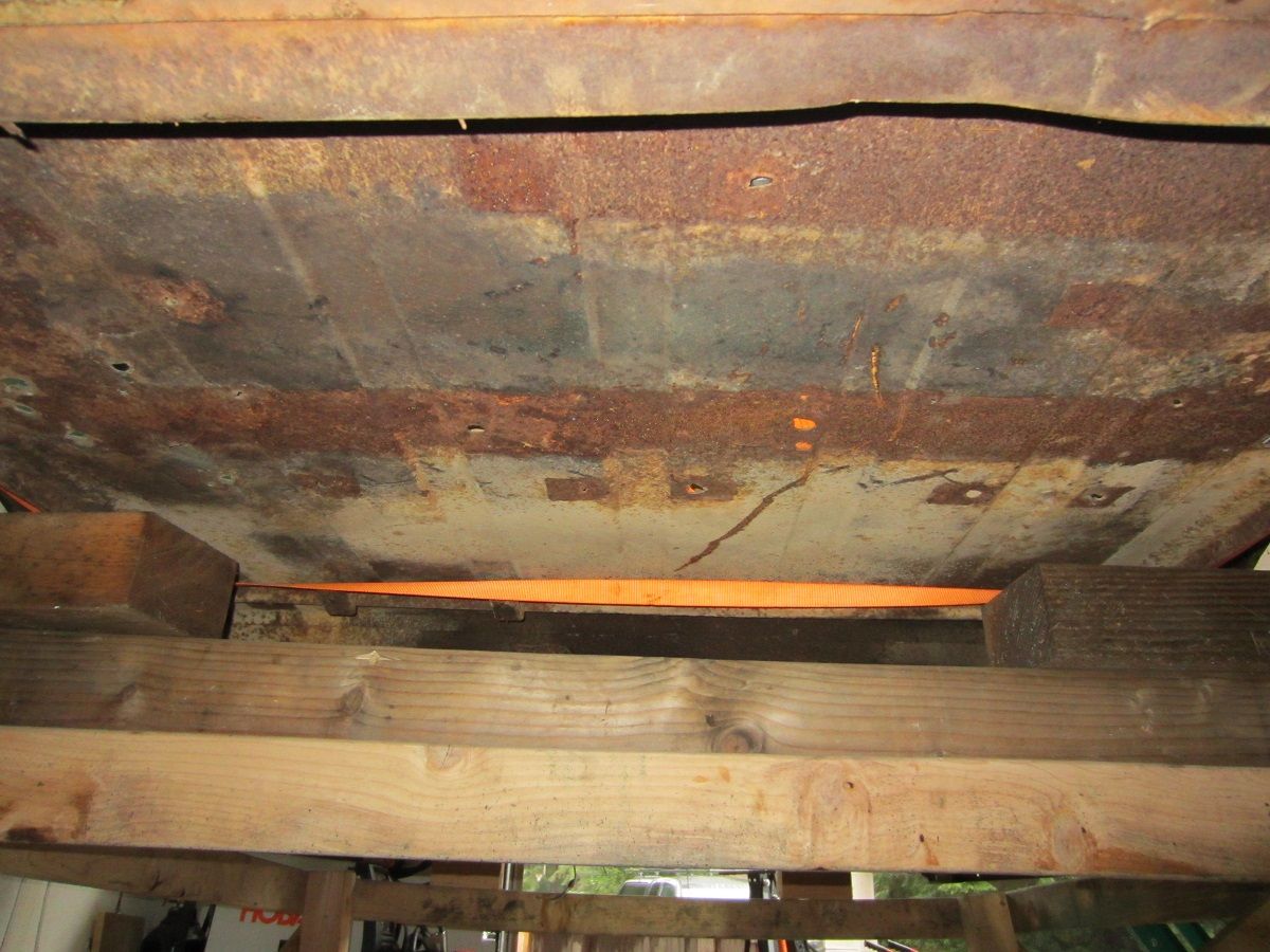

1) Rear sill. I think the sill isnt actually bad, just the metal "cap". But figure safest bet would be to replace it with all new. So already ordered a new one.
2) Is a bunch of random holes. Previous owner had a roll cage that bolted to the floor so gott fill those holes. Same holes got cut to access the front body mount bolt. Then just some other random holes

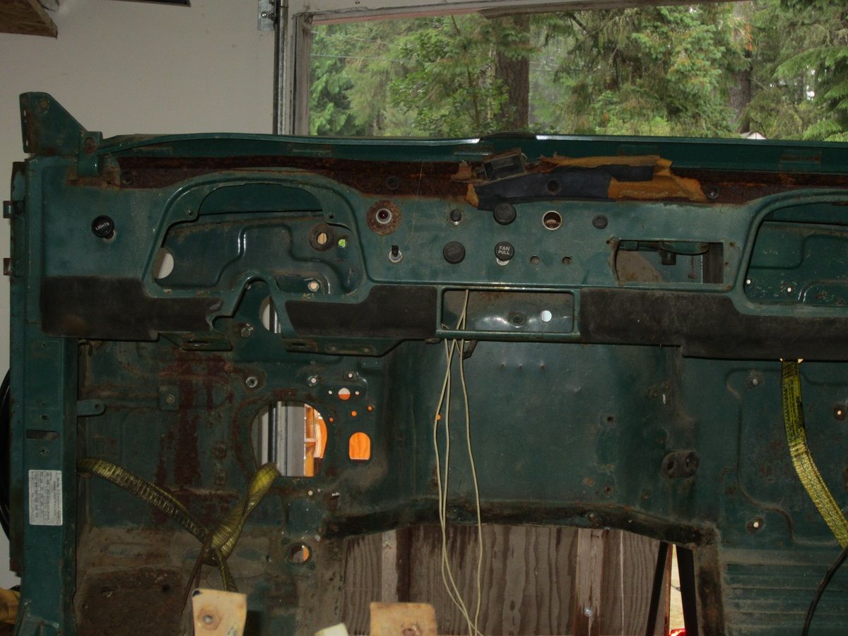

3) The dash area. Overall its not to bad but going to need some work. Will need all new dash pads. The upper dash pad support is bent and going to need straightening. So have to figure something out for that. The ash tray also has been cut so might need a small patch there to make it rectangular again. Then it should only be plugging a couple of the added holes the PO used.
full
4) Is the quarter panels. The PO cut them to fit larger tires. So I will need to fix them. It kind of sucks cause the rest of the quarter panels are in good shape (ie no real rust). But i fear the cut the PO did is going to be to much to use something like the real steel wheel well patch. So itll either be full rear quarters or the wheel cut out patches with some extra patches to go with them.
full

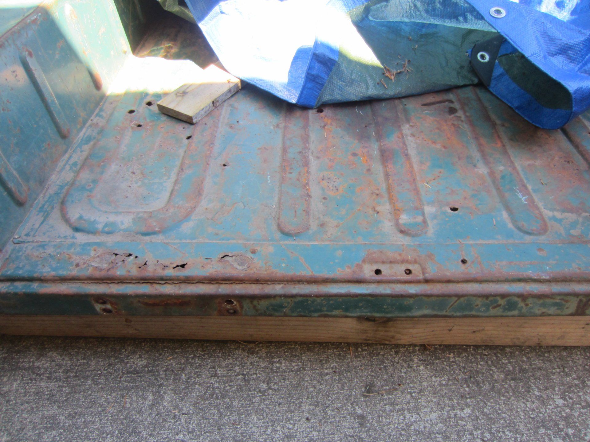

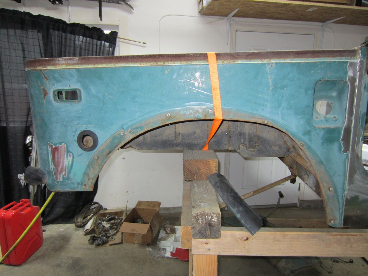

5) Lastly is with the bed. I always felt like it was a bit to flexy in some spots. Well noticed a piece is missing all together. You can see the rusty spots where for some reason the PO cut out the support and also the brackets for the "skid plate" thingy. Thankfully my old tub has them so i should be able to salvage them. It also explains some of the holes in the bed. Whoever cut them out probably just drilled out the spots weld and straight through the bed. So be a double whamming sort of fix being able to weld the brackets back and plug the holes in the bed lol.
full
