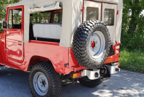

I do know most of them have rubber bumperettes. Probably because the roads were quite tight and a mild bump is served better with a shock absorber.
That style soft top was never offered in the US. All our FST had soft doors on the side and tailgate on the back. First couple of years of the FJ40 in the early sixties a few had barn doors. But none had the hard/soft ambulance doors.
Please understand that was an image to show bumperets that were attached to a SA vehicle. The softtop was never an issue. Perhaps you are adding to the thread by observing something else.
That all I was doing. That combination of doors on a FST is always a five away being from another market or a later conversion. Barn doors and left side spare were never offered in the US. The rear ambulance doors for the soft top is a option I wish Toyota would have imported here. Have a 1962 FSM showing the FST ambulance doors. I personally like the soft side doors we got with the FST.

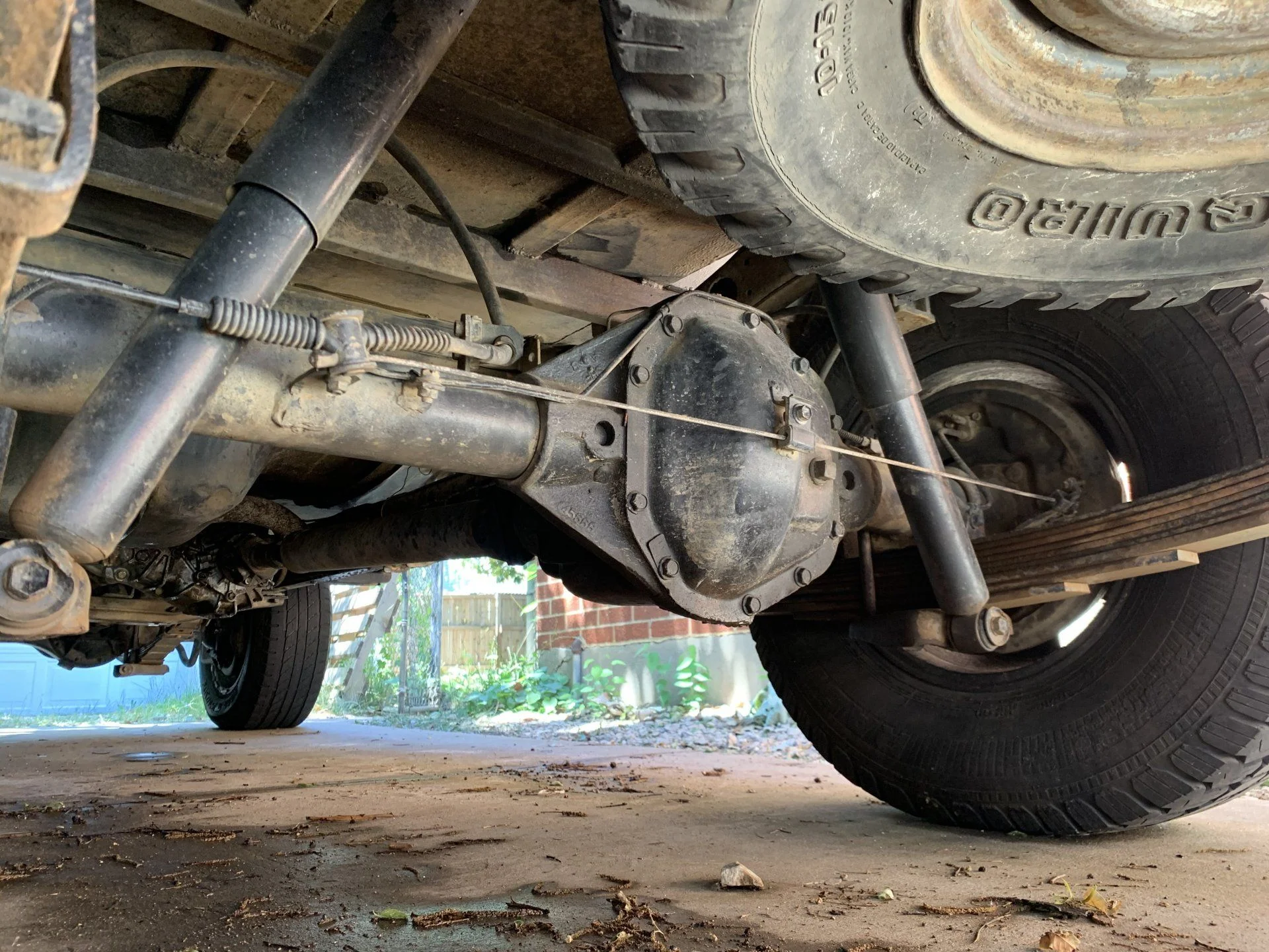

Rear axle being a Dana 60 sem-float is south american only
Been here a while and never heard this. Please elaborate, with pics if possible.
Sure, Venezuela made a deal with Toyota that they would sell the FJ40, but a certain percentage of it needed to be "locally" made/sourced. Government regs or something...
That looks like:
rear axle, radiator, doors (some) glass, softop, etc.
The rear axle is a Dana 60, semi-float
