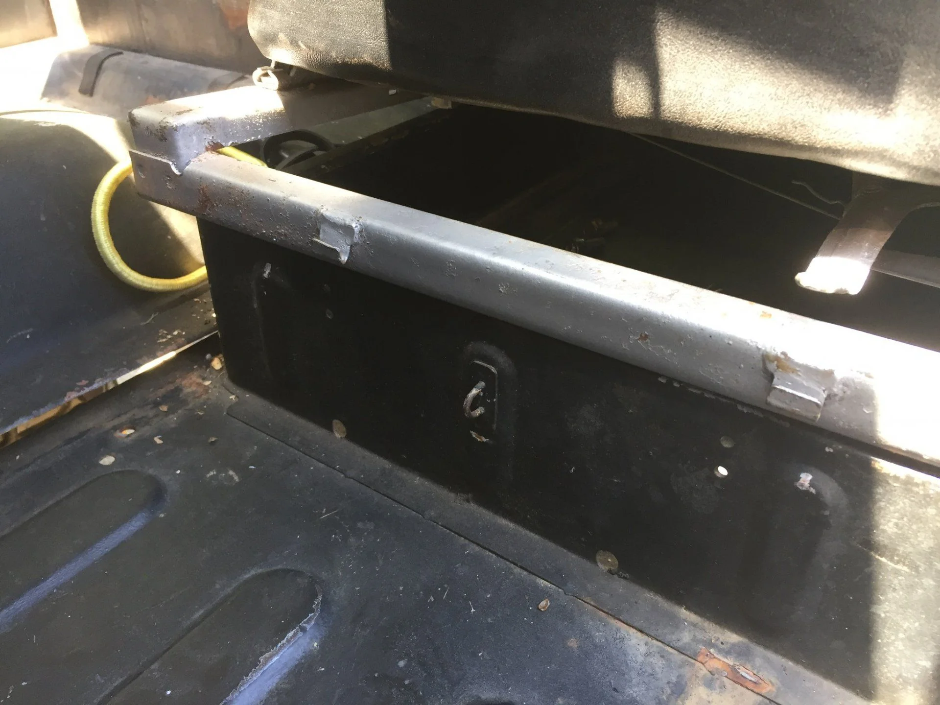

You should have 2 hooks that are welded into the seat frame. Those hooks latch into (2) othe hook Componetns that are bolted to the front of the toolbox. I hope that helps. It's a real simple design on the early seats.

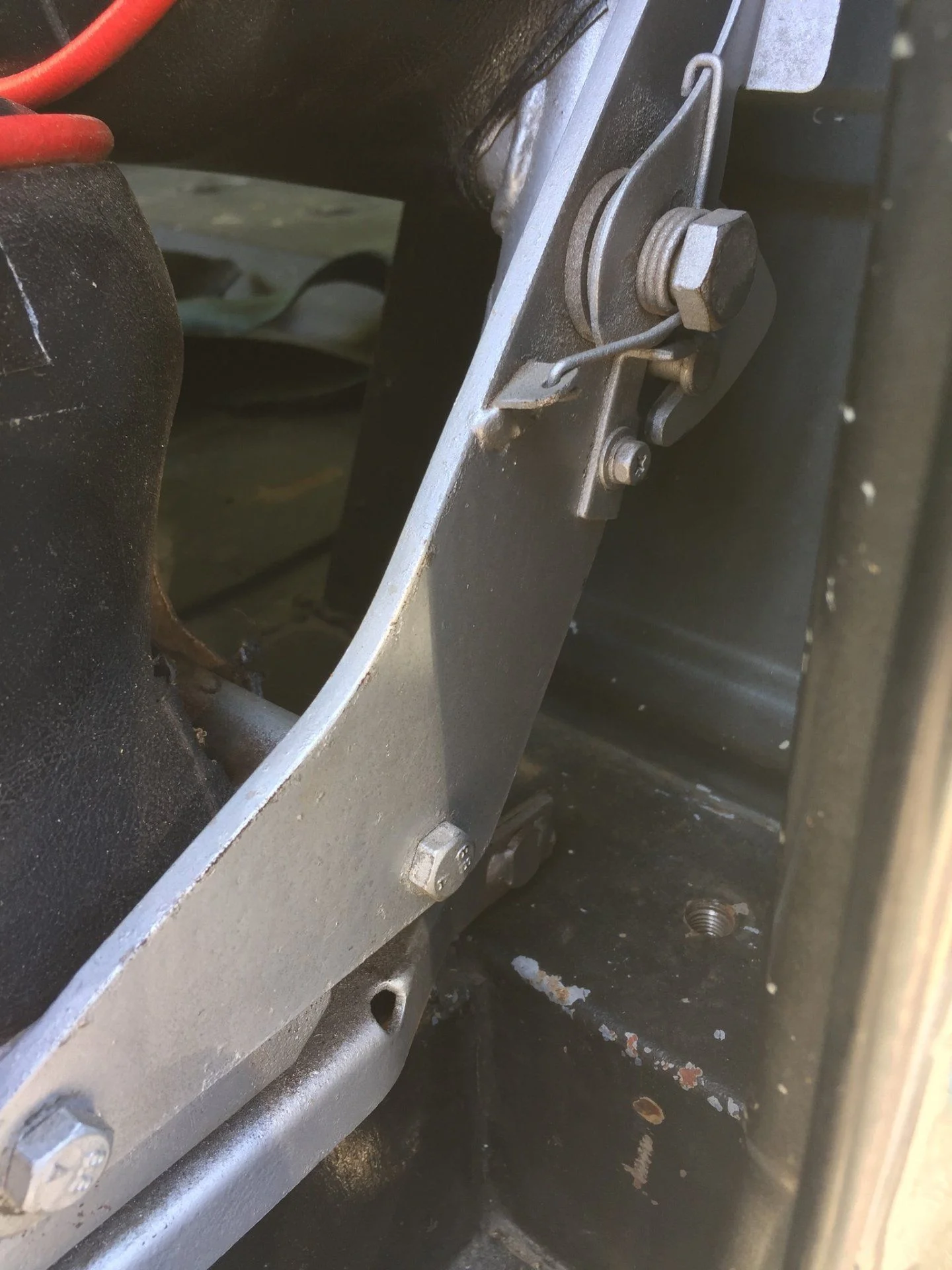

I'm looking to source the latches, but what about the rear of the seat? Surely it bolts down to something?

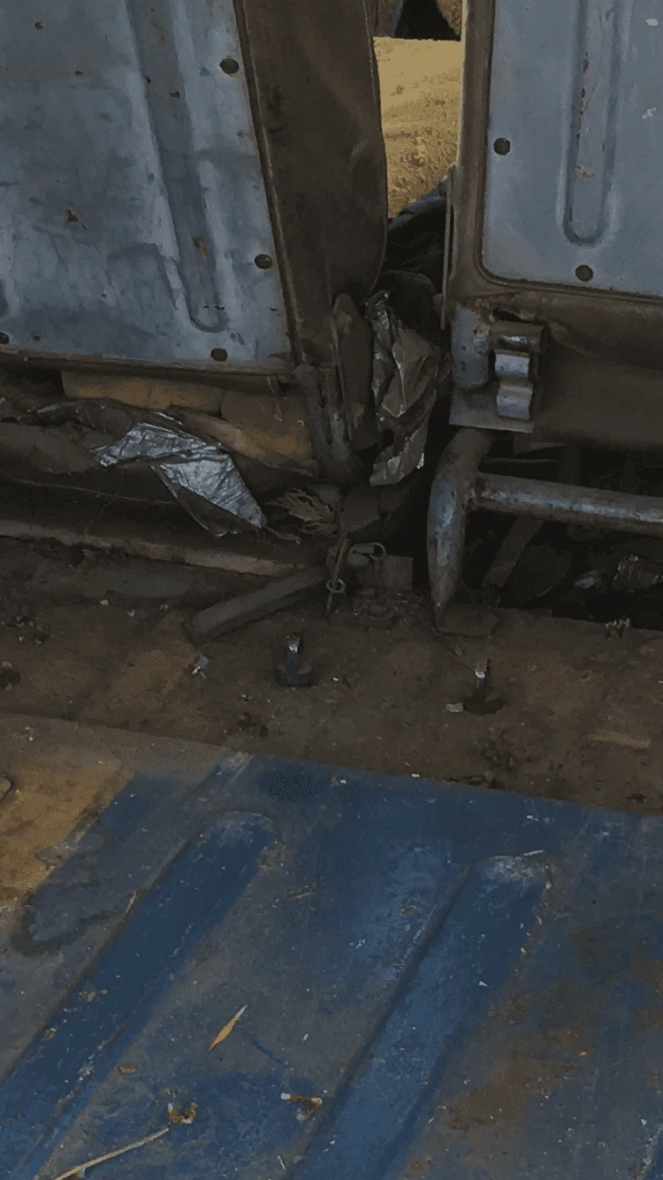

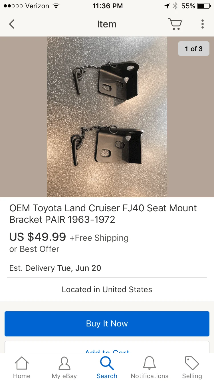

Yes- on the back of the seat should be (2) round pins, that will side through the holes on these brackets here and these brackets mount to the floor. I've included a pic of mine when I tore my cruiser down and a set that's currently on Ebay, that would work for you.

Latches to secure the seat frame to the tool box can be found here McMaster-Carr
I'm not so sure safety was top priority when the the mounts for these seats were designed.You may want to add your own measure of security when reconfiguring the brackets,hinges and latches :steer:
Not to hijack, but if you are already there: if you can take pics of the early driver's side mechanisms that attach the seat frame to the vehicle/tool box lid, I would appreciate that. Just got seats yesterday for my 1970 and am uneducated on what I still need. SOR.com isn't much help as the line art is too low res to really see what's missing.
1970 fj40 driver seat tool box latches.
Thanks - duh. Didn't look there. Four sets available.

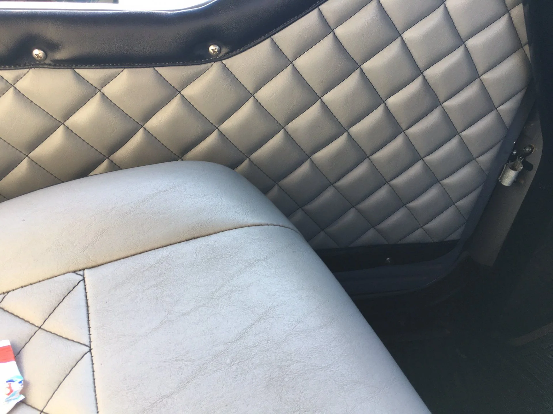

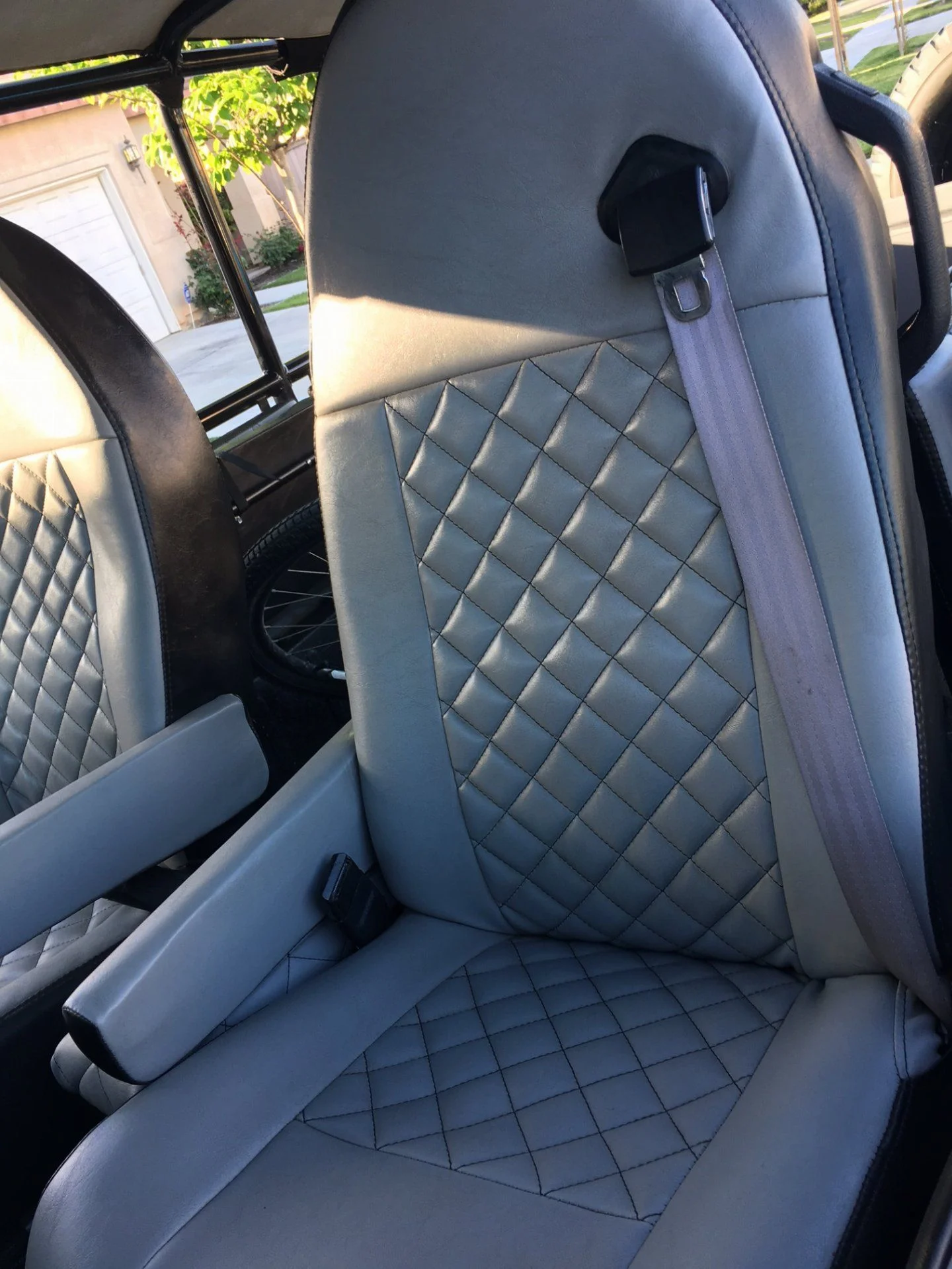

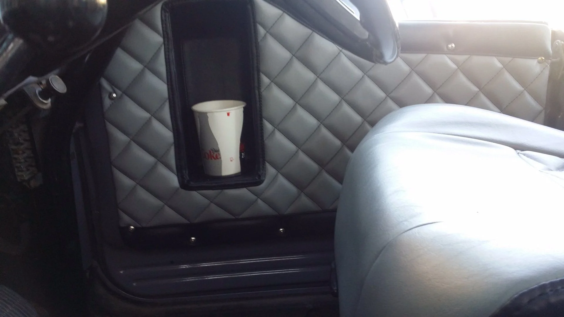

I threw out the factory seats and went with something a bit more comfortable.. I used a marine UV Resistant Vinyl, Fabed up some metal door skins with built in cup holders..
Ford EcoLine Seats integrated seat belts & Arm Rests .. Custom Door skins .. I really like my Diamond design..

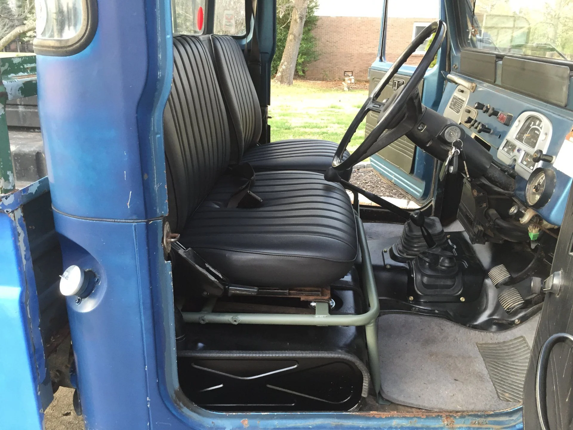

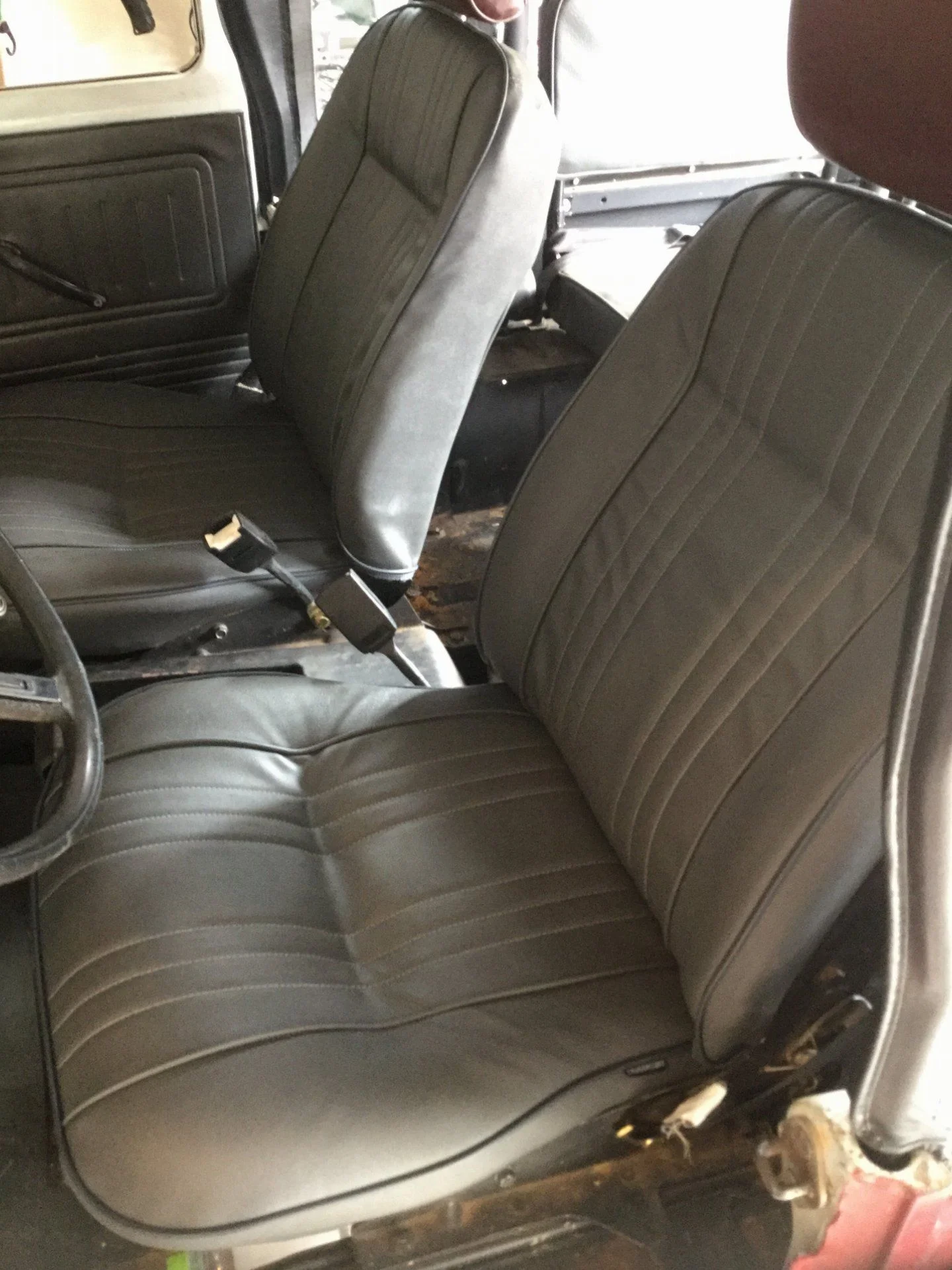

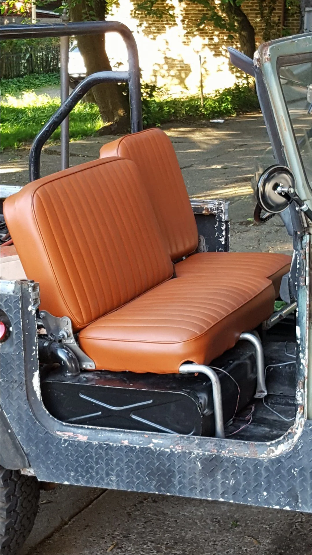

Crappy pic from back right after I finished recovering. Cruiser Corps covers (they ran them on sale a while back) - original foam with some additional upholstery foam added to lowers - wouldn't have the ripples if it was new foam (or if I was a professional) but they are great quality. camera seems to accentuate the ripples - I don't notice them in person.

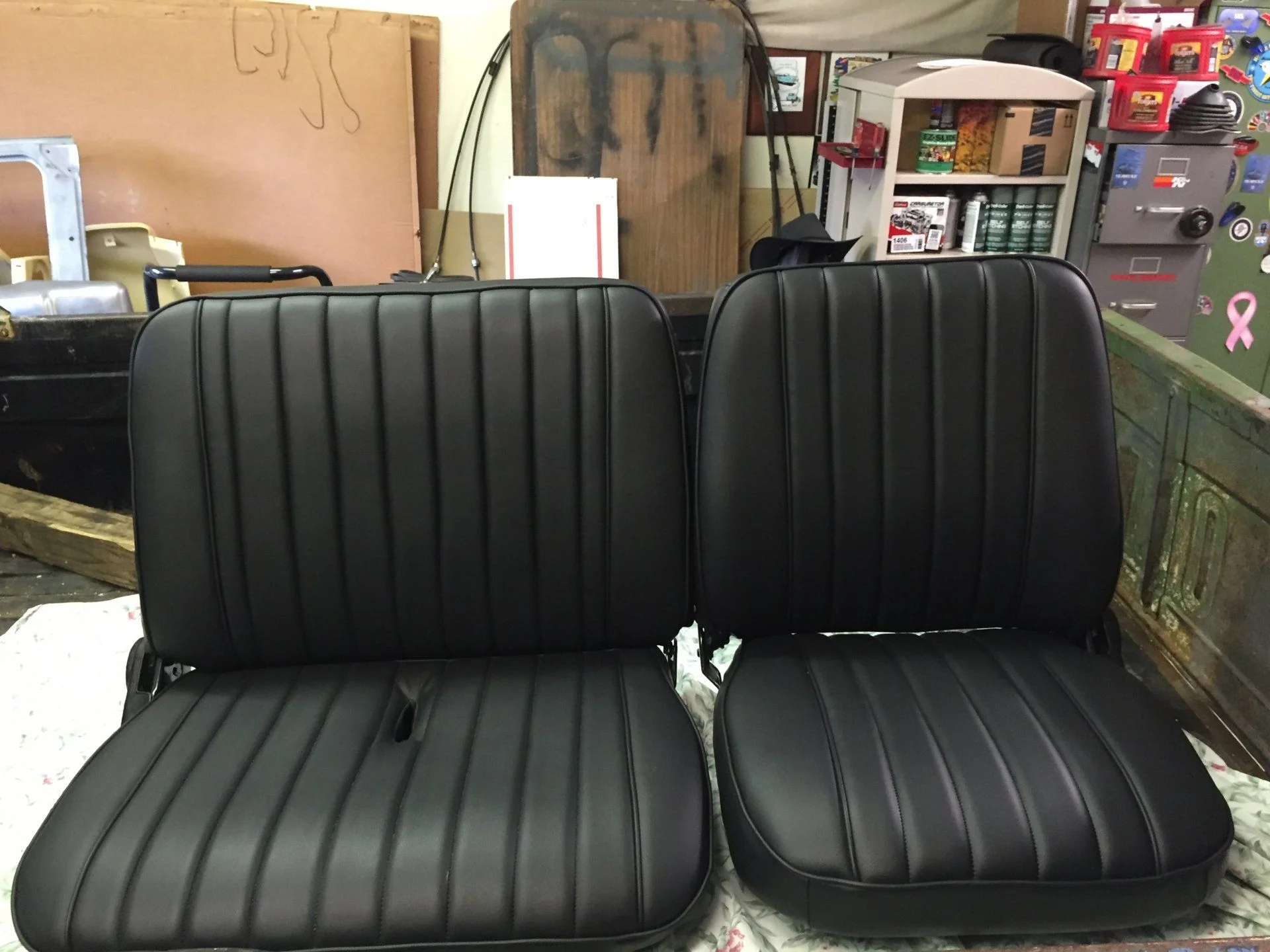

Hey Rigger,

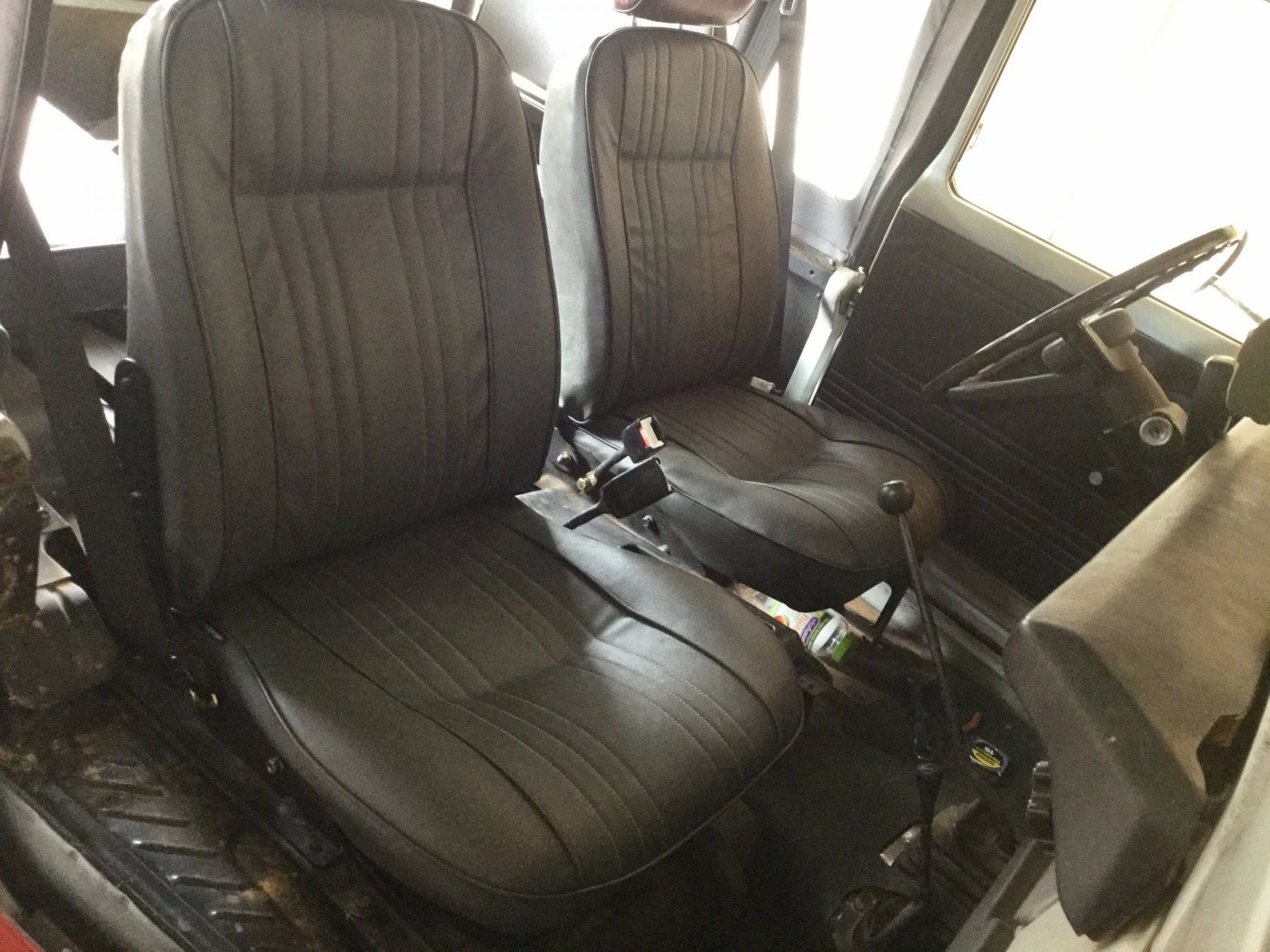

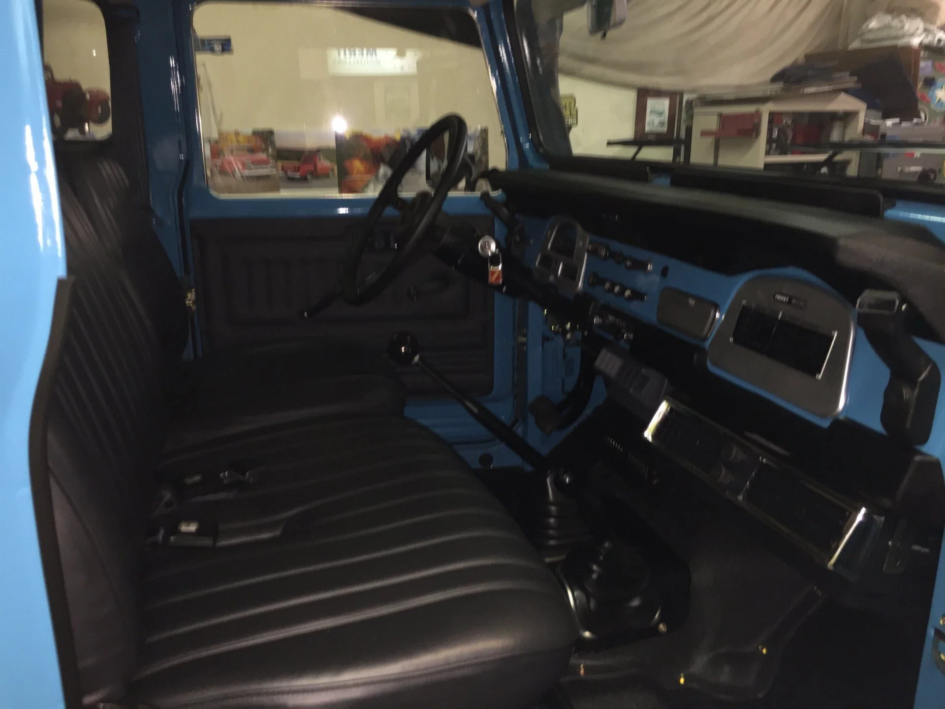

I have a 78' 45 but I wanted 79' and later seats. I found a set of 79' seats that were RHD and converted them LHD configuration and customized the seat mount to fit my truck. I had a local shop recover the seats and add extra foam. I paid $450.00 for the upholstery work.
