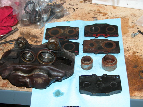

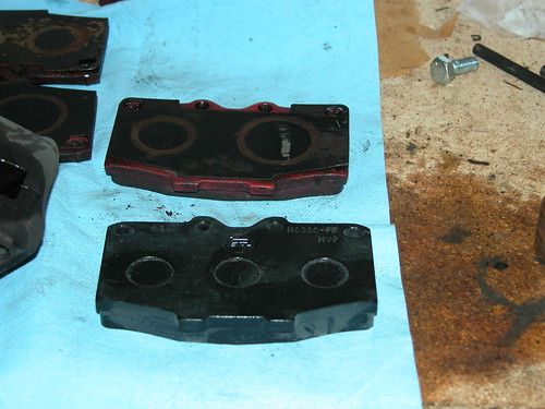

Dove into my calipers this morning and I have a few questions. Never done brakes before so....
1) The old pads have thin metal backing plates on them. My new ones do not. Am I supposed to move the plates from the old ones and somehow glue them to the new ones? Or are the new ones good to go?
I'm super tempted to get my calipers blasted and powder coated. They're going to look yucky next to my shiny brake shields. Question: Powder coating on calipers is cool, right? I mean that *is* the way to paint capliers?
Last quesiton: I had assumed all I needed was new pads. I also got new pins and anti-rattle springs with them. But I did not order a new set of caliper cylinders... 4 of the 8 cylinders I took out are rusted up pretty good; I assume it's worth while replacing them?
Paint is good, high temp caliper in gloss black is easy clean.

Im the anal safety guy, replace the calipers with NEW OE rebuilds from Toyota....

I'm super tempted to get my calipers blasted and powder coated. They're going to look yucky next to my shiny brake shields. Question: Powder coating on calipers is cool, right? I mean that *is* the way to paint capliers?]
I would think that powder coating a caliper would be more trouble than its worth. There are seals which would probably melt when they put them in the oven. High temp paint would work the best.

Unless you feel like screwing around with a bunch of old rusty cylinders and brake calipers I would personally buy new/reman parts. I tried my hand at rebuildling a brake cailper once and that was enough for me. YMMV
I didn't notice anyone answering this, so I'll try.
For my '88 4Runner I used to only buy OEM pads... and Toyota offered a type of anti squeak kit to go with them. It might have been listed as a shim kit... I don't recall for sure, thats just what name comes to mind. Looked just like the thin metal pads in your photo. I always bought the optional kit, and never had brake squeaking problems.
