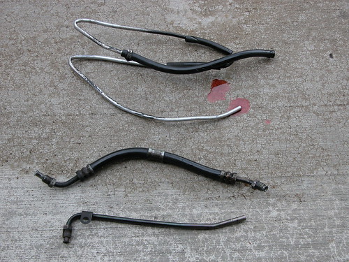

Posting these pics in the hopes that someone can help me source replacements for my
- Powersteering high-pressure line
- Powersteering cooling line (flexible pipe like material)

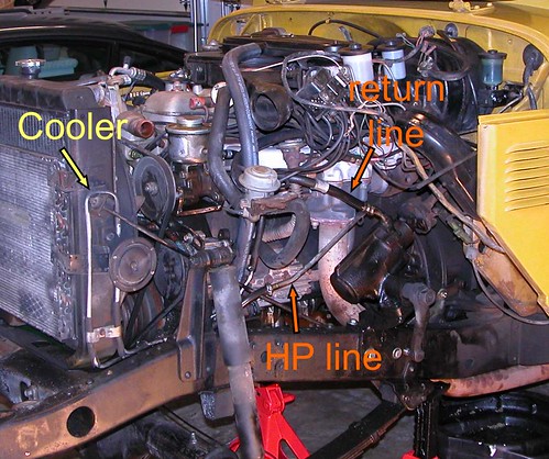

The picture below i labeled the high-pressure & return lines backwards.
I can't use a 79+ cooling line beause my frame does not have the threaded holes for attaching it. So I'm going to just reproduce what CCOT did when they installed the system originall (per the picture).
I've poked around locally and local hydraulic shops have been unhelpful...they don't deal with metric sizes!
Thanks!

The line is fuel line from any good parts store. Tube spec built mine and it looks just like fuel line to me.
I am having 3 return lines made and think I have the HP line nailed down.
16mm or 18mm ?
I'm not entirely sure that it's fuel line. I ordered a return line from SOR the other day (Toyota part) and it felt much harder than fuel line typically does. It's probably something that's rated for higher pressure and temperature than fuel.
From Toyota NO. The one Tube Spec built me is std tube from any parts store., Needs to be softer for them to bend t by hand.

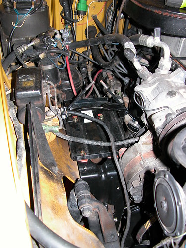

  1. Correctly attached my battery cables & ground strap. Ground strap goes from a bolt on the starter to the frame. Hot lead (red) goes from starter to battery, and black lead goes to frame just in front of the strut brace.
  2. Used Plasti-Dip to coat the arm that sticks off of the battery tray bracket to hold the fuel line. Worked great; looks like it came from the factory.

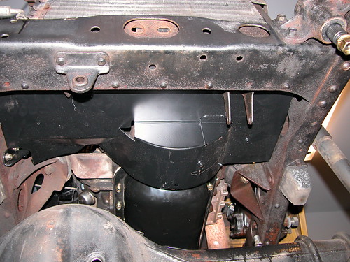

  3. Installed my shiny powder coated battery tray bracket, new battery tray (I made some rubber insulators out of gasket material in leiu of the OEM pads that were originally between the tray and bracket). I also installed my newly powder coated pan that goes under the radiator and belts.

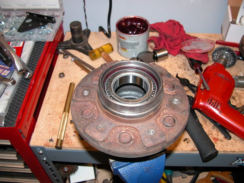

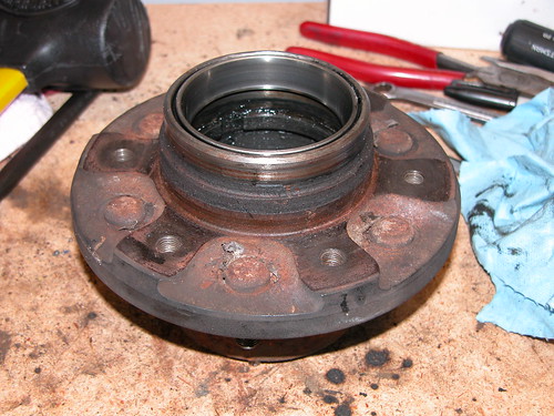

  4. More cleaning and prep on my hubs (the thang the disc is attached to, not the lockable part). First I removed my discs from the hubs so I can get them turned. Then I removed the inner bearings and races and cleaned a lot of the rust and grime. I did not remove the outer races yet because I discovered I didn't buy outer bearings and wasn't sure if new bearings come with races (they do). Hubs are ready to have new races & bearings installed.

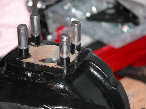

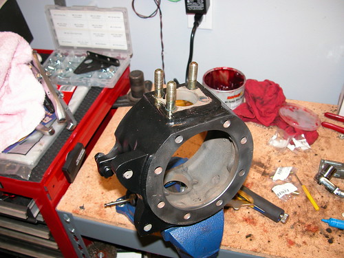

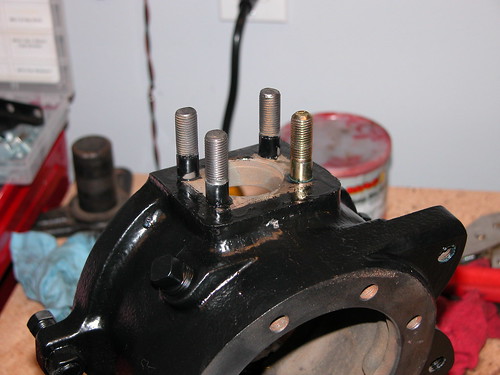

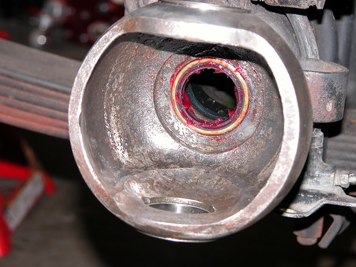

  5. Preped my knuckle housings. The powder coater didn't mask them quite right so I had to wire wheel off some tough powder coat in some spots and add some POR15 in other spots. Replaced a few studs.

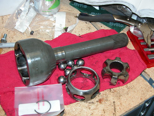

  6. Got my axles (inner shafts and birfs) together. Made a mistake on the first one: didn't have the inner clip in it's groove (see pic) and once I had the outer clip through the spindle and snapped I was hosed. By hanging the axle from my vice I was able to finagle the clip into place. Did it right on the other one.

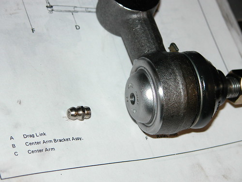

Question: My new tie rod ends came with the grease fittings loose/not screwed in. Am I supposed to put grease inside the ends before putting the fittings on, or should I just tighten them on now and make sure I grease the fittings when I've got the whole thing assembled?
Probably a stupid question, but I just want to make sure.
Install fitting and then clean well! then paint black. If not they will RUST!!!!!!!! Then fill with grease, do not over fill.

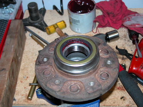

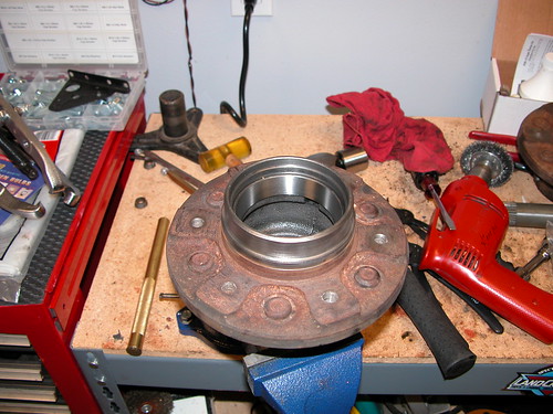

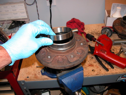

  • I didn't get a chance to pick up new outer bearings from the dealer today, but now that I know they'll come with races I went ahead and banged the old races out and put in the new inner races, bearings, and seals.

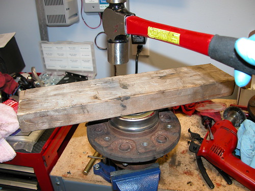

  • Using a brass drift to install the seal didn't seem to work very well. Instead I found that a 2x4 applied pressure evenly and got the job done nicely.

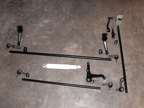

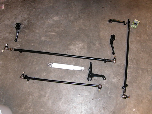

  • Organized and assembled my tie rod, relay rod, an drag links and ends. I need to get new C clamp nuts & bolts; the old ones are crap (several are not OEM and not even metric sized).
  • Looks like I need to figure out how to bolt the new stabilizer in place. The OEM/old one had tie-rod like ends on it and this one just has poly through holes. What should I use?
Are those painted? I can't see that good;)
The rusted set in the pic have never seen outside, they have been mounted for two years in the garage. The one in my hand is OE and they come painted. my .02
