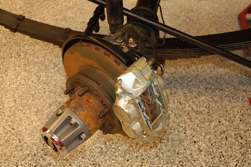

I took the day off and while waiting for Rodney go the new calipers on and took care of a few loose ends...
(The rust on the hubs will be taken care of later, don't fret)

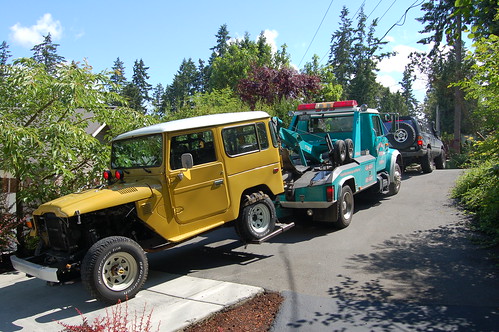

Bull came by this morning and we spent a few hours taking care of little things like getting the skid plates on, the clutch shift fork boot, diff oil, etc...
Then the tow truck showed up and Uglina went to Bull's house for a while...

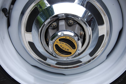

just curious......i am piecing back together my 1/75 frame off and need to degrease and rebuild the front hubs. What degreaser did you use? That's kept me from touching that nasty front axle for a while. All my stuff has been painted and it is time to rebuild........i just don't have anywhere to degrease. Also how did you decide the old Warn locking hubs were thrashed?

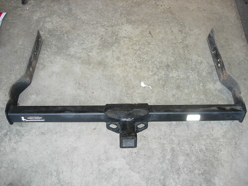

PO installed trailer hitch. PM me if you want to buy it. Make an offer.

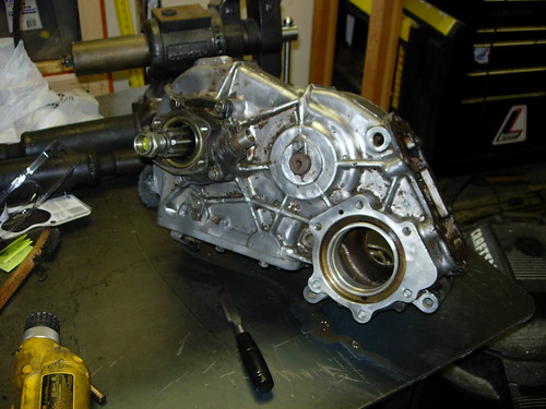

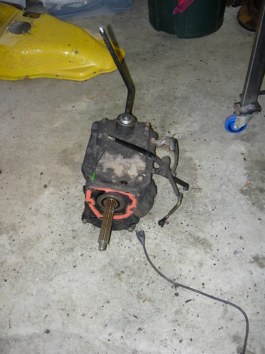

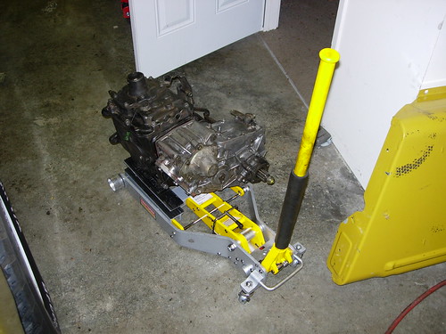

A dirty TCase

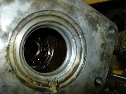

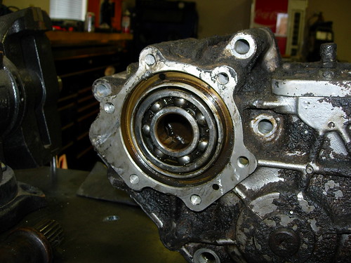

One of the reasons for the leakage. Whoever last put in the tcase forced it in and scratched the surface and actually cracked the seal while putting it in. Bozos.

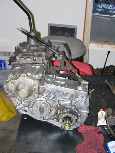

Ugly on the outside, not bad on the inside
After cleaning

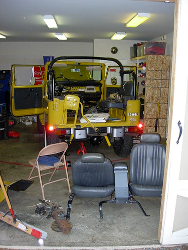

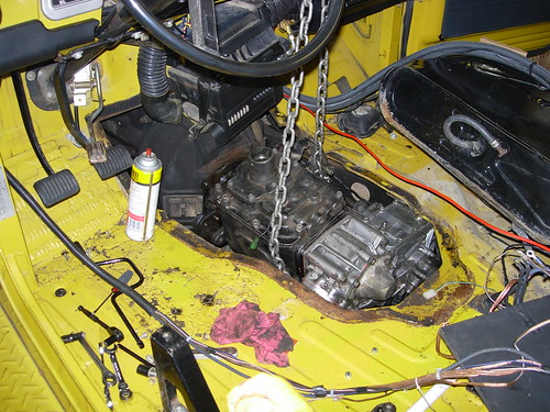

Removing the seats (again) because we had to pull the hump in order to get the tranny back in.
Tranny
Re-assembled and ready to go back in

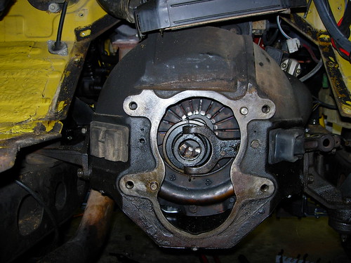

Clutch fork...

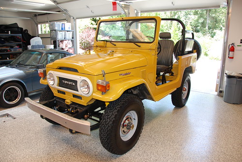

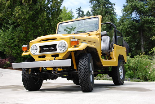

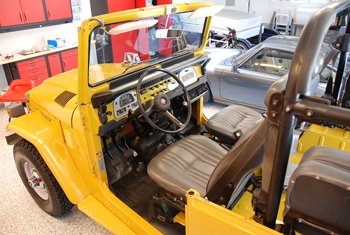

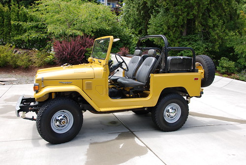

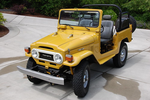

Below are a bunch of photos I took today. As you can see I got my new tires mounted on my OEM steel wheels and hubcaps. I love the "tall skinny" look of these 33x9.5 tires. Like the idiot I am, I only ordered 4 tires so I have not yet mounted my spare. Sigh. The bigger tires, 2.5" lift, and the 3.73 3rd members have changed her personality a great deal. Before she was really bouncy (jolt-jolt-jolt) but now she has smoothed out. The gearing may be a bit tall for hard-core off road work, but that's not why I have her.
I gave her a once-over with some wax and elbow grease and she shined up nicely. Glorious day here in the PNW; great for photos.
Still trying to ID a slight coolant leak and my e-brake is still dripping a little oil. Have a speedy sleeve on order for that.
Idle is too high and I occasionally get over-run, but otherwise she is driving like a dream.
I have a tailgate on the way and my paki-half doors will go on asap...
