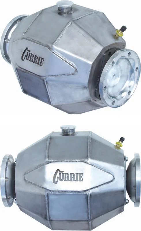

well if you did do ifs currie has the part now
Currie Enterprises Racing Rear End Categories
that is a 9" set up for ifs applications. Shannon campbell ran one on the front of his ifs rock racer in the 2009 KOH. (he was disqualified but the the ifs 3rd did not break running hard on the Hammers)
how hard is it to install? Major fab work?

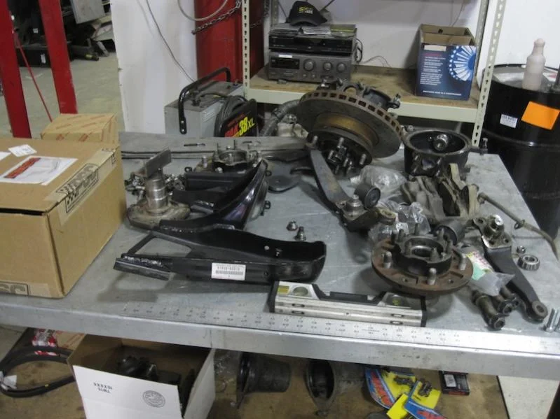

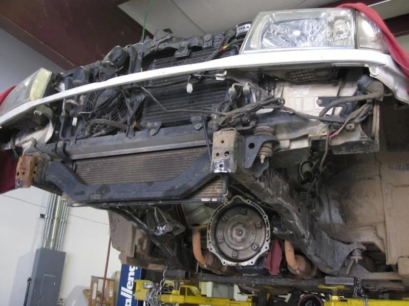

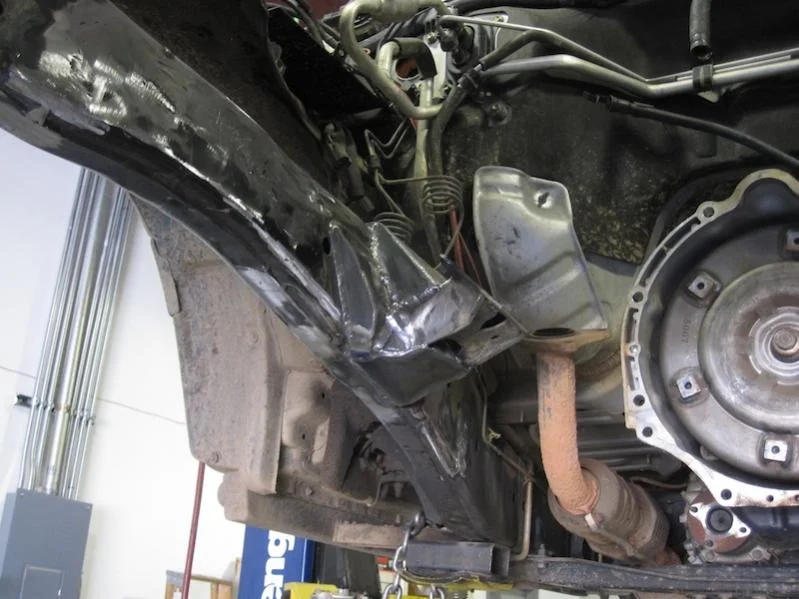

ok, I wont leave ya hanging. All this goes in there, plus a motor mount after everything else has been shaved off.
This was last week, as Joe was finishing up a 80 motor and was getting ready to proceed on this project. I'll leave everything else to Christo.

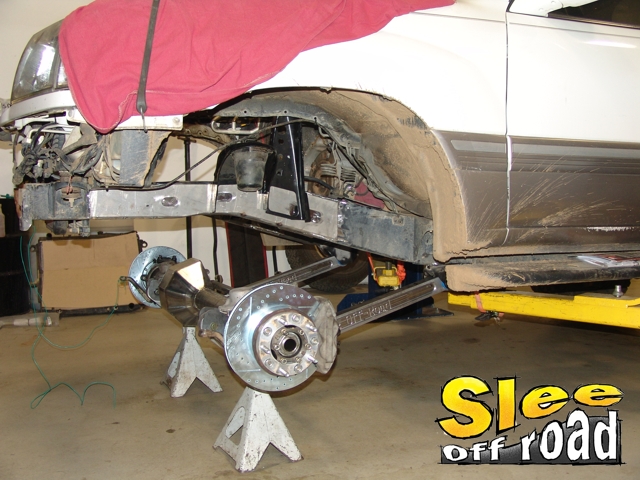

Updated pic. Axle located. Starting with fabrication of all mounts etc etc. Now the fun starts and one sees the progress.

I do not have the total on all the parts yet, but it is not cheap. Once I have all the prices I can total it. The diff with ARB and gears was about $3k. The housing is about $1k and that is bare without knuckles, axle shafts, birfields brake components etc. We also imported some 105 parts, that was not cheap either. I would not be surprised if the total for the axle is around $7k.
