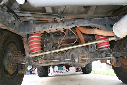

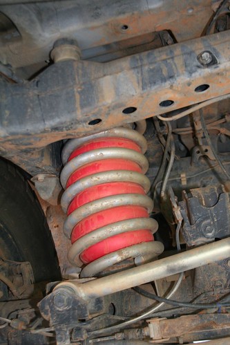

Due to the extra weight I add Airbags to the springs to level off the truck.
Untitled by pesimsmd
This is before the airbag
see how low the rear end is
now with the air bags, a much better stance. Airbags at 50PSI

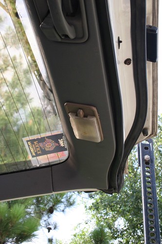

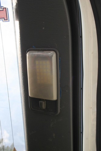

Was not finished yet. Put LED light in throughout the who truck. Also placed LED lights on the Upper rear hatch, to give some light to access the drawer system.
Untitled by pesimsmd, on Flickr

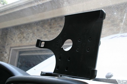

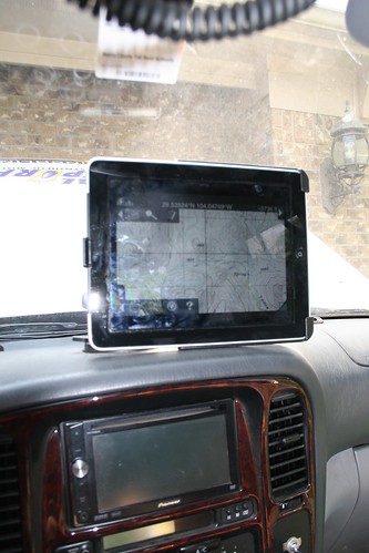

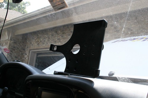

I also got ride of the lap top for use of the iPad. Bought a ram mount for the iPad and it works great.
With all of the GPS and Mapping apps it really works well. It also frees up room for the passenger.

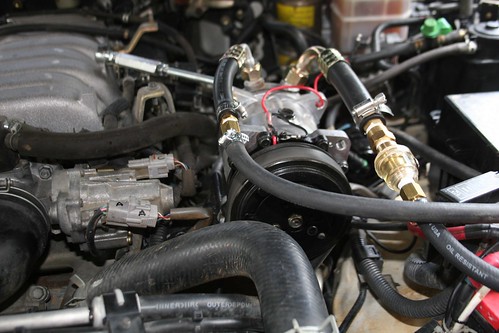

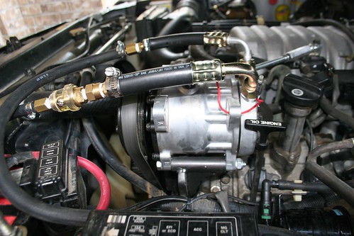

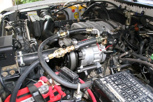

The final mod placed on the truck was Spressomon onboard air with Sanden compressor As of now it was a great investment. When we where at Big Bend National park we ran out of CO2, due to a air leak.. Now I don't have to worry about that ever again. I am still plumbing it up, but it works great. It took 2 mins at 750 RPM to air up my 36 inch KM2 from 8 psi to 36 psi. Not bad.

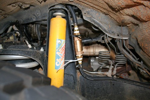

check valve

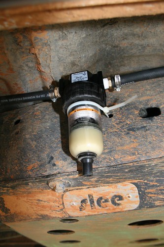

Oil Filter

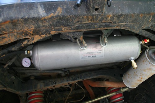

2.5 gallon Via Air tank where the spare tire sits
Still need to install the pressure regulator, and a drain plug and plumb a fitting to the front of the rig for airing up the front tires.

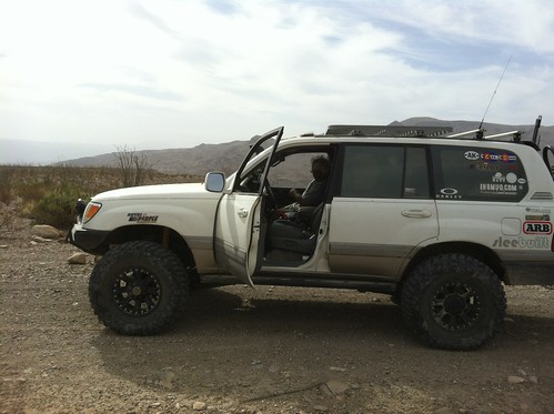

Some more shots out in the wild, Alaskan Rainbow, our trip to Big Bend National Park.
