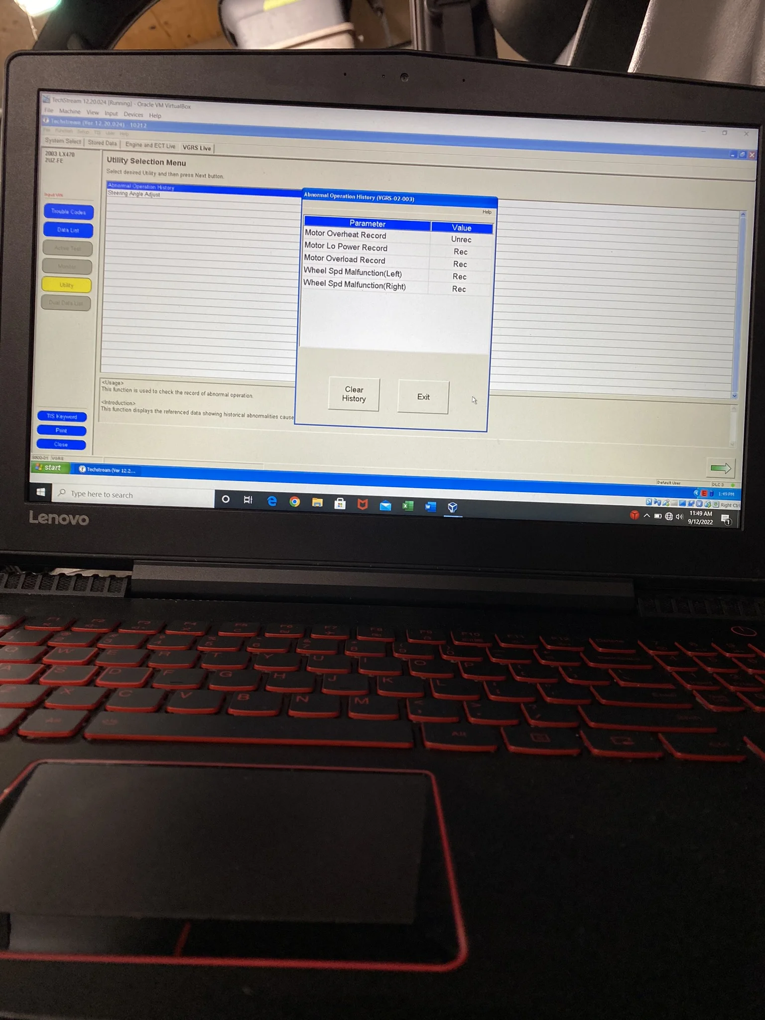

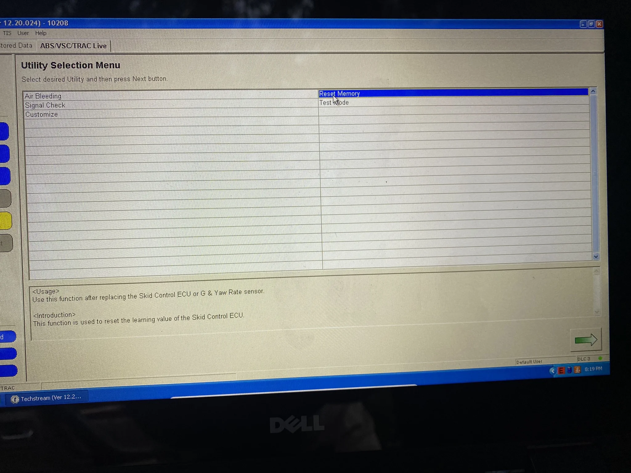

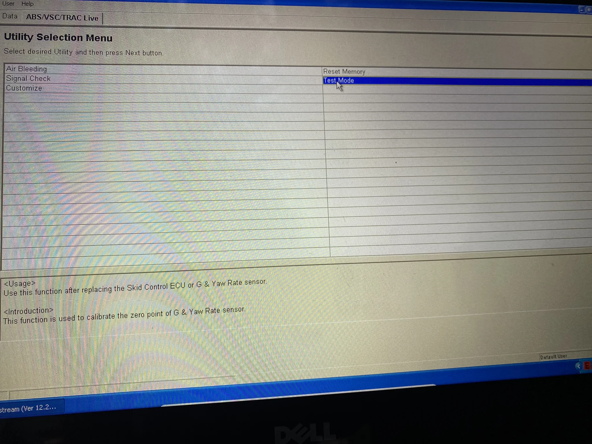

Make sure to: Go though tech stream, VGRS and calibrate steering also. You clear all DTC and all flags first.
It was sitting completely level in the garage for this
Good.
Reset
Then ZPC

I'm new to techstream so your screenshots are CRUCIAL. THANK YOU! I will get in the garage tonight and give it another go. I did not do the steps you outlined so I'm hoping that clears the false 1150 reading from the new SAS.

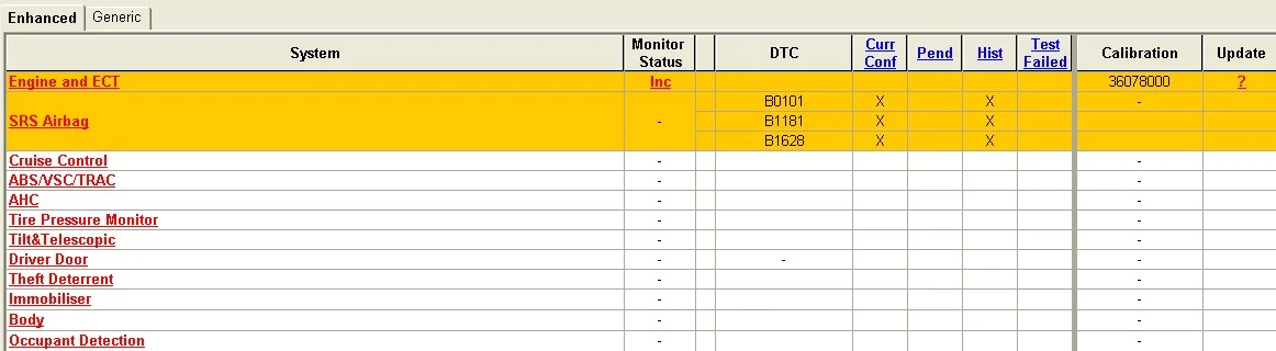

This time I did a full health check on all ECUs, got a few obvious ones for the airbag since it's not installed at the moment. Cleared all DTCs, checked all ECUs and there are 0 active DTCs. I ran the ZPC again and it completed. Then I ran the test mode. It made the VSC light flash, but the ABS light stayed solid. The steering angle sensor is still reading 1150. I guess this new-to-me ebay SAS is broken too? IDK. The ABS light didn't show up until I plugged this one in. I've got an appointment with Toyota in a few weeks but I'd like to have this sorted before then so I can wheel. Roads just opened up! I'm about to put my old SAS on just to see what, if anything changes. At this point I've replaced the entire SAS/clockspring assembly and I'm STILL not back on the road.

No steering angle sensor DTC present in your screenshot. Perhaps, it will pop up when you drive. But first, best to deal with DTC you do have.
First:
I would work to clear these. It seems you've an airbag issue. Since working on steering wheel. It would be likely, a wire not properly connect or procedure not followed.
I always, record and then clear any DTC. Then see what comes back. (Note: The Engine and ECT, has to do with update the Tech stream software "NO DTC present" )
