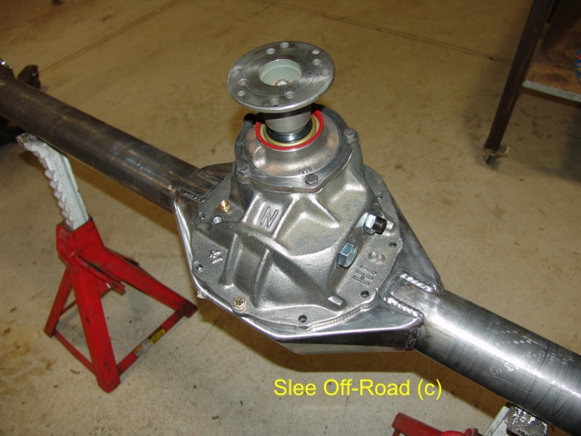

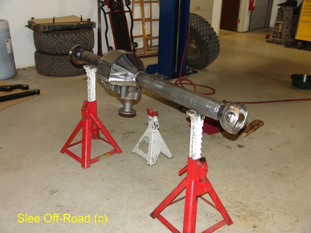

Some eye candy for now. Probably no picture updates from this until Jan when I am back from SA.
Housing and diff came in.

Diamond axle, with True Hi-9 center section, ARB and 4.88's. Hybrid 80/105/100 outers to retain 5 lug setup with 100 brakes and if all works out right, the ABS as well.
35 spline?
