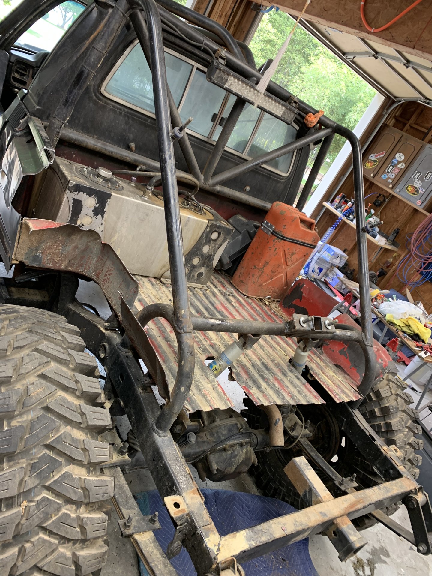

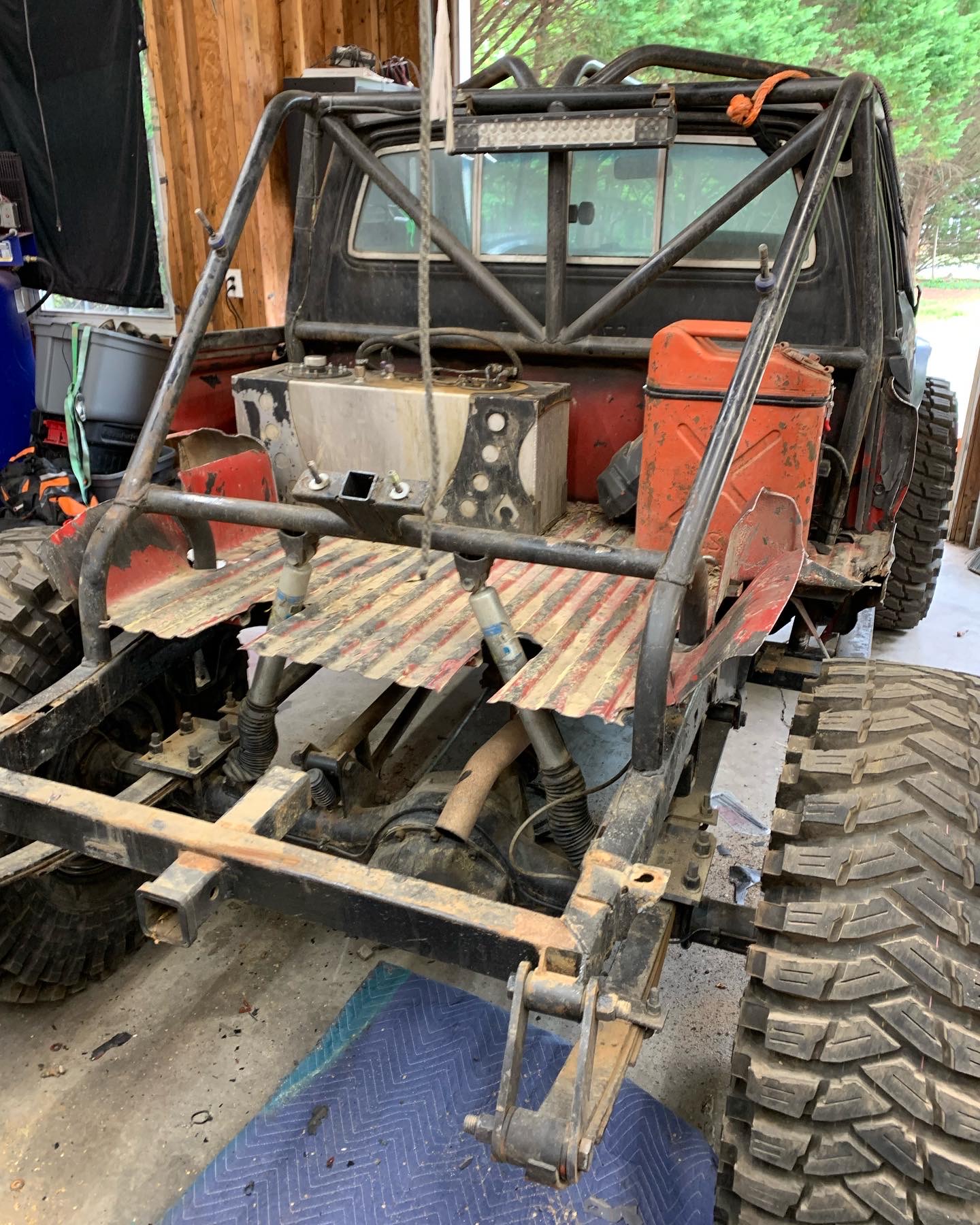

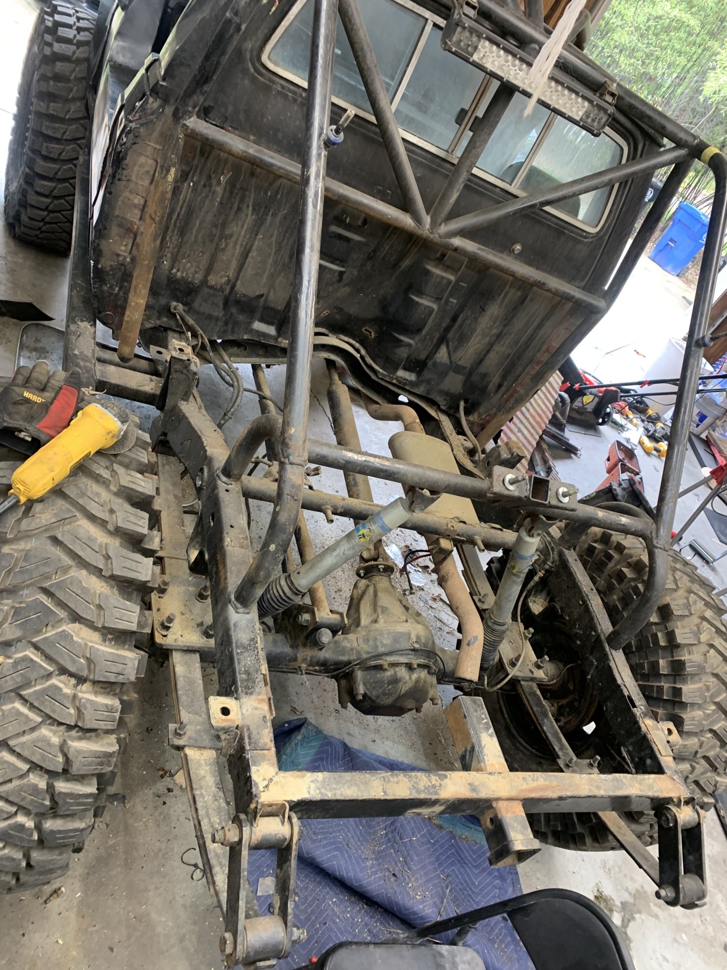

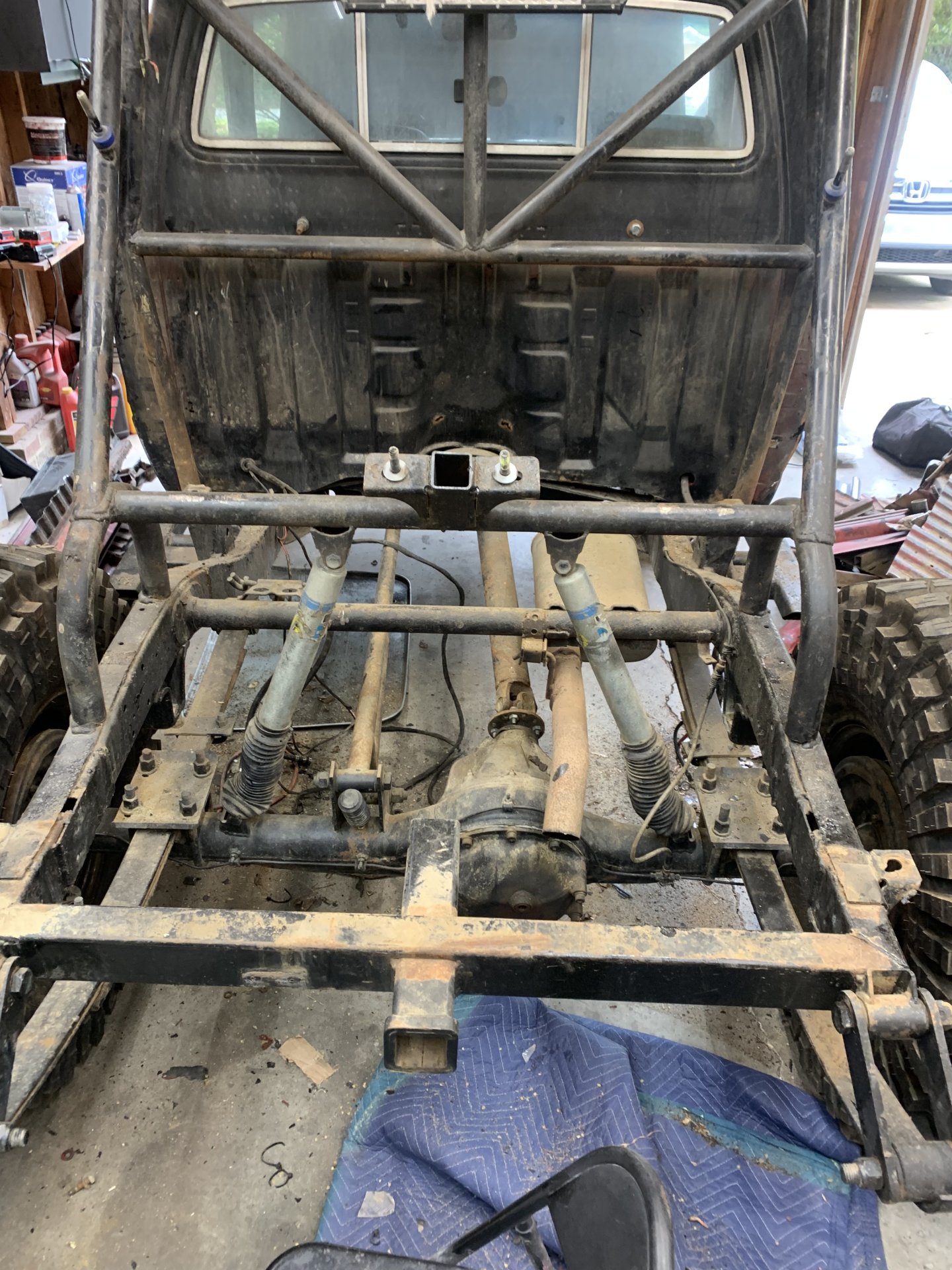

30 min into truggy transformation.
Building something more stout and practical to be able to carry tools, spares, fluids, 40” spare, recovery gear and other miscellaneous crap for the trail.
Took some quick measurements and started cutting. Don’t have a plan, just winging it and going to work around the tubing that is already there.

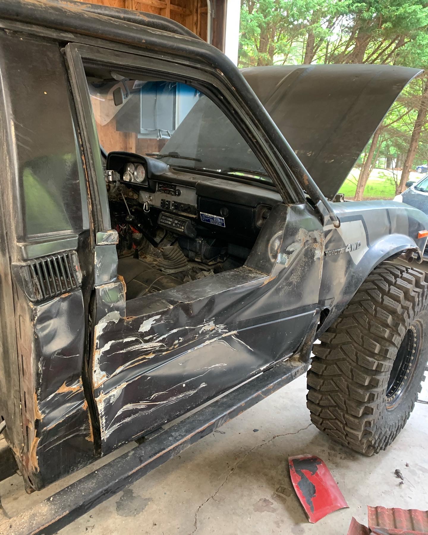

Get the rest of the bed off today. Going to pull the busted up half doors and make new ones. Also going to spend about an hour on each B pillar with the dent puller and straight then out. Not make them perfect, just better than they currently are.
Also going to either pull the front fenders or just cut them more to keep the 40” tires out of them.
I’m also going to cut those two diagonal bars. They kind of limit the full use of the whole bed. Might try to Incorporate them somewhere else but I’m not worried if they don’t make the cut.
More progress next week.
