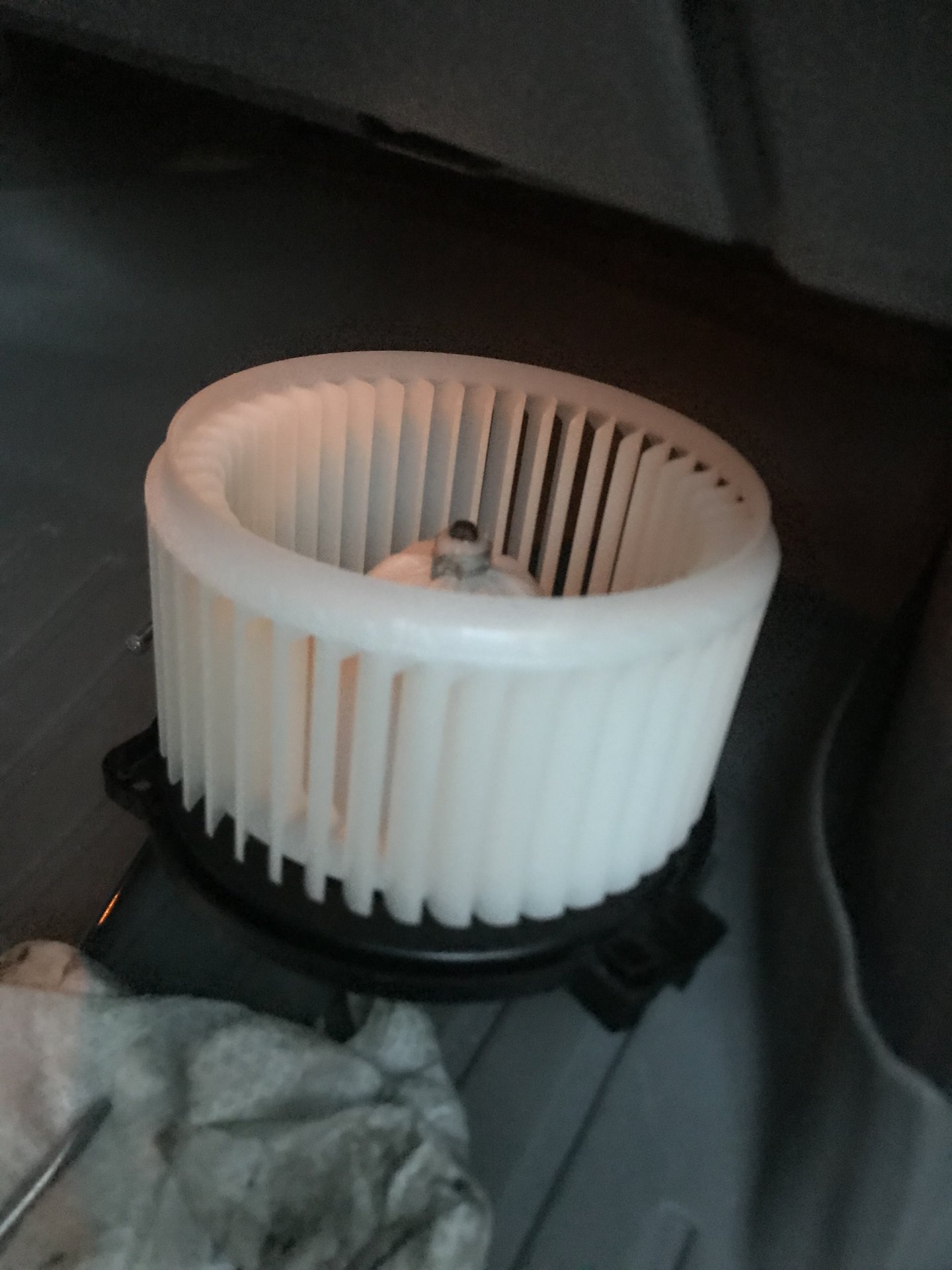

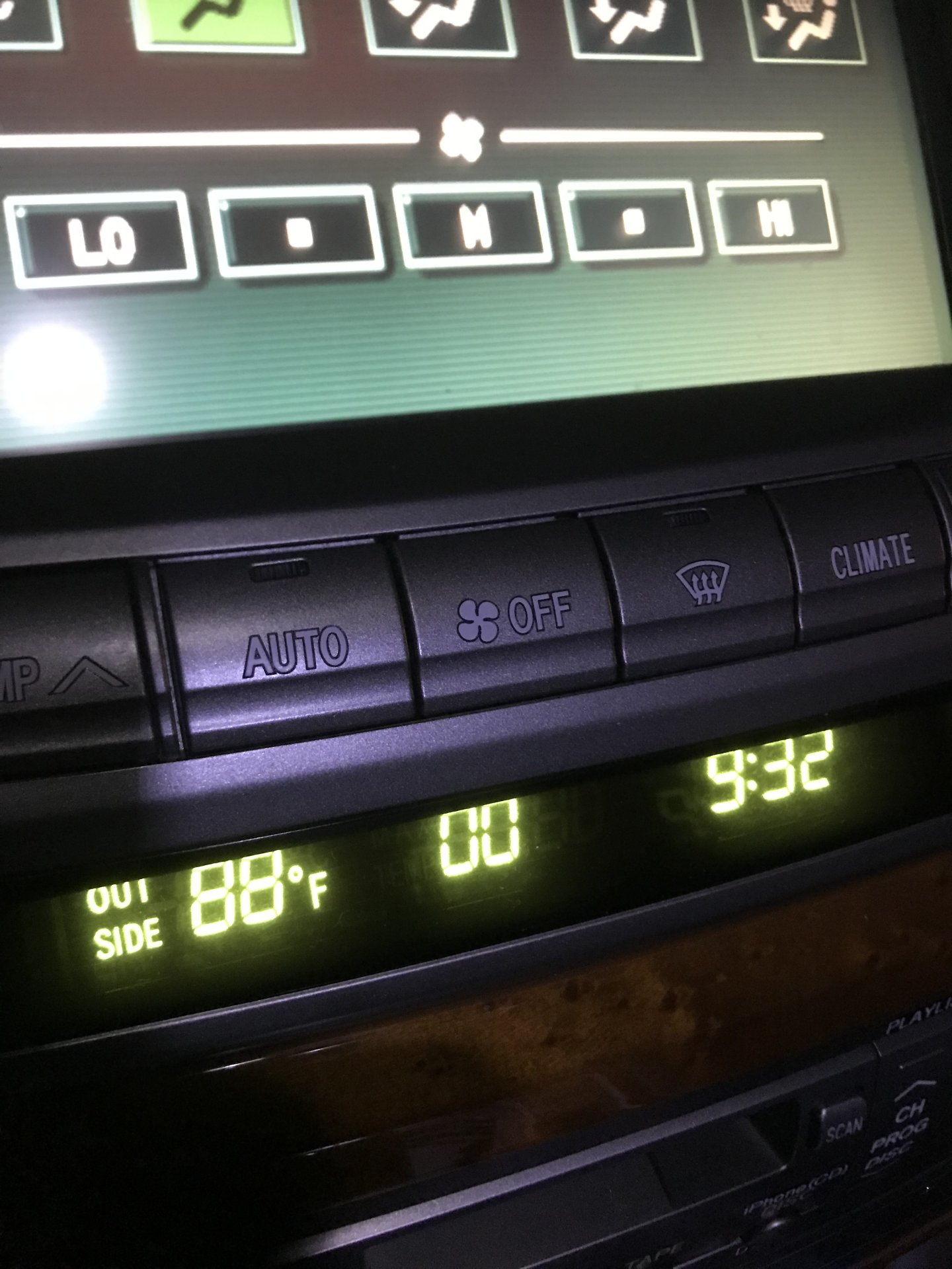

My AC on the LX470 wasn't working so had Scott Clark Toyota evac, recharge and leak check. No leaks though????
Blowing cold now but it was not distributing as much air as I remembered. I noticed that my foot blowers weren't working.
Carpets were in the way of the outlets.
After tucking them back under it still wasn't coming out of the foot vents. So much for the easy win.
AC diagnostics didn't show any problems either. I Ohm'd out the 3 temp sensors. All in speck. Driver front temp sensor was dirty. Cleaned it up.
It turns out the foot ac/heat damper was spring loaded closed due to the servo actuator rod being disconnected. So I hooked it back up.
I also vacuumed out blower box, replaced filters and cleaned out the squirrel cage.
It's nice to have cold ac again!
Henry is having the same problem with his LX470; I hope it;s the same solution.
I hope too. Its either the carpet and or the servo arm disconnected, the servo is shot or the AC Amplifier. I hope it's the easy fix for him too.
