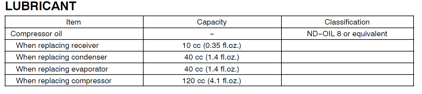

I got my brand new Denso AC compressor in the mail today, and I plan on installing it tomorrow. But I am confused as to how to determine AC oil. I don’t know if my compressor shipped with or without oil and how much.
yes, they have to recover the Freon from the system to open the line and inspect. then pull a vacuum and recharge the system to return it to operational state. that process takes some time.
that is a loaded question. i'm not a a/c guy Roxx can provide a better answer. but, if was doing it and wanted to know how much oil to add.
i would take the old compressor and drain it into a something you can measure. in ml. see how much came out
then drain the new compressor and measure what oil come out if any.
you can drain them from the suction port. might have to spin the compressor pulley come to help vacate the oil.
i am sure you lost some oil that was mixed in the Freon when it escaped and if you replaced the dryer/receiver that might be another 10cc. if you replaced any other parts there will be trace oils in them as well. if you have had a few leaks then even more oil might have escaped.
i would probably poor in oil to the amount of somewhere between what you recovered from the old compressor an the 120cc indicated on the factory chart below based on what i didnt touch.
