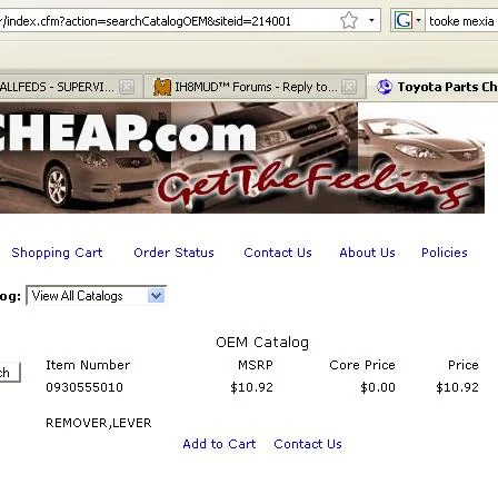

I ran that part number in Toyota's database, 11 bucks. Think it's the same?
