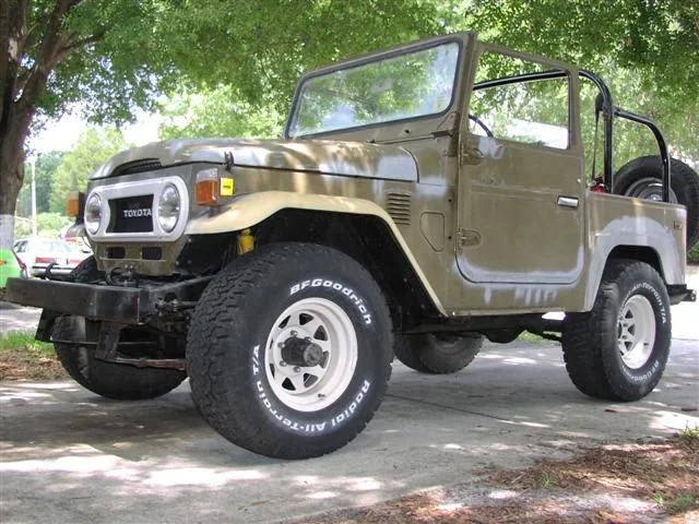

Here's what I started with:

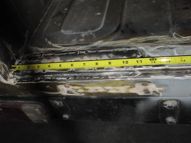

I wasn't sure what was under the previous repair work - so I bit the bullet and decided to cut out all suspect metal and weld in new pieces. I planned to yank the entire sill and most of the rear quarter panel sections. I did some research and saw a layout for a brace to keep the alignment of the rear sections while work was being done. Knowing that I would be doing a fair amount of metal work I also picked up a HH140 MIG after witnessing the magic done with this same machine when wielded by Buckroseau. So far it has not let me down.
With the brace welded in place I proceeded to remove the rear sill and quarters. The sill fought me a bit but in the end you see who prevailed. The trick is to drill out the spot welds and then use a chisel or wedge to seperate the panels. Dewalt makes a "Pilot Point" set that works great. Don't waste your money on those high prices spot weld bits - these work like a champ. Essentially you drill a small pilot hole then follow it up with the pilot point bit - easy.

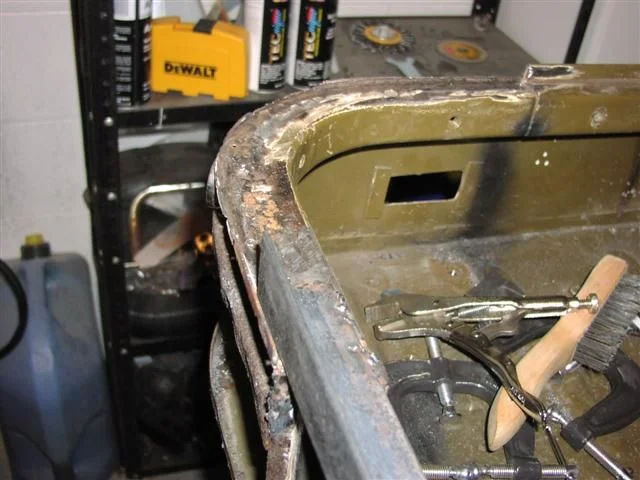

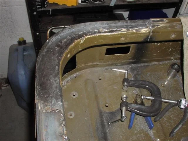

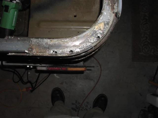

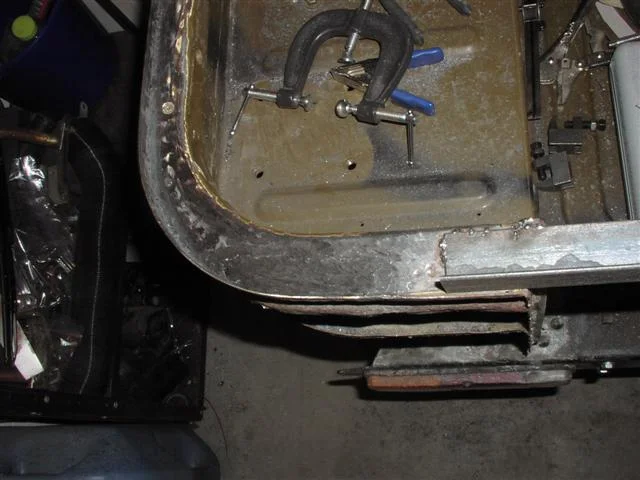

Next up was the rear quarter rails. The driver's side rail lip had some rust through in a few spots, so I decided to cut it out and fab up a new piece. I'm using 16 guage cold rolled steel for all repairs unless otherwise noted. This is the same thickness as the original sheet metal. I don't have the luxury of owning an uber-fancy metal-fab shop, so all this is done by hand in my garage at this point. The first pic is the lip removed - cut out with a sawzall. Second is of the replacement lip in place. Still have more grinding to do at the time of the pic:

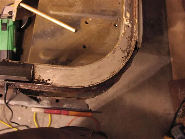

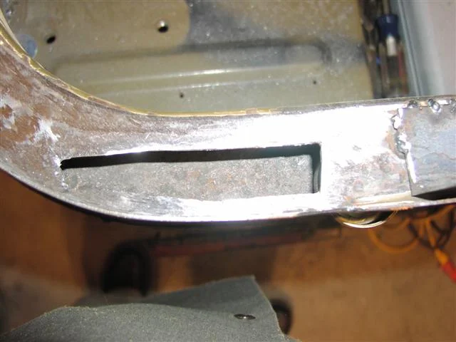

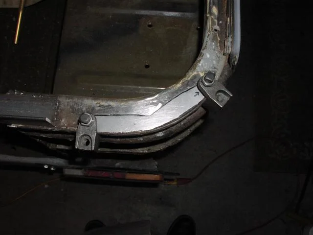

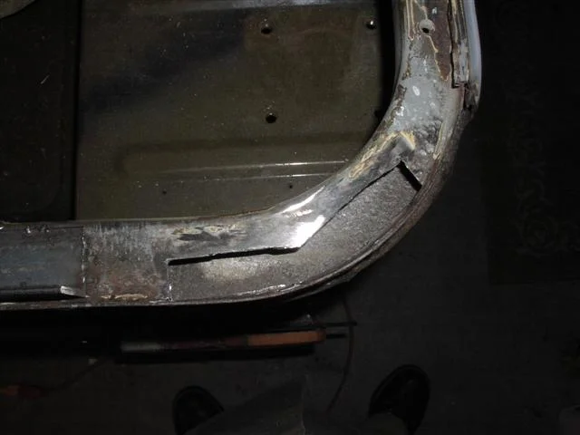

Next up was to cut out some compromised sheet metal in the rear driver's side rail. There were a few small pencil eraser sized rust holes in each of the rear top rails.
Driver's side rail - section removed

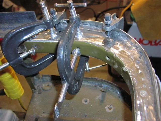

Driver's side top rail:
1) New metal in place ready for tacking.
2) Welded in and the welds ground down.

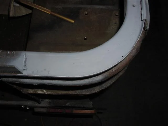

3) Repair is primed with self-etching primer. End repair could use a skim coat and then it would be perfect. I will probably do this before final paint.

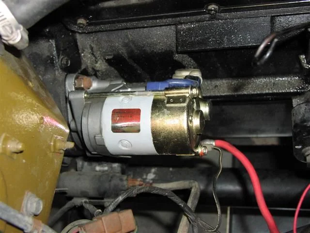

Did some research and a lot of folks seemed partial to replacing the stock FJ40 starter with a newer gear reduction unit. I decided to see what all the noise was about and sourced one locally as my original starter would grind every once in a while. As luck would have it, I picked up a Toyota factory reconditioned starter for $75 - I felt good about that price and installed it. Following the install, I noticed that the engine spins up much faster and fires up almost immediately now. I am pleased with the updgrade:
