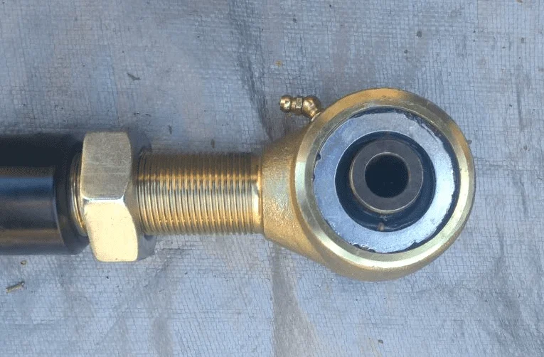

On the lower arms, the rearward mount (not the JJ), does the greak zerk fitting point up to the body or down to the ground?
In the middle of install of these now. I also shot a PM to Jason, just looking for a quick answer.
I would think they should be rotated up to protect them from getting ripped off by ledges and rocks. You might have to do what I did with me front UCAs which would be to replace the "vertical" fitting with an elbow 90 degree fitting so you can get the grease gun onto the fitting.
Just installed this weekend with 45 degree zerks.
That gives a straight shot in from the top.

@OwnerCS do you happen to recall what the thread size is for these fittings? That is super smart conversion.
