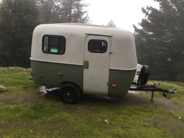

I've been driving my fj40 for 6 months across the USA and Mexico and now I wanna drive across Canada.
I am contemplating getting a small trailer that has a bed and maybe a small kitchenette . Something like a Boler or any 13 +/- foot RV
What I'm wondering is, has anyone used their fj40 to tow a trailer? Tow capacity issues? Any tips or concerns? Do we have to have trailer breaks even if it's a small trailer?

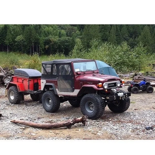

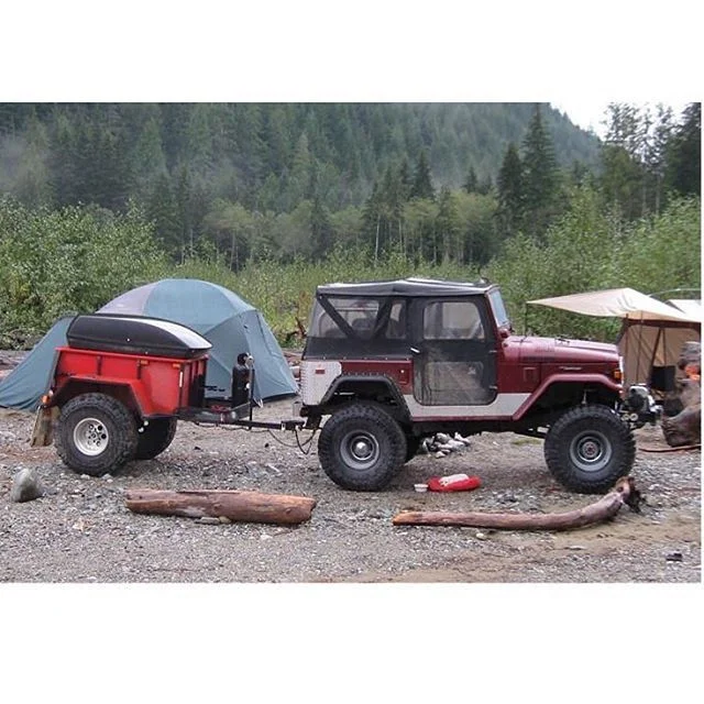

Short trailers i find harder to tow because they react/over-react quickly. Reversing is a PITA, and requires practice, and patience. Both of those trailers pictured look light and doable for a 40.
I need pics of your FJ40 to make a professional assessment. lol
I towed 19 Ft. fully self contained for three years to all wheeling runs. Small trailers like you are showing above would not be a problem, probably even without trailer brakes. I believe size/weight of trailer determines if it must have brakes or not??? Sooooo, here's the deal- - -you have a short wheel base vehicle. That means what ever the front tires do reaches the rear tires much sooner than with a long wheel base vehicle. This means any jerks/turns of your steering wheel react much quicker on the trailer, so you must make slower, more gradual moves of the steering wheel when towing- - -you'll get the feel for it fairly quickly. Also, with heavier trailers double axle trailers tow much smoother than single axle trailers. Single axle trailers just bob up and down on your trail hitch ball, jerking you up and down as well.

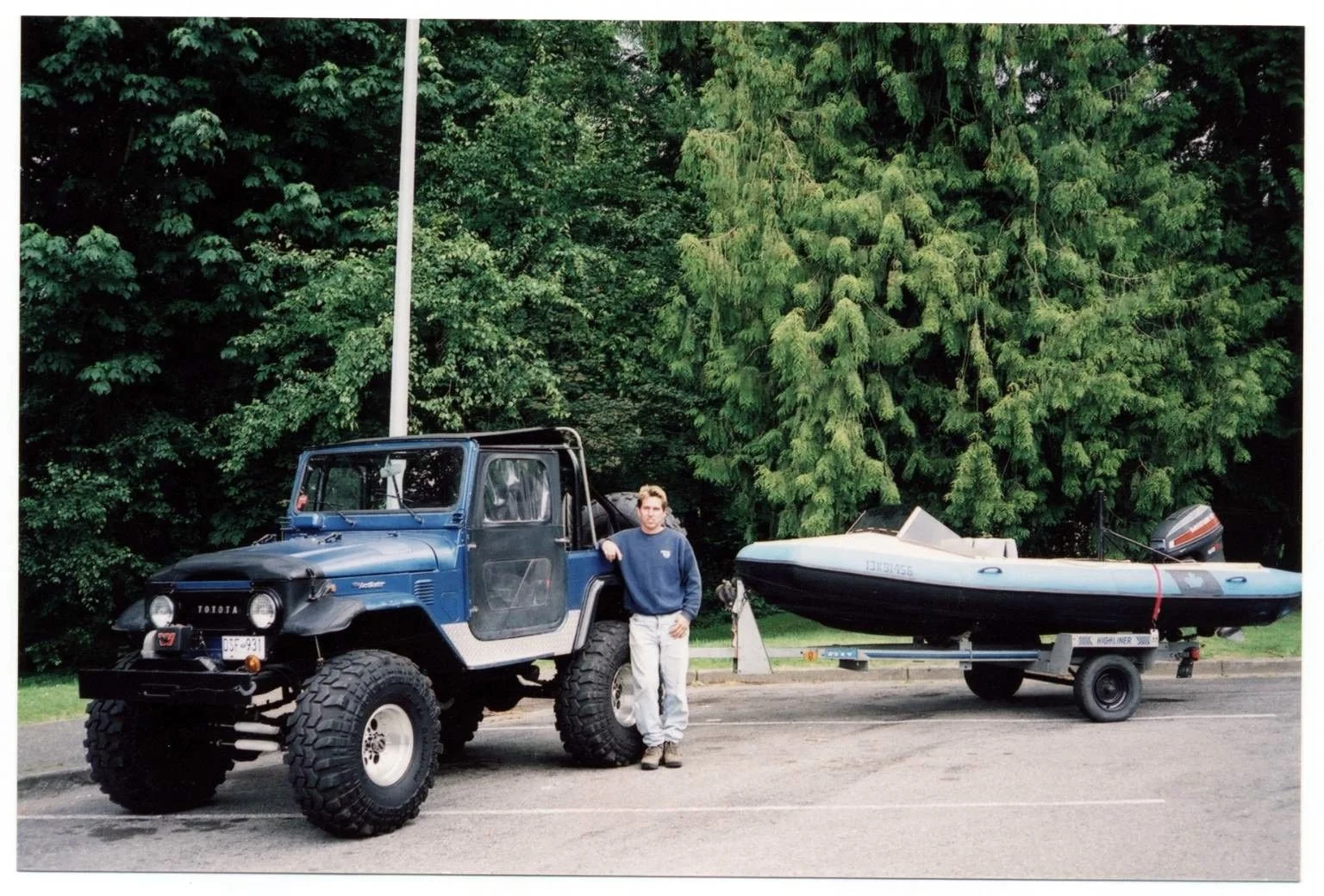

I used to tow my old 16ft rigid hull inflatable with 60hp outboard 800km trips one way no trailer brakes. Never had an issue.
Fuel consumption was an issue though, I never enjoyed pulling a trailer with the 40. Here are a couple old pics. For the fun of it
