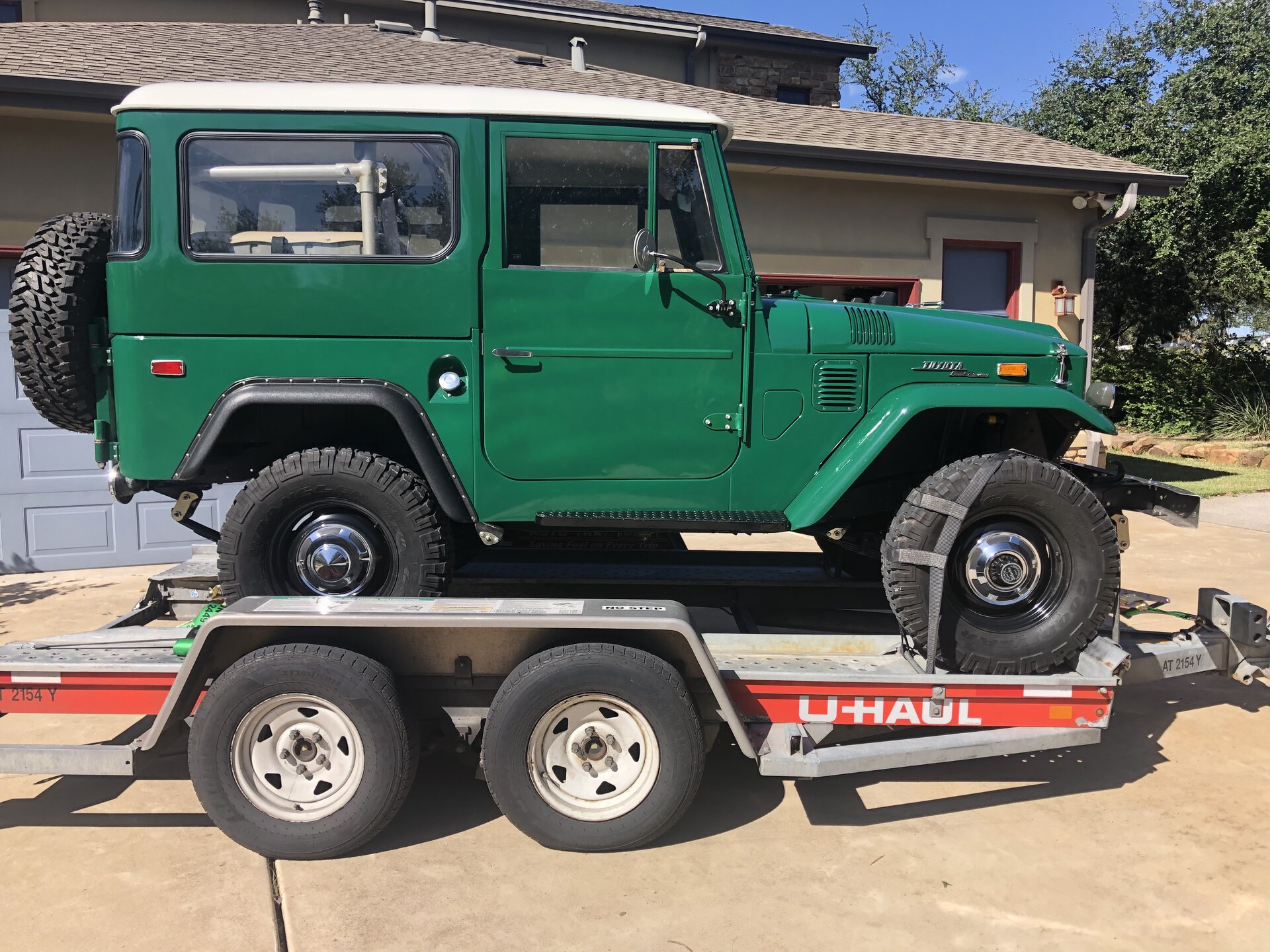

You might want to consider renting a U-Haul car hauler trailer. You could possibly do one-way if you end up leaving the 40 at the shop. We rented one to move ours and everything went smoothly. Pulled with a F250. Pretty inexpensive as I recall.

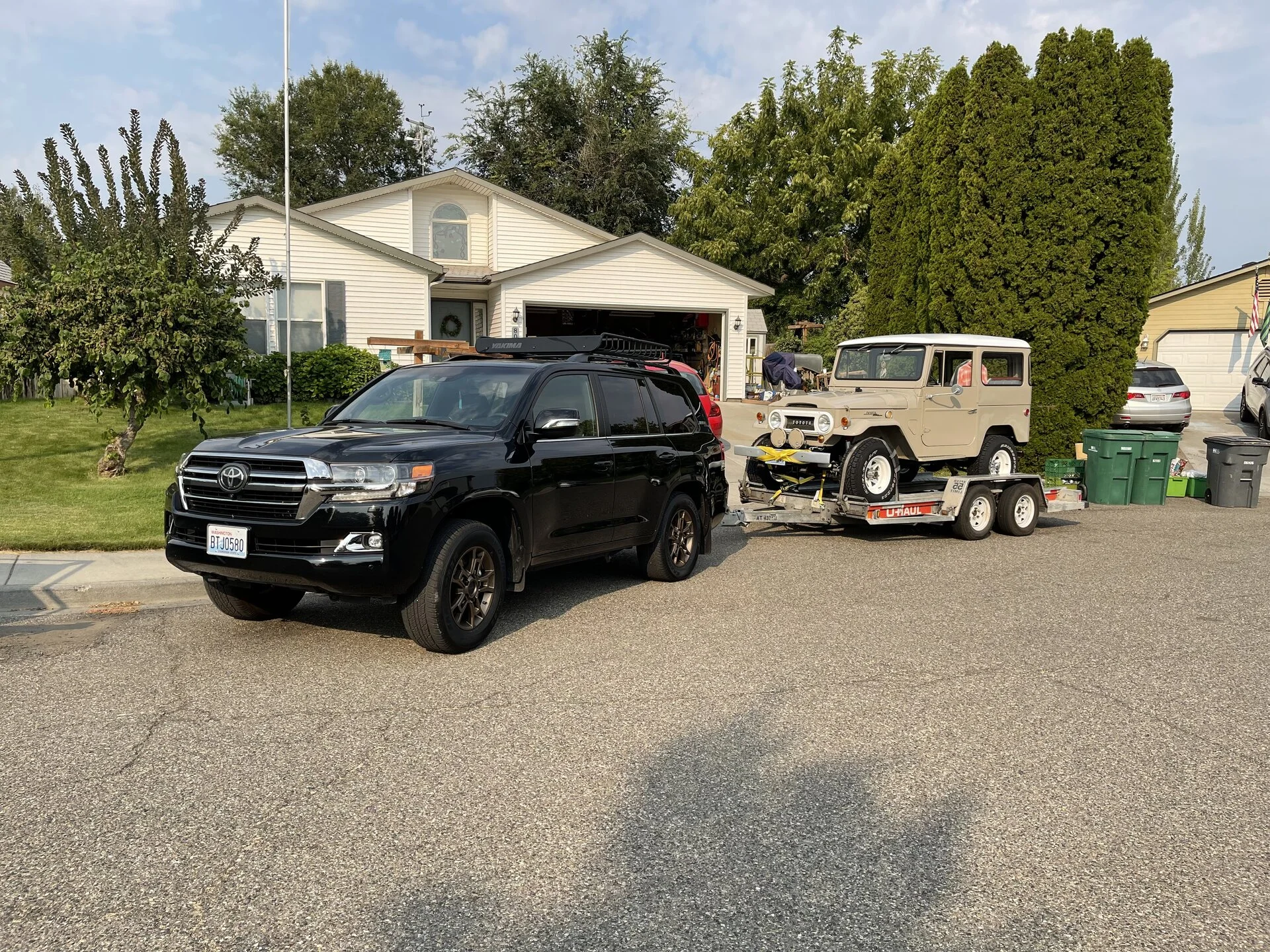

Yep, U-Haul it. If you flat tow, remove the rear drive shaft. The F150 should do fine, plus U-Haul will make you enter the tow vehicle and what you’re putting on their car hauler to verify it’ll pull it safely…..to even rent one. I pulled my 40 with a 200 Series LC from central Washington to SLC Utah……a little squatty in the back, but did fine.
