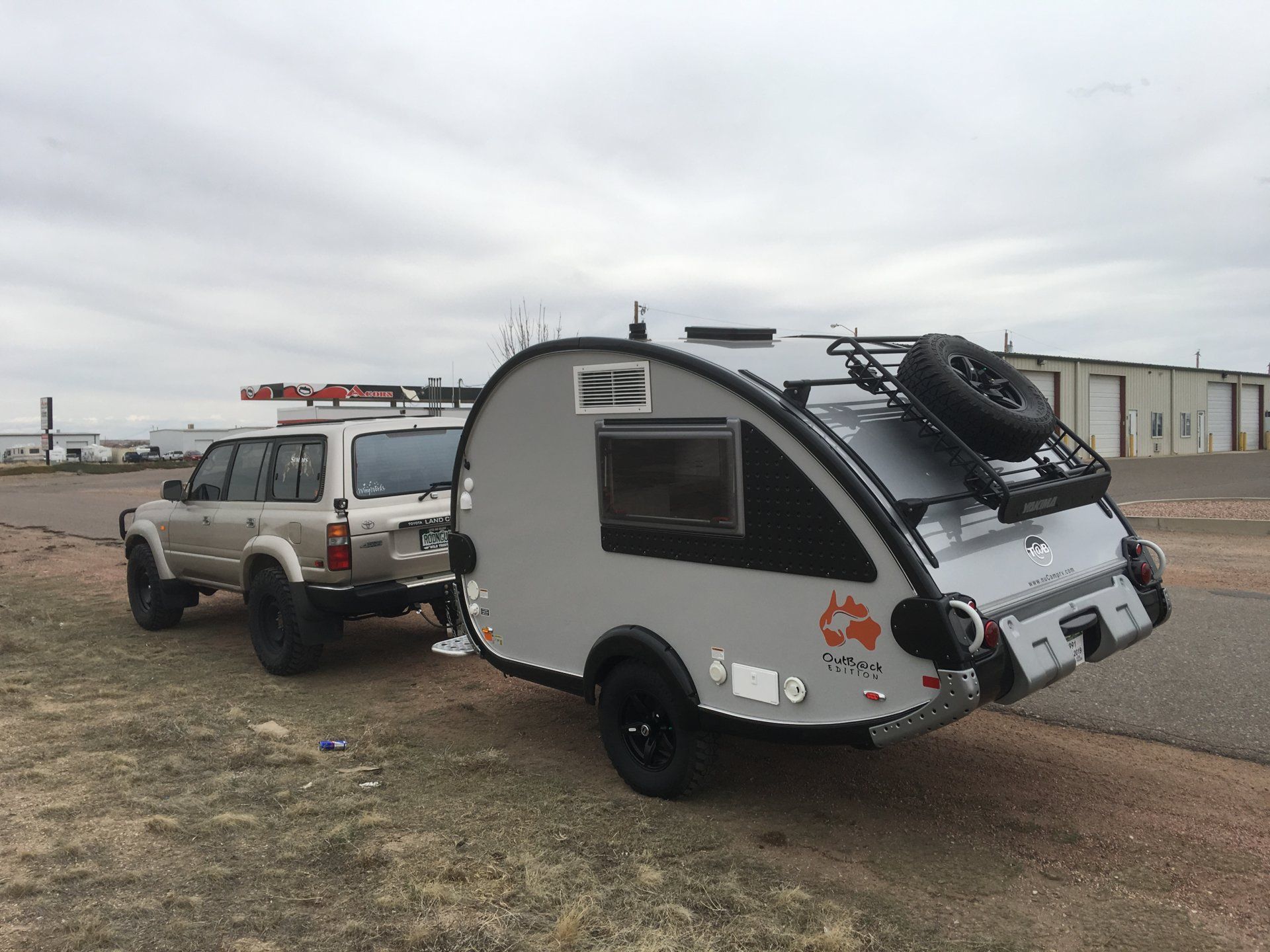

I opted not to add a aftermarket receiver hitch. PO installed a hitch on factory 4 hole location and anyone wondering about doing the same thing it is solid as a rock at this weight range. Picked up the teardrop in Pueblo on Friday drove to Canyonlands needles side on Saturday and back to Bayfield Sunday.

The trip from Pueblo through Salida onto Southfork I was very happy with how it pulled. When we headed up Wolfcreek pass over 9000ft 6.8% grade it would no longer maintain speed and had to down shift into 1st and 25mph. On the flats I can pull as fast as necessary.

That's what I figured 6.8% is steep and 9000 feet takes the guts out of these things. I regularly drive mountain passes like that. I figured it would be slow going.

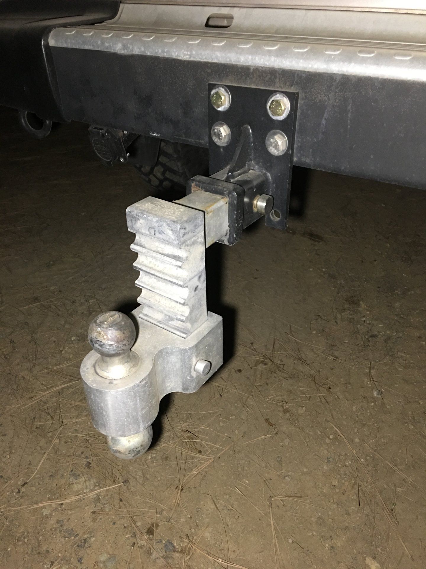

FWIW - I would change that hitch to a proper one. Lots of leverage twisting on that thing with the drop hitch.
I opted not to add a aftermarket receiver hitch. PO installed a hitch on factory 4 hole location and anyone wondering about doing the same thing it is solid as a rock at this weight range. Picked up the teardrop in Pueblo on Friday drove to Canyonlands needles side on Saturday and back to Bayfield Sunday. View attachment 1948355View attachment 1948356
The torque induced in the hitch is scary! It's about 12" of drop (appearances), so a 2000 LB trailer will have a marked increase in torque under braking on that hitch. That's most likely when it will fail since these trucks don;t have a lot of acceleration.
No scare chains? Or scare chain attachment points? Or do you use the lower bolt holes for that?
I would not run that at all, but that's me.
It is a factory rated hitch location in the not US world. Can’t remember what it’s rated at but think it’s somewhere around 2-3k lbs
Yes, but with a pintle, not a 12" drop.
We've all seen the video clips of a FJ40 loaded with railroad ties 8 ft high and the driver is leaning out the side crossing streams on high alpine unmaintained roads in India somewhere... I don't think this is anywhere near that scale. If anything there might be some torsional bending on the frame at the mount but that's not the end of the world.

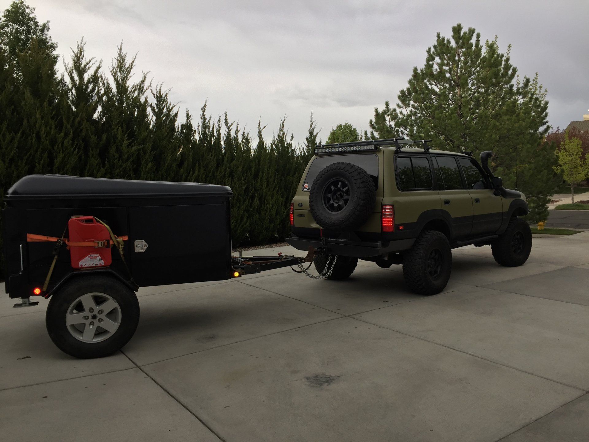

My 80 with my teardrop. Mine is about 1500lbs ready to roll. I use a combination pintle with a milsurp chain plate.
