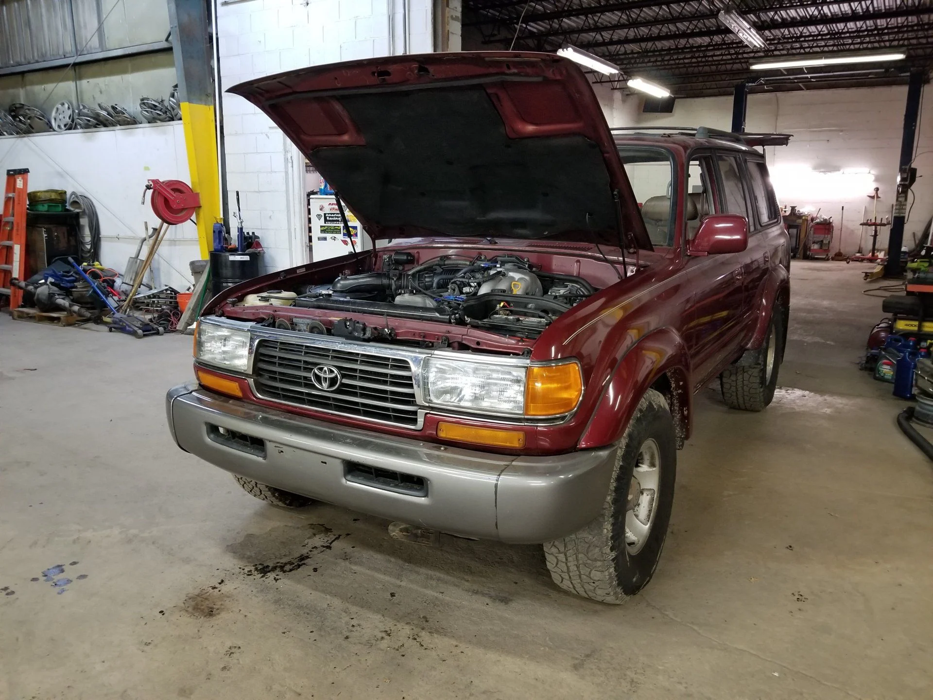

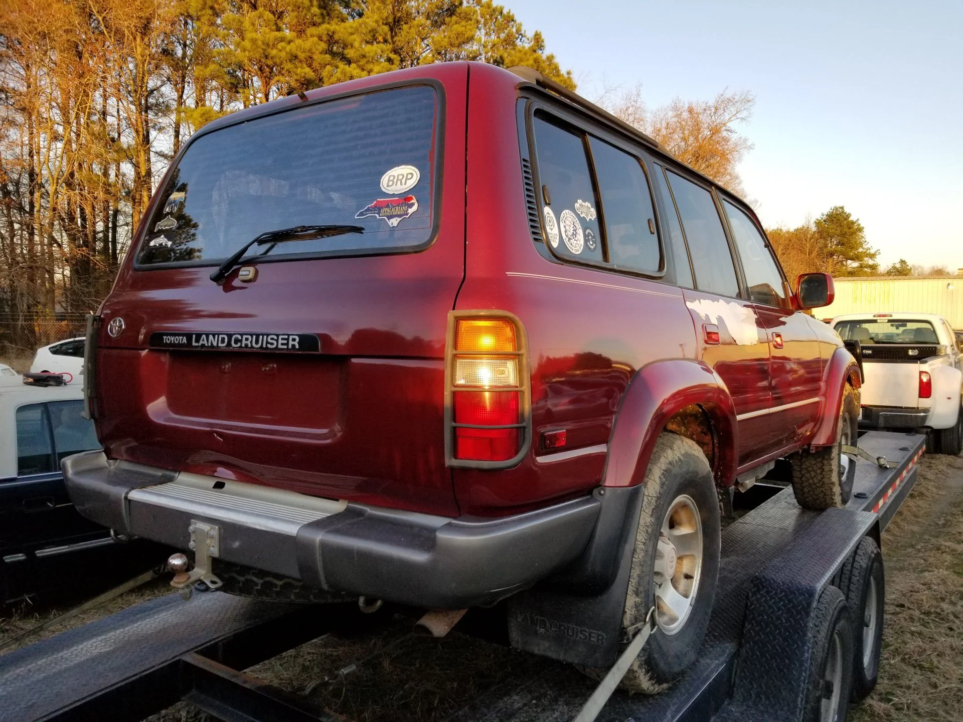

I've been casually looking for an 80 for a new shop truck. Something I can build a little bit and use to pick up parts, loan to others, and to take to the beach and maybe light wheeling. I still wheel my 1st gen 4runner hard so this one doesn't have to be anything crazy.

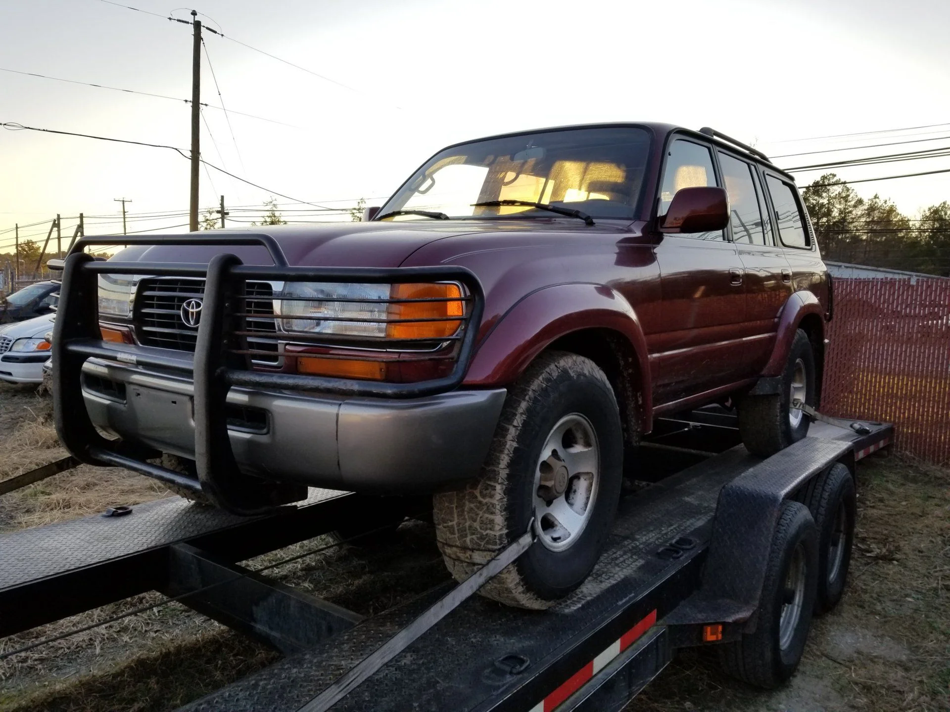

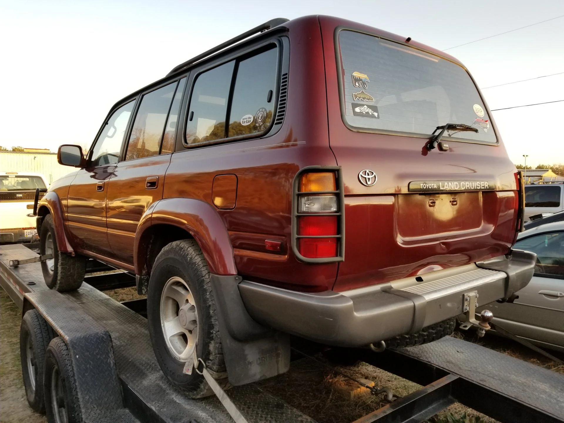

This one popped up on Craigslist and I couldn't help but jump. 1995 Fzj80. 140K, no lockers, typical problems. No significant rust but definitely in need of love. Hopefully this thread will get me some help with correcting issues as well as documenting what is done and still needs attention.

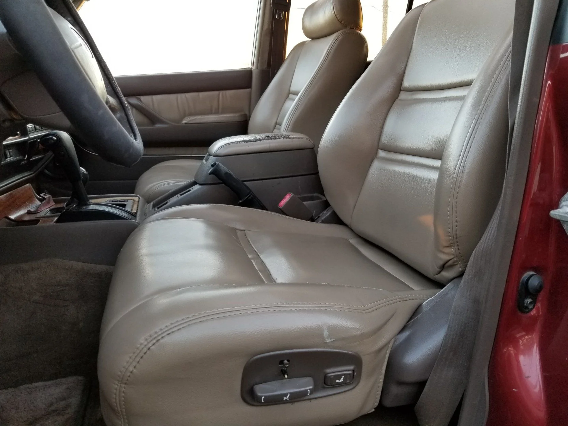

Drivers seat not moving one screw (ordered new gears and plugs)

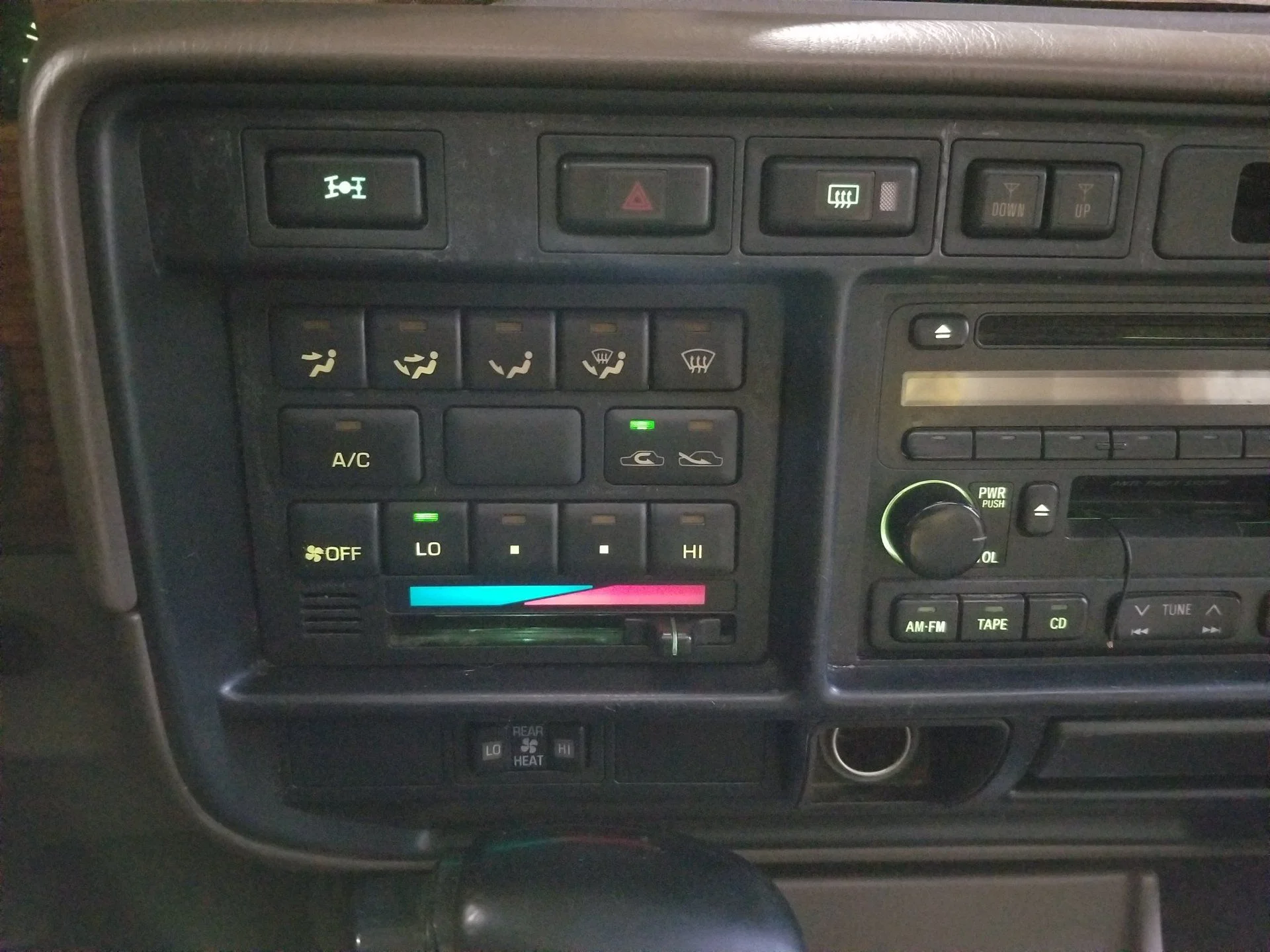

I started with making sure to get any air out of the cooling system to try and get the heat to work. I did get quite a bit out of it but the heat is still luke warm at best. I think my next step will be bypassing the rear heat because the lines look pretty rough and flushing the system out well. Hopefully that will fix it. I will do the phl (or whatever it's called) at the same time.

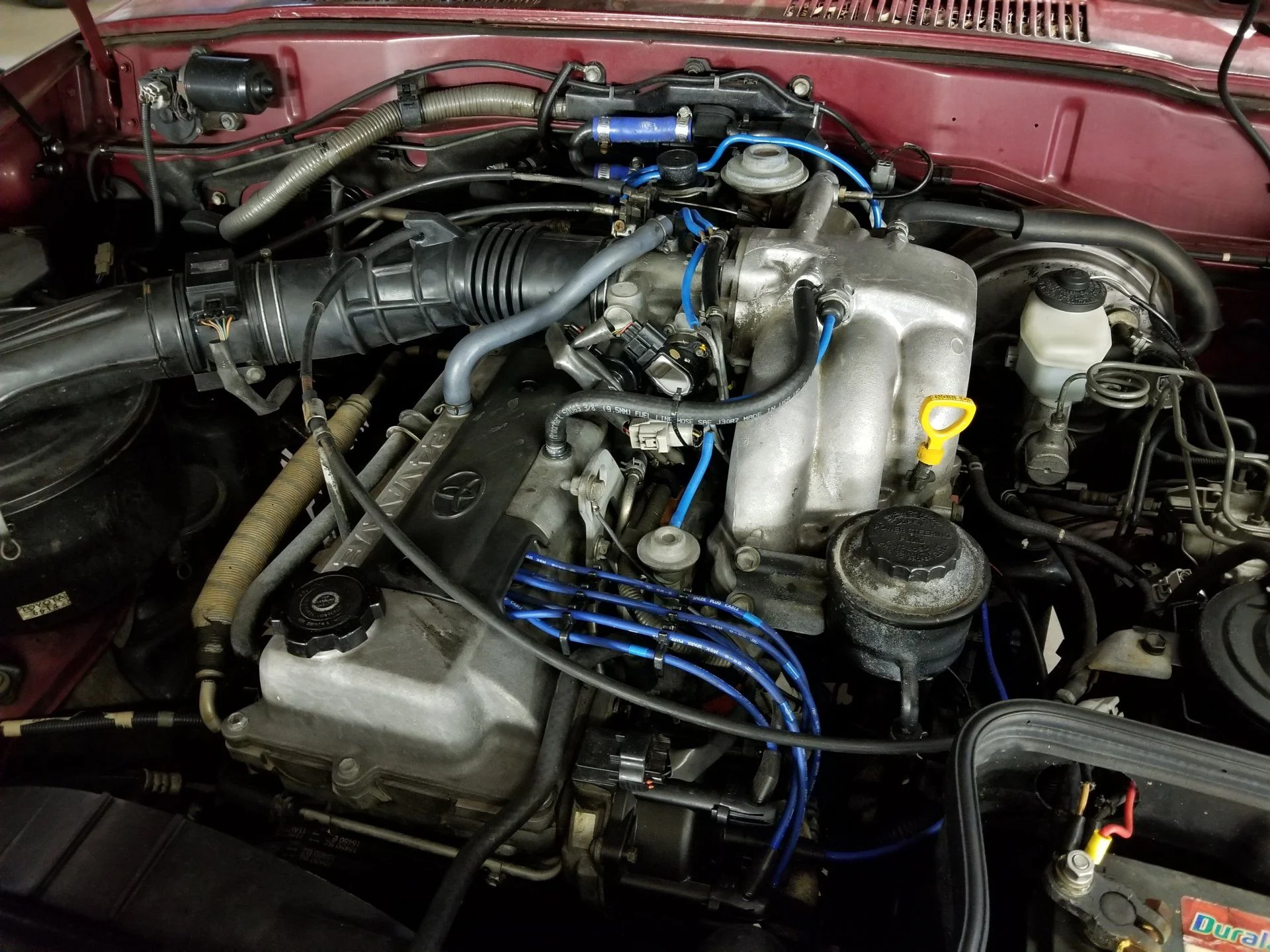

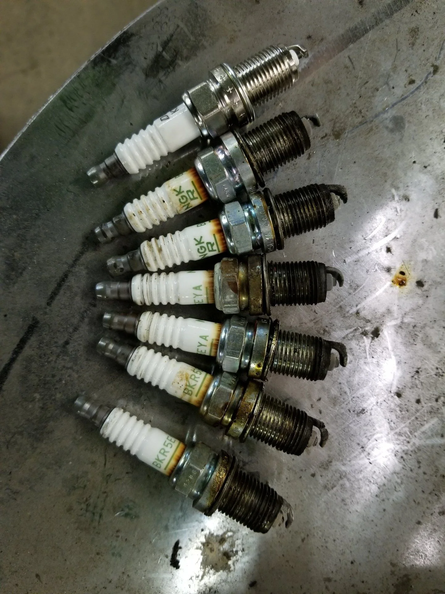

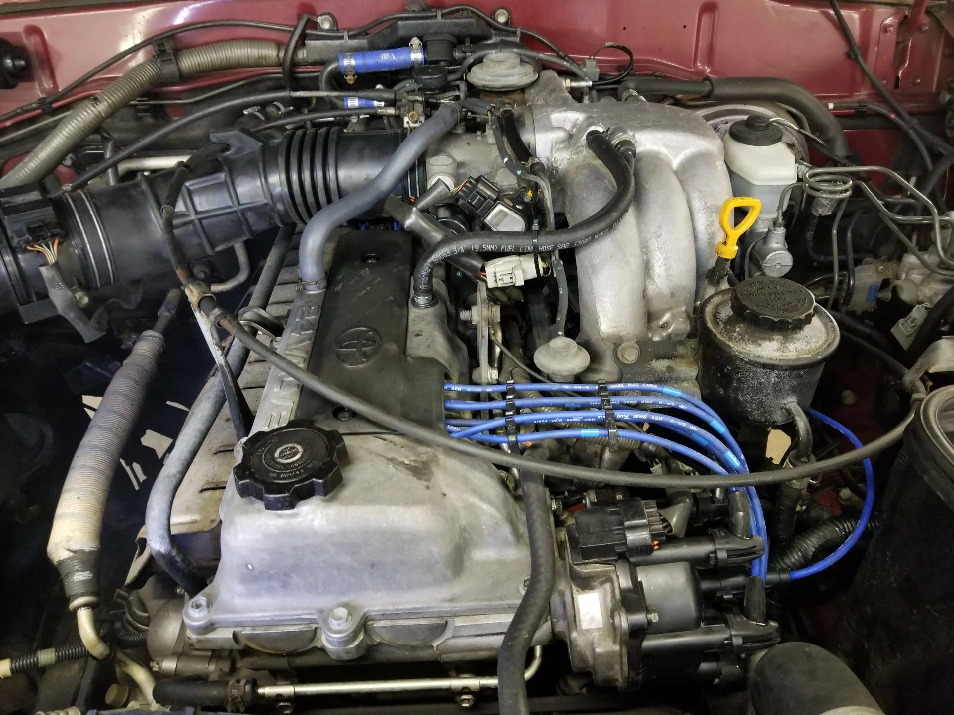

Decided to tackle the tune up next. It ran surprising well for all original parts. You can see how rough the plugs looked compared to a new Denso. Replaced those, ran new NGK wires, and an oem cap and rotor. Replaced the distributor o ring (hard as plastic) and also the formed rubber hose from the valve cover to the throttle body. Someone had already replaced the pcv hose but the grommet was broken so I replaced that and the valve. Installed a new air filter and am still waiting for the new intake hose but put the old one on just to fire it up and make sure I got the distributor back in right. Runs great.

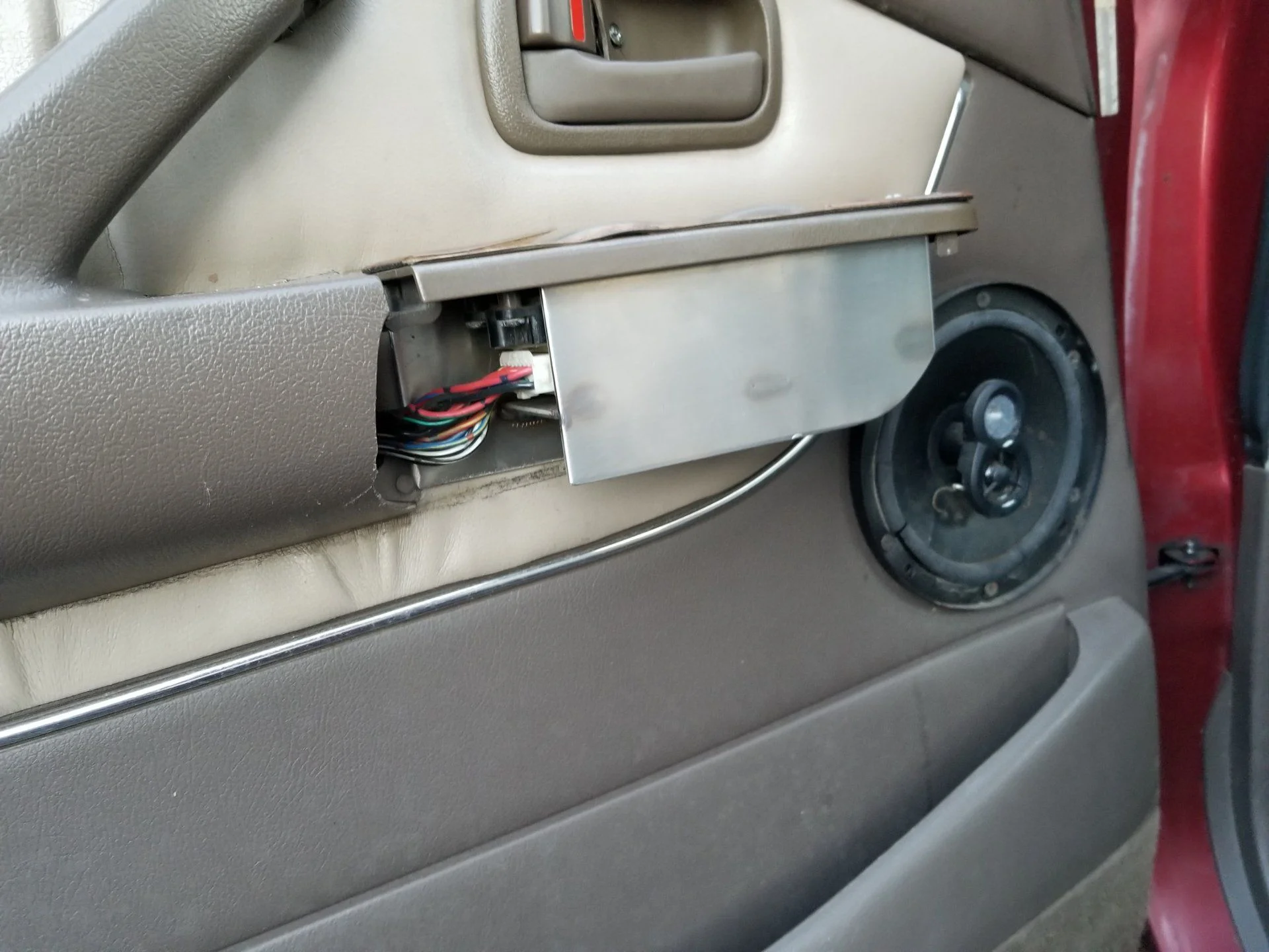

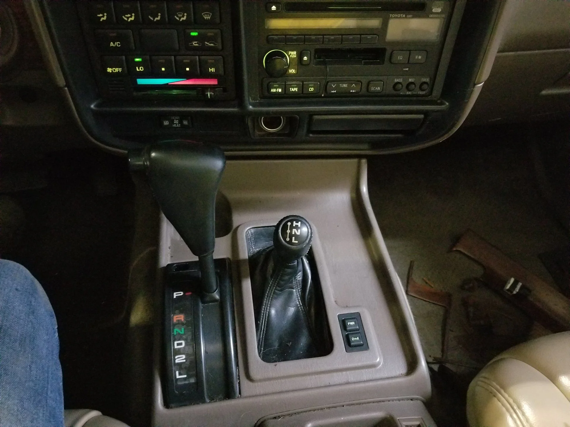

One question I've not answered searching around though... Are the buttons for the power seat replaceable and/or available? You can see in one of the pics I'm missing the seatback recline button. It works, you just have to move around the screw.

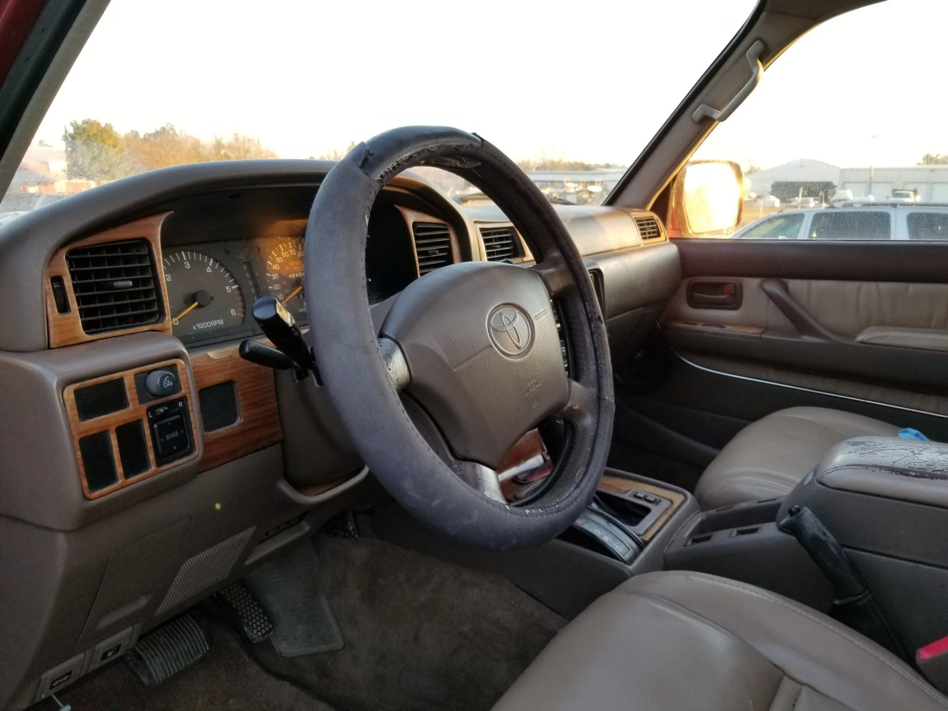

The other interior things I need to tackle other than some missing trim is the steering wheel. That thing is awful.
Front oil leak is probably the oil pump cover. Not a horrible jump. There is also the distributor O ring. And crank shaft seal.
TexasKnowHow has a nice video on doing all three at once. Good tricks.
Yeah, I did the distributor o ring. It was definitely was leaking and in rough shape. I got an oil pump seal but need to pick up a front main. Before I do all that I'm going to clean off the grime and make sure the timing cover isn't leaking as well.

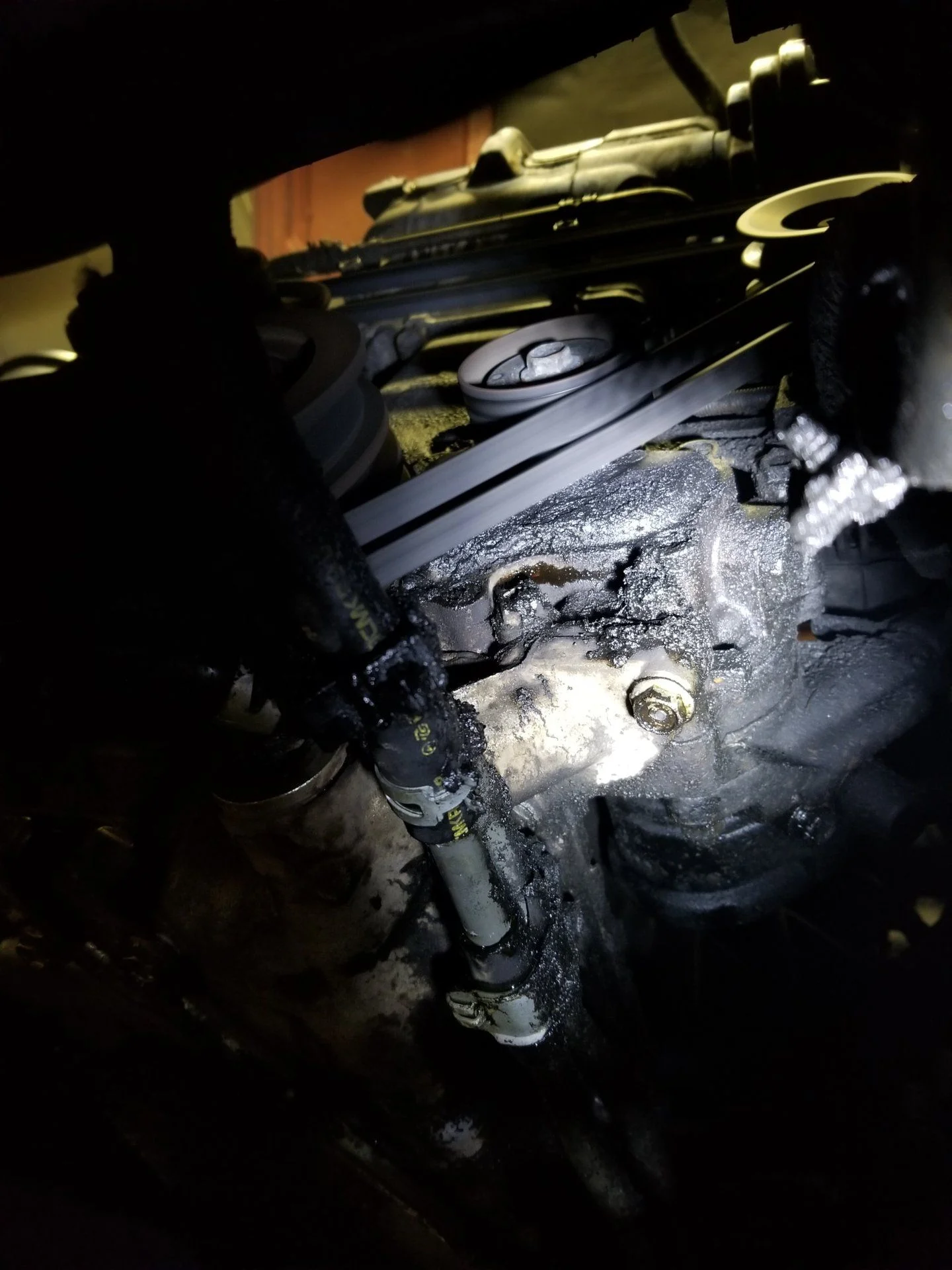

While I was going to town with brake clean I hosed off the area around the crank pulley to try to id the leak. Replacing the distributor o ring slowed it a lot but it is still leaking from the oil pump cover (see pic) so I guess I will need to dig into that.

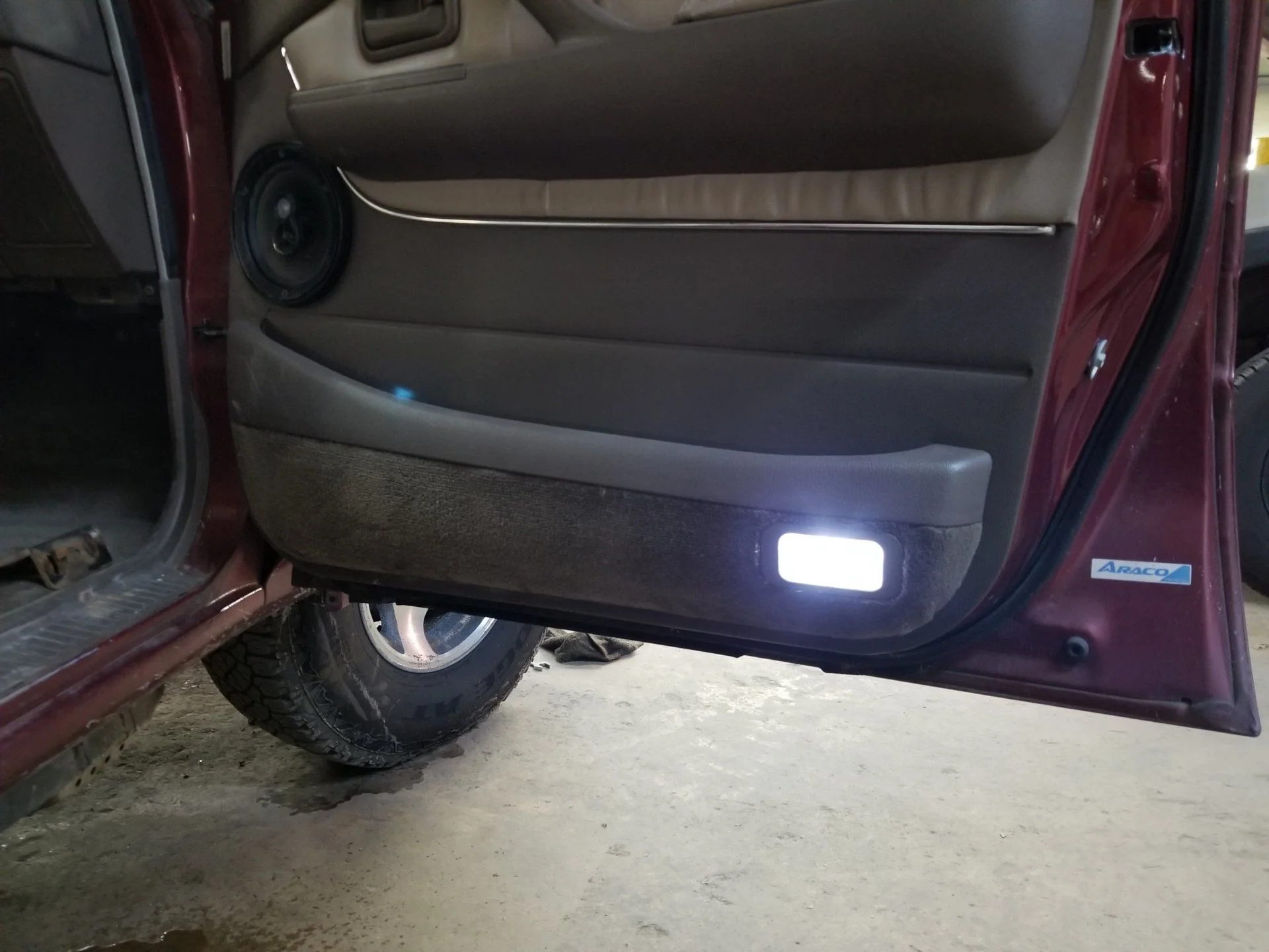

Popped some leds I had around in the door lights. I have a weird problem with the lights though. The driver only works if the passenger door is open. The rear doors don't work at all with incandescents and the leds just barely glow when I put them in so I have some type of voltage drop there. Dome light doesn't work either but I didn't check to see if that's just a blown bulb.

After looking at that second to last photo, I think you may be needing some new power steering hoses, and a power steering pump rebuild in your near future. Both of those items are known causes of leaks on these trucks, and if they are not part of that leak now, they will be a source of a leak later on.

Yeah I read a little about that. I'll probably do all of that when I do the seals. I'd rather do it all once rather than pull it apart multiple times.
