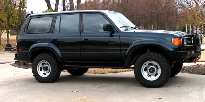

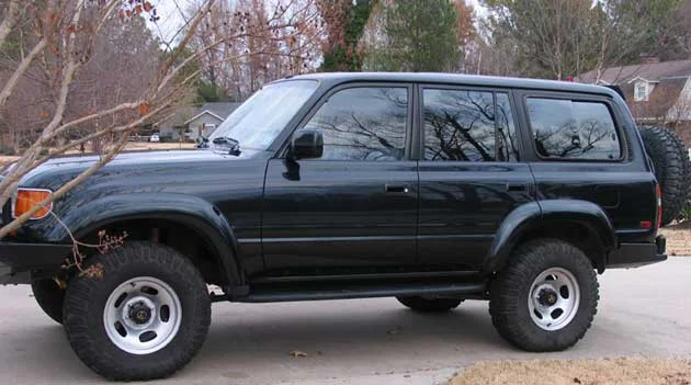

The wheels shown in these pictures are Toyota steel ones with Interco TrXus 285/75/16 tires. These tires have been pretty impressive, getting OK wear and surprisingly quite on the road. I have a set of wheels with the standard Michelin 275’s.

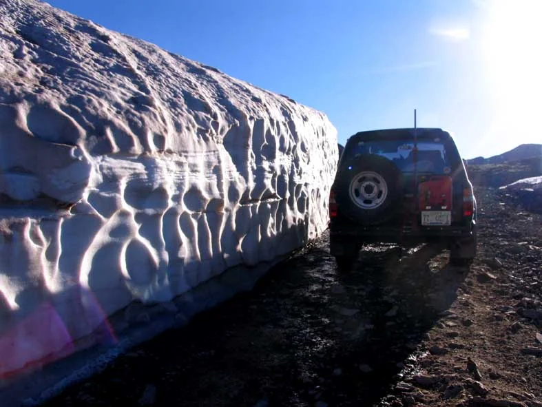

My Land Cruiser has been reliable and has taken me to Colorado mountain passes and to the back of Charity Hospital in New Orleans (note water mark).

The wheels are official Toyota steel and can be gotten from CDan for just a few gold dog bowls!
