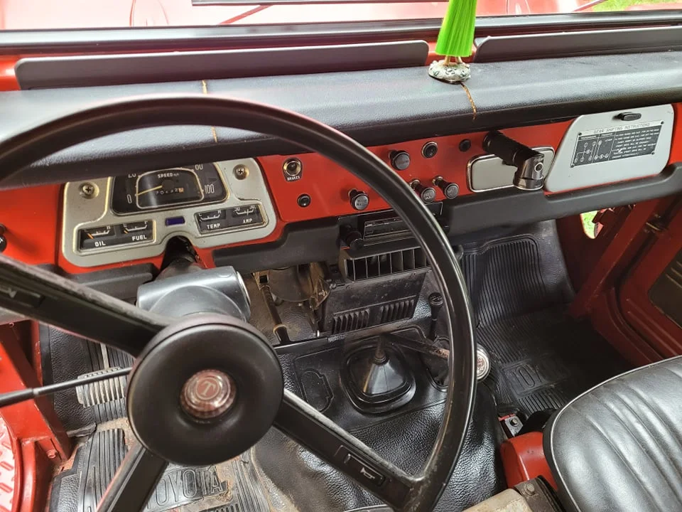

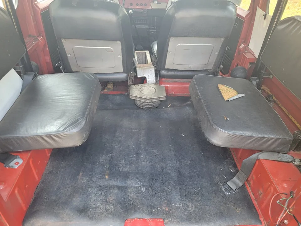

I found this one online, literally after looking for years, not my ideal rig, but seems like a decent deal. Seller is looking at $22.5k. Too far to take a look so trying to get as educated as I can before I make a 10 hour road trip. Claims to be all original and bought out of college. Interior looks ok for age. Typical problem areas with body, No PB or PS everything works as it should. Not looking for show car or daily driver just something to have fun with possibly do some mild restorations . Any input on what else I should be asking or checking on? or pull the rip cord?? Have additional photos.

no PB? it has power brakes
Everything 3 puppies said. Has quite a bit of rust. Also, the door hinge hardware looked painted; I thought they weren’t doing that anymore in 75? If that’s the case, it’s had a respray while assembled. I wouldn’t spend $22,500 on that one, maybe $12,500?

Will throw in the rear sill looks like a cover has been installed in the section under the doors. Guessing rusted sill was just covered up verses being replaced.
