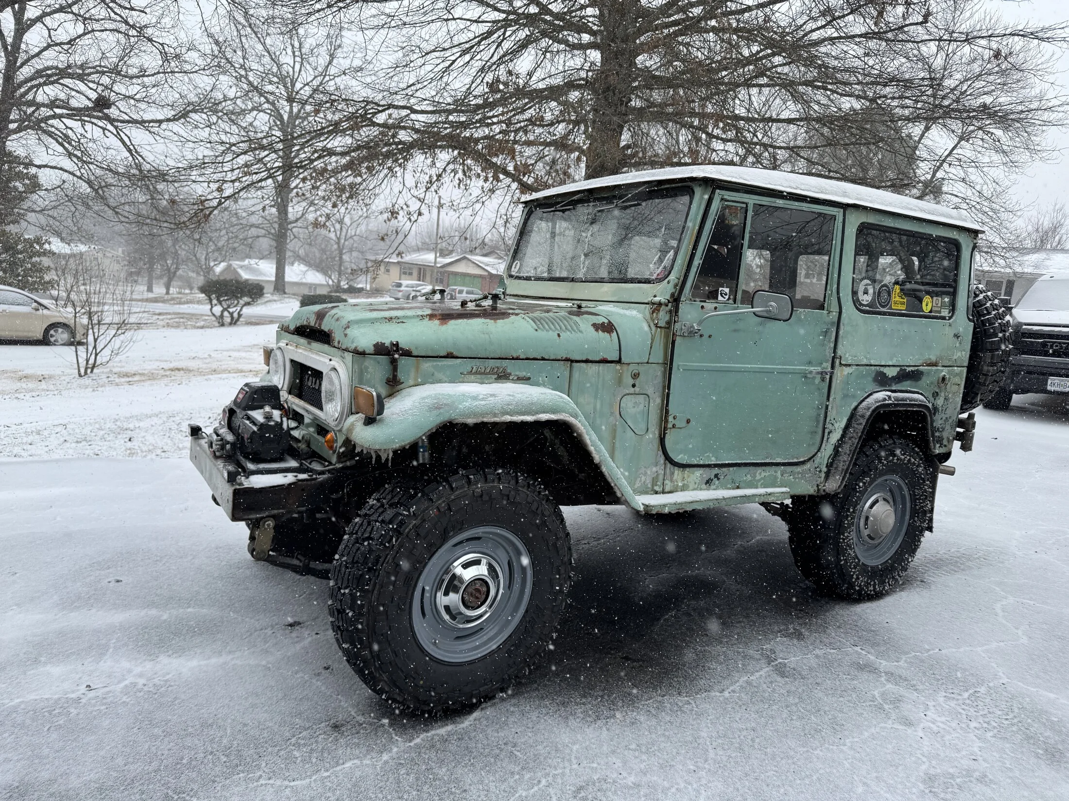

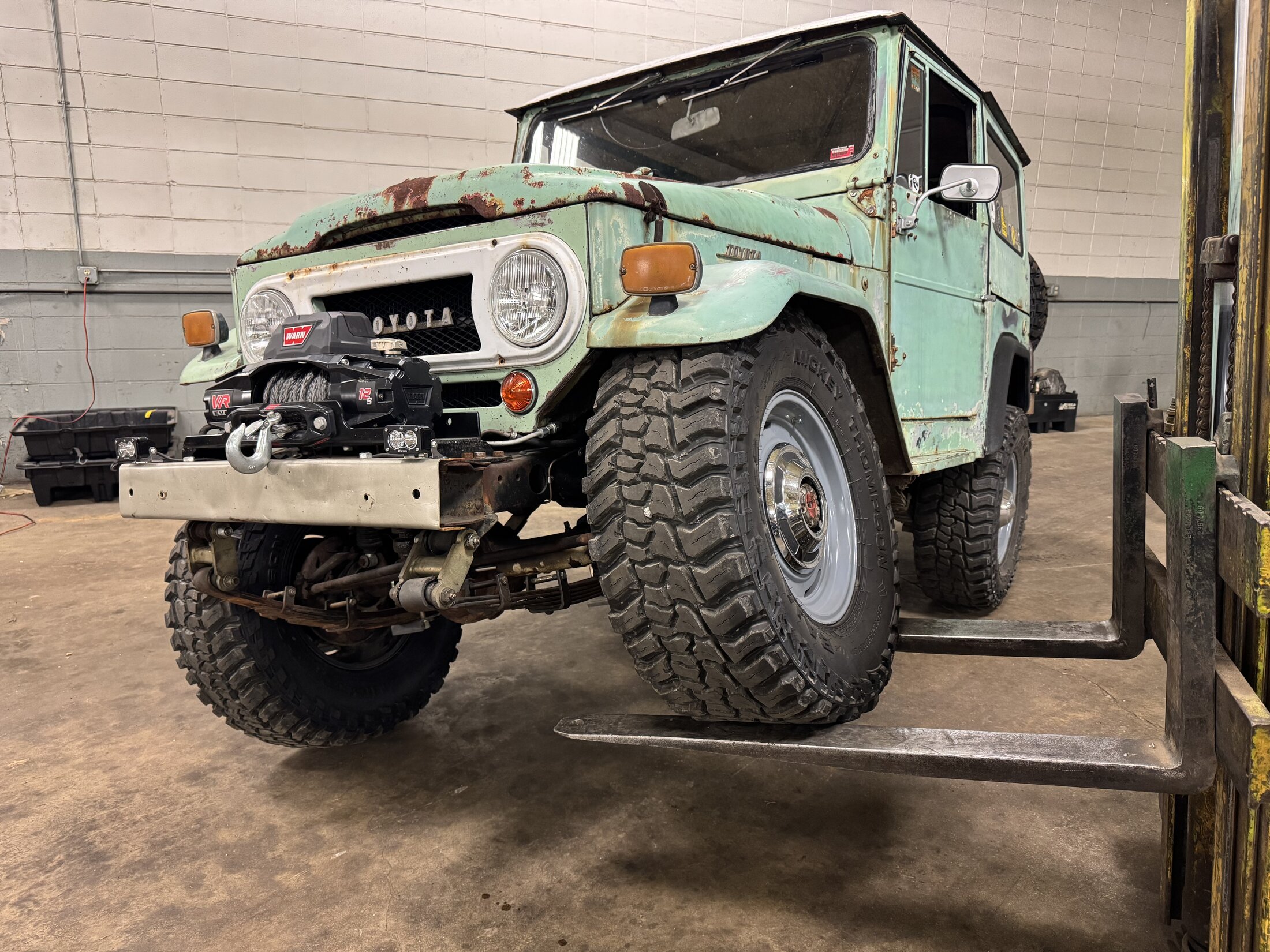

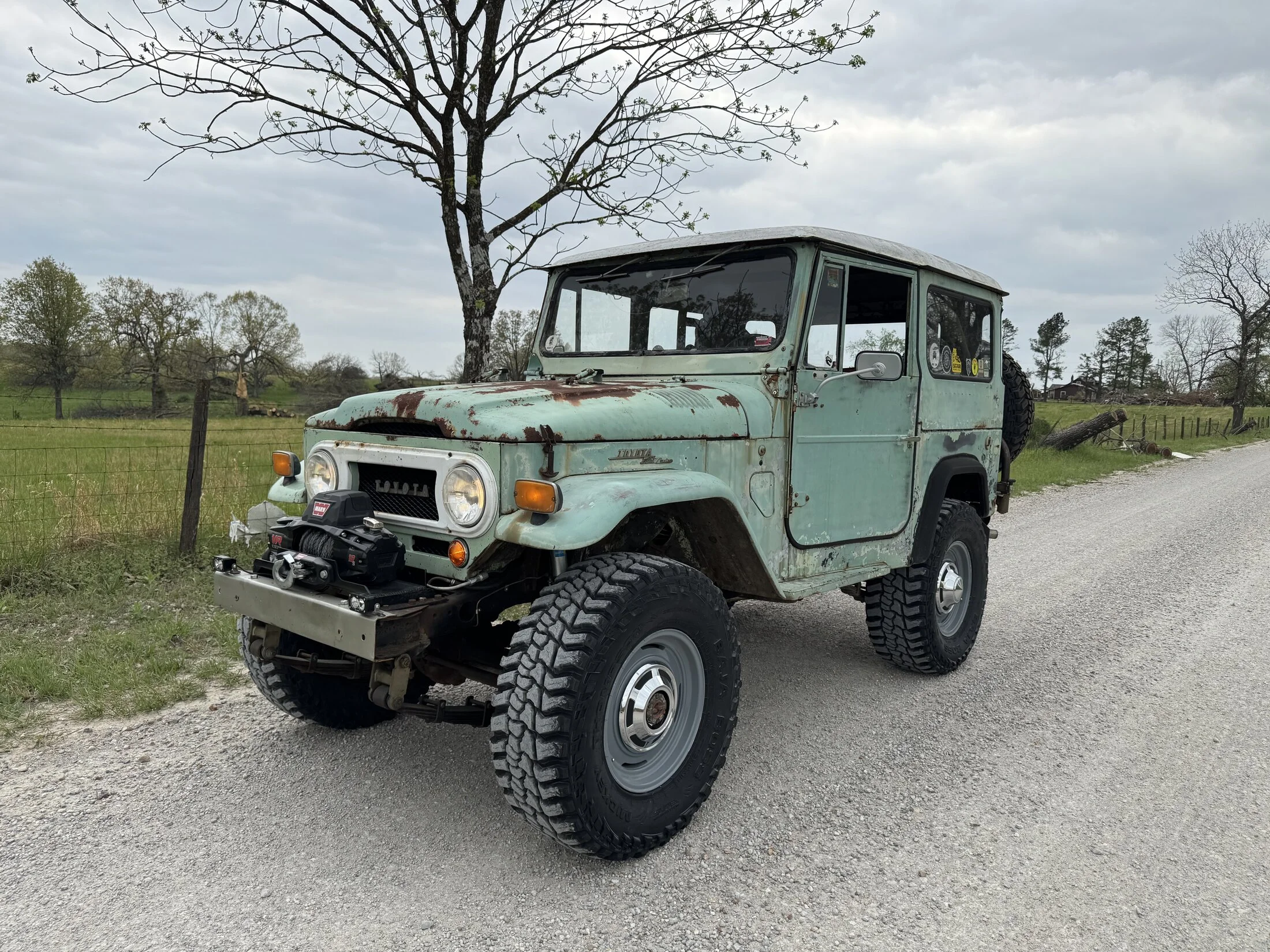

looking for thoughts/feedback before i dump $$ on 17x8.5 et0 with 120mm backspacing and if anyone has done similar?

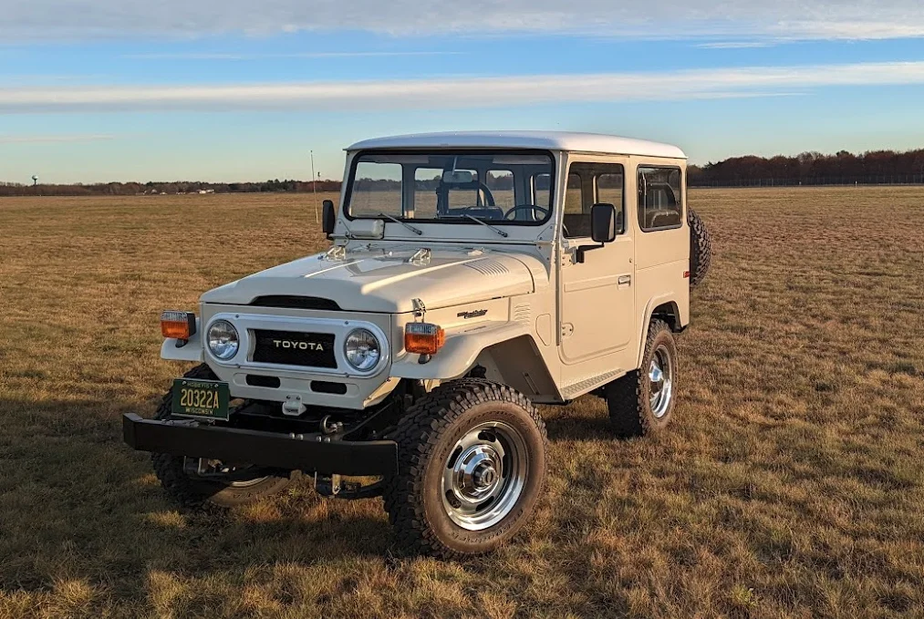

I run a 17x8, 4.75" backspace...so very similar. Been happy so far with 32"s and a 2" OME lift, but no real offroading after the resto, it's living a pampered life now.
The 17s give nice clearance for disc brakes, and the BS/offset keeps things pretty centered to avoid a ton of wheel poke.
