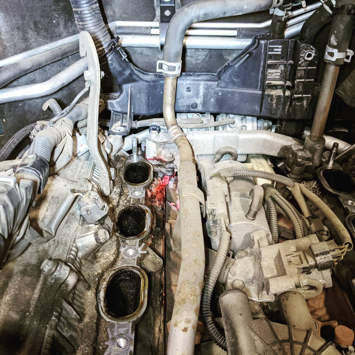

Safe to say I found the leak...
So wait... you literally just got this truck and have a head leak already?
Yup.
I got the rig, ~$3700 tent, ARB fridge, drawers, fridge slider, solar setup, dual ARB compressor all for less than what I was budgeting for the rig. I took a risk and skipped any PPI so this was all semi-planned. Got it up on the lift in my garage and found the big coolant leak right away.
If I can sell some of the parts or subtract their used value from the deal I'm close to a straight swap of my 99LC for this 06LX.
Provided this leak and other unknown issues that will inevitably pop up during baseline don't amount to ~$5k worth of parts and labor pain, I'm coming out pretty far ahead.
Plus, it's a good idea to replace the intake manifold gasket on any of these VVTI motors at this point. Seems like an almost guaranteed air leak with the original gasket.

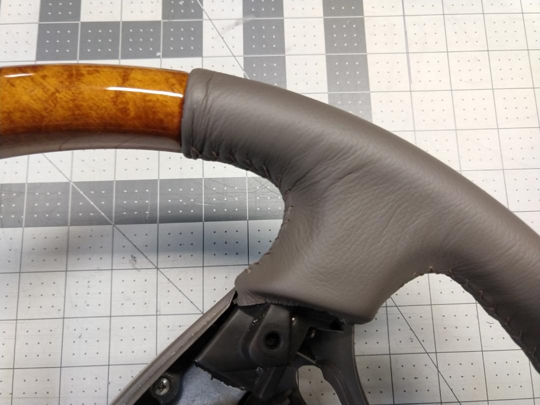

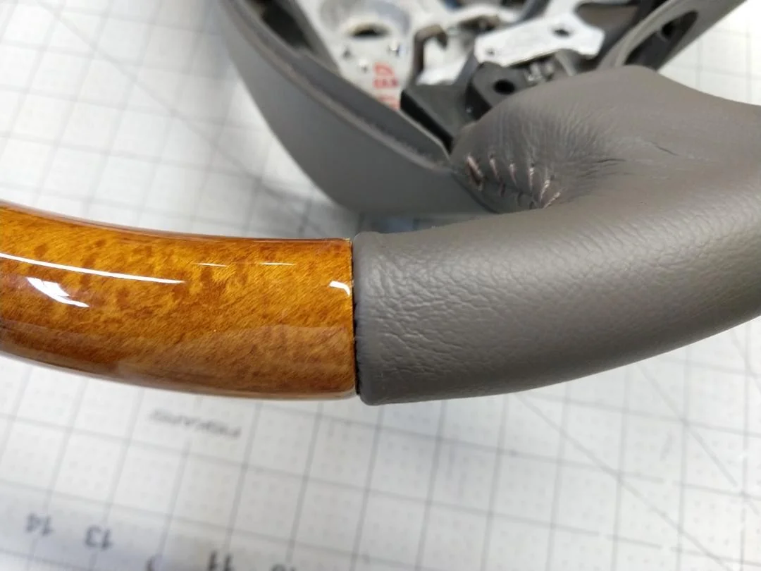

Steering wheel pulled and on its way to Dallas Custom. Rewrapping in OEM style leather, maintaining wood. I had to go buy a puller (98% sure I had one, but couldn't find it).

Any idea on the turn around from Dallas Customs?

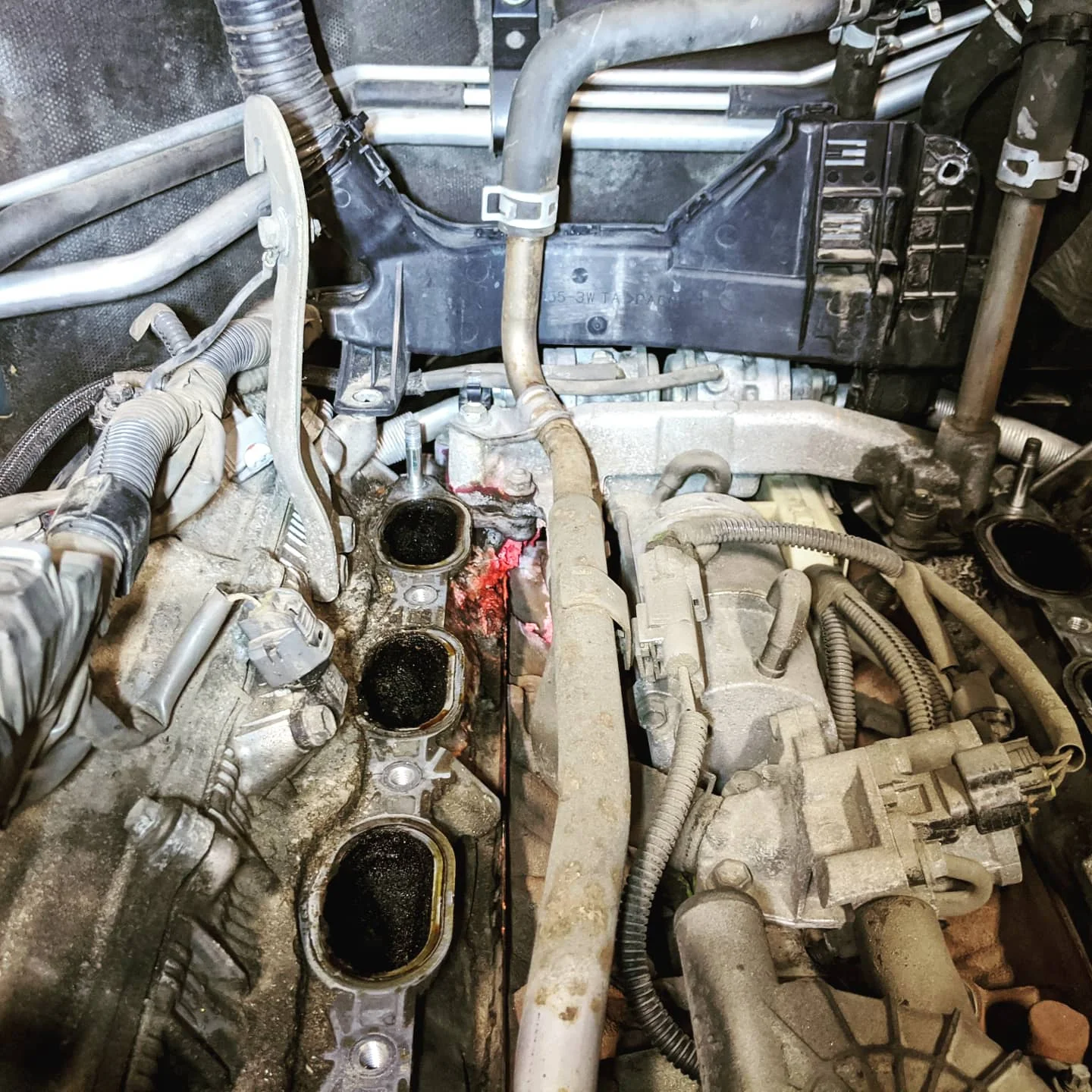

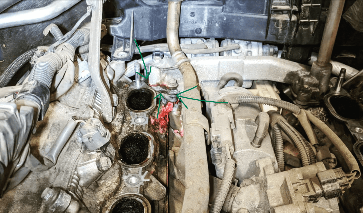

Is it really a failed head gasket or just a coolant leak from the rear plumbing/bypass?
No, not a head gasket leak. Just the rear bypass gaskets. Sorry if I confused anyone between my talk of motor pulling and someone else's head gasket comment.
This appears to just be the coolant bypass at the rear. It looks a lot more scary than it is. I've got parts coming in on the 28th. Should have it all buttoned up and refreshed shortly after that.
*Leak shown in green arrows below.

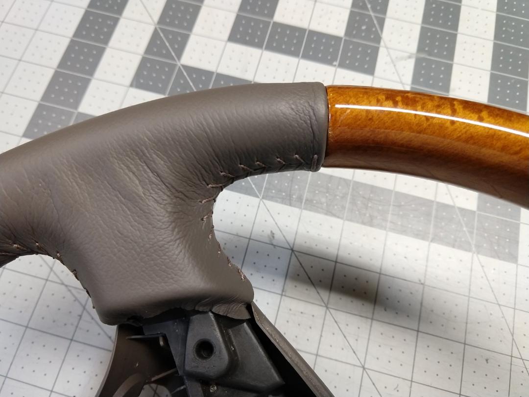

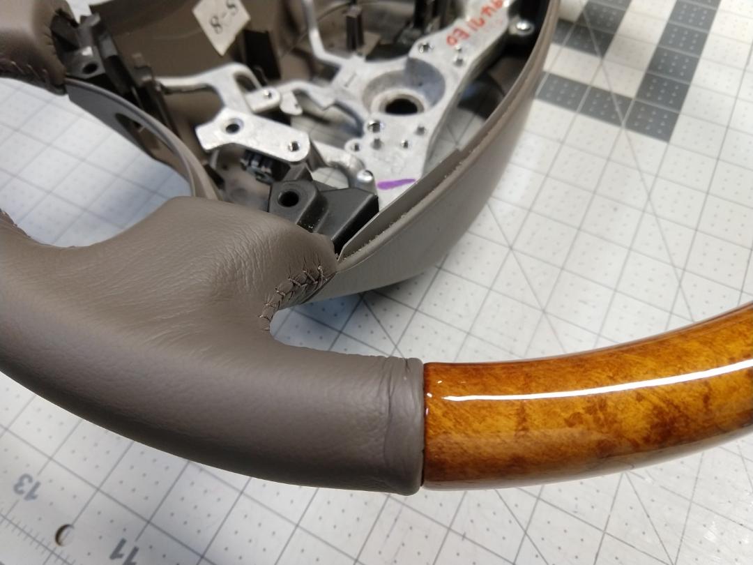

That ended up turning out very good.
What did the turn around time end up being?
He received it Jan 21 and had it completed and shipping out on today (27th), so 4 business days. He also adjusted the leather in one area per my request in that time. Very prompt, communicative and professional. 10/10 review from me so far.
Very nice! Thanks for the feedback. I'm going to keep their contact info as I might seek their services later on.

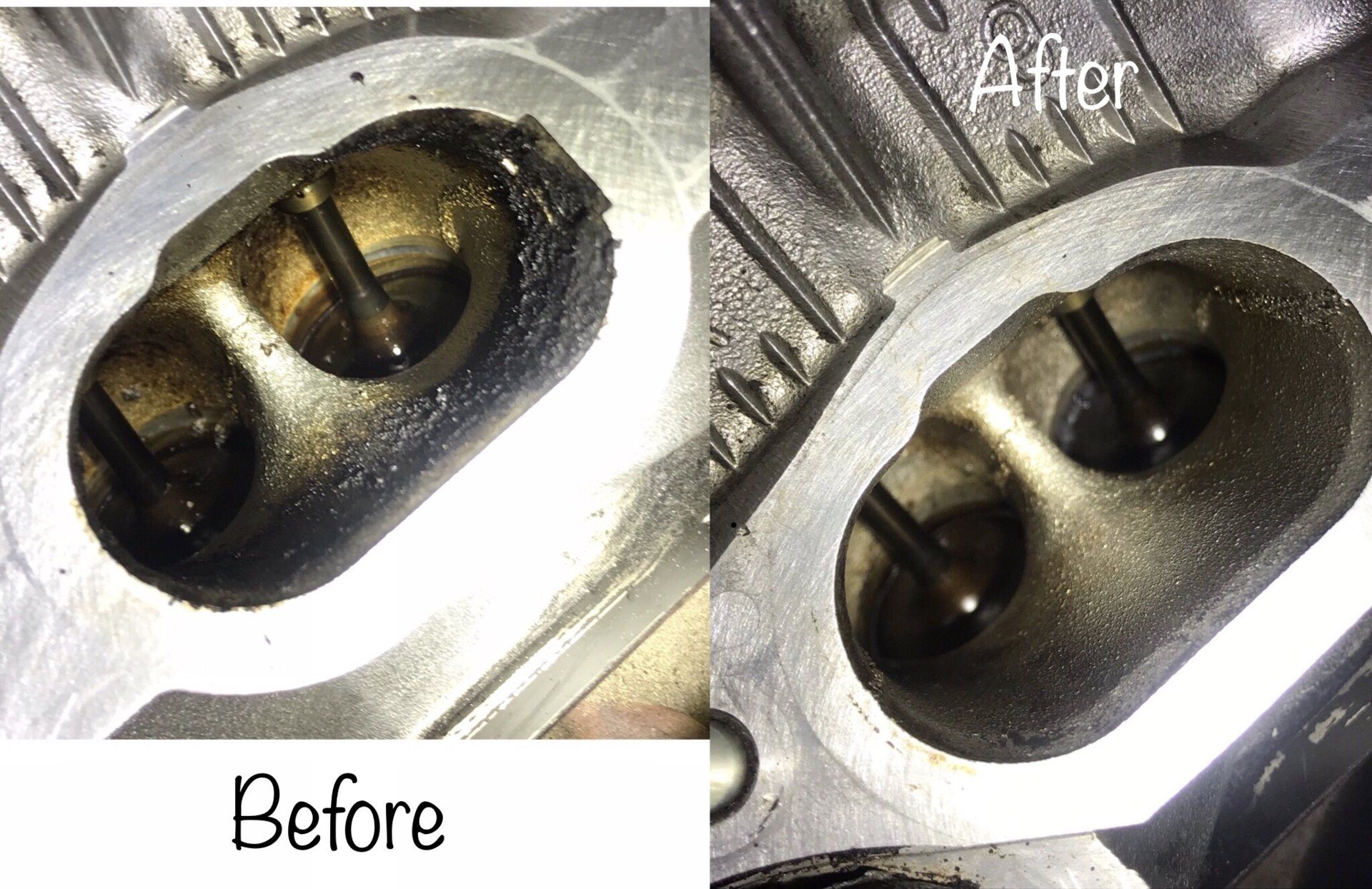

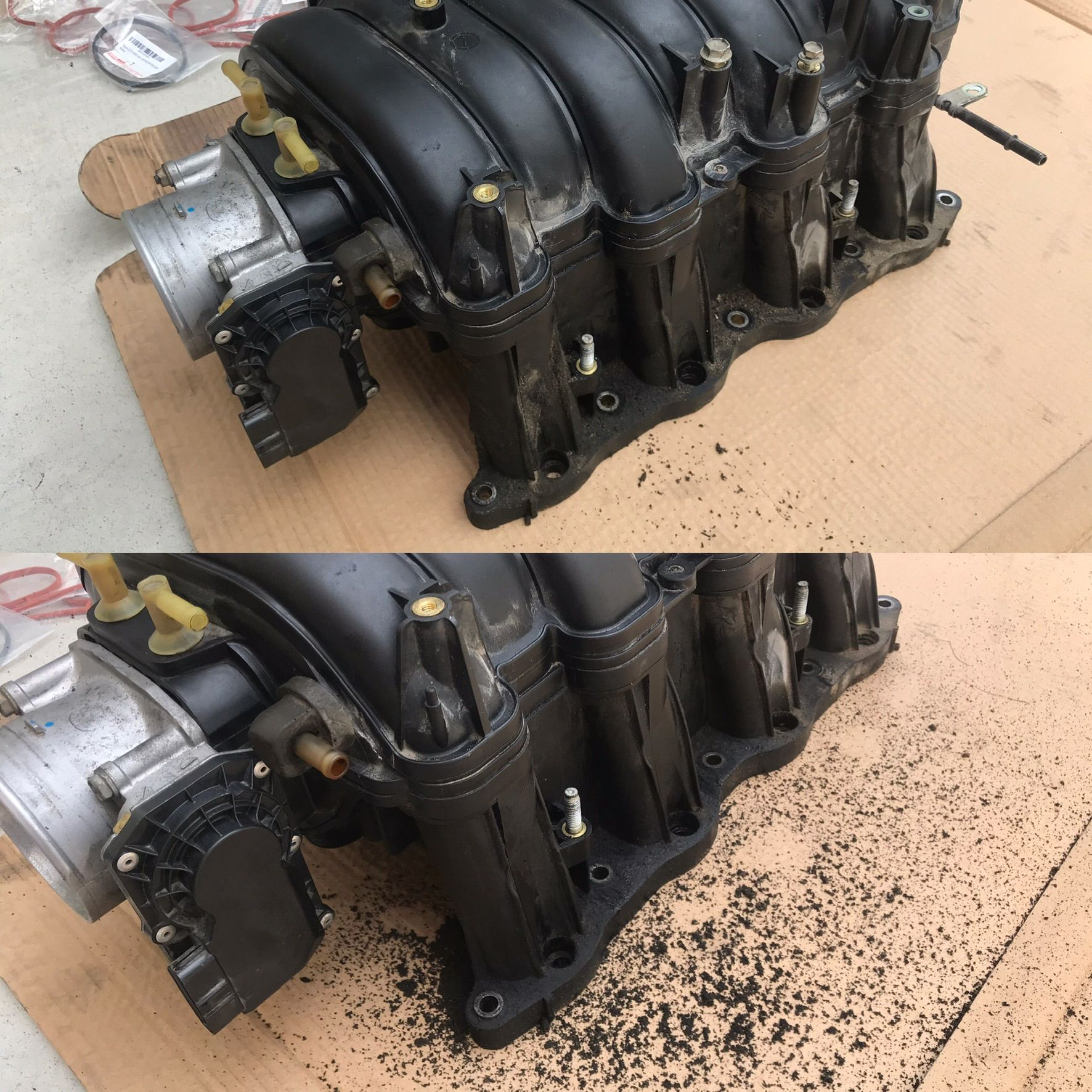

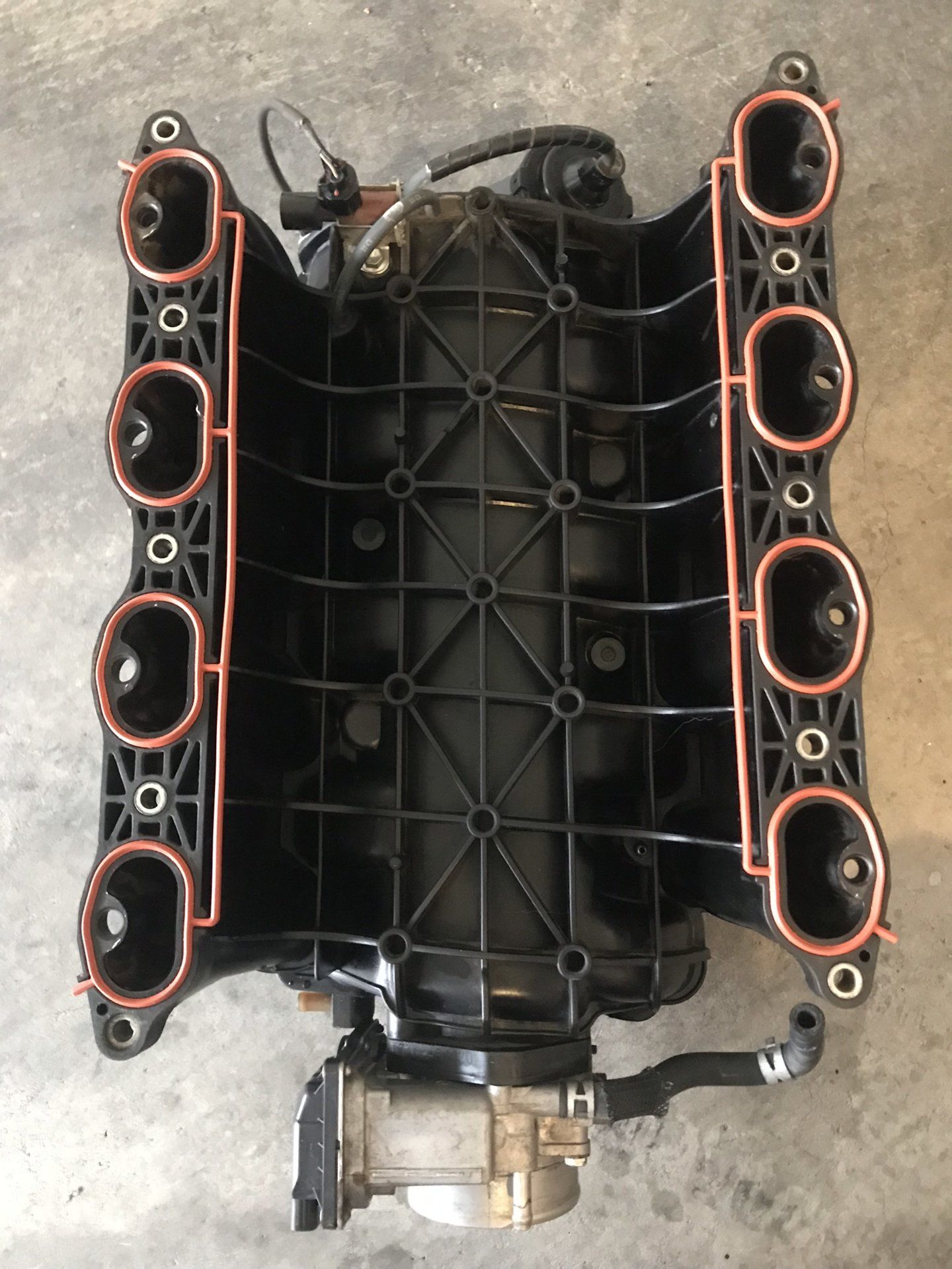

I still remember this picture when I did an overhaul on my intake manifold. Those intake ports where you see the intake valves) stared at me long and I just couldn’t resist servicing it, and so I did:
I think I used a total of 3 cans of carb cleaner to get this done.
I actually got myself 2 of those water bypass gaskets just in case while it’s already open and I see a small leak I’d go ahead do that too. But it was bone dry, so I just ended up returning the bypass gaskets and got a refund.
View attachment 2194475View attachment 2194476View attachment 2194484
Oh man, now you're tempting me! My heads are gnarly! tons of debris around the intake channels and tons inside the channel.
How did you prevent debris from falling into the valve areas and inevitably into the cylinder and onto the valve seats? That's got me scared to clean them.
Yeah it was inevitable for the dirt to end up at the bottom where the intake valves are, and some are partially open and would lead to the pistons. I took @2001LC’s advice: used a vacuum cleaner and had the dirt sucked out on each port. That did the trick in collecting those fallen off dirt. Most of that dirt that have been removed by the carb cleaner chemical are also small to be burned in the combustion chamber. Made me sleep well that night. And boy the 2UZ engine just idled smoothly, even smoother than my 2019 honda fit with 3k miles on it.
