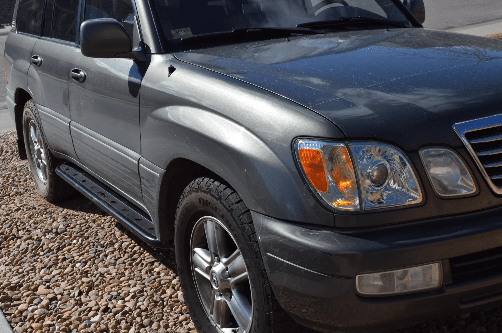

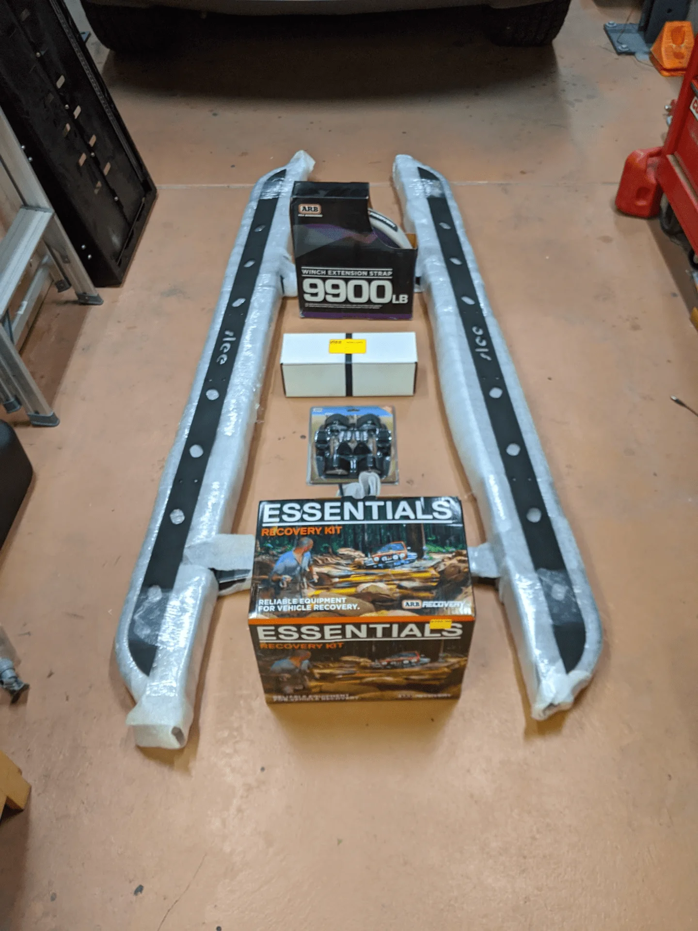

Today was a good day. Sliders Acquired. Install later this week if I can fit it in.
My work has gone Work From Home as of today for the virus so hopefully I can use the saved commute time and lunch breaks wisely and get this knocked out fast.
I also picked up the ARB recovery kit so I've got a cleaner recovery setup than my old partial piecemeal setup.
I did not pick up the ARB Jack. Because... well... $$$$. It's really neat. Very light. And also, unfortunately, very expensive. Maybe if YotaMD has a record month soon I'll splurge later.

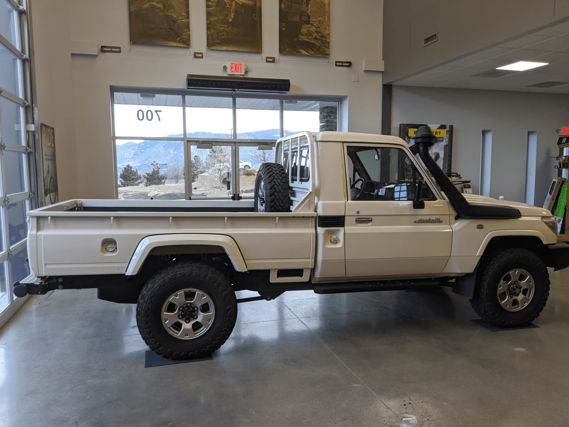

Bonus "slee built" 70 series. Awesome. I'd trade a few Jeeps for one of these.

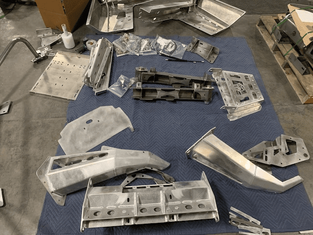

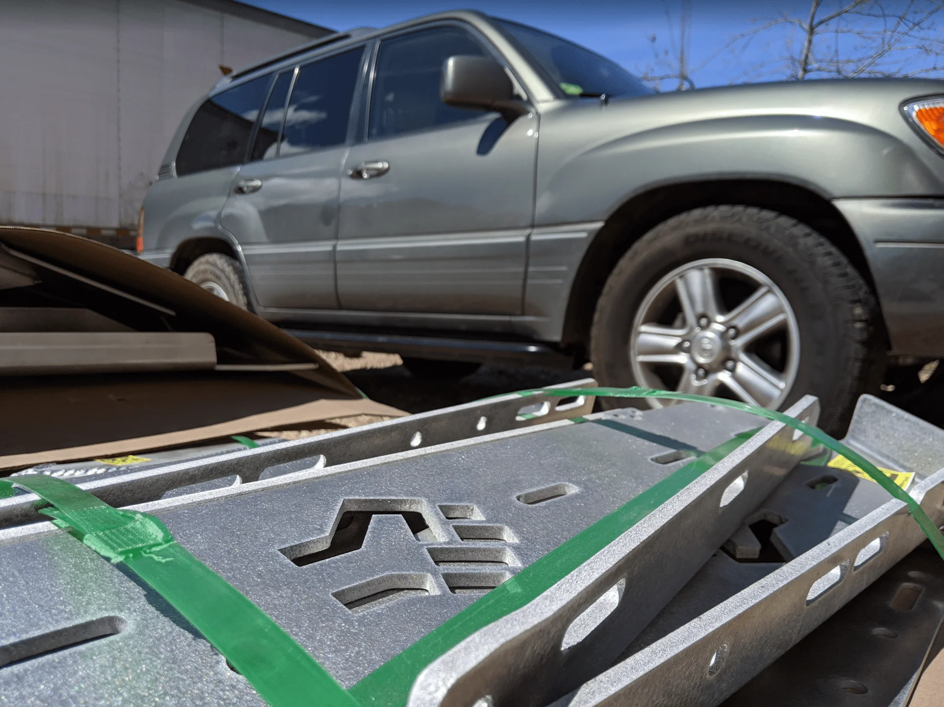

Goooooood stuff on the way, courtesy of Ben @benc at Dissent Offroad.
Now to decide on the color-scheme. I'm thinking color-matched main sections with a dark grey accent on smaller pieces.

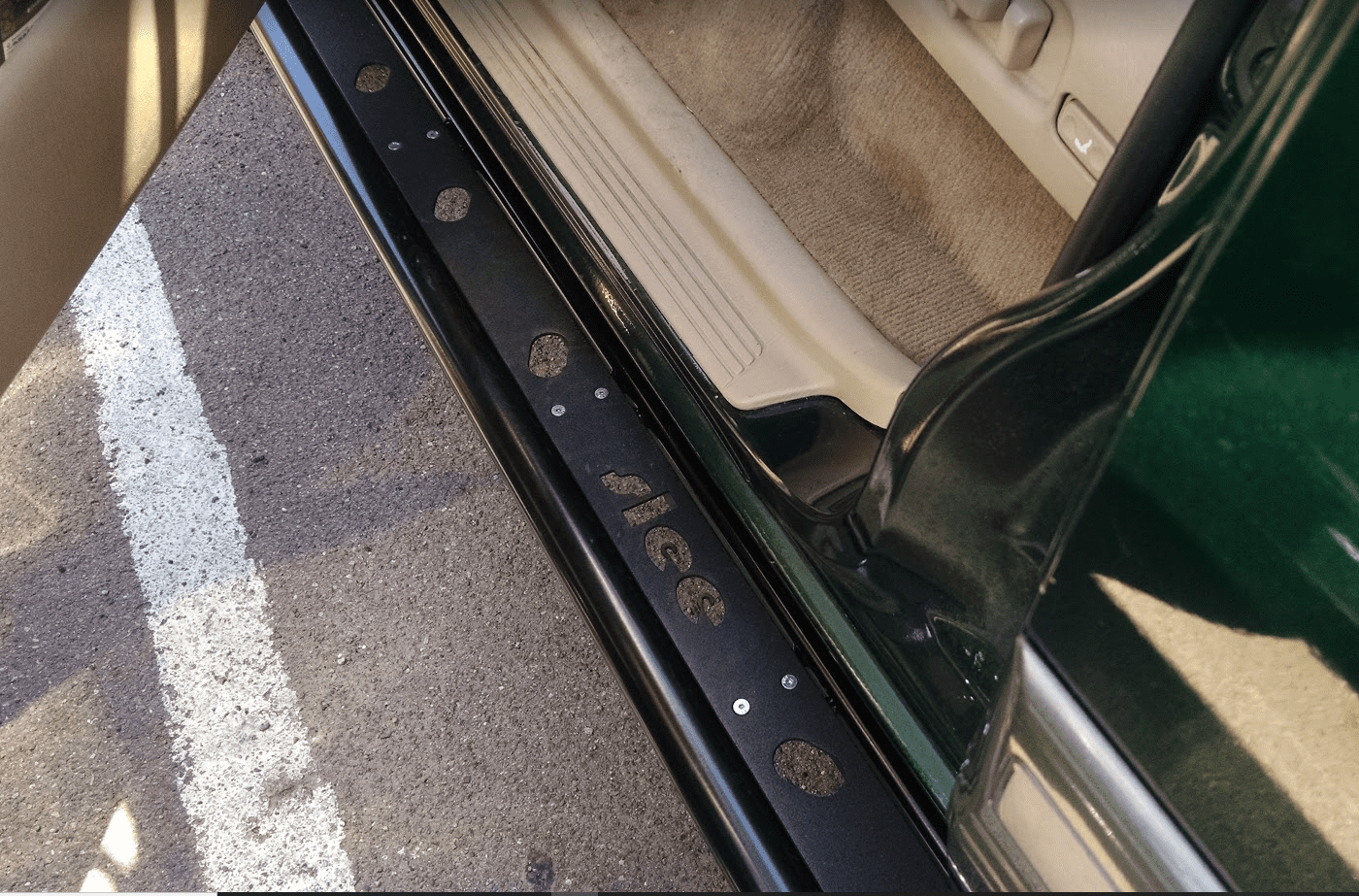

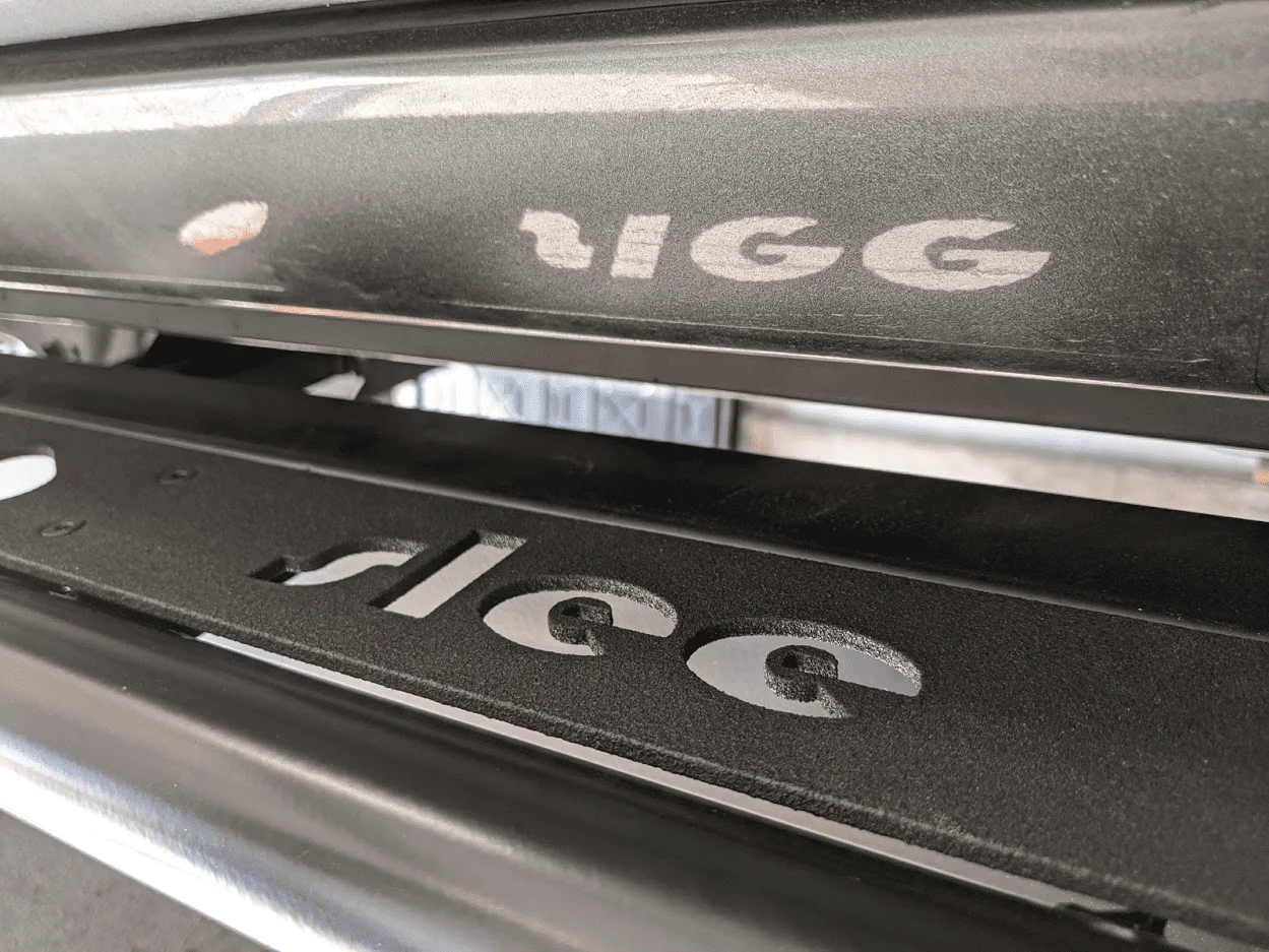

Better pic of the Slee sliders installed.

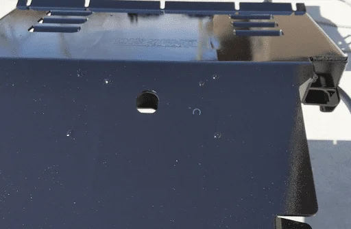

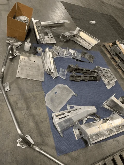

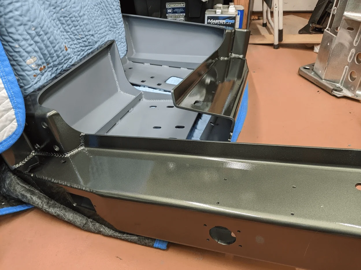

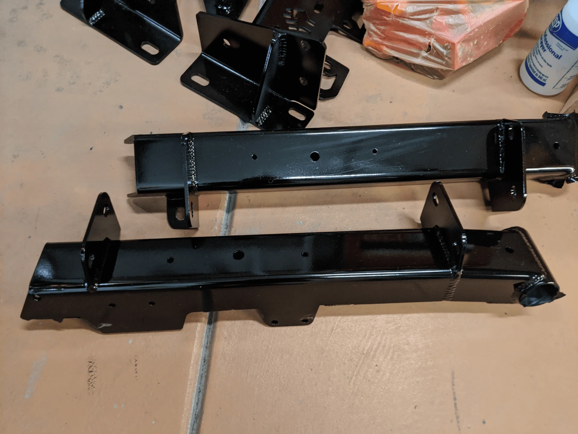

I'm painting the Dissent armor currently. Main sections will be color matched to the Cypress Pearl - Basecoat/clearcoat. The rest will be a semi-gloss single stage black with an extra clear layer. I'm shooting outside which makes life so much easier than messing with my home-made booth. Just setting a stand outside and spraying is downright fun!
And then there was green.
Arms are finished up as well. I think I'm good now to start assembling the rear bumper arms! woot!
I'll just happy to start reducing the number of random bits everywhere. There's a lot of pieces when you;re dealing with Dissent skids, front and rear!

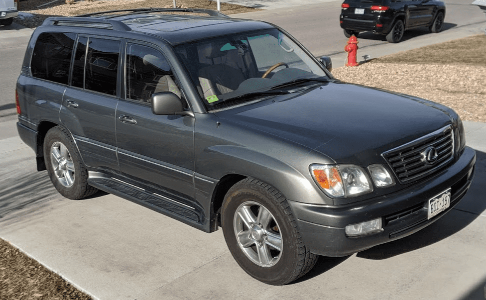

2006 LX470 in Cypress Pearl.
As Received
-216k miles as of Jan 2020
-AirTop RTT on factory rails
-Budget drawers
-Solar Panel, charger and battery
-Otherwise all OEM

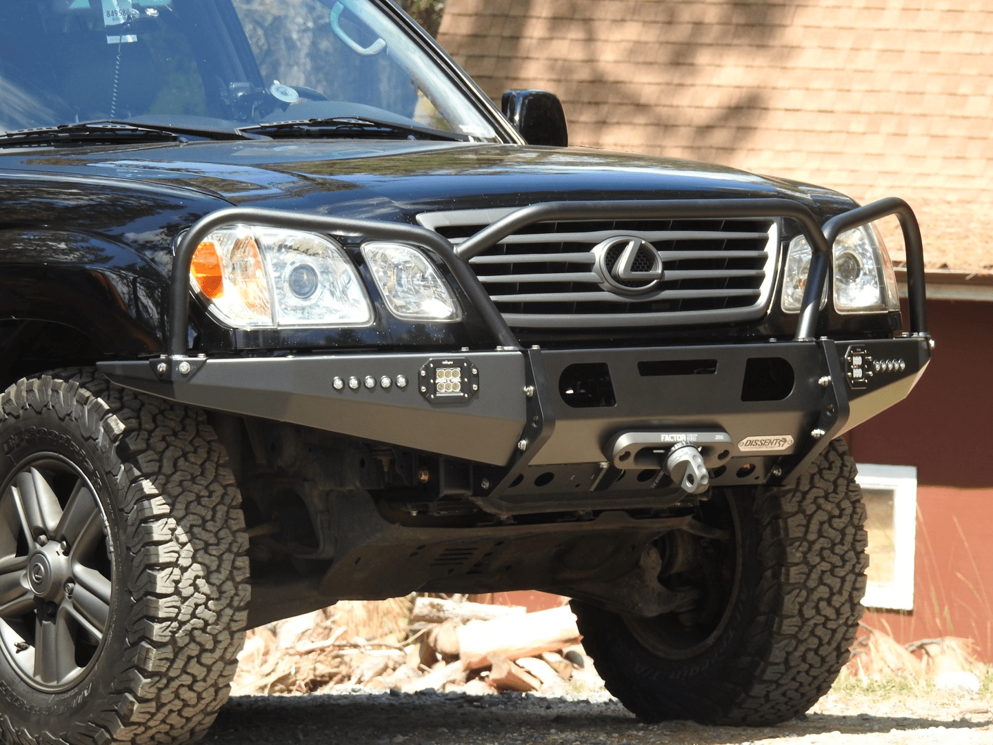

I like the Dissent bumpers/skids quite a bit. I wonder if @benc will offer up a deal if I go all out on aluminum Dissent gear at once?

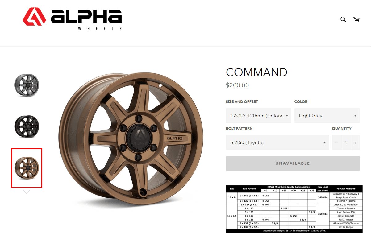

The rig comes with fresh Cooper AT3 tires, but they're 32". I like 33's for summer highway and trail driving. 17" wheels would also be better for trails. I'm not in love with the Lexus wheel's style and would prefer something with a slightly more flush offset. The Alpha Command wheels have my eye and come in a variety of offsets.

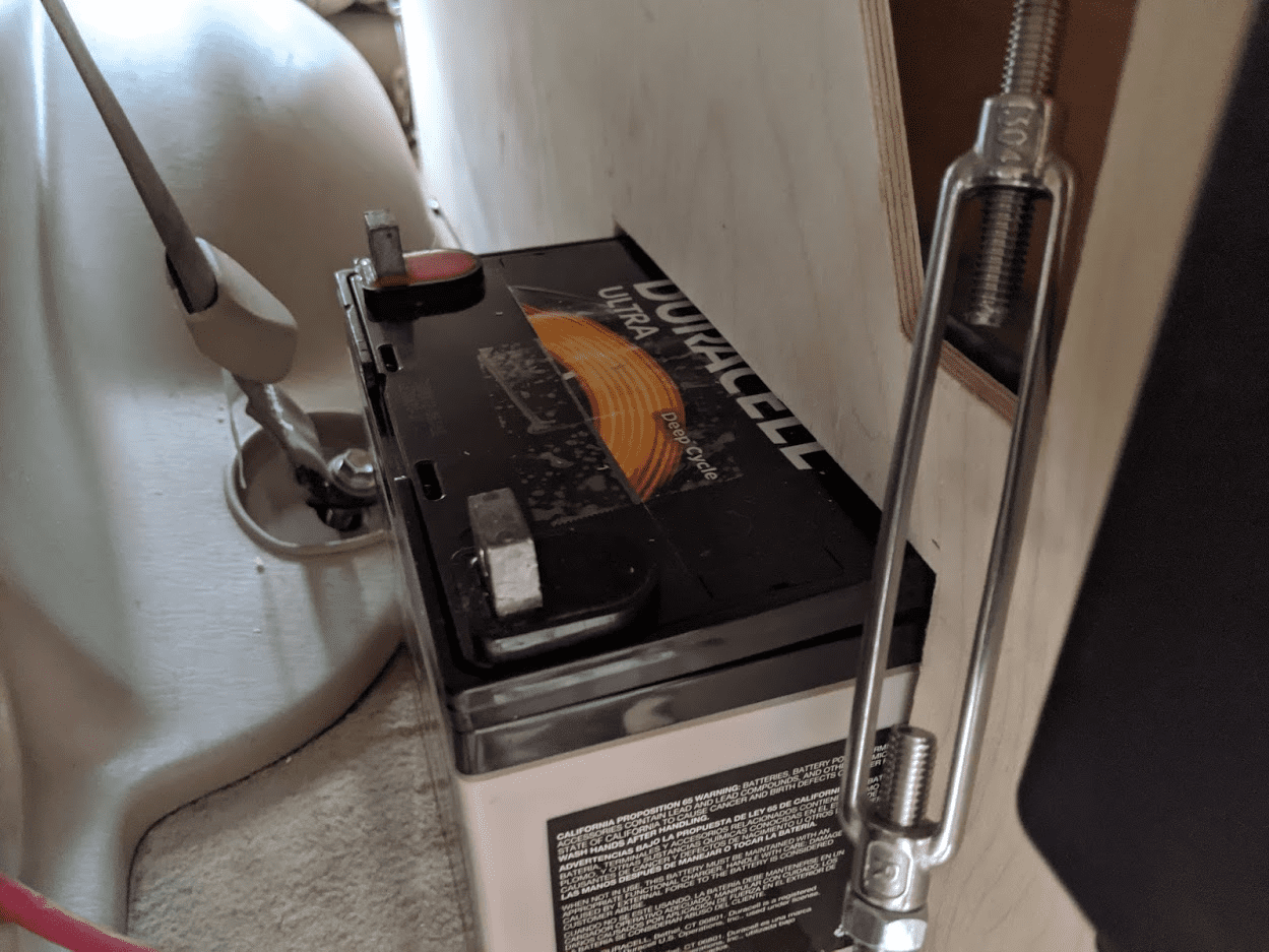

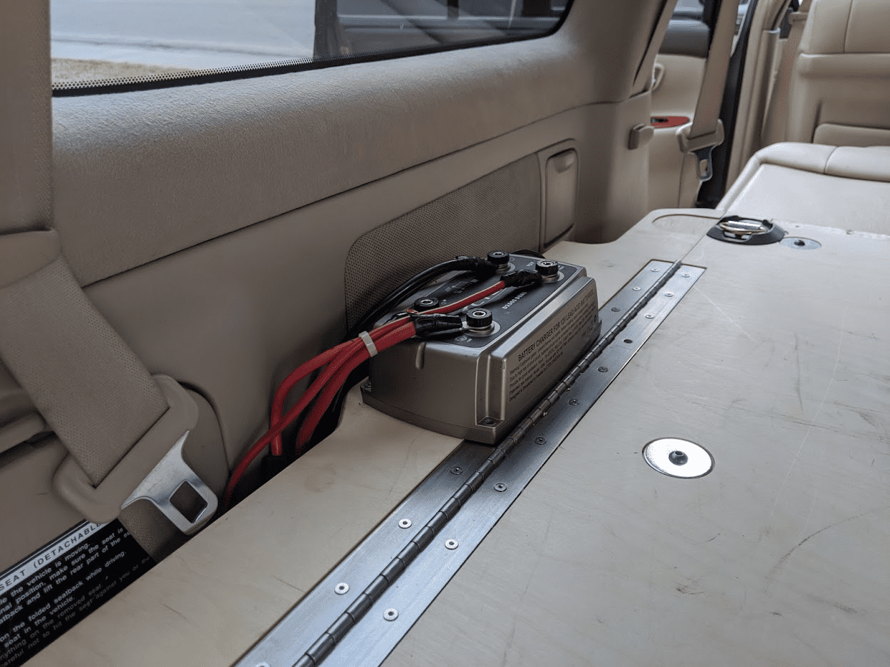

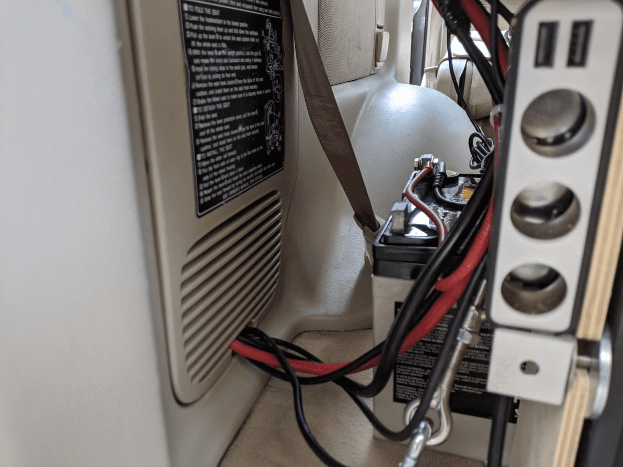

Also got the solar panel, DC charger and wiring redone and verified. The battery is tucked under the SS1 cargo divider nice and sung. I'll add a small strap to the side and it'll be neatly stowed and secure. The charger is a little exposed right now on the topside. I will likely move it to the underside or protect it up top with a custom cover, but for now I want to see the indicator lights and learn how and when this thing works.
I'd love to find a connector I can use here. All the loose cables are pretty annoying. Zip ties can clean it up a little, but a connector would pull the cables together and make removal a breeze.

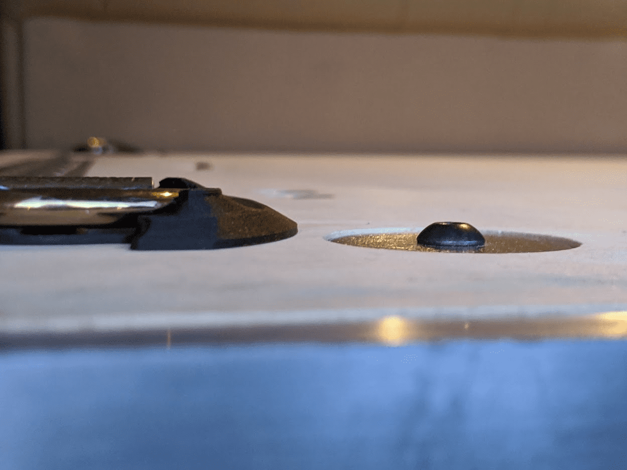

Recessed hardware and tie down ramps on the SS1. So glad to have this system in now! Rock solid and snag free.
This is what I'm very interested in. Do you have this second battery hooked up to the starting battery or are you only relying on Solar to keep it charged?
If its hooked up to the starter how'd you run the wires and what sort of wires/parts did you use? I'd love to have a second battery but the AHC in my lexus wont allow it right now, and I think I'd like to have a second battery tucked under my drawers.
Some have squeezed dual batteries into stock location, AHC is not prohibitive. Not sure what to search for but I know there’s a thread or two. I might try this.
Thank you, I'll look more into squeezing two batteries in the stock location.
I've got a CTEK D250S like this: 56-677 | CTEK D250S Dual Battery Charger
It does most everything you want in a 2 battery setup, including:
-Isolates the starting battery when the car is off.
-Charges the aux battery with solar AND the alternator.
-Charges the starting battery with solar once aux battery is full.
The only thing it doesn't do is provide a switch for jumping the starter battery with the AUX battery, but I'm not sure if that even exists in a charger like this.
Battery location is super flexible. First, I'd figure out what size second battery makes sense for you. If you only need a small battery, your options are plentiful. If you need a BIG second battery, then it's gets more limiting. For me, something pretty damn small is fine. I don't leave the grid for days on end and I don't run a coffee maker or big array of camp lights so I can get away with a small battery like the PO happened to have in this car. I think it's 36Ah. Not much, but plenty for day trips and simple overnighters. Once I get a fridge slide designed and fabbed that second battery should also allow me to keep the fridge plugged in a theoretically indefinitely cold. Should come in handy for Costco and for cold beer throughout a camp trip.
One thing I still want to incorporate is a battery box. I don't love having a live battery in the cabin, even if it's segregated under the SS1 platform.

Yeah, I think you need something very small. 36Ah should be plenty and those are small enough to fit a few places under the hood or in the cabin (ideally in a battery box).
