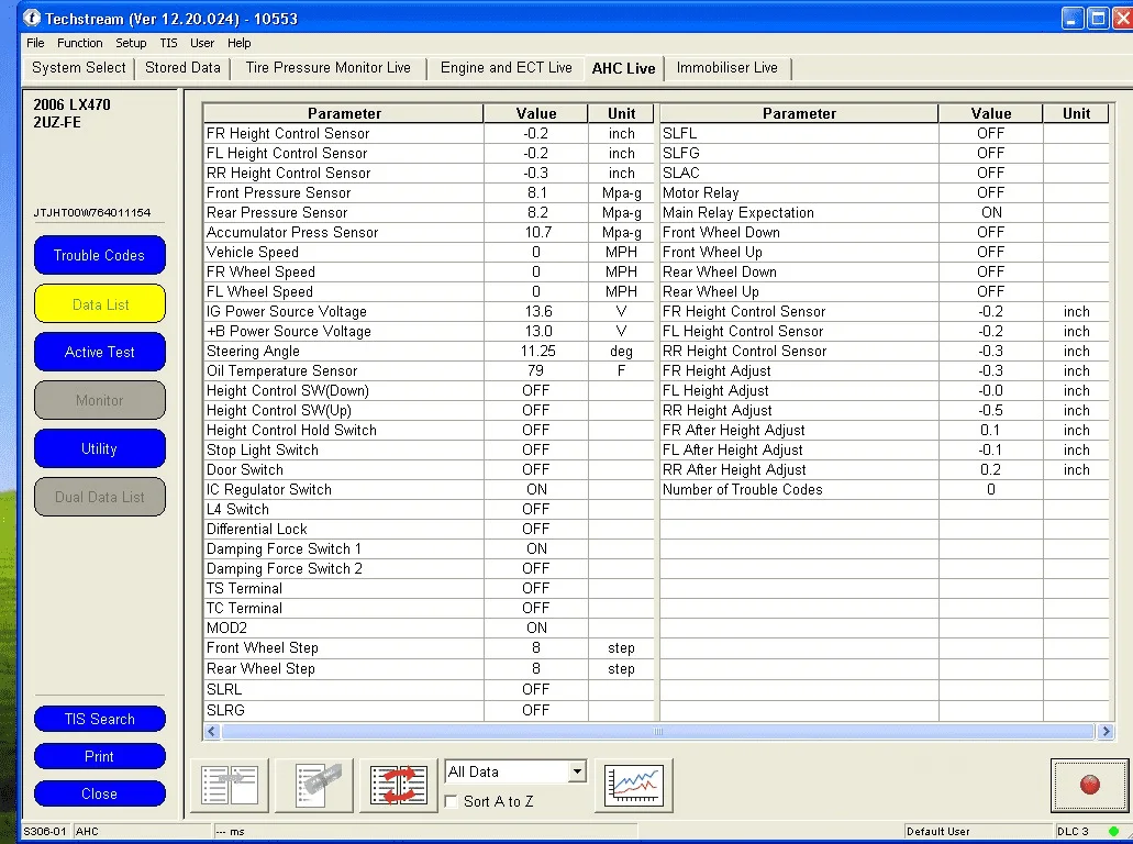

Here's a screenshot of AHC from my driveway the other night. Car was nose down on my driveway, so not level. I also tested nose up and pressures were still too high (no screenshot, but I recall the rear was 8.X and the front may have been high 7.X)

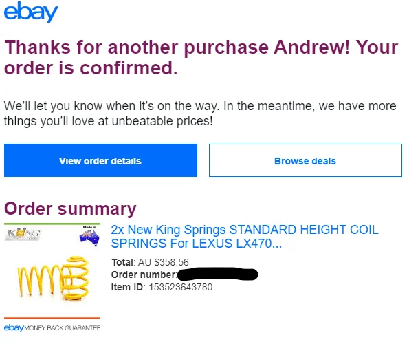

I plan on buying King Springs this afternoon as I'm pretty sure I will need those once I add some armor.

This might be useful to you. Here’s part of my cheat sheet I pilfered from @PADDO, I found these numbers pretty accurate for predicting pressure adjustments:
Front:
1 turn (torsion bar): -0.2 MPa
1” height (raise sensor): +2.2 MPa
Rear:
King Spring swap: -3 MPa
1” height (raise sensor): +0.6 MPa (stock springs)
210lbs over axle: +1 MPa (stock springs)
