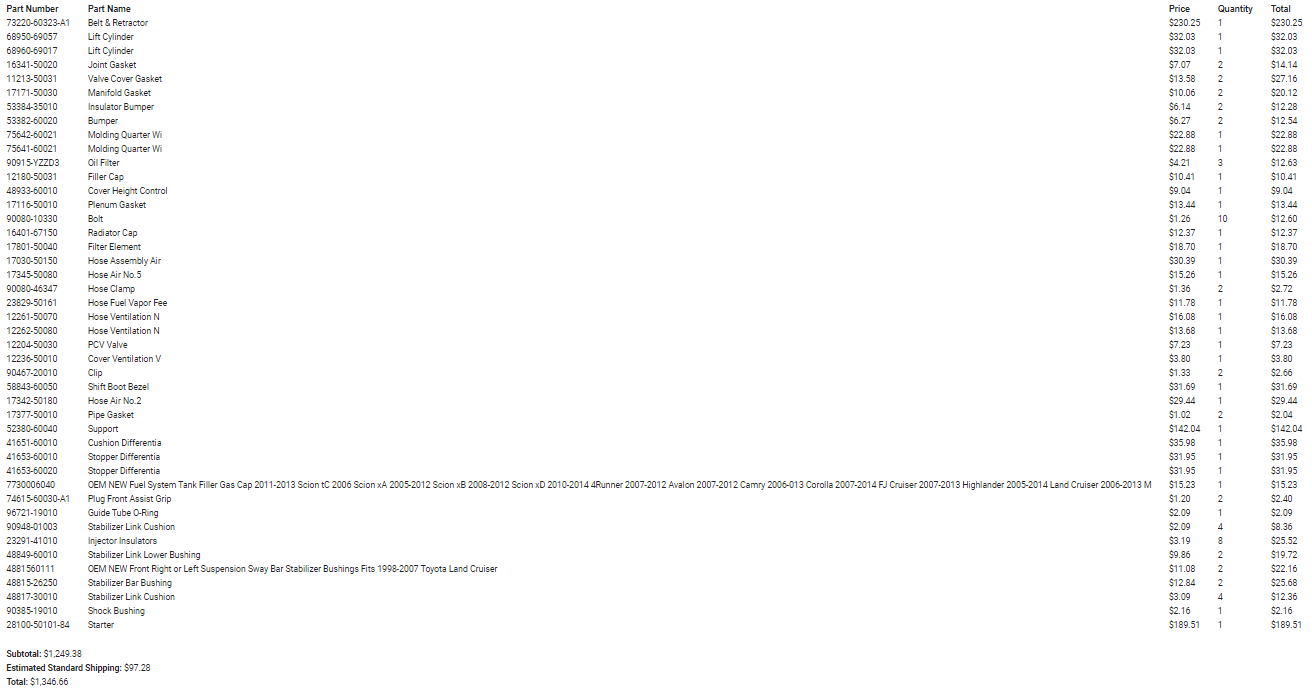

Where did you end up buying parts from?
Ebtoyota. (Boch Toyota). They seem to have the best pricing and they've been my go-to for a while. Shipping hurts sometimes, but I tend to save enough on the part prices that it's still a good deal.
I may have gone a little overboard with the parts purchase from Toyota...
