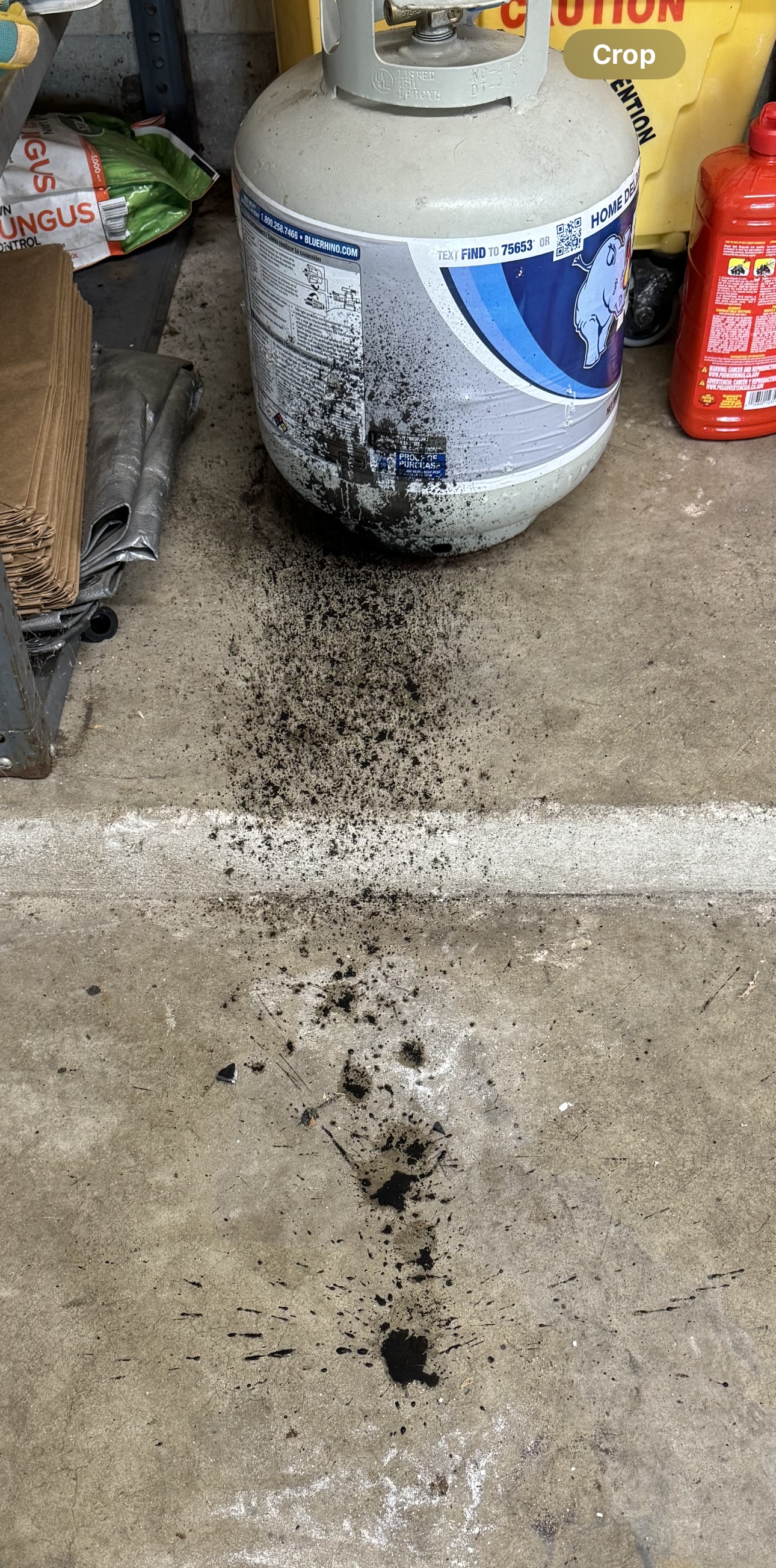

A new engine may be high on the priority list. This was after startup this morning. Hopefully it’s something simple. I never saw any oil out of the exhaust during our whole trip.
Maybe just a bad PCV valve? I had just shuffled The Squirrel around the day before, so it didn’t really warm up. Maybe just condensation and a filthy exhaust?
I’ll do a compression test as soon as I can.
It might just be carbon. Hard to say as it was filthy and mixed with water/condensation.
I need to do a compression test regardless.

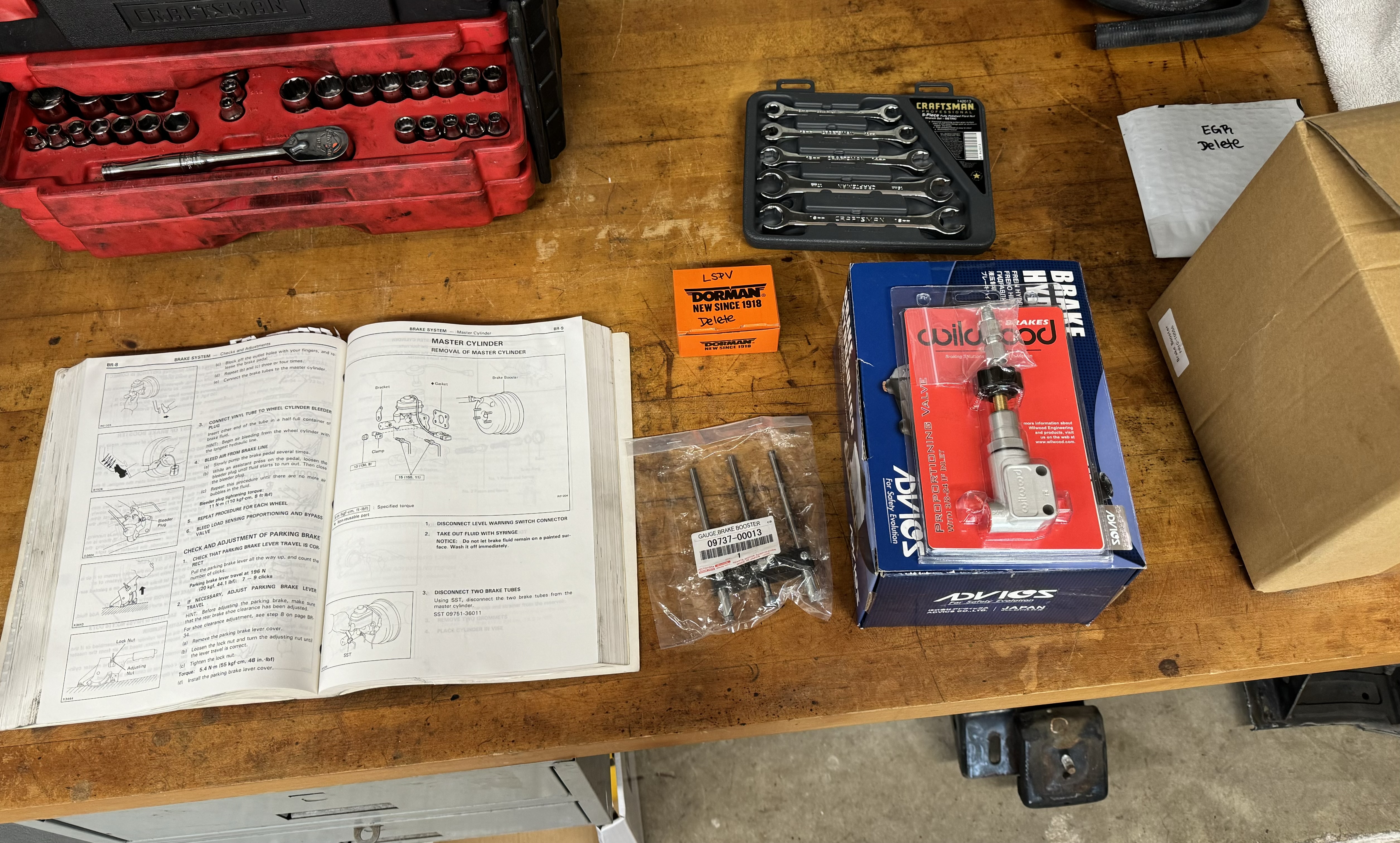

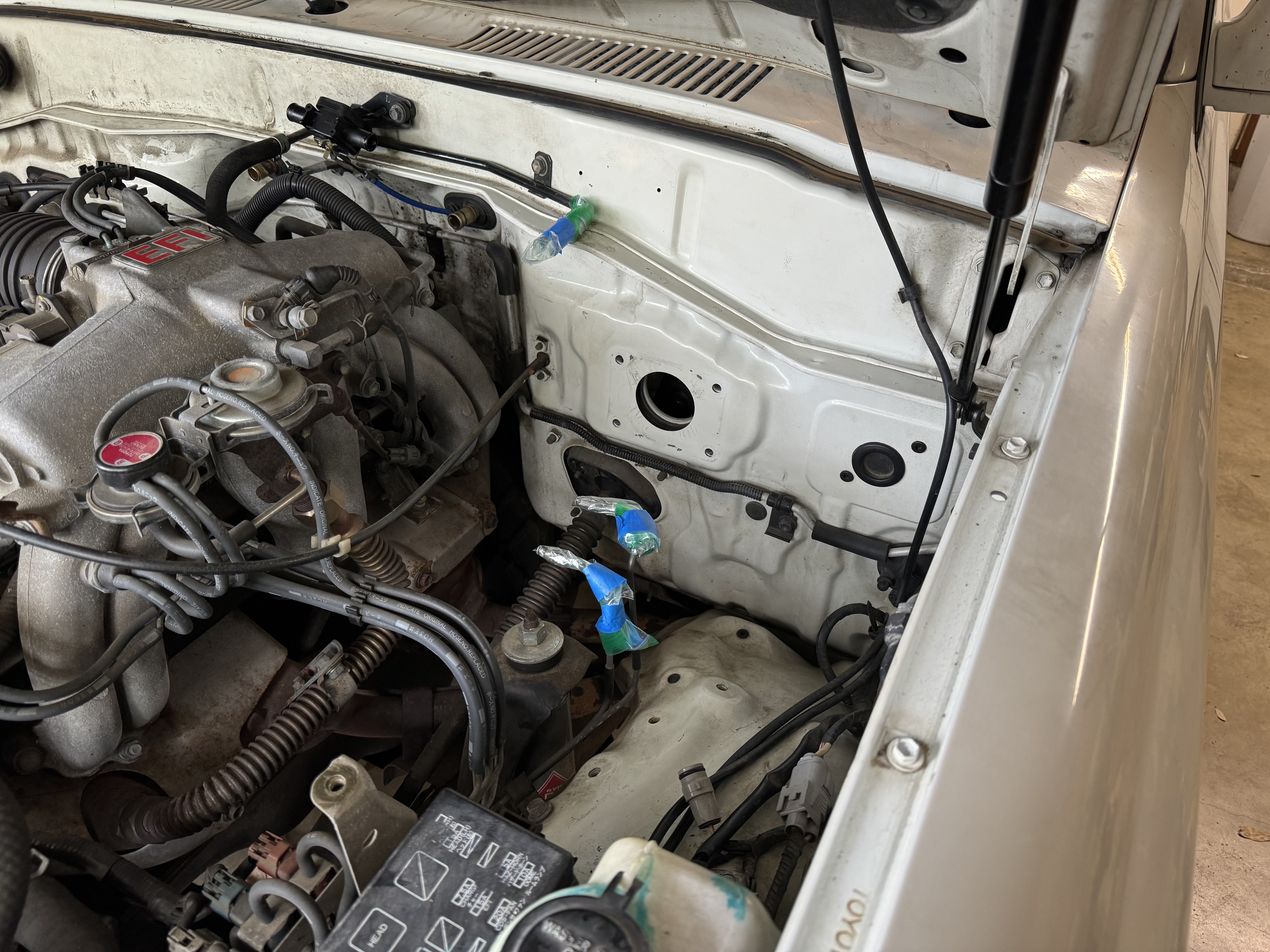

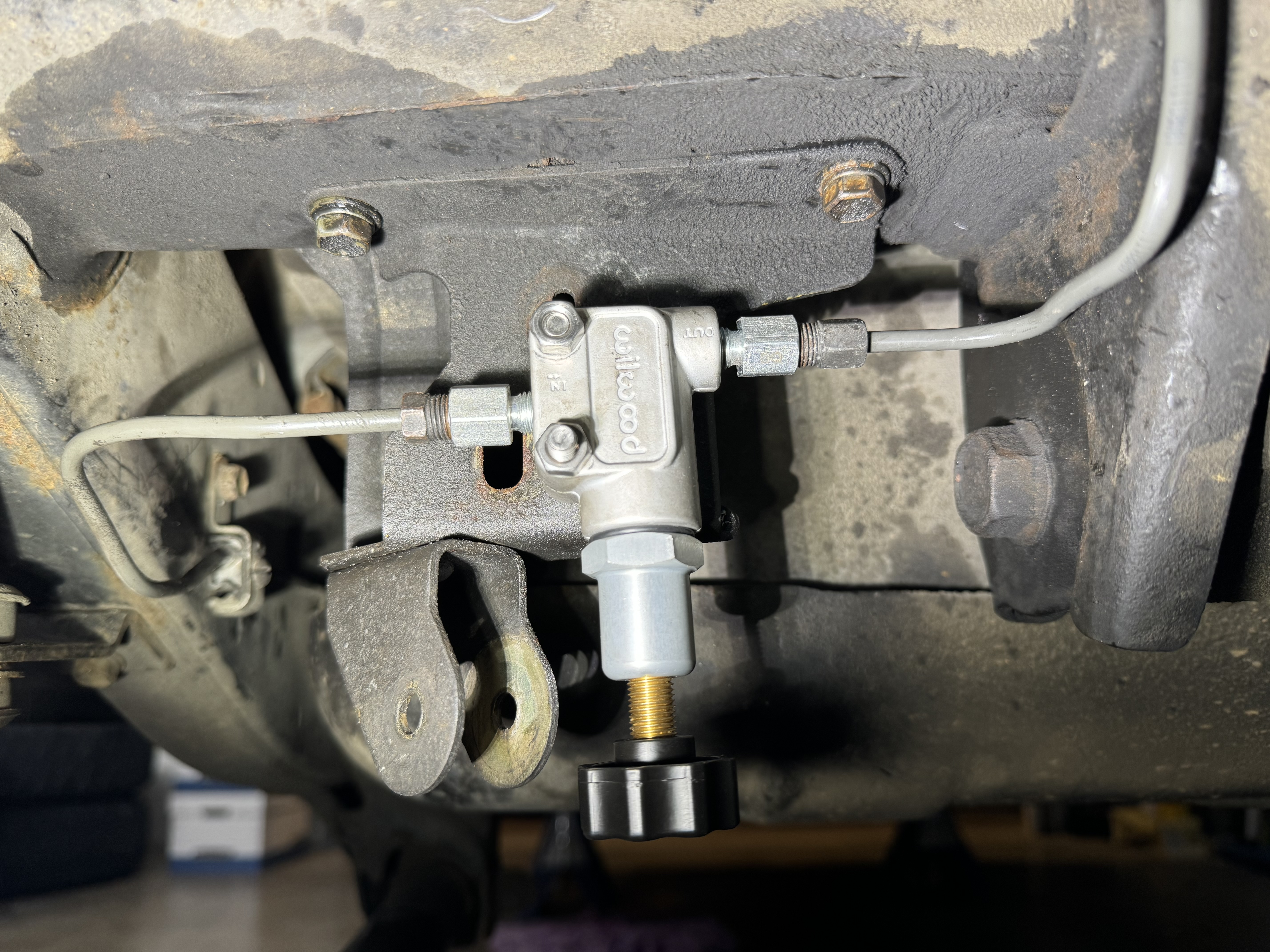

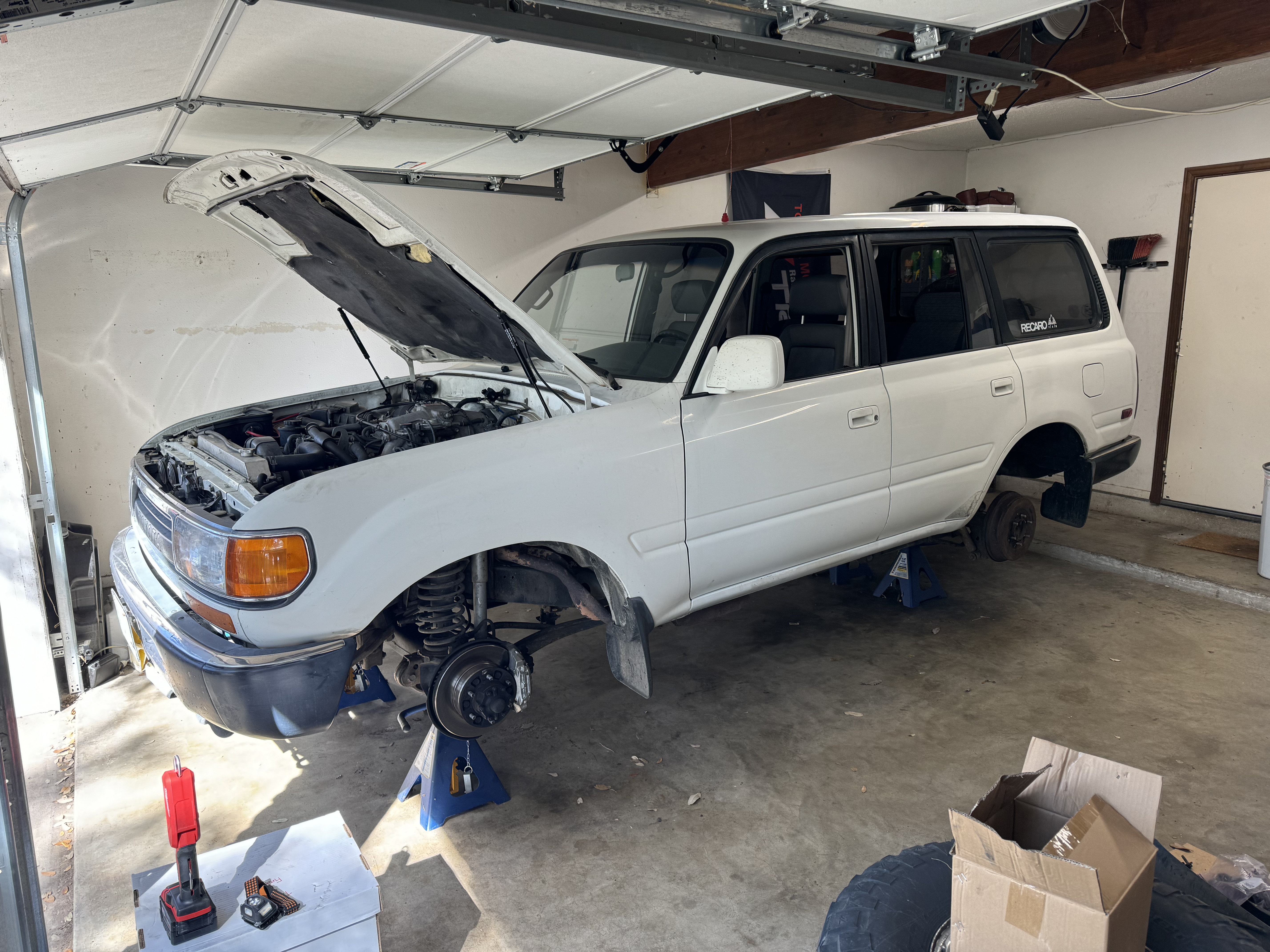

It is a beautiful day here in Central Texas! Perfect for brake work. I’m doing an LSPV delete, Wilwood Proportioning Valve, Advics Master Cylinder, and new Brake Booster.
I forgot to order brake booster and MC gaskets, so I’m at a standstill for now.
