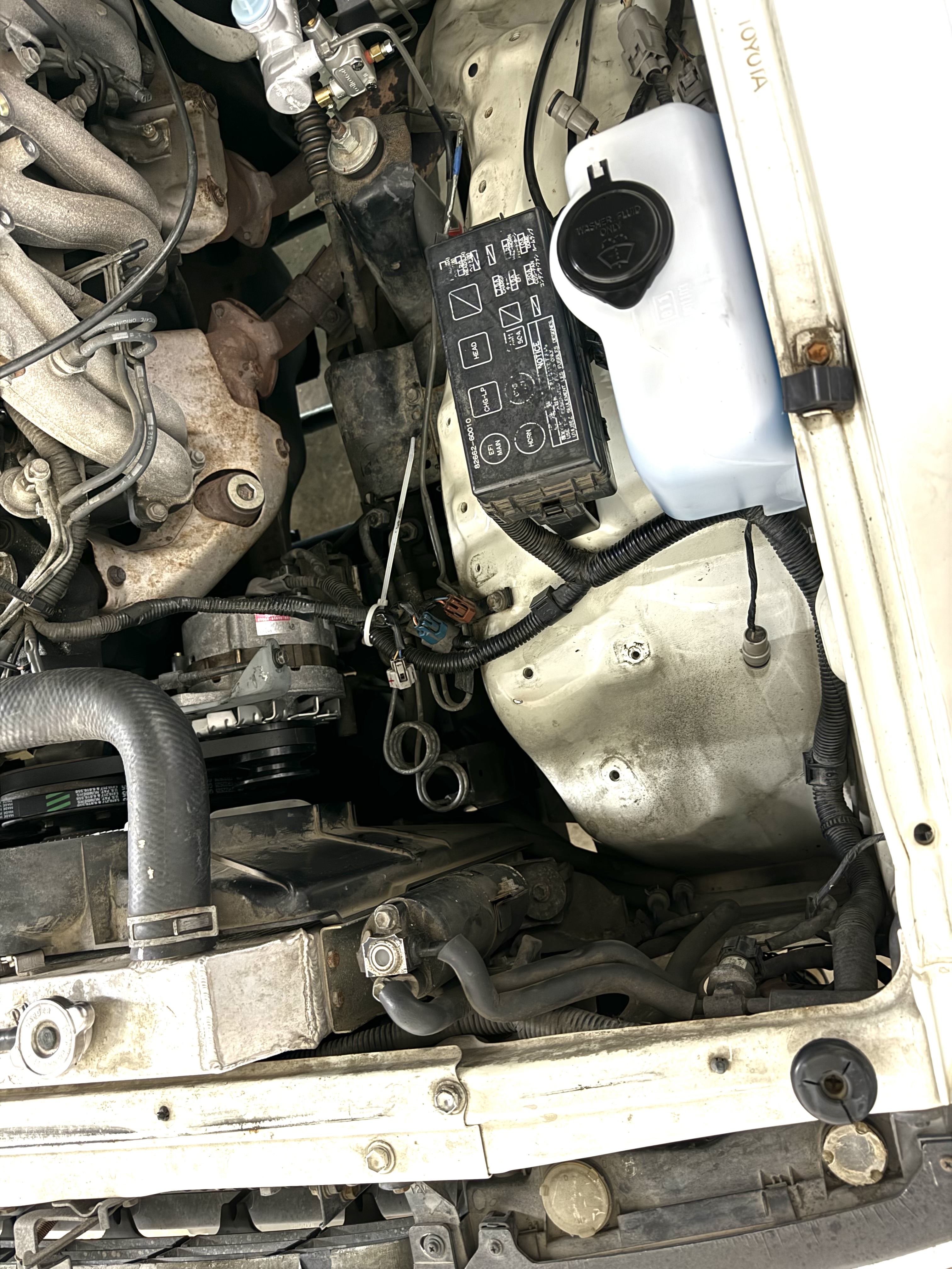

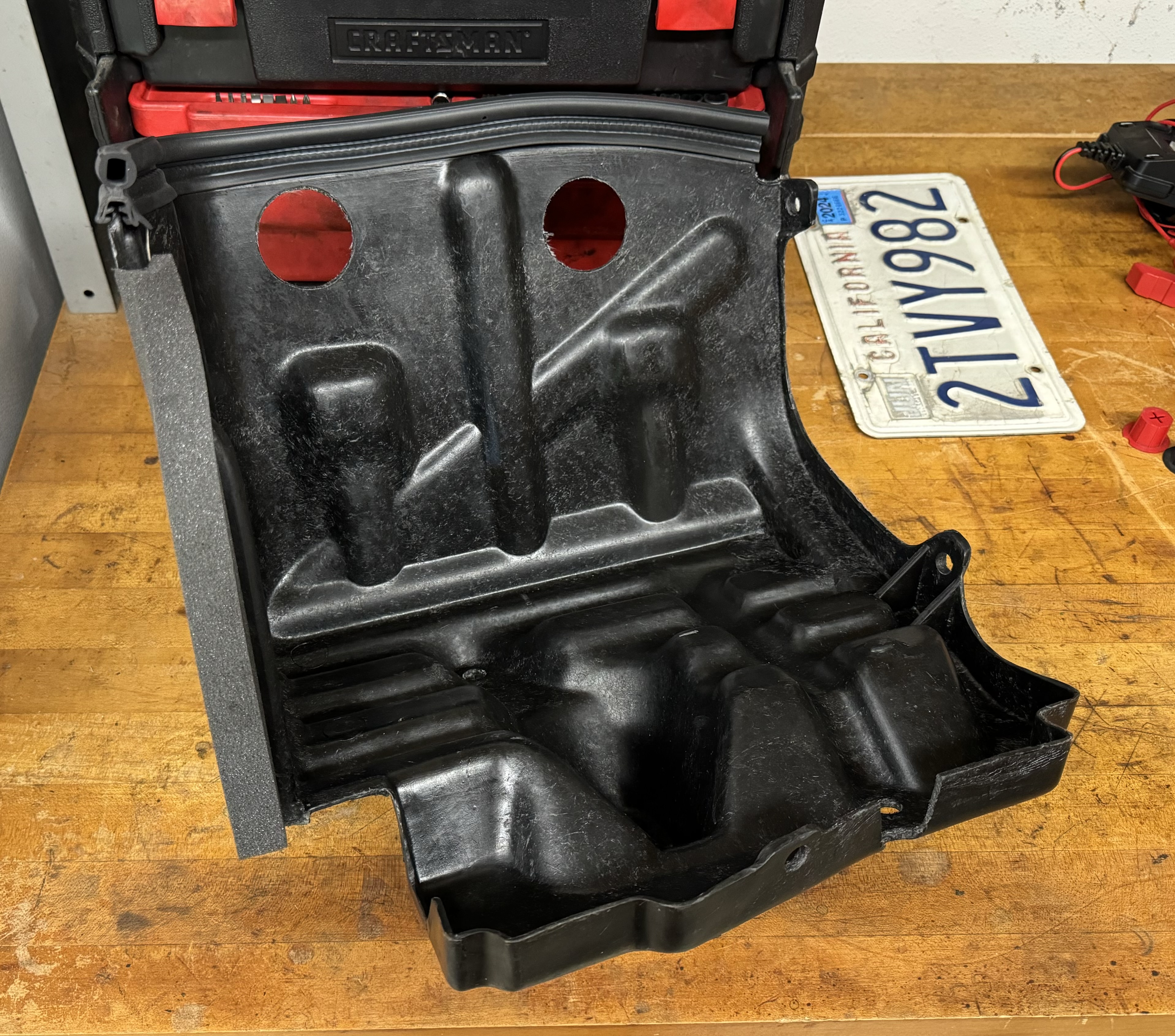

I picked up an FZJ80 battery tray for the driver’s side fender. Does anyone know, do you have to remove the A/C drier and radiator to install?
You do not. That tray can be installed leaving everything intact with the stock radiator (not sure if your aftermarket radiator changes any dimensions).
I moved my dryer up to 91-92 spot, it been a few years but I think you may have to make a small notch for the cooler lines.
Early '93 FZJ80 used that same drier and had that battery box there. 91-92 radiators physically interchange with 93-97 radiators. You should be good to go.

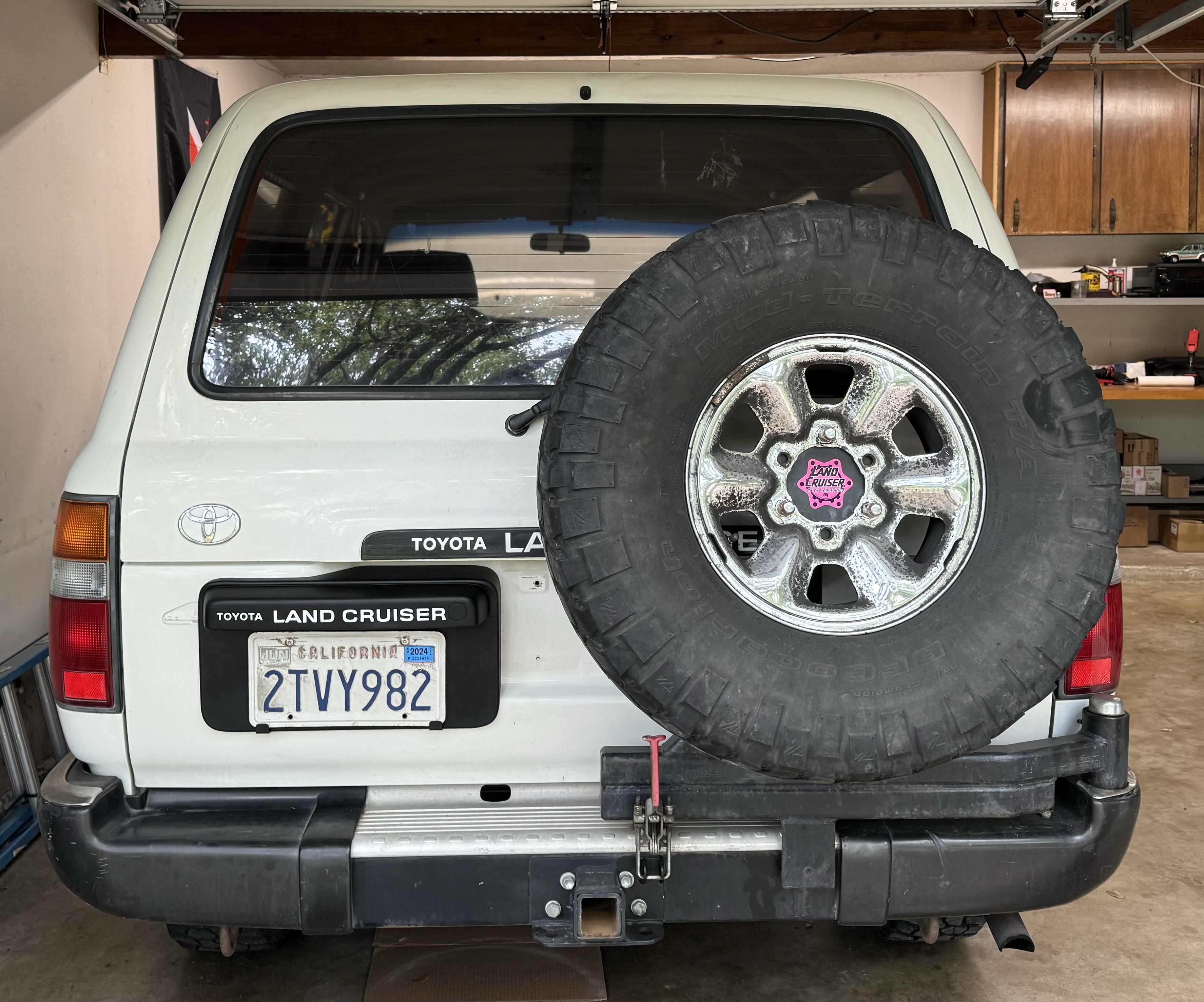

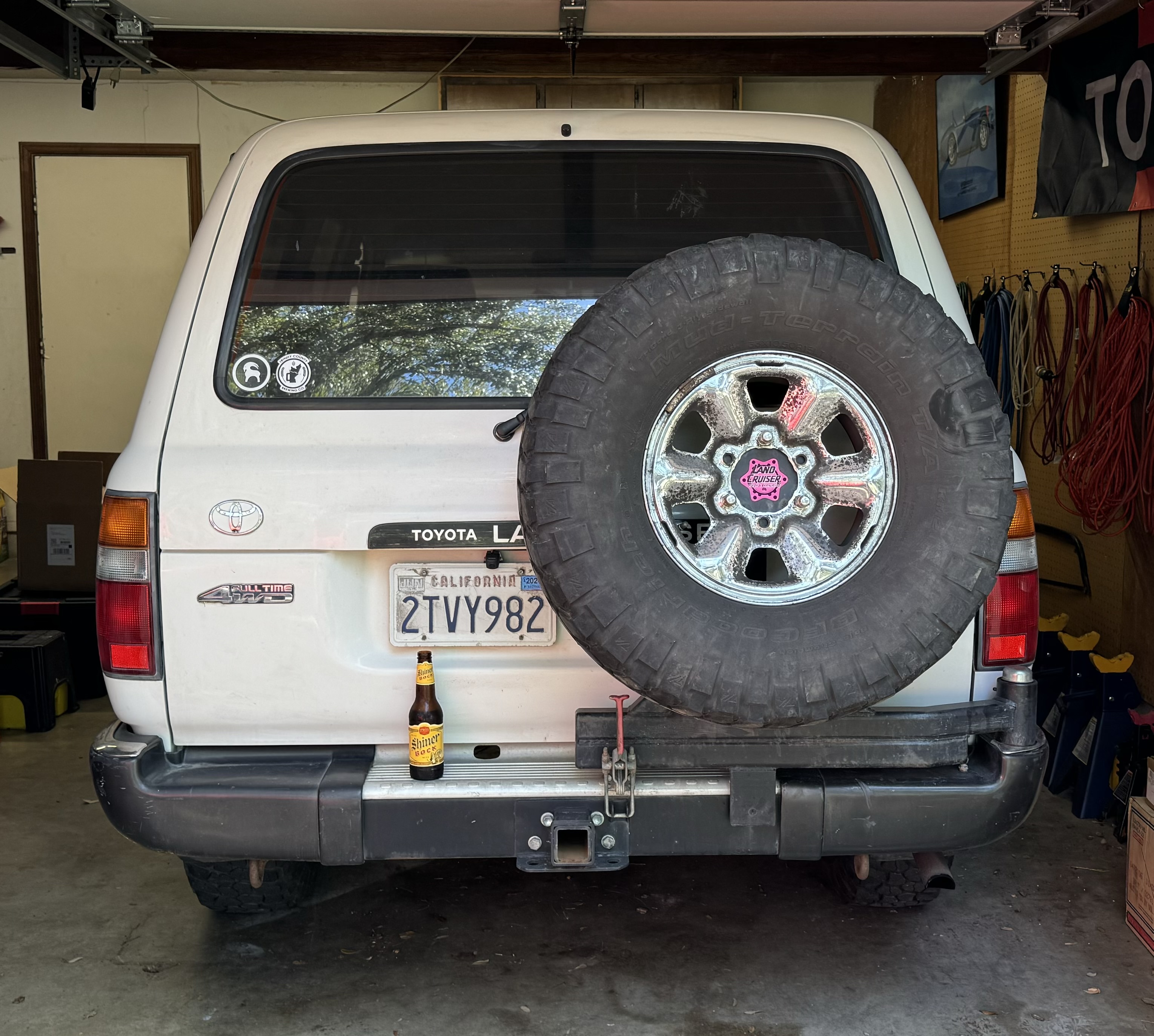

My truck came with a passenger’s side rear tire carrier from @SUMMIT CRUISERS Jr back when he was still making them. PO made a nice bracket for the license plate.
Before

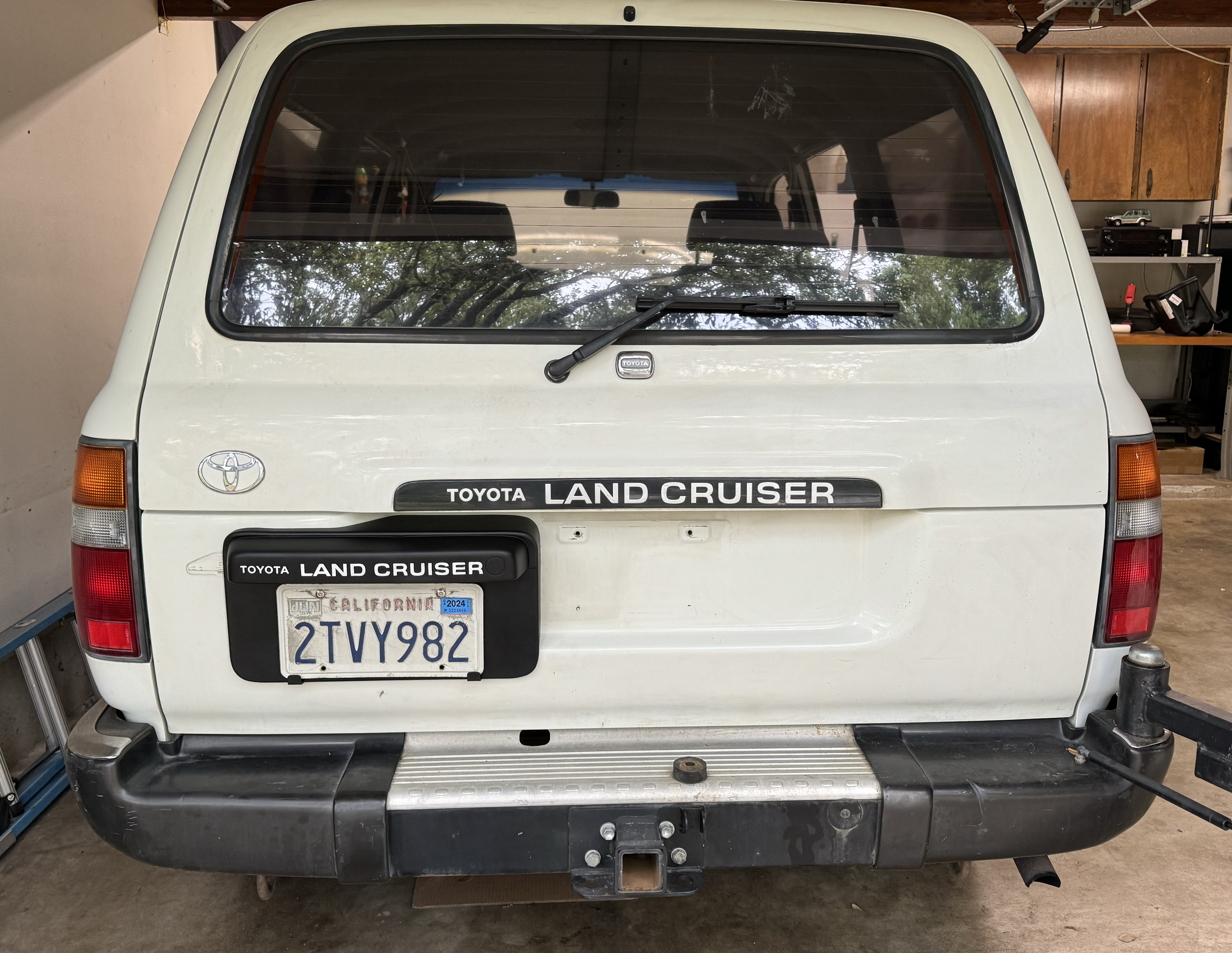

But I found a JDM license plate holder and decided to install. I’ll probably delete the second “Toyota Land Cruiser” garnish on the hatch since it’s redundant (and you can’t see half of it behind the carrier). Paint is also going to need some restoration from where I removed the “Full Time 4WD” garnish.
After
The condition of the license plate holder is not perfect, but decent from 10 feet.

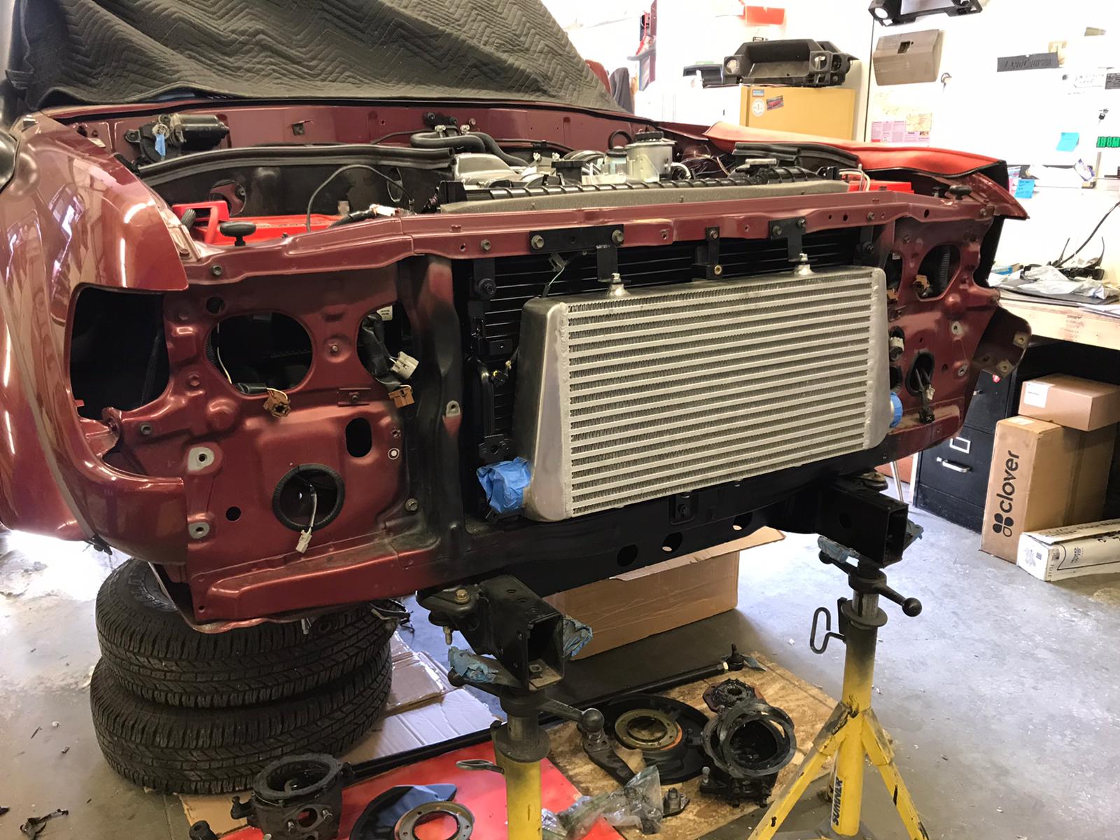

I realize the winch limits your options, but putting the IC there does create a lot of problems if you're in a hotter climate. The intercooler in front puts substantial heat into the radiator and ac condenser. To the point the cooling package is wholly ineffective nearing 100 degrees.
If you're planning a conservative engine (like sub 250hp) you might be better off just not intercooling.
Agreed. Compromises must be made if I want to keep the OEM winch.
Thank you for bringing that up. I have been thinking about deleting mine. I’m planning to keep my 6bt as close to stock as possible. I may build a small camper (less than 2000 lbs) but that’s the extent of my towing.
