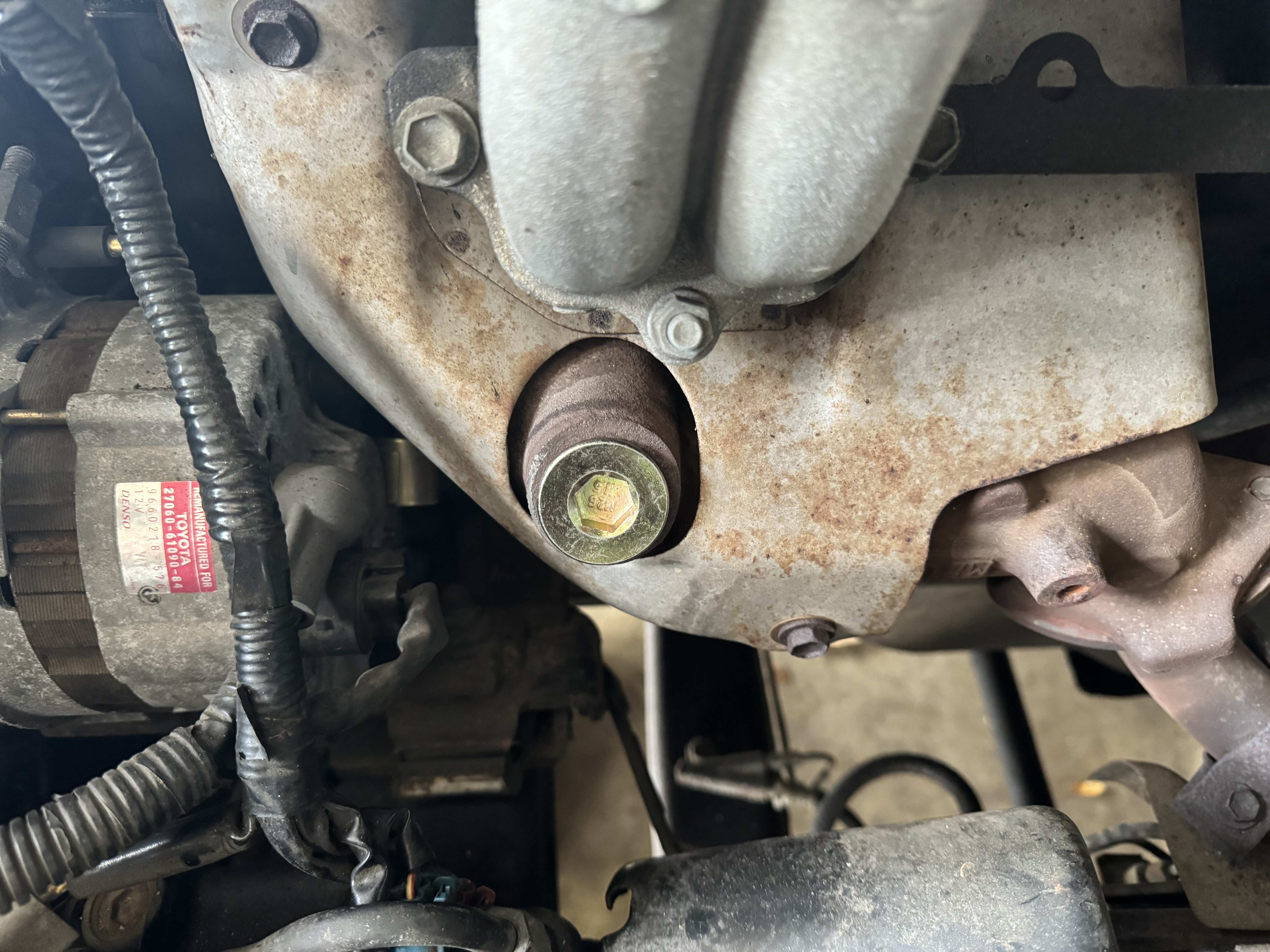

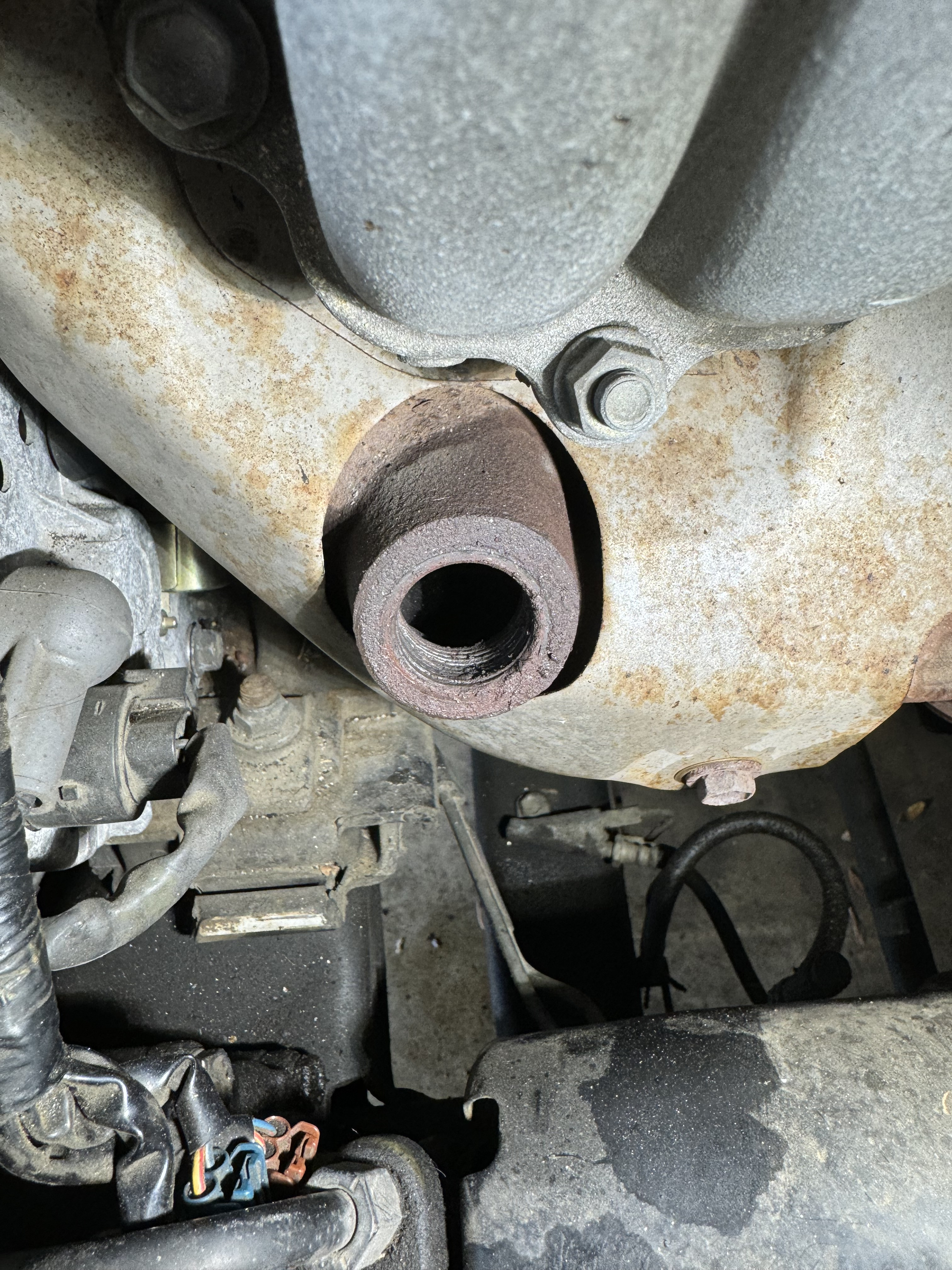

My EGR delete is not going as planned.
I’m going to run a tap through it. I think it is 26mm x 1.5 thread.

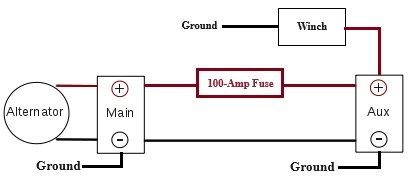

I realize most people like to run an isolator for the "house" battery. But I just want as simple wiring as possible. Mostly for a convenient place to connect my OEM winch (driver's side power).
Would this wiring setup work? Obviously there would still be the OEM fusible link (or alternative) between the alternator and main battery.

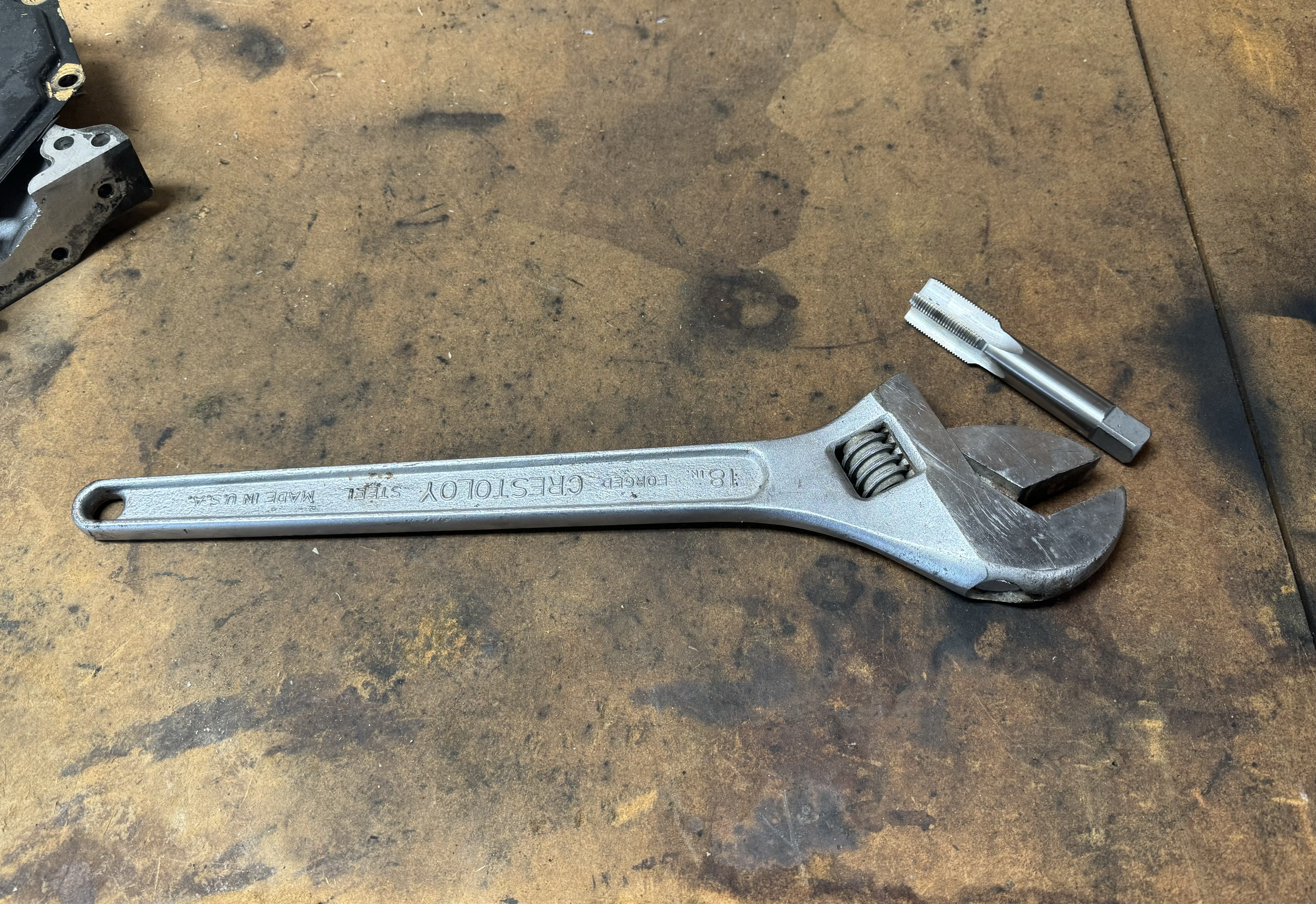

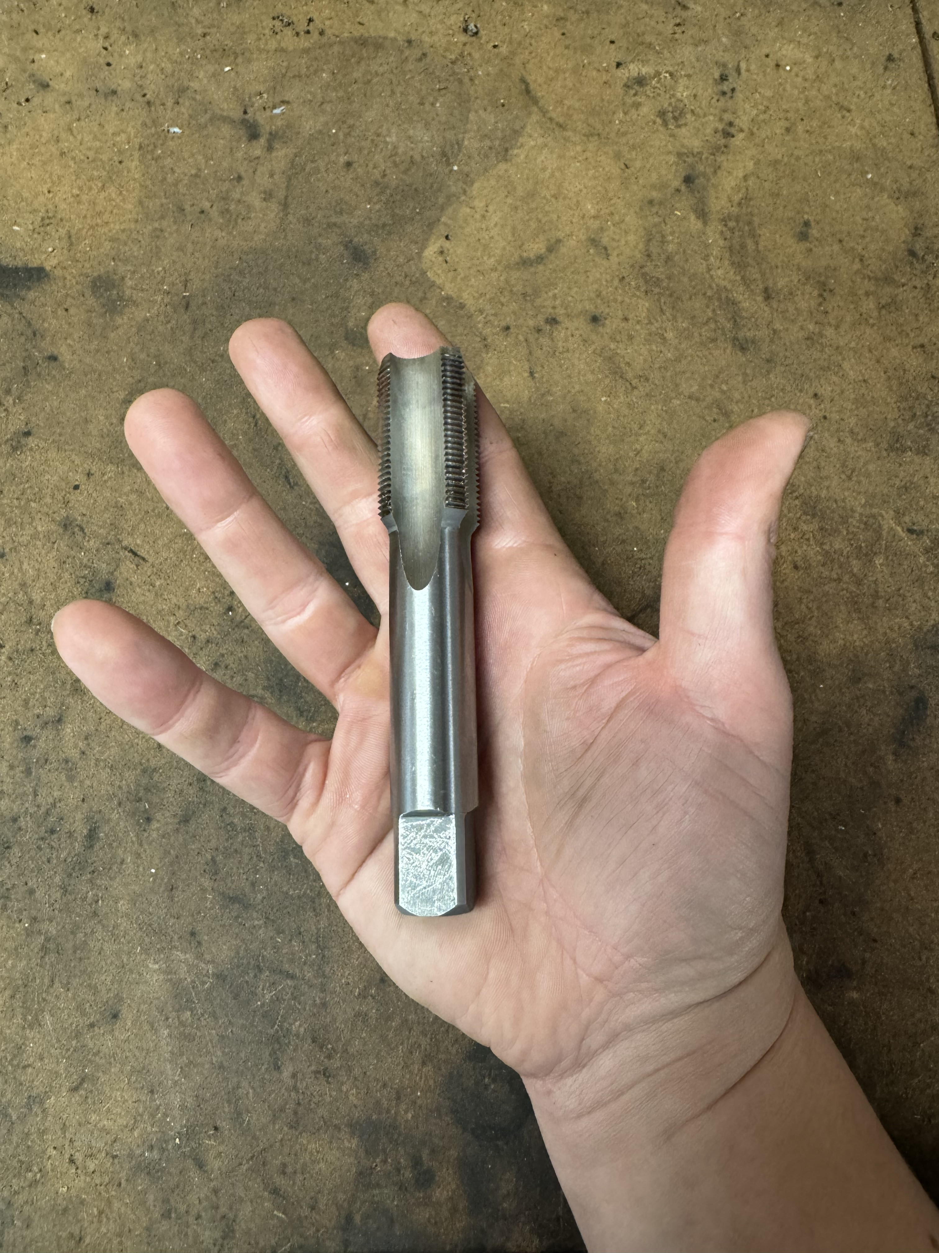

My M26x1.5 tap finally arrived, so I was able to wrap up my EGR delete.
I had to use this big monster to thread the tap. It was nerve-racking. The last thing I wanted to do was break the tap in the exhaust manifold. But it all worked out.

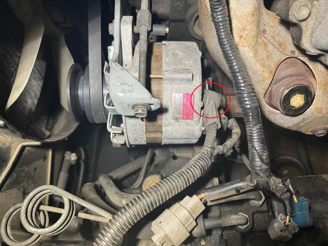

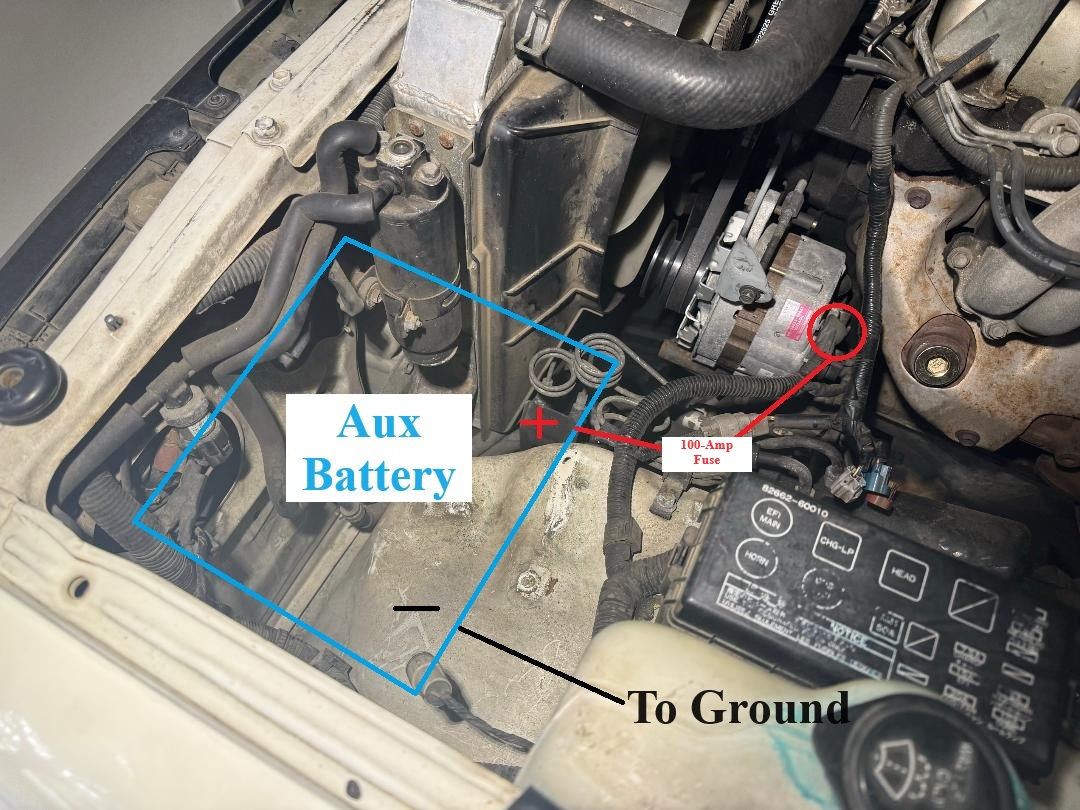

Continuing with this dual battery discussion...I noticed when re-threading the EGR port that the positive alternator post is right here.
Since the alternator is already wired over to the existing battery on the passenger's side, couldn't I just pull a lead directly from the alternator to my new driver's side battery? The connection between the two batteries would just be the existing wiring from the alternator post to the driver's side battery. Any reason this would not work?

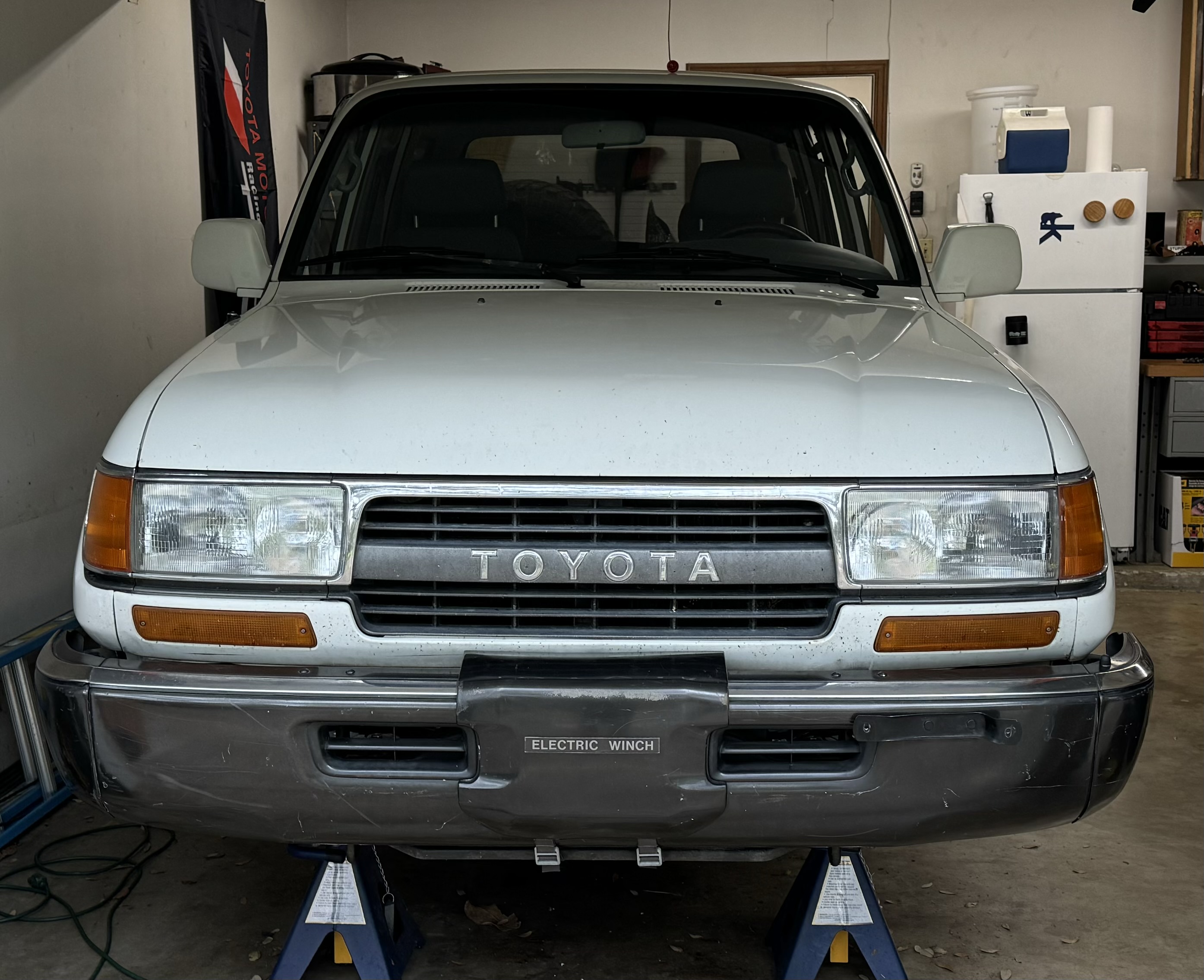

Winch is mounted and tested.
I need to find the factory wiring diagram for the winch because I’m not exactly sure how to wire the magnetic relay. And I’m waiting on a budget for dual battery setup (which will make routing the wiring a breeze).

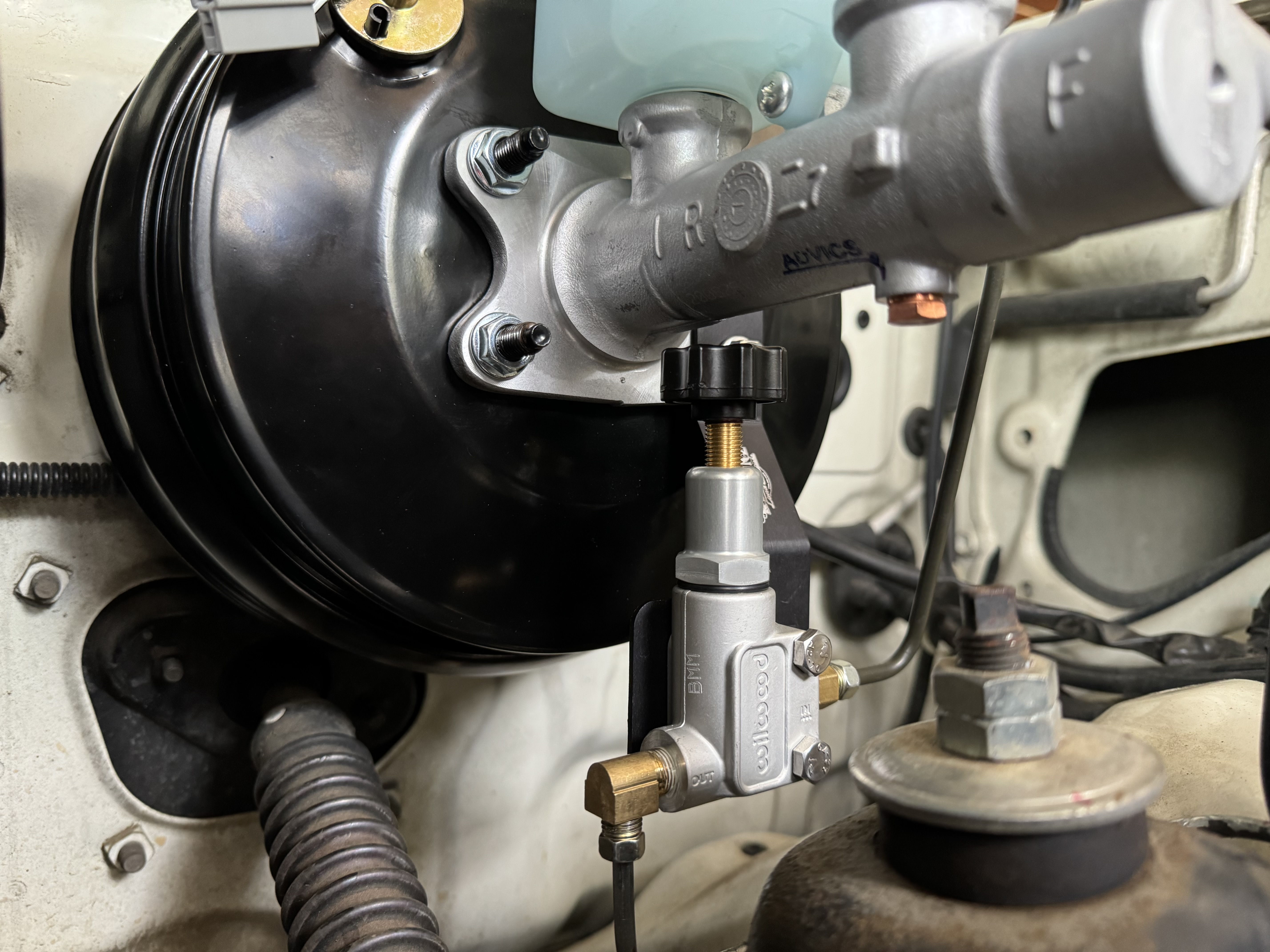

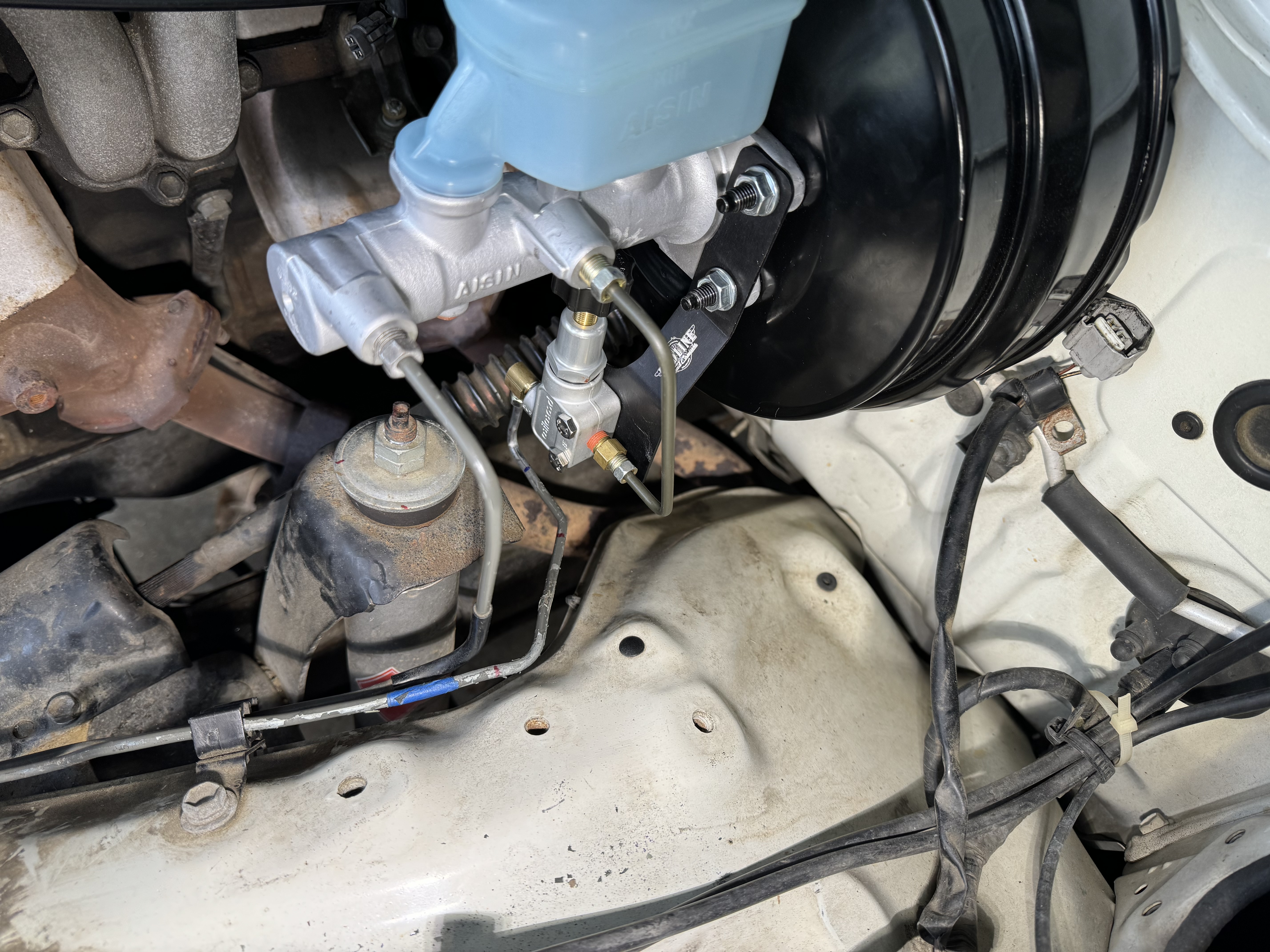

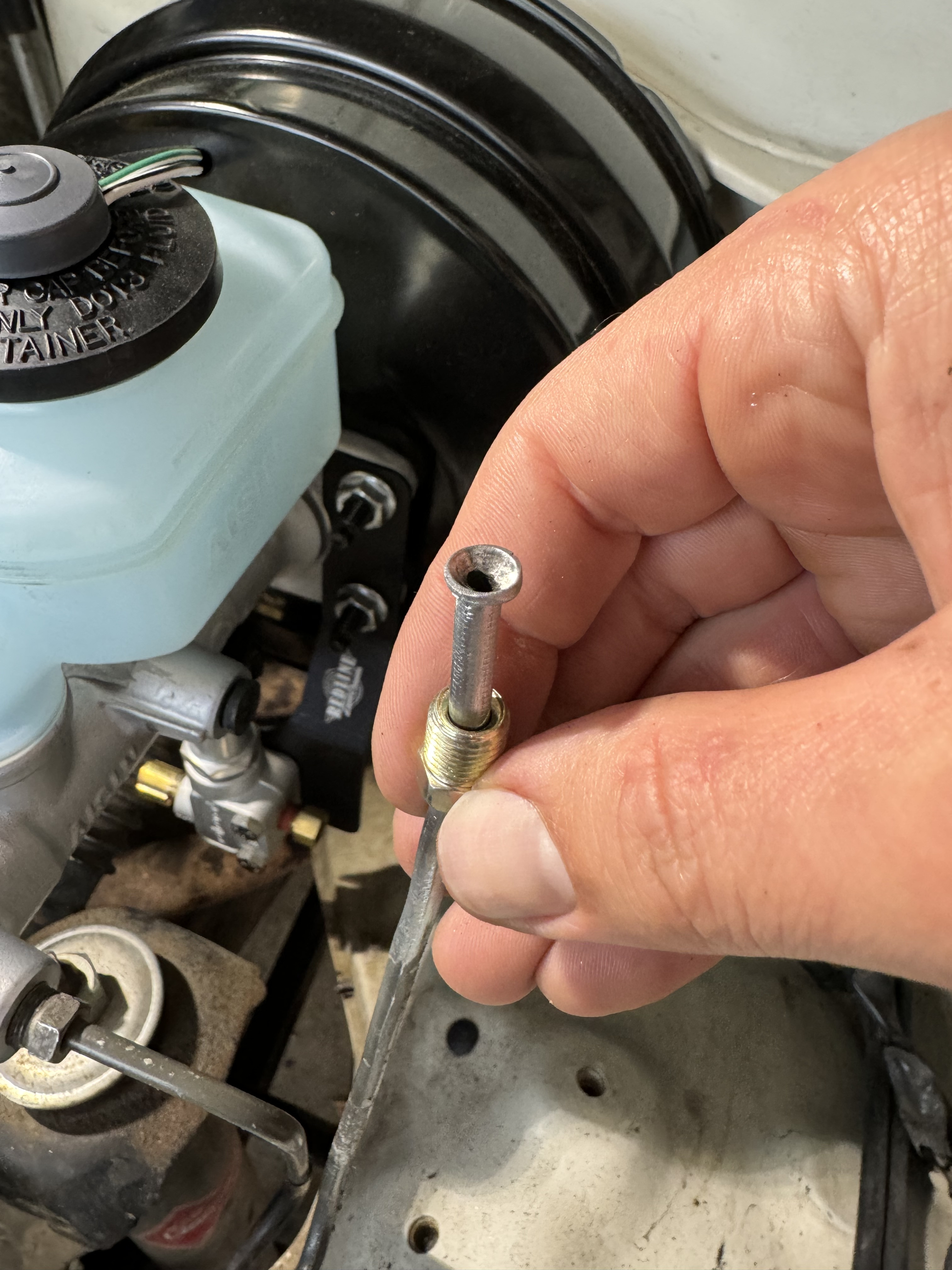

I decided to modify my earlier LSPV delete and Wilwood brake proportioning valve install.

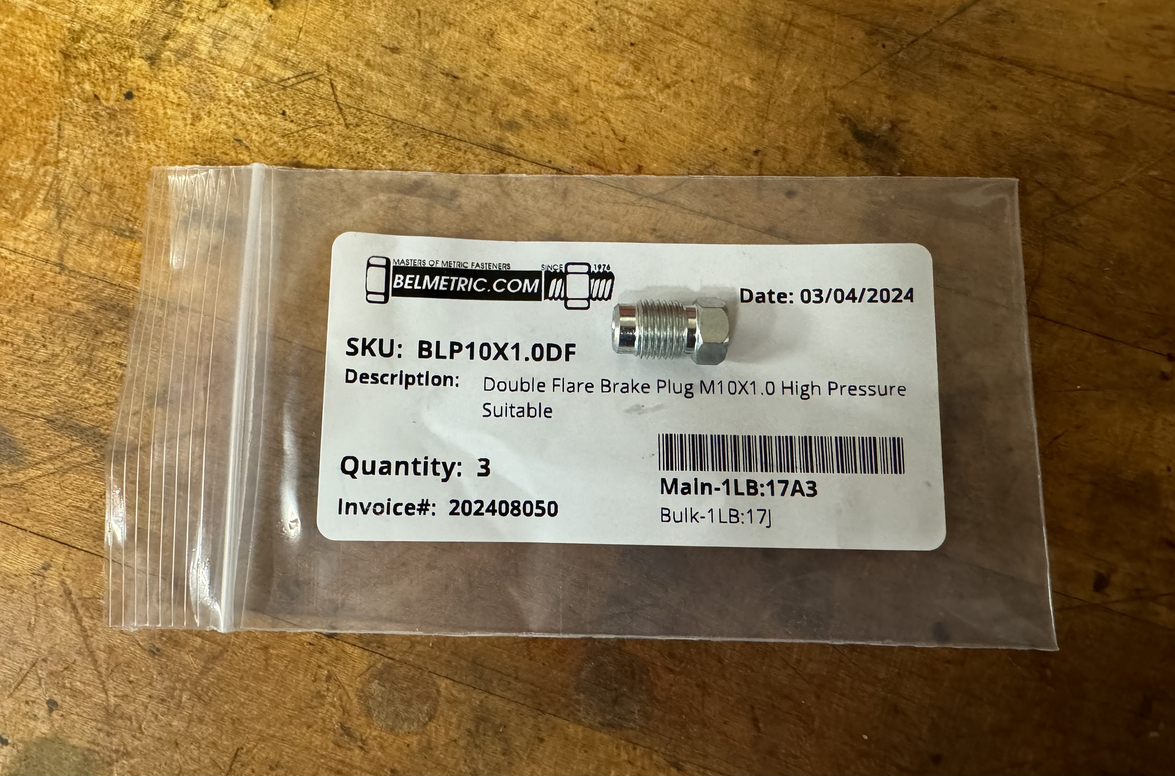

I didn’t like the prop valve under the truck where it could get dirty/damaged. So I just used a brake tee with one port plugged so I could mount it (I couldn’t find any regular M10 inverted flare unions with a mounting hole). I also decided proper brake plugs would be more appropriate than just a hex sealing on the threads.
I then bought the Redline Land Cruiser prop bracket from @RLMS to mount on the booster. This required re-flaring one of the brake lines and converting to 3/8-24 SAE threads to match the Wilwood. Plus custom bending hardlines. Huge PITA and would not do it again.
I think it came out pretty good. And most importantly, no leaks.
