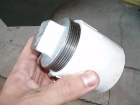

Pic 6) This is a side view of the 'contraption' I put together to seat the pinion seal. Its a PVC clean-out piece with a metal cap.

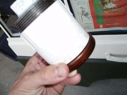

Pic 7) side view of my contraption wiht the pinion seal.
