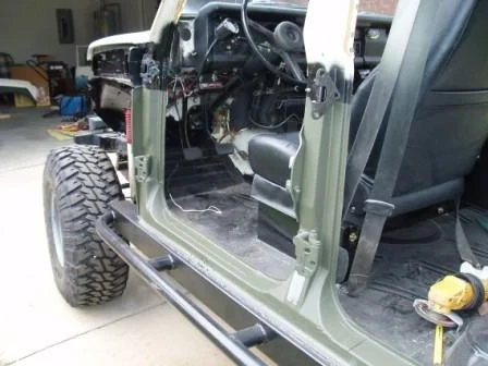

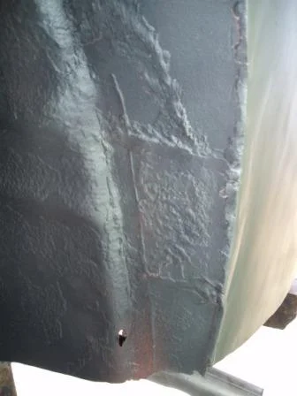

Little work done last night. All bare metal in Pic one from Post 348 was hit w/ Marine Clean, then Metal Etch, then POR'd. I let the POR get very tack (close to dry) and then hit with a few light dustings of spray primer. This seems to work well to allow me to top coat w/ paint and not have to sand. I need to get some of POR's primer...

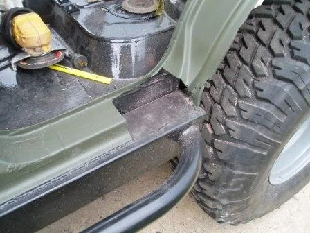

Six holes in Pic 2 Post 348 were welded shut and a split in the rear corner was welded shut. Welds were ground down and then slatered in POR. I'll have to sand this area before I paint.

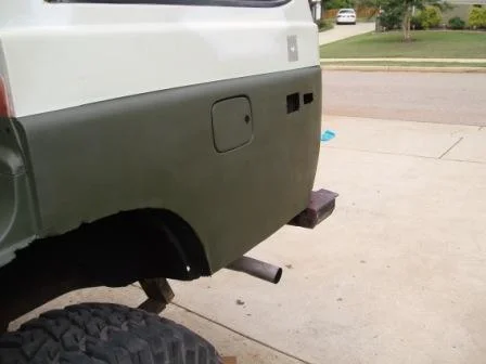

I wire wheeled and primed both rear wheel wells. I under coated the passenger rear wheel well. I have not welded the wheel well back to the quarter panel (should have done this before I painted) but everything matches up pretty well on this side so it will only take a few beads, then some sealer, touch up the paint and I'm done. I do need to weld in a new piece of sheet on the front of the wheel well but that is on hold until I get a few other things further ahead. The driver's side is a different story.
The driver's rear wheel well is rusted pretty badly. I was able to clean up the quarter panel to some degree but to get the rear quarter and wheel well to contact I had to cut about eight slits in the wheel well and then clamp the wheel well and rear quarter together. This works well to some degree but when doing this it is KEY to use a very thin cutting wheel. Using a thick cutting wheel makes it a pain in the keister to weld the slits back together. I got a little discouraged at my progress and right as I got my second wind I ran out of welding gas so I'm off to Tractor Supply in a bit to pick up a full cylinder.

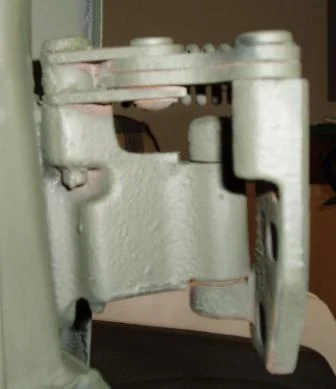

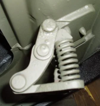

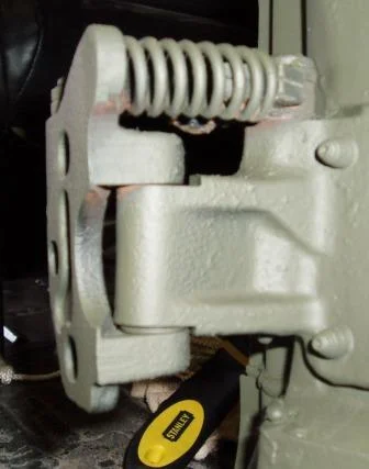

Still working on the hinges. I think my rear hinges will work for the time being but the front ones have gotta go - soon - they are horrible. I think I'll have one hinge coming from k9crazy but I need another and I'm not sure what side I'm getting from k9 . I might have to see what I can get from Dearborn if I can get ahold of him.
I don't follow what you are saying about the spring being held in place by a crimp...so I've attached a few pics of one of my hinges for you to look at. Give me some more info and I'll take another look.

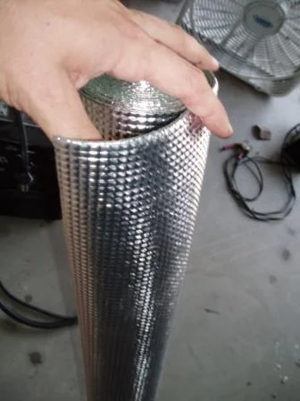

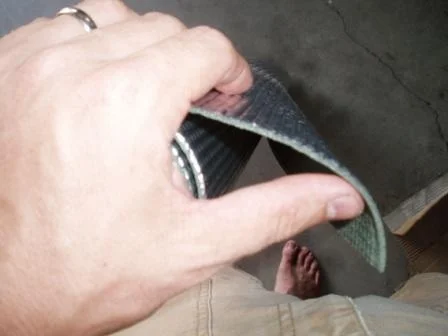

I picked up two 40 sqft rolls of foam and foil backed insulation from Big Lots yesterday. It was labeled for use under hardwood floors and is pretty thin but for $20 I got 80 sqft. I'm going to blue the two rolls to each other with the foil size facing out. I'm going to glue the two pieces together with spray contact adhesive and then attach probably with the same method to the bottom of my factory floor mats and a piece of carpet that will cover the rear cargo area. I'll eventually place Second Skin ontop of my floor and then slop Durabak across the entire floor.
See pics of insulation.

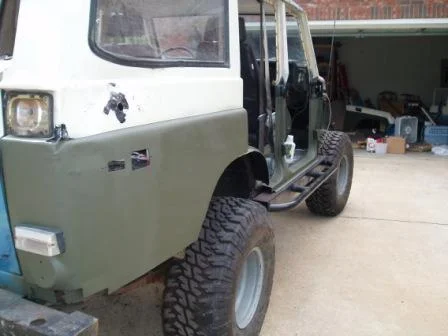

Right after I got my Piggie home I trimmed the rear wheel well lips off because they were, well, already half missing. Problem then was the wheel well was no longer attached to the rear quarters. I've reattached both passenger and driver's rear wheel wells to the rear quarters. Pics are of the driver's side. The passenger's side was much easier as I just clamped it in place and welded. The driver's side (pictured) had to be sliced, diced, and then welded in place. The metal was pretty thin so I had a ton of burn through and therefore my welds are NASTY but hopefully they will hold. I pounded on them pretty hard and they appeared to hold OK.
ETA: after welding the underside of the wheel wells were wire wheeled, primed and under coated. You can see in the first pic that I am missing some metal . This is hopefully going to be replaced later this week with new 16 gauge sheet.

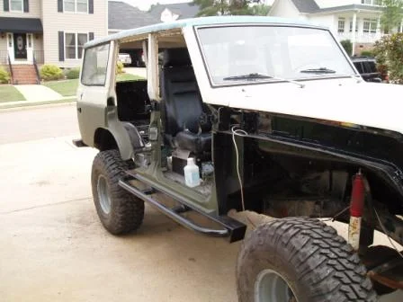

Couple more pics. Doors are all but ready to go on. I have to paint the ODG portion on one rear door. I also need weather stripping and guess I'll buy from JC Whitney in about a month (Cruiser funds are L-O-W). Hole on rear passenger quarter will need to be welded shut with a piece of sheet to fill the gap. I already welded shut six holes and one crack near the large hole you can see surrounded by POR.
Tomorrow I think I'll weld in the missing sheet metal to the rear wheel wells and either rip out the headliner, wire wheel out the factory insulation and attach the roof rust or I might pull the hood and work on some rust on the front edge and then paint the hood. We'll see what type of mood I'm in and if a neighbor is around to help lift the hood off.

Wow, looking sweet! Quarter panels look especially nice. :cheers:

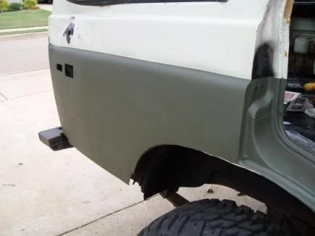

80 grit and an axe handle did wonders for the driver's rear quarter. The passenger rear lower quarter is good enough but the upper needs some work to get the window to mount again properly. I studied it a bit today and I think its not the dent you see from the outside that is the problem - the entire upper rear quarter below the window is pushed inwards. That should be an easier fix with a jack and some boards....
I like the looks of the rear wheel wells without the lip....
That was my only real choice here. If mud flying up from the rear wheels becomes a problem I can add the rubber flexible flares from JC Whitney but I'm not a big fan of their looks.
