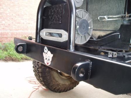

Pic 1) front bumper with a nice new coat of paint

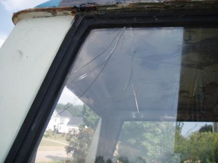

Pic 6) Doh! I had to beat the ever living tar out of the drip rail to get it to go up. I didn't know I broke the windown until I was done, hopped off my stool and took a look - Doh!!! o well
