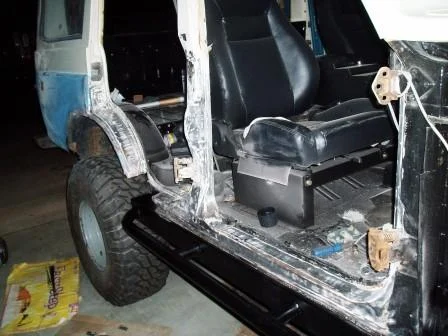

Pic 1) Passenger slider painted and A, B and C pillars cleaned up in my search for rust. The only thing I found that worries me is rust on the factory rocker - or what is left of it. I am going to POR the outside for now and try to slap some on the underside but eventually the IPOR rockers will have to be cut out, the rust treated, and the IPOR rockers re welded in. No biggie.

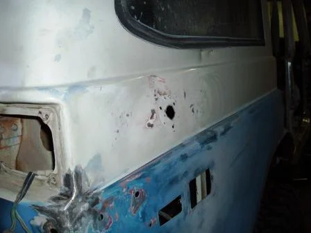

Pic 2) This is the result of what I call "Todd's Folly." :grinpimp: I've been working on pushing this dent out a bit. It came from when a PO flopped the Piggie on its side at GSMTR. I am going to see if a slide hammer can't help out a bit. I'm not looking for perfection - just smaller raisin patches. You can also see where I have been working on cleaning up the rear quarter. I have about a one by three inch section of rocker I need to cut out to get rid of some rust. I also need to weld shut some holes, weld the wheel well back to the rear quarter, then it will be time for paint on the rear quarter (only ODG as I will paint the white section when I replace the rear rubber) and I'm going to wire wheel out the wheel well and slap up some undercoating.

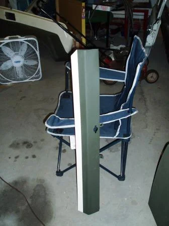

Pic 3) A pic of my front doors finished. Rattle canning is fun! :o

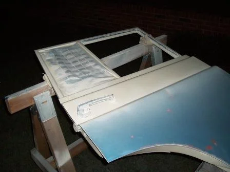

Pic 5) Passenger rear door painted white. Underside is already painted. Today I hope to get the ODG on and slap on some matte clear coat on the green and move on to the last door.
eventhough;2491412 Pic 2) This is the result of what I call "Todd's Folly." :grinpimp: I've been working on pushing this dent out a bit. It came from when a PO flopped the Piggie on its side at GSMTR. I am going to see if a slide hammer can't help out a bit. I'm not looking for perfection - just smaller raisin patches. [/QUOTE said:
You're going to ruin the aerodynamics....
TJK
She's very sensitive to poking and prodding. :D
I was afraid that I'd break that window again if I popped that dent out. Funny thing though, the only infomercial product I've ever purchased was a Dent Doctor. Worked surprisingly well on small dents and even on some medium sized dents. But the dent in the back of the pig shrugged and laughed at the Dent Doctor. No way.
TJK
If by "Dent Doctor" you mean one of those big suction cups my neighbor had one. I stuck it to this big dent and started pulling from the outside in. It worked well until it hit an uneven surface it couldn't stay stuck to. I decided to give it one last good tug. I thought it was holding fast but apparently not. It popped loose and I went stumbling about 20 feet backwards into the house. The neighbor of course was watching and found the entire scenario hilarious.
I had that very same experience, except I only brought the Dent Doctor out in the dead of night when no one could see me using it. :rolleyes:
TJK
My vote is to use a highlift and some 2x4's to spread the weight.
Todd has a good point - before I do any more prodding or pushing I am going to need to remove that rear window. I would not be happy if I broke that glass.
For the time being I am going to leave that dent as it is and slap some POR or primer over the bare metal. When I pull the headliner and the rear windows I'll work more on that dent.
Dang - I've got a lot of things to do on this Pig.:lol:
It's kind of like a golfball. The dimples create turbulent flow for less drag...that's what those snots on the roof are for, right? That's why I didn't mess with them...
Dangit - I've already flap disc'd those down. There goes my fuel economy! :D
