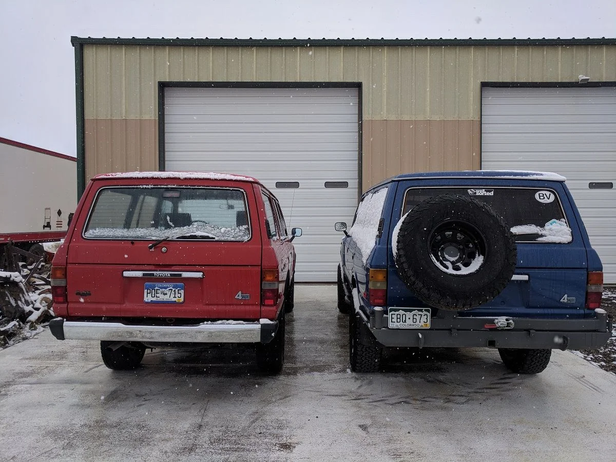

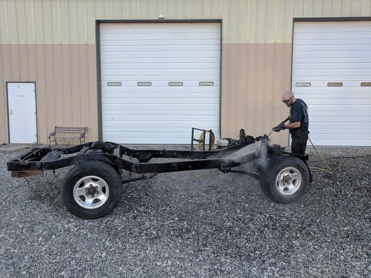

Saturday we had blue skies and perfect weather, 60 degrees and sunny. Time to get the 80 frame cleaned up...
Sunday (today) the weather changed a bit... high of 40 and snowing all day. Cruiser-cicles abound....
Interesting note - the rig on the right has a Tough Dog Heavy kit with a 1" body lift. The rig on the left (pre-Goat transformation) has an OME Dakar kit. Full stinkbug on the red truck, the nose is easily 2" below the blue one.
Had the same issue with my Dakar kit.....I'd be pretty happy if the front springs were arched more. A or B designation spring in rear?
These are B designation rears - CS017RB part number.

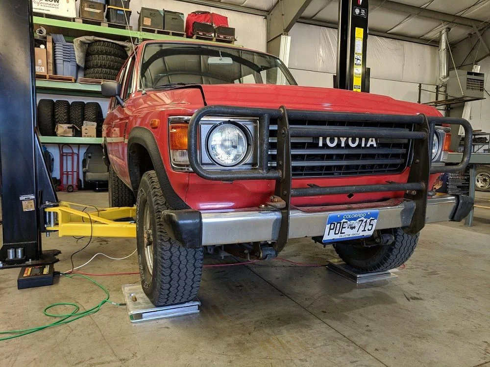

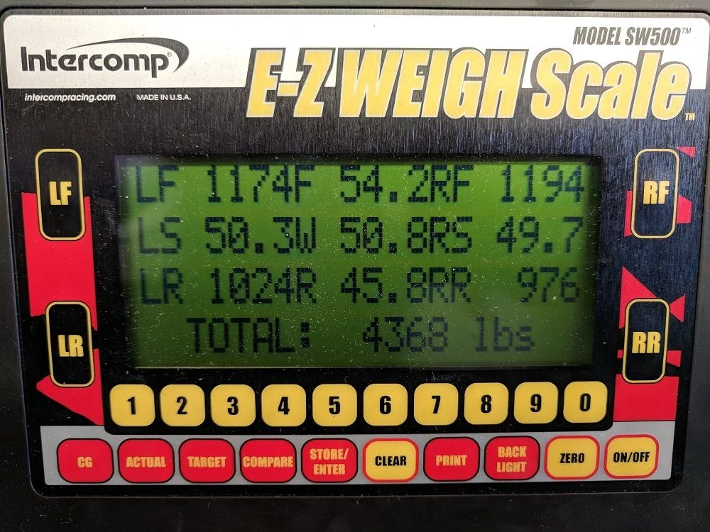

Next step was to weigh the truck for a baseline. This is a stock 1985 FJ60 with about 4 gallons of gas on board and a simple brush guard. Tires are 31x10.5 on stock rims.
Pretty good on the splits considering how big it is, I thought it would be more nose heavy with that big anchor under the hood. It's going to be a while before we have the finished product, but this will be an interesting data point to compare before/after. Tomorrow the fun begins... :)
View attachment 1813710 View attachment 1813711

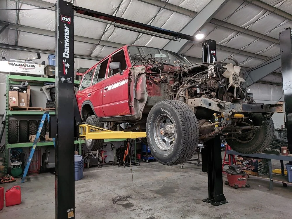

Got a few hours in over the weekend to start the teardown. Front clip is almost off, hope to finish it up today...
HOLEEEE $H!T! I've never thought of using a big tub to drain the radiator. That's freaking genius!
Finished up removal of the front clip over the past couple days and went through all the various underpinnings and underhood (figuratively speaking disconnects. No major challenges or surprises other than a few ornery body bolts.
Next up was interior. Not much exciting there, now she's pretty much bare inside. Still need to do the headliner, glass, and dash but I'm saving that for later.

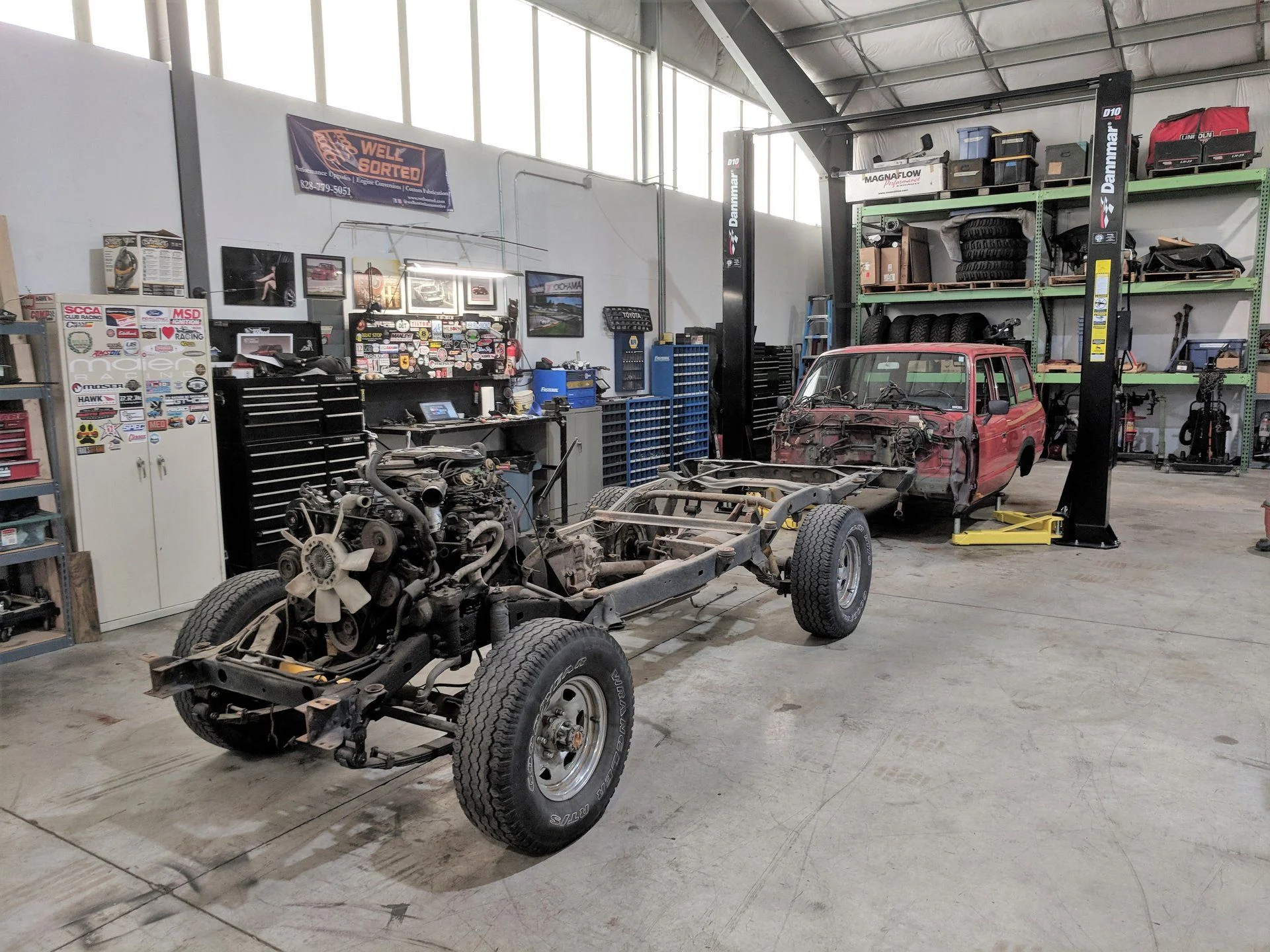

With all that done, time to lift the body off and get the old chassis out of the way.

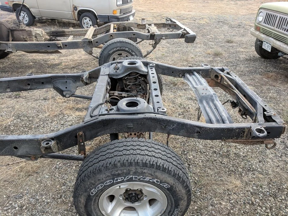

I rolled the chassis outside and put it next to the FZJ80 frame which will go under it. Thought you all might appreciate a quick side by side comparison of the two, especially in the rear frame section. You can see how the rear frame rail on the 60 stays quite a bit higher than the 80, it's also quite a bit smaller in section, not nearly as much height in the rectangular box aft of the first rear kickup.

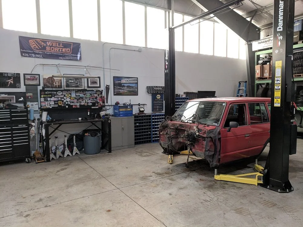

Now I'm left with the body on the hoist ready to move forward. First I'm going to build a dolly for it so I can easily move it around and also properly support it when I make the cut.

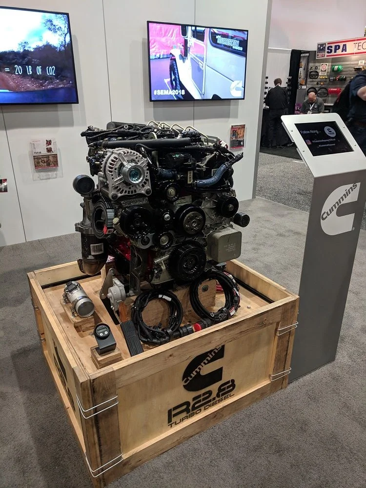

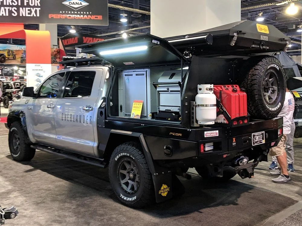

Spent most of last week out at SEMA canvassing the show for parts, suppliers, and inspiration. As usual it was a really fun few days but hard on the feet. A friend had on a fitbit and was logging 7-8 miles of walking each day during show hours. I spent quite a bit of time with the Cummins team at the show, gotta say it's tempting to throw one of these into the rig. I talked with Tor a bit about his converted 62 and he's really happy with how it performs, especially with the tune he's got on it (he's over 200hp and 400 ft-lbs).
I'm signed up now in the Cummins Builders program and I'm about to start a customer build to put one into an FJ40 (thread coming soon in the 40-series forum), I'm looking forward to getting my hands on the hardware and really working with this thing. I also spent some time with Chad from Quickdraw adapters, he's got a nice bellhousing setup to run the R2.8 with an H42/H55...
But for now, we move on with the plan as-is. Of course there's lots to see and build inspiration out there but most relevant was spending time with the guys from Exploration Outfitters who are importing the Patriot Camper trailers and Tray/Canopy systems from Australia. I climbed all over this rig for a while and the guys were super cool, offering to help with advice and guidance on the canopy box.

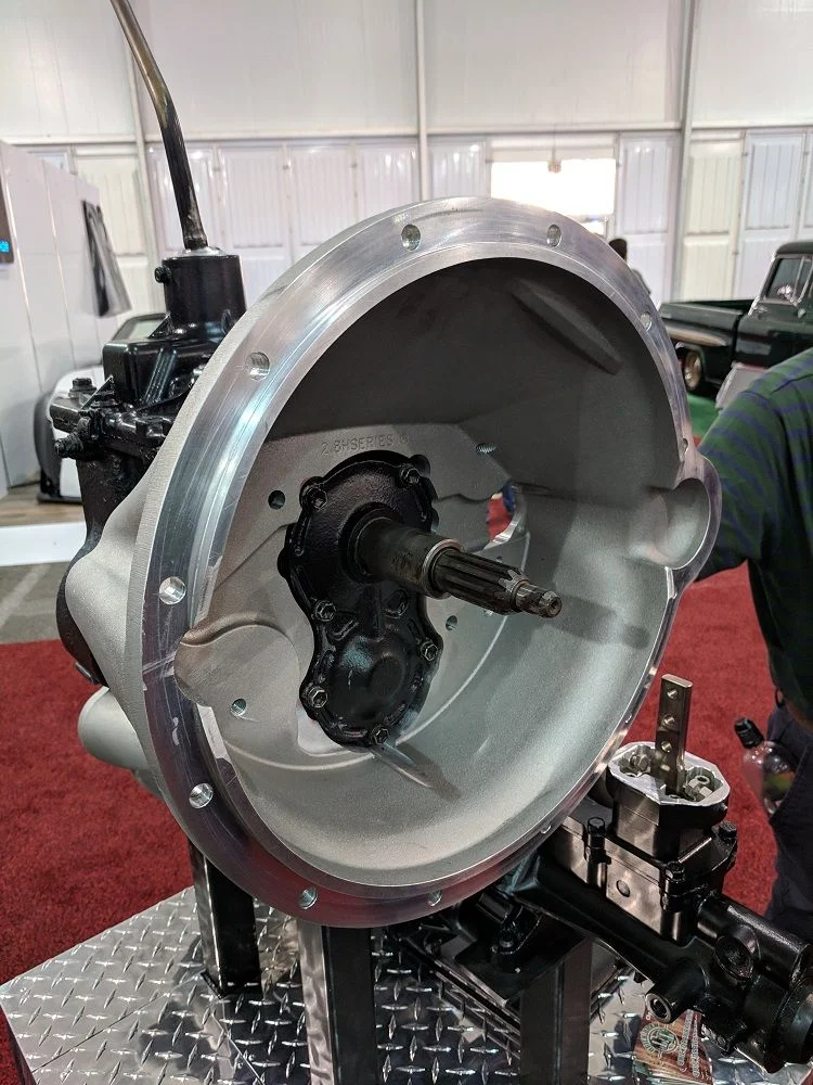

I also met a guy from Australia who has a business focusing on transmission swaps. He and I talked to for a couple hours on a wide range of topics including 2UZ swaps, transmission options and solutions to some of the challenges. We've got more to discuss and do, but I think we can likely have a solution for the auto trans ECM in use with a manual trans. More to come on that as it develops.

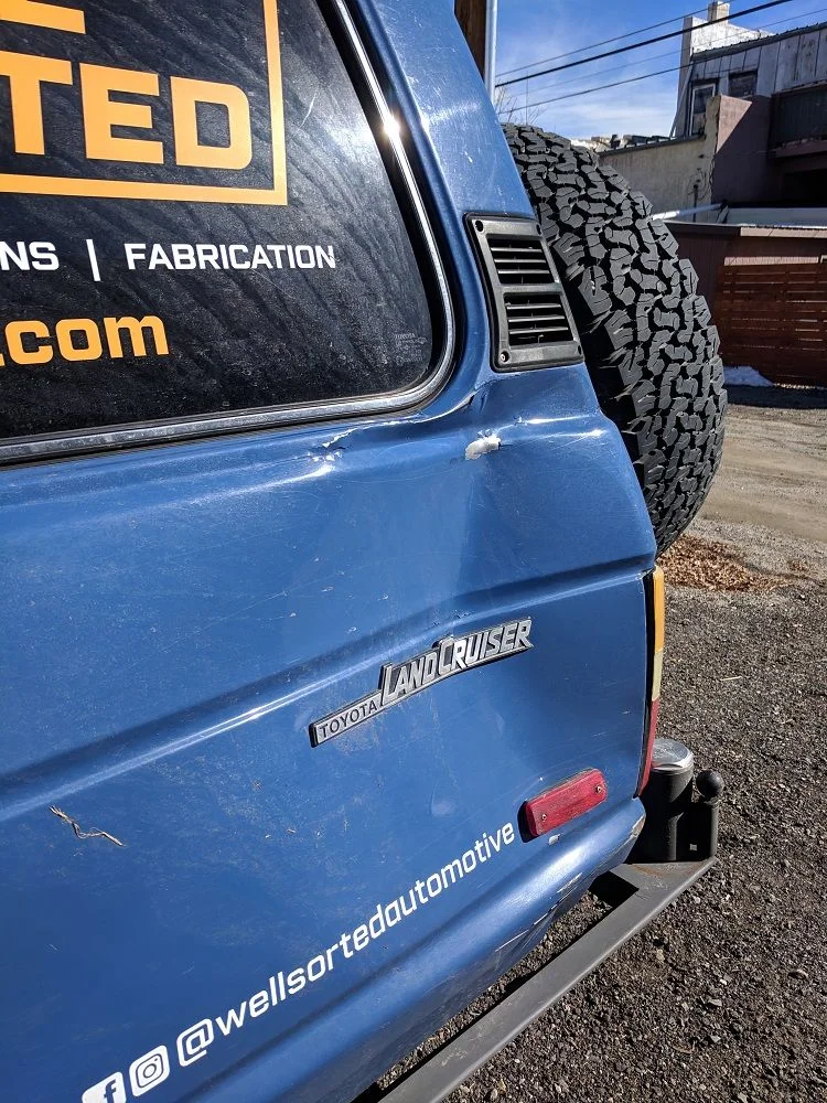

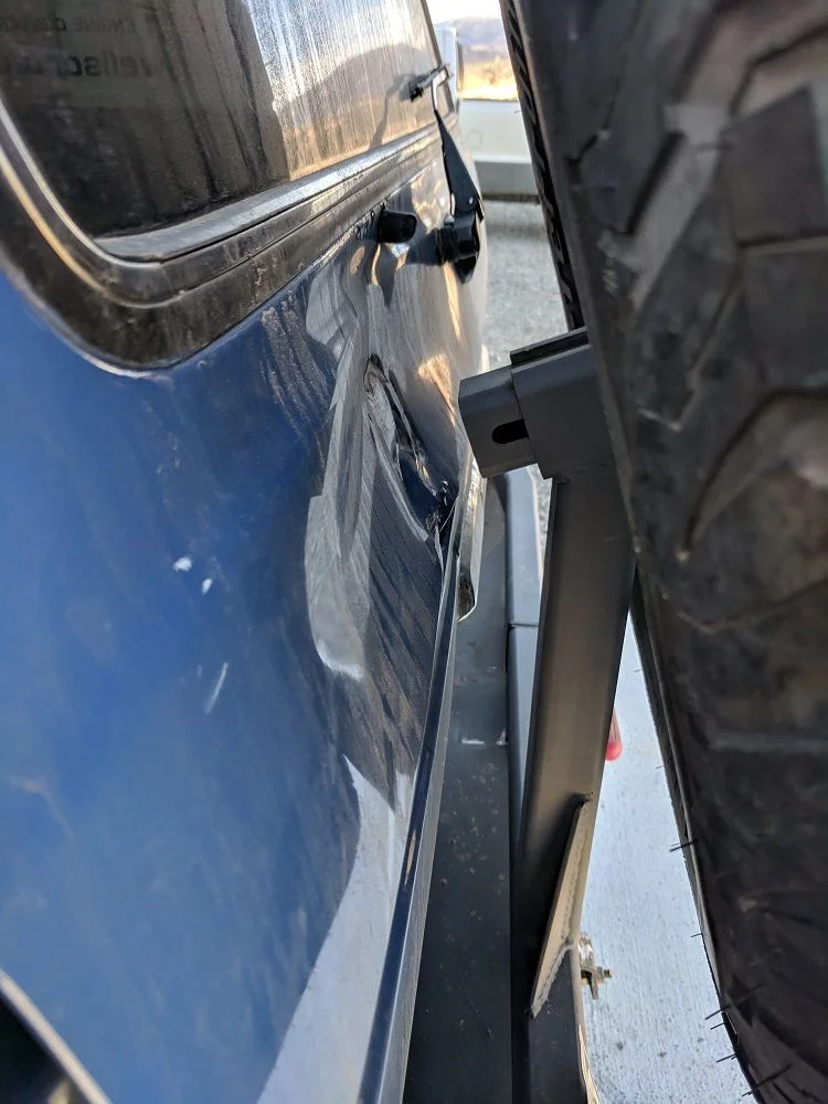

And lastly, we had a major snow storm in CO while I was gone and unfortunately there was a bit of an accident with my daily driver shop truck 60. My wife was heading to work and slid off the road into a ditch after hitting an ice patch. Thankfully she was fine and the truck drove away but there is damage. She went in backwards and the spare tire on the rear swing out was driven into the liftgate and tailgate. The hatch is pretty ruined, the tailgate can be repaired.
The worst part though is that as she bounced off, the latch was opened and the tire swung around and hit the driver's side quarter.
My local collision shop is working up an estimate to make the repairs but they are concerned it's going to be really expensive and hit the insurance company's scrap value. They think 30-40 hours just to repair the quarter, not to mention replacing the other parts and the paint work. I may end up doing the quarter repair myself and having the whole truck painted, it's in need of it anyway. Unfortunately this is just one more distraction to get in the way of the Goat build. On the plus side, by the time this is all over I'm going to be an expert at working on the rear quarter sections of 60-series.
