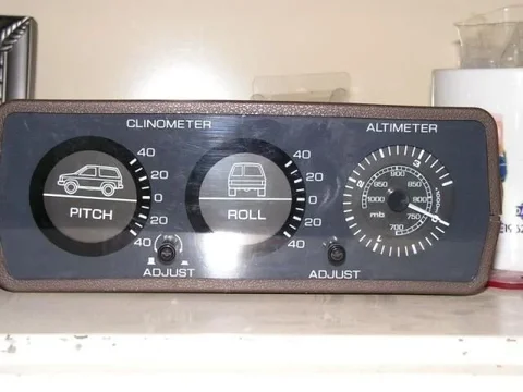

Also got this, it is from a Patrol but would work ok in the Cruiser. It is a Mongrel after all so why not!? ;)
main.php

Those are cool and every rig needs a zombie light switch. ;)
I'd love to have something like this in my rig!
