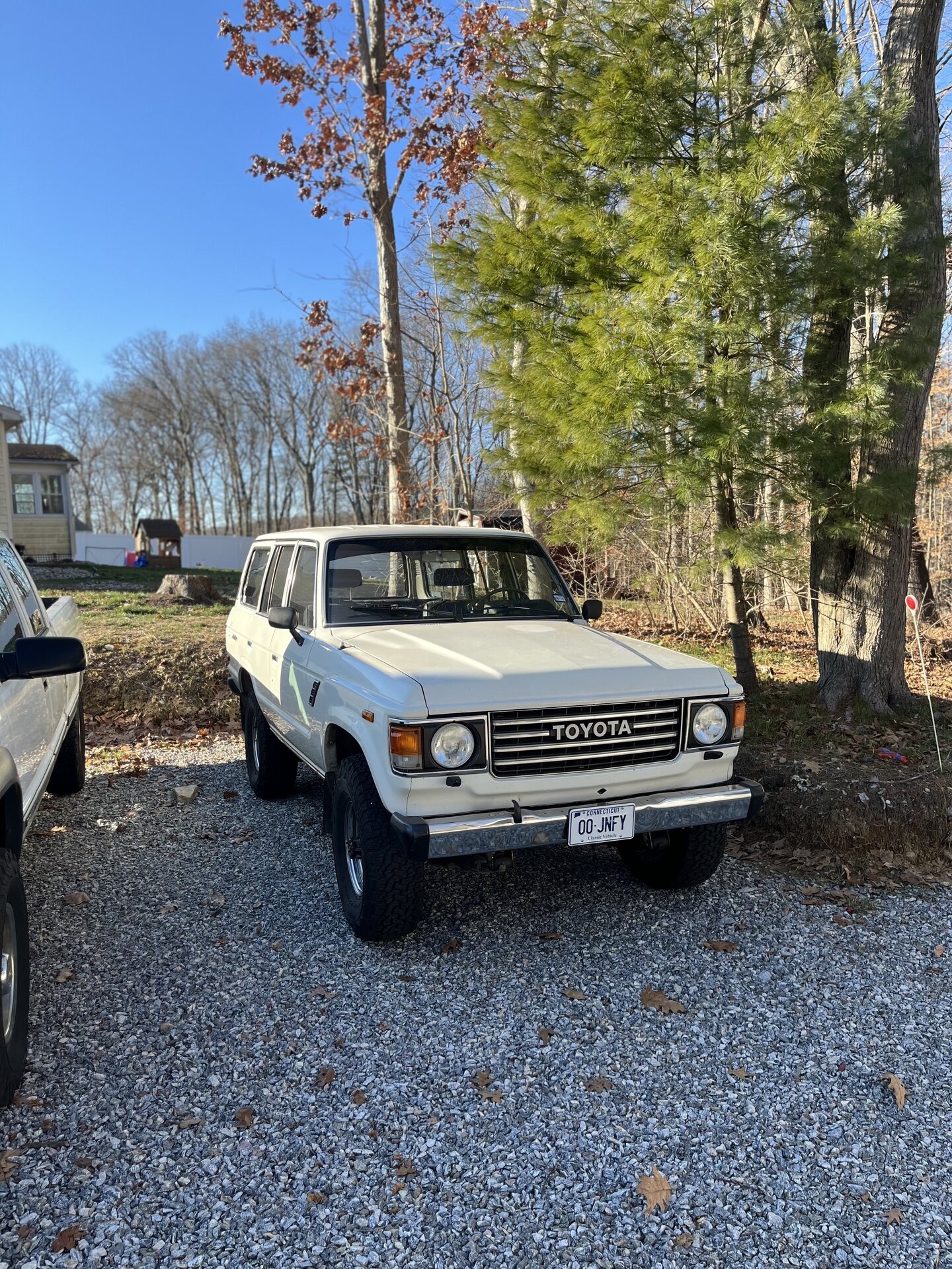

Ordered a set of halogen fj60 replacement lights from Toyota.

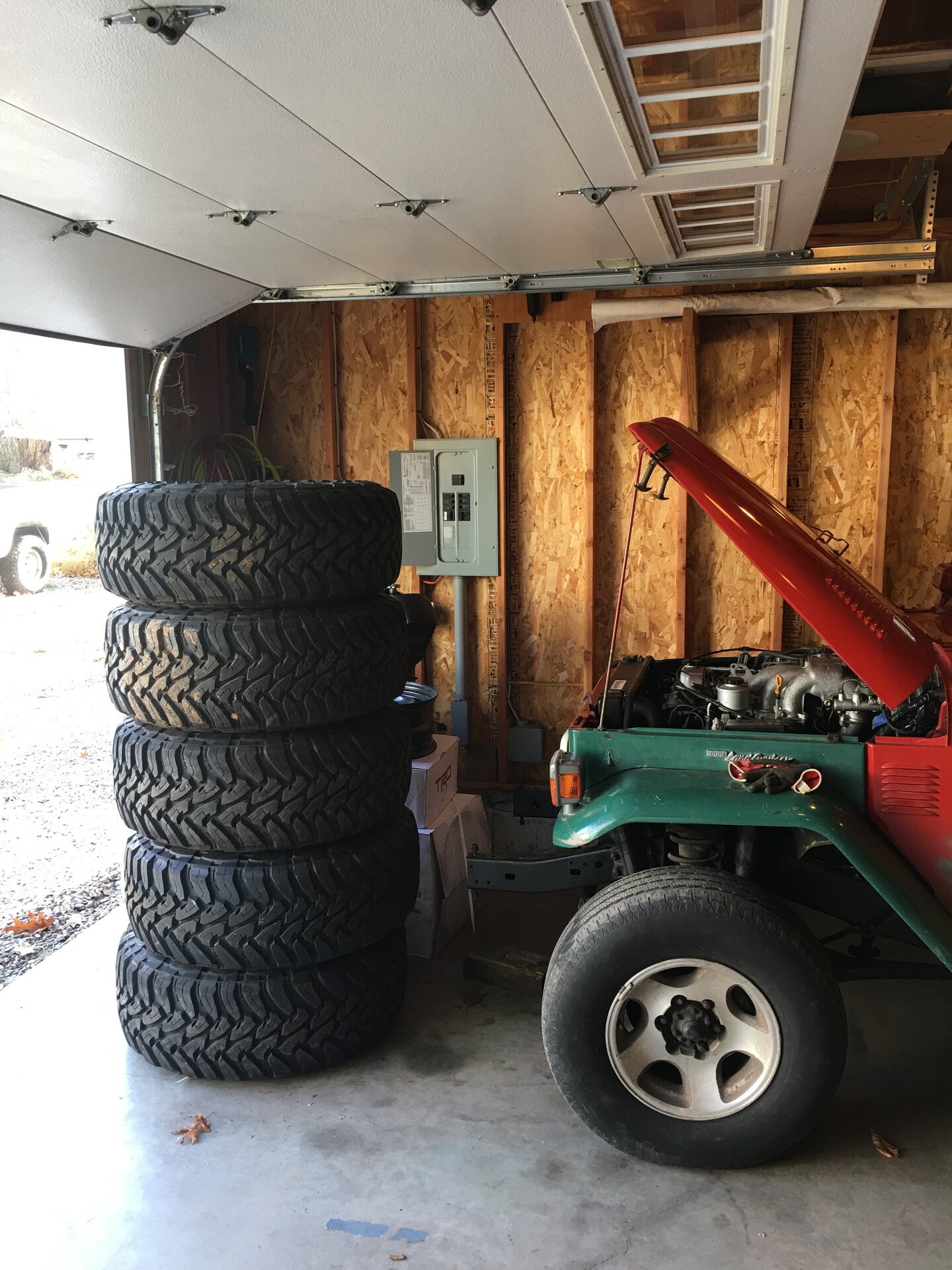

Rims showed up, they r fjcruiser stock 17 steelies
tires are Toyo mt 37s
Got my old bumper repainted and installed new tail lights

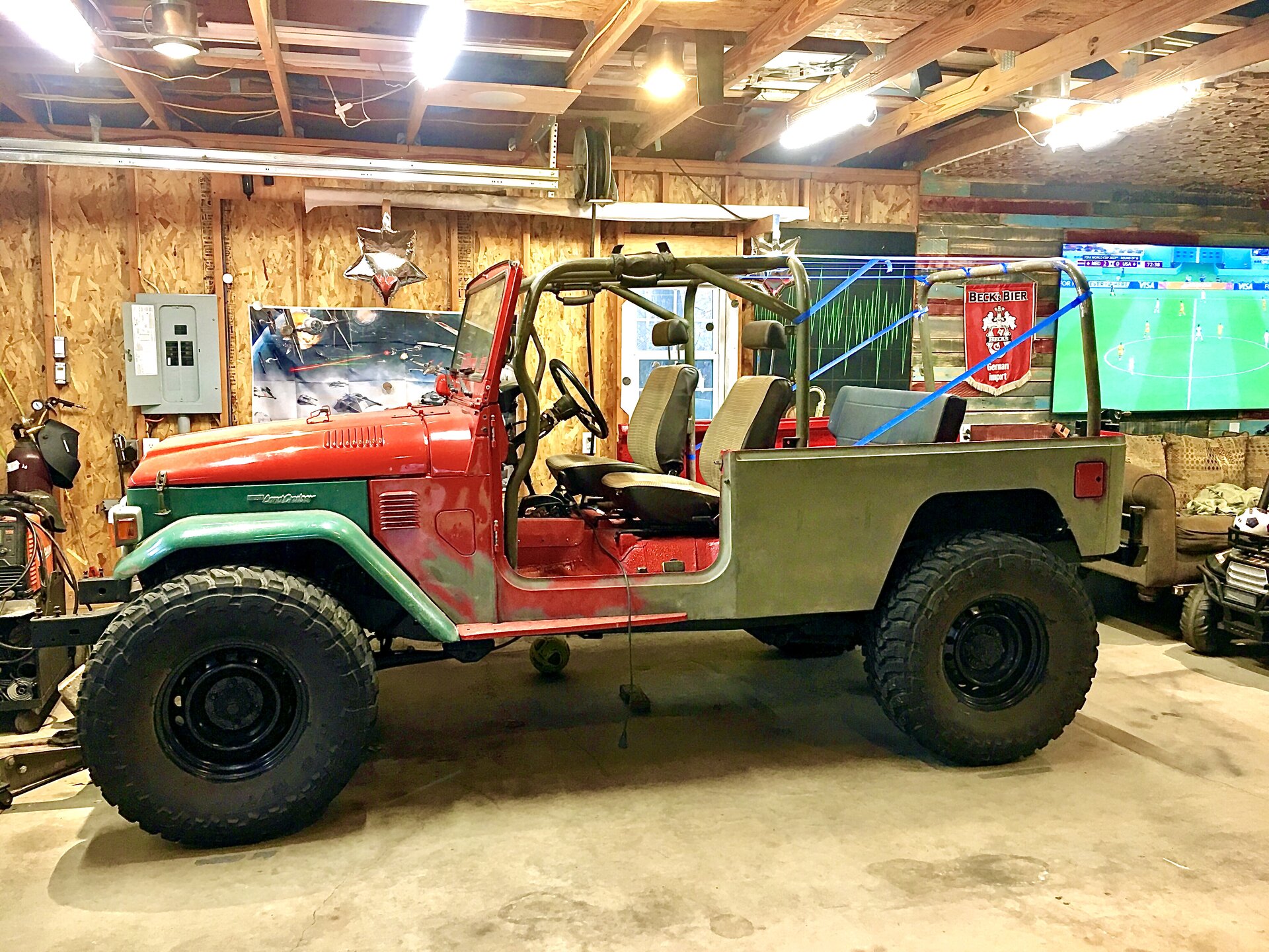

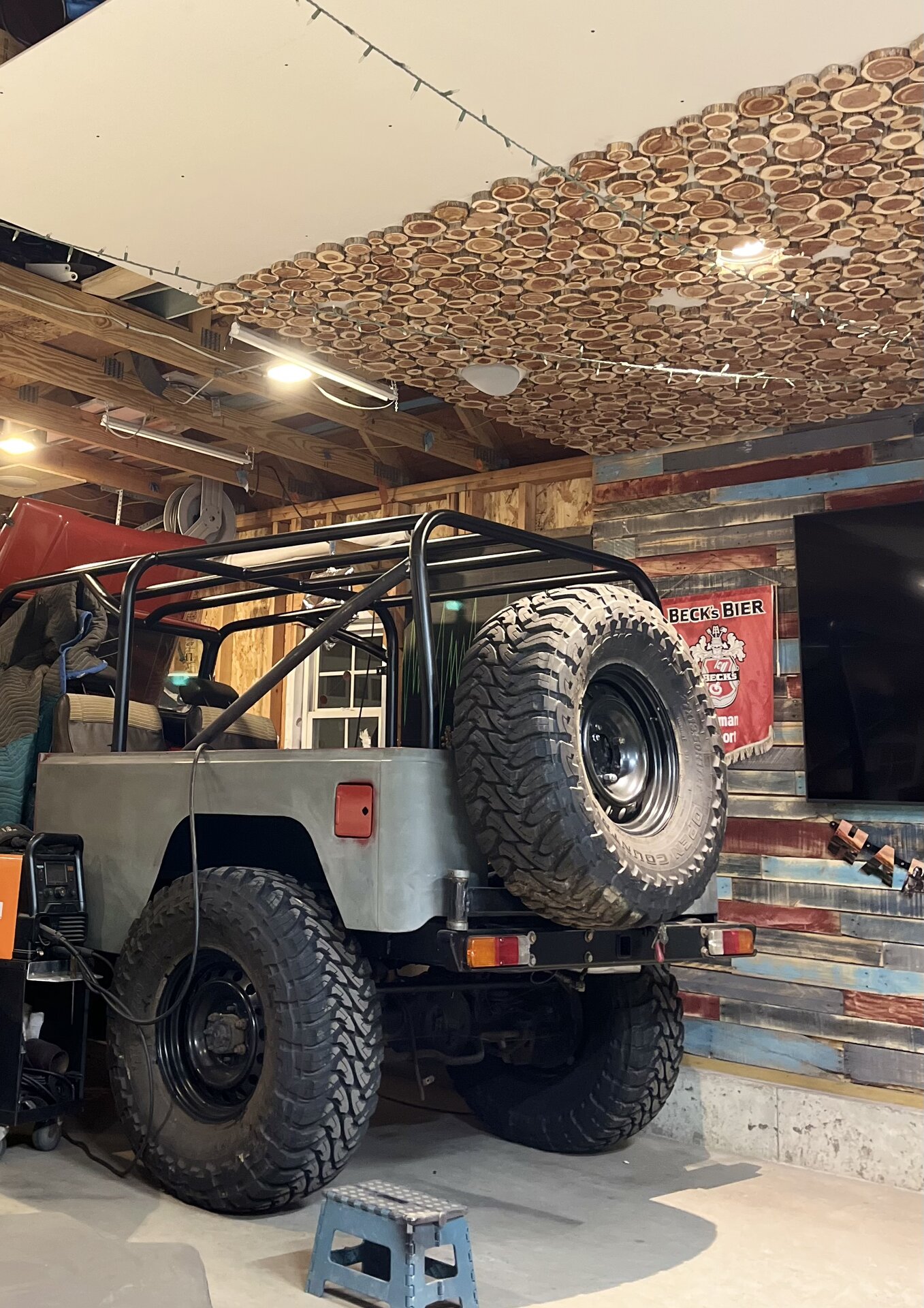

Cage time. Will be reusing what I can from my old metal tech roll cage . Adding new pipes to back half
Playing around with different designs for back of the cage .at the end I went with what I had before anyway.
My brother dropped off his 60 for carb tuning. Taking a brake from the build for couple of days.
Finishing up the rear half of the cage

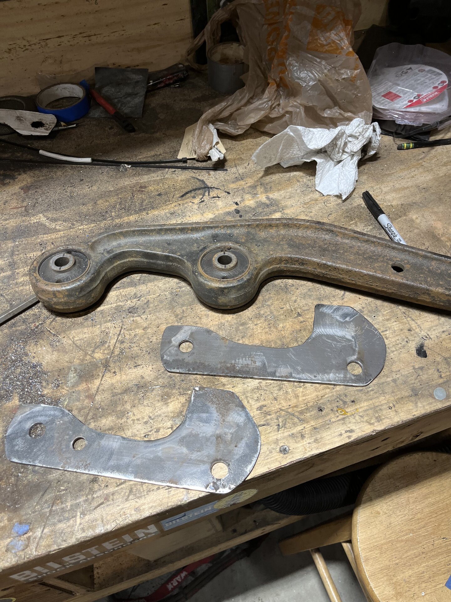

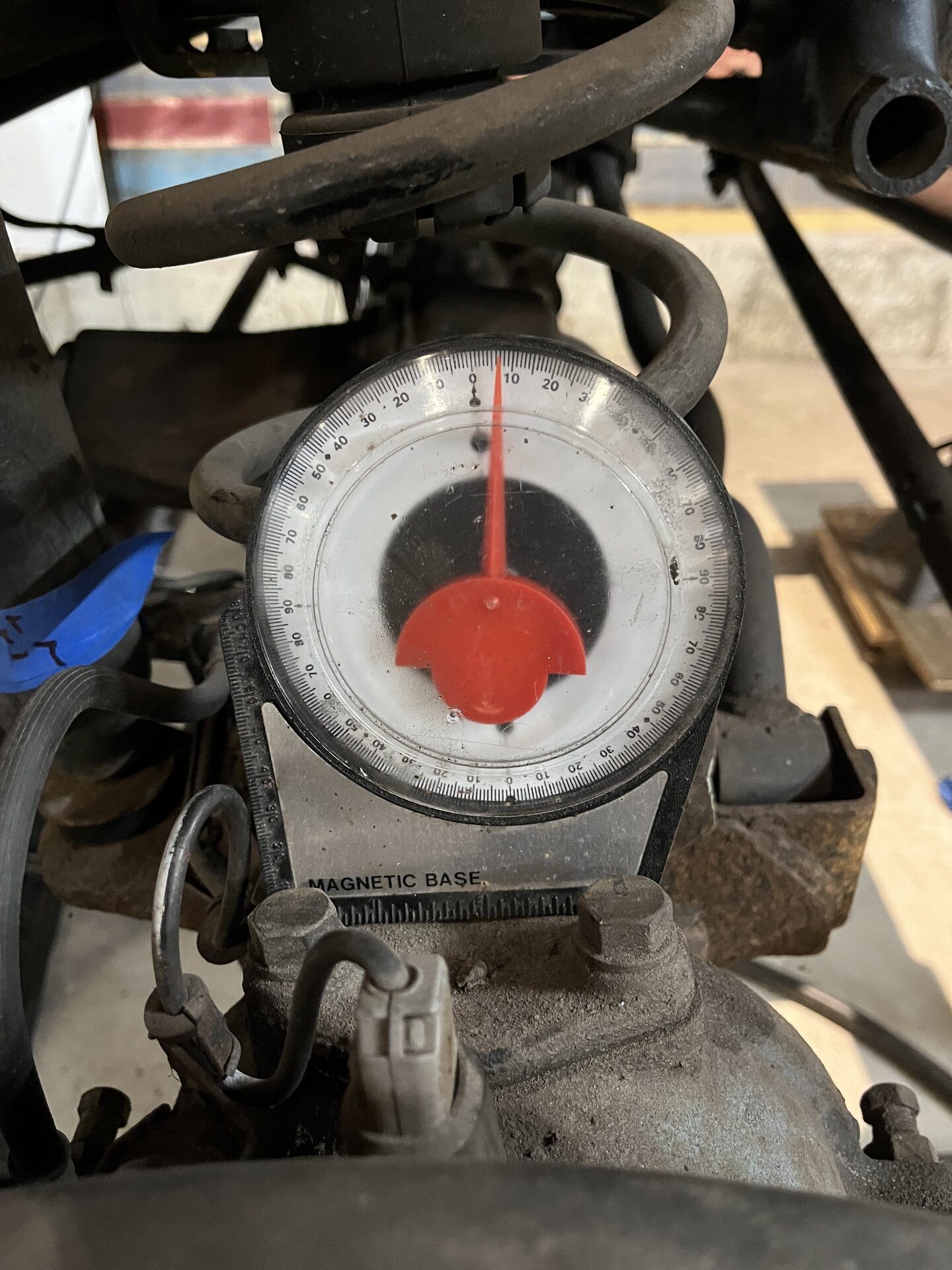

Started fixing the caster. Will be using caster correction plated I made, welding over existing ones.
Ended up with about -7 caster

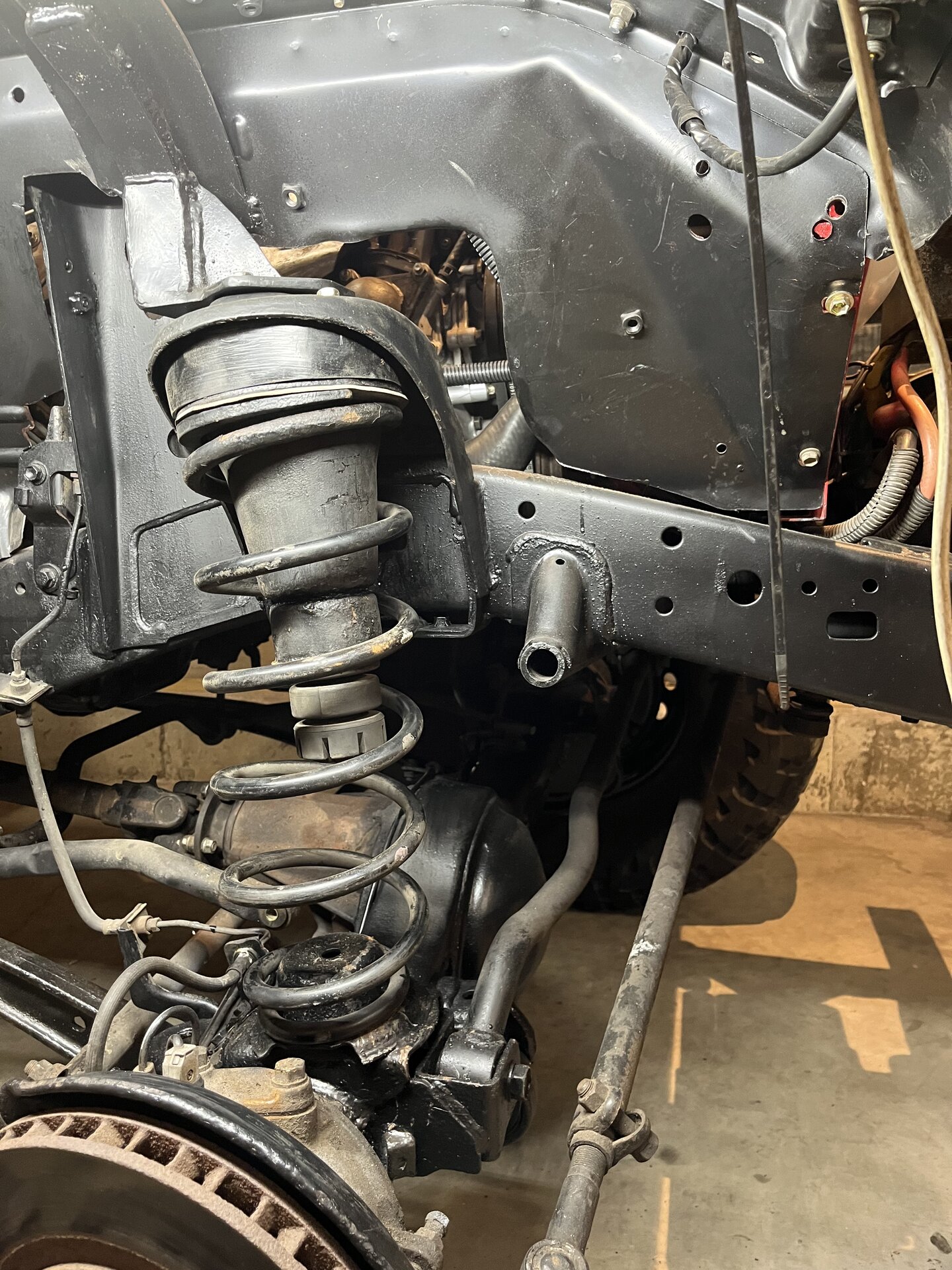

The 40 sits little too low . Decided to make my own coil spacer. 2inch
Used 1/4 inch plate for top and bottom and 1.5 inch flat stock in the middle
