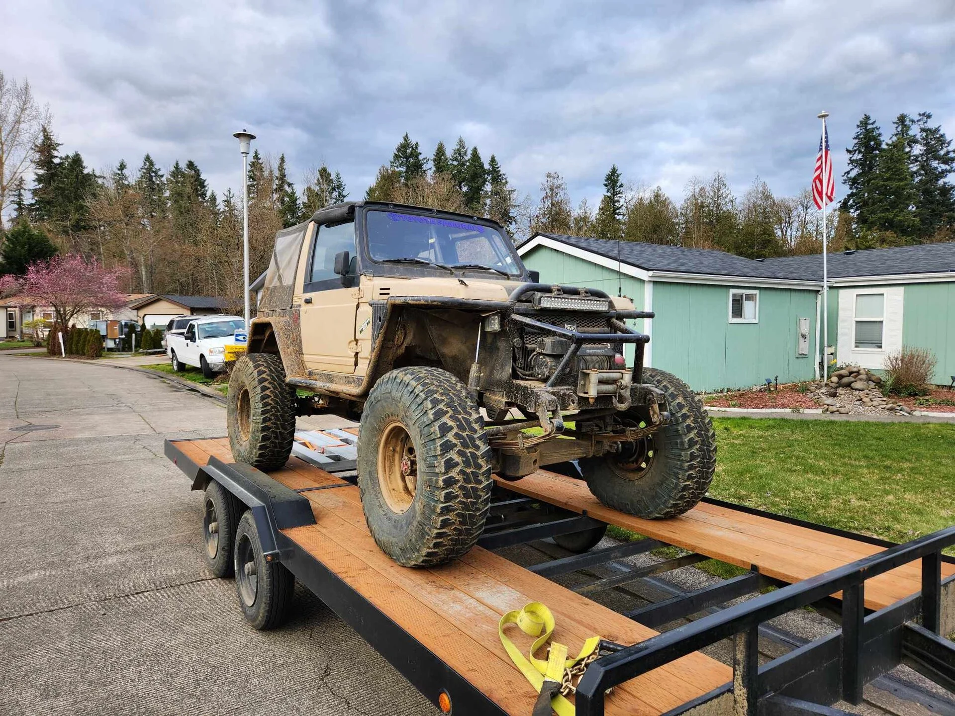

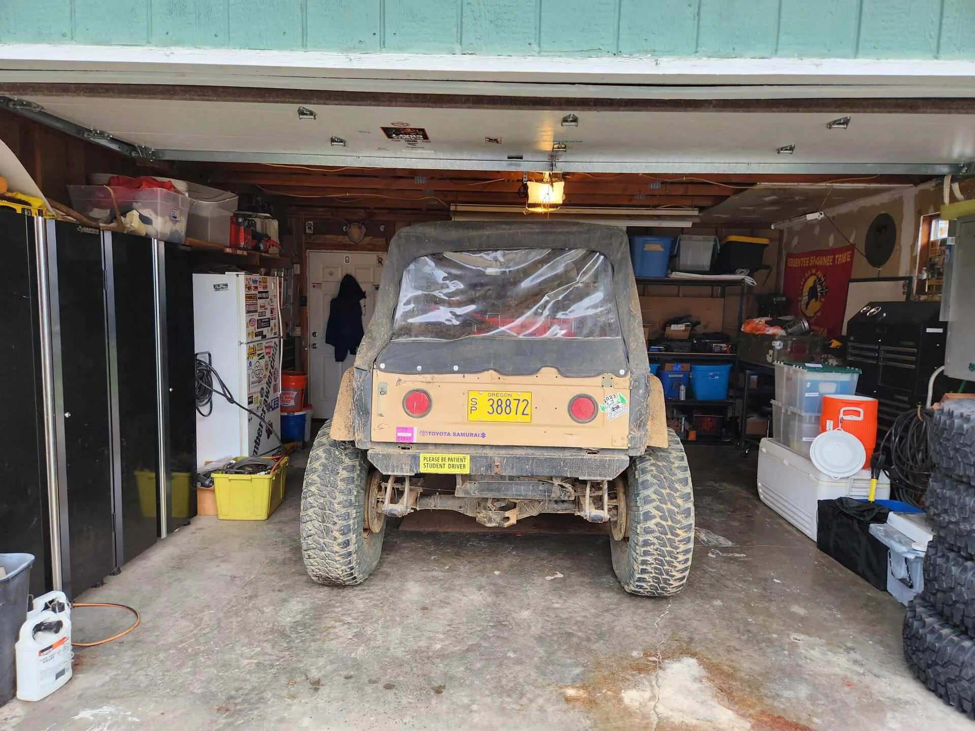

Got Snuggs home safe and sound yesterday afternoon. My tiny garage has so much more room! LOL

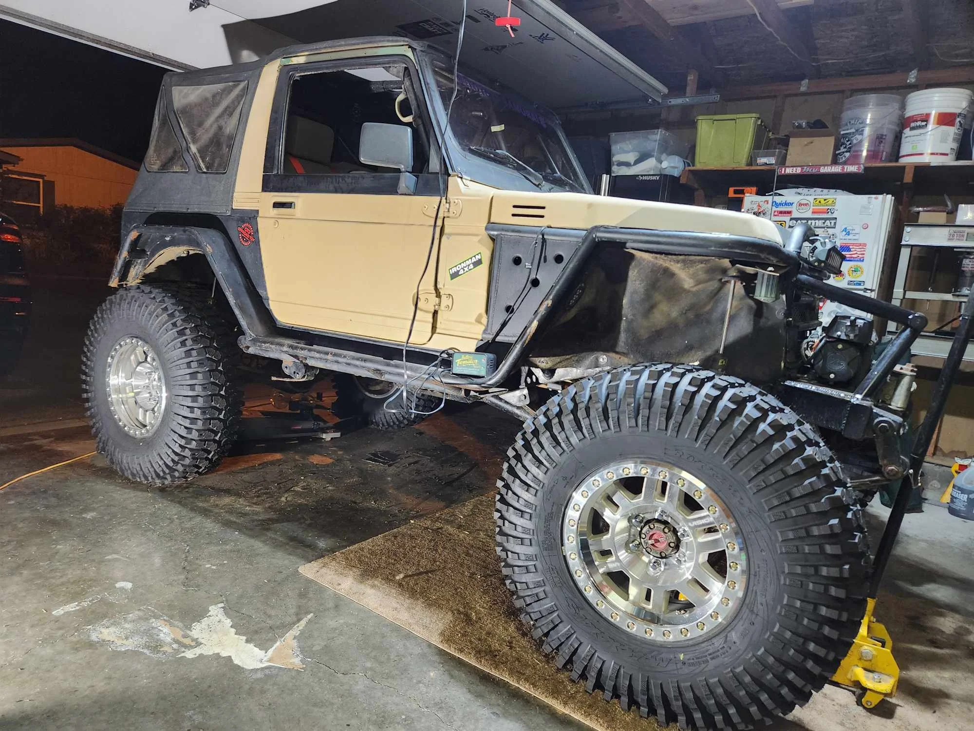

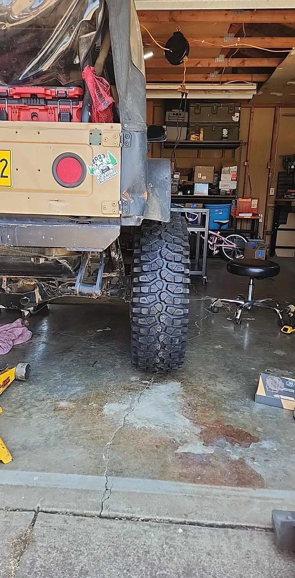

This weekend I pulled a rear tire off to see what spacer was on there and decide on which spacers to buy. I couldn't help myself from making a sneak peek...
(Yes, I know I put a tire mounted up for the passenger side on the driver side... I was being lazy!)
I will be removing the 1.5" spacer in the rear and adding a 2" spacer. For the front, I will run 3" spacers. That should put me right where I want to be.

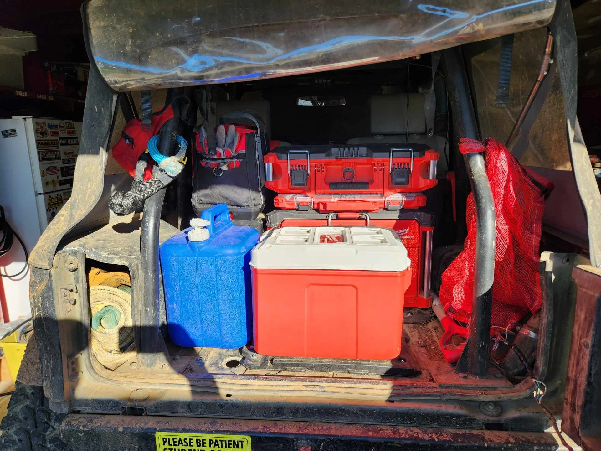

After that, I started getting the Packout system organized. I carry a lot of crap with me!
It's mostly done and organized.

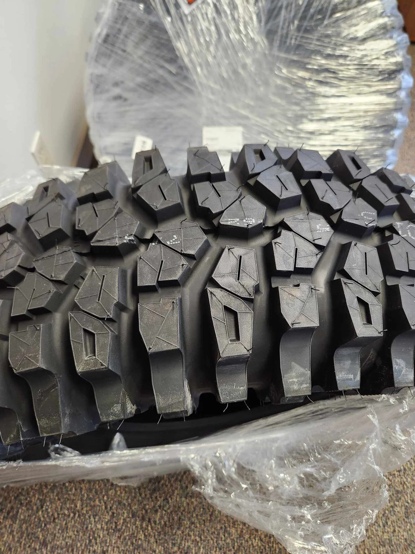

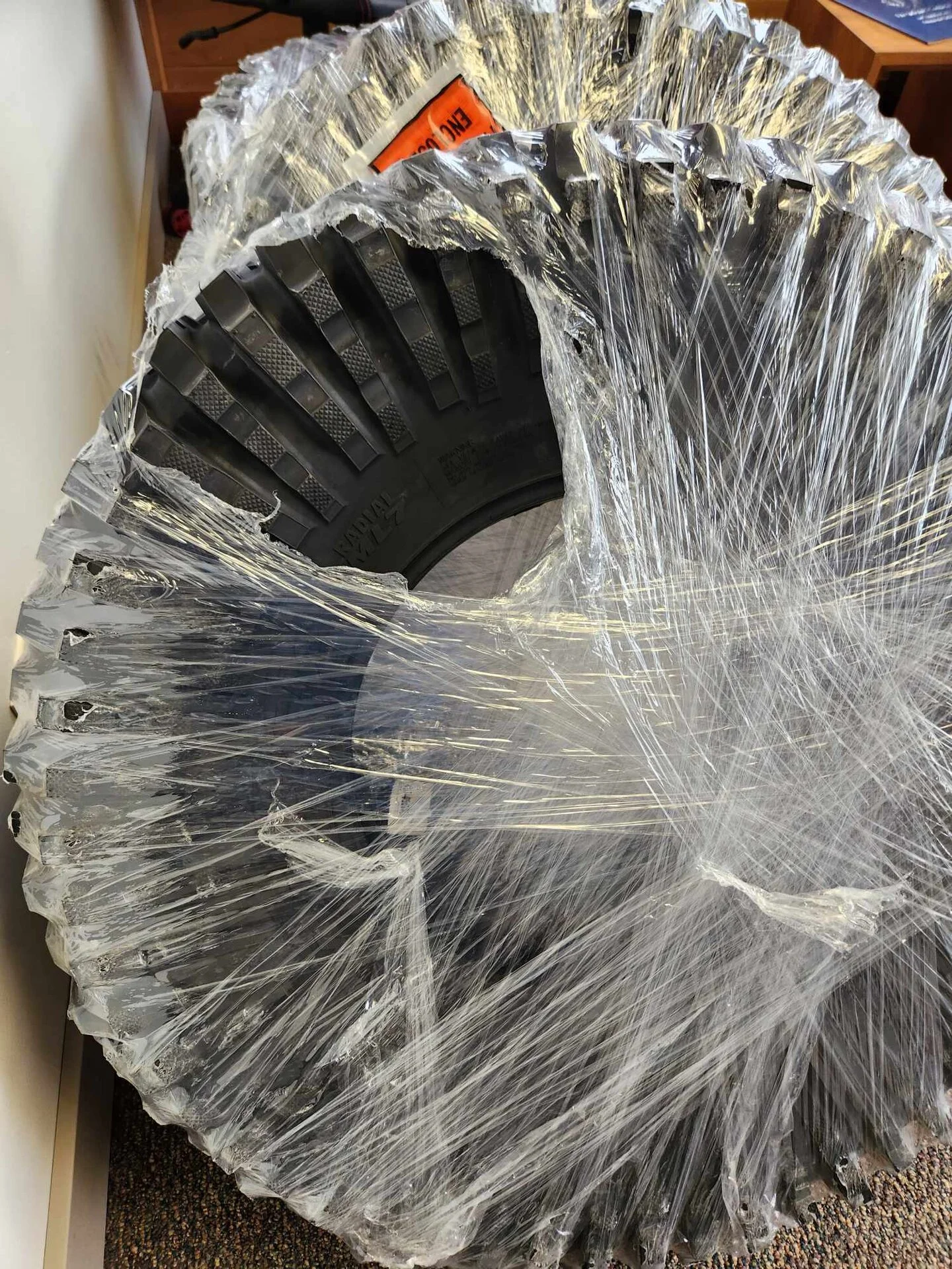

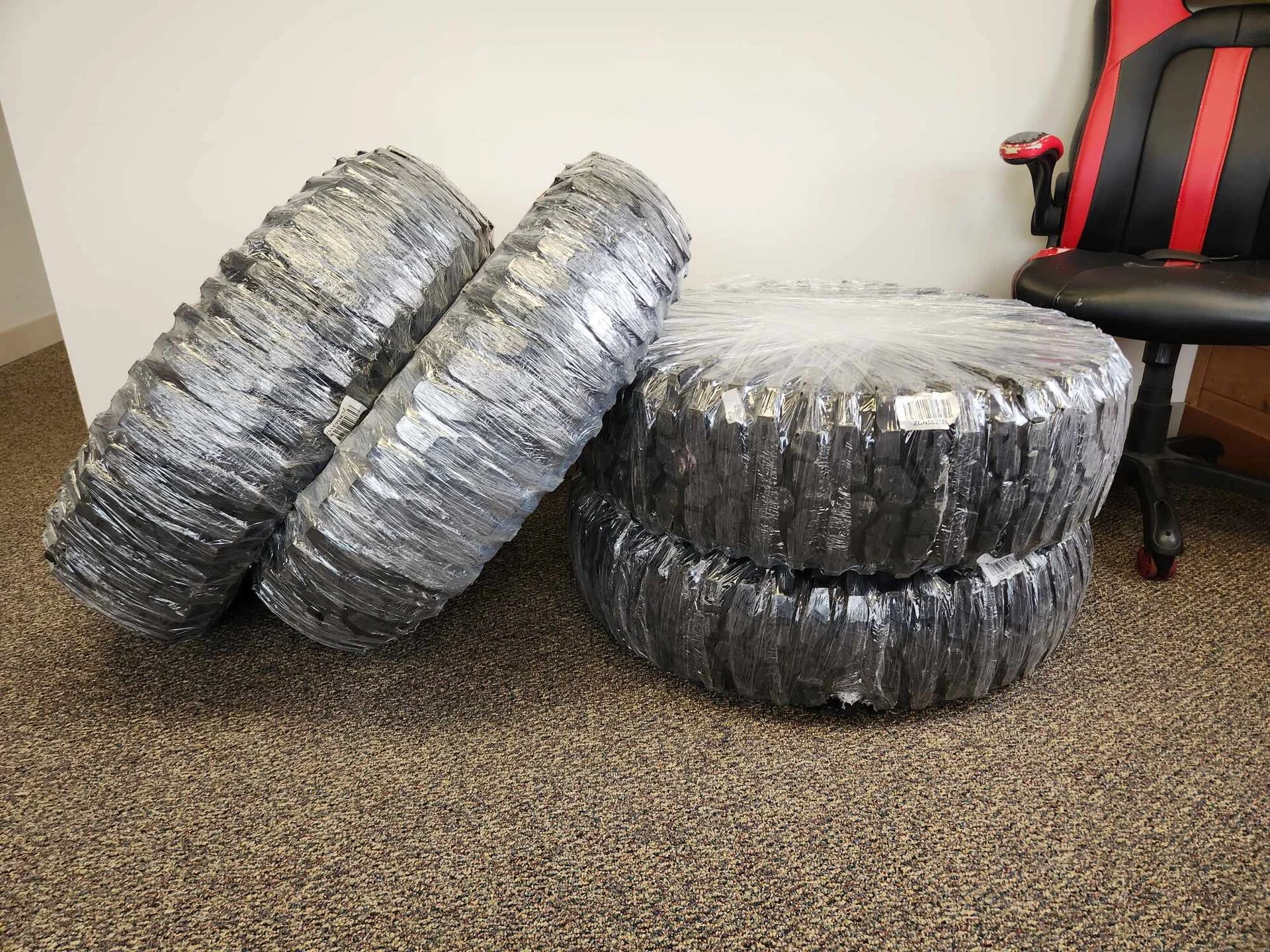

I started talking to a buddy of mine and he threw out a crazy suggestion: "You know, I bet that Sami is light enough you could get away with running SxS tires."
Well that got the wheels turning... Did you know that Maxxis makes a competition sticky SxS tire in 37x10.00r17?!? Neither did I! Did you know you could get them on sale shipped to your door for $316 a tire?!? Neither did I! But I do now...

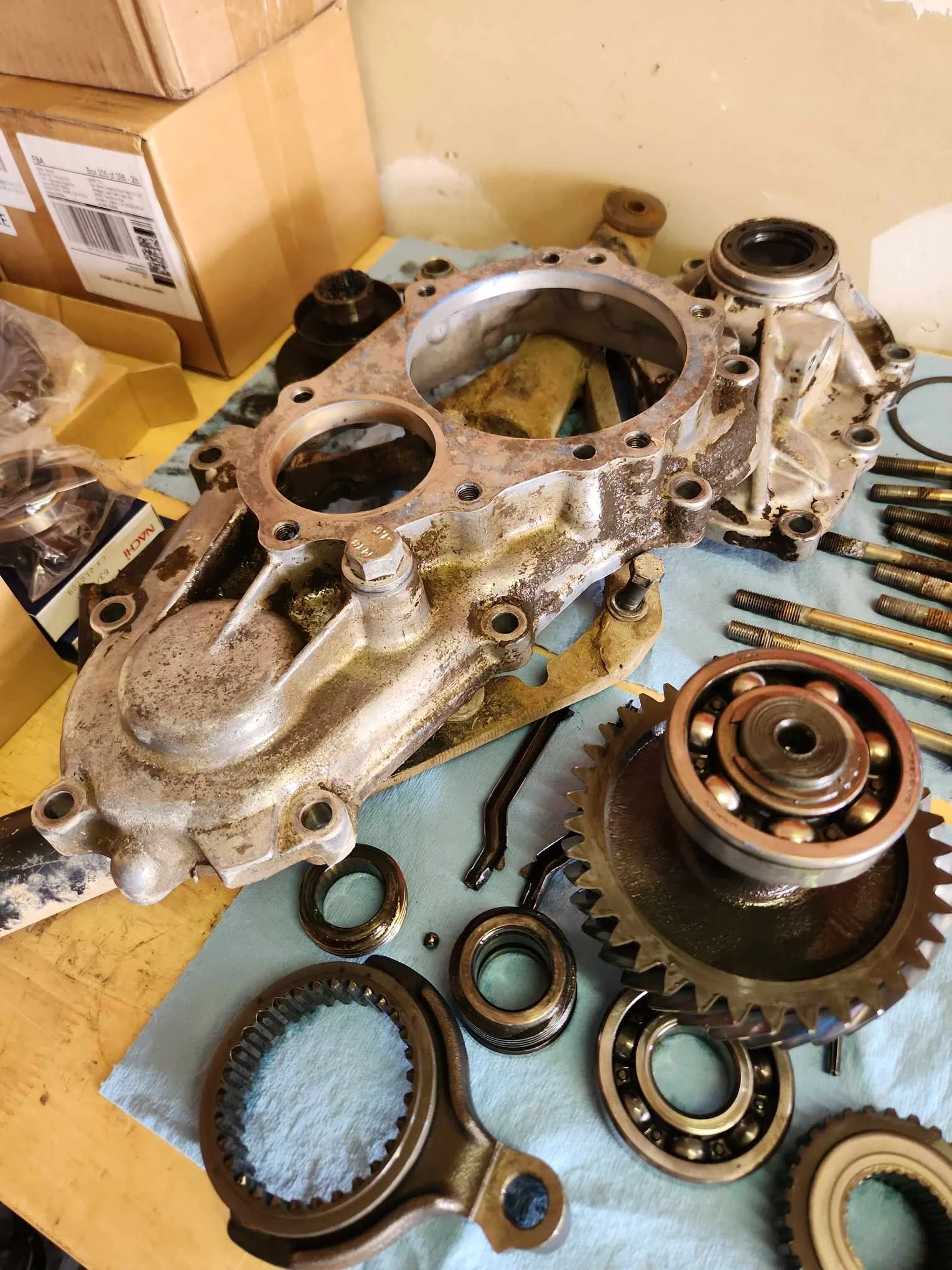

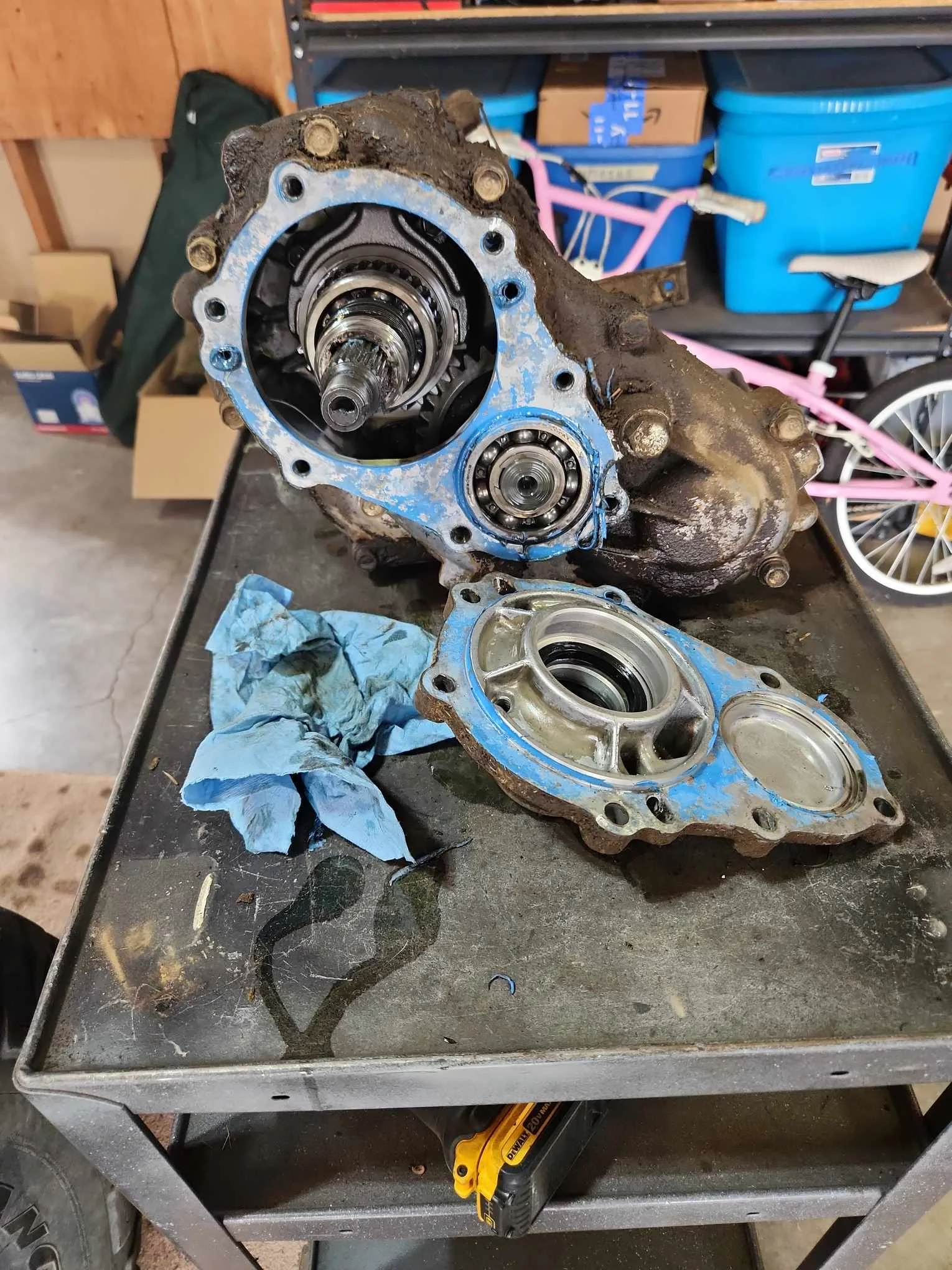

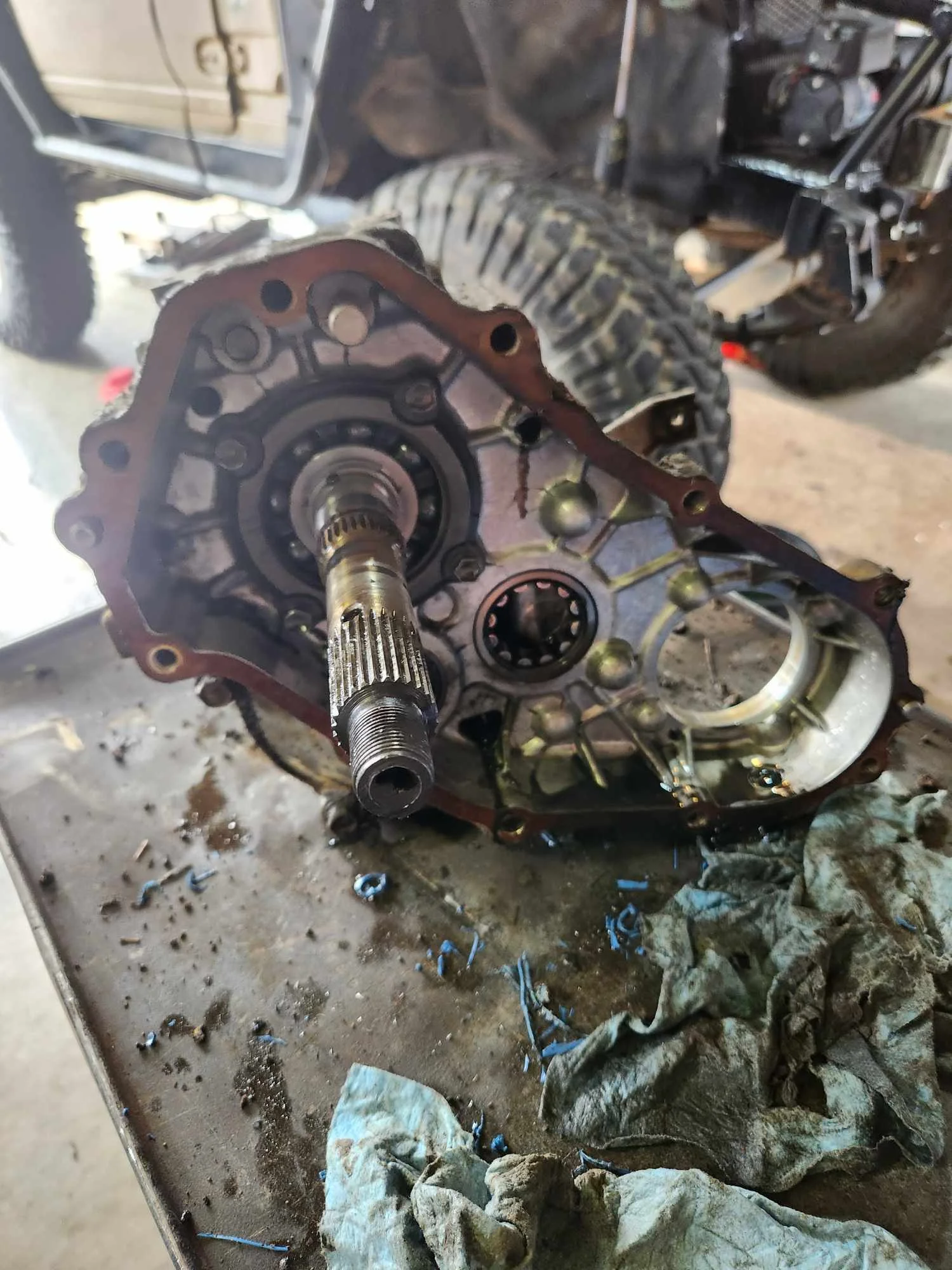

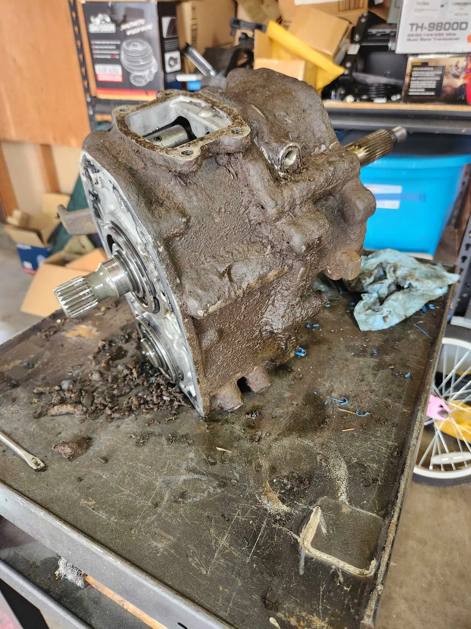

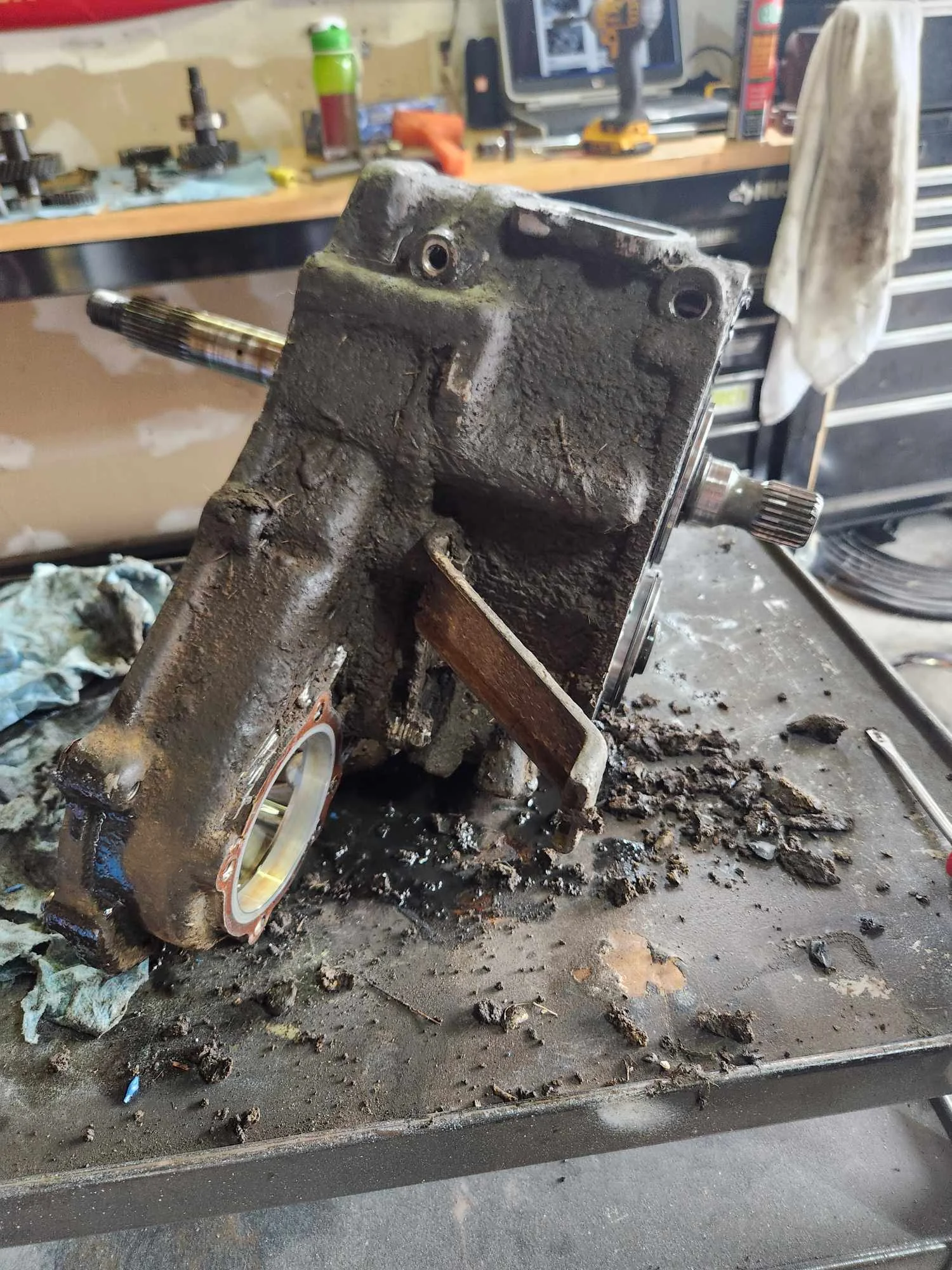

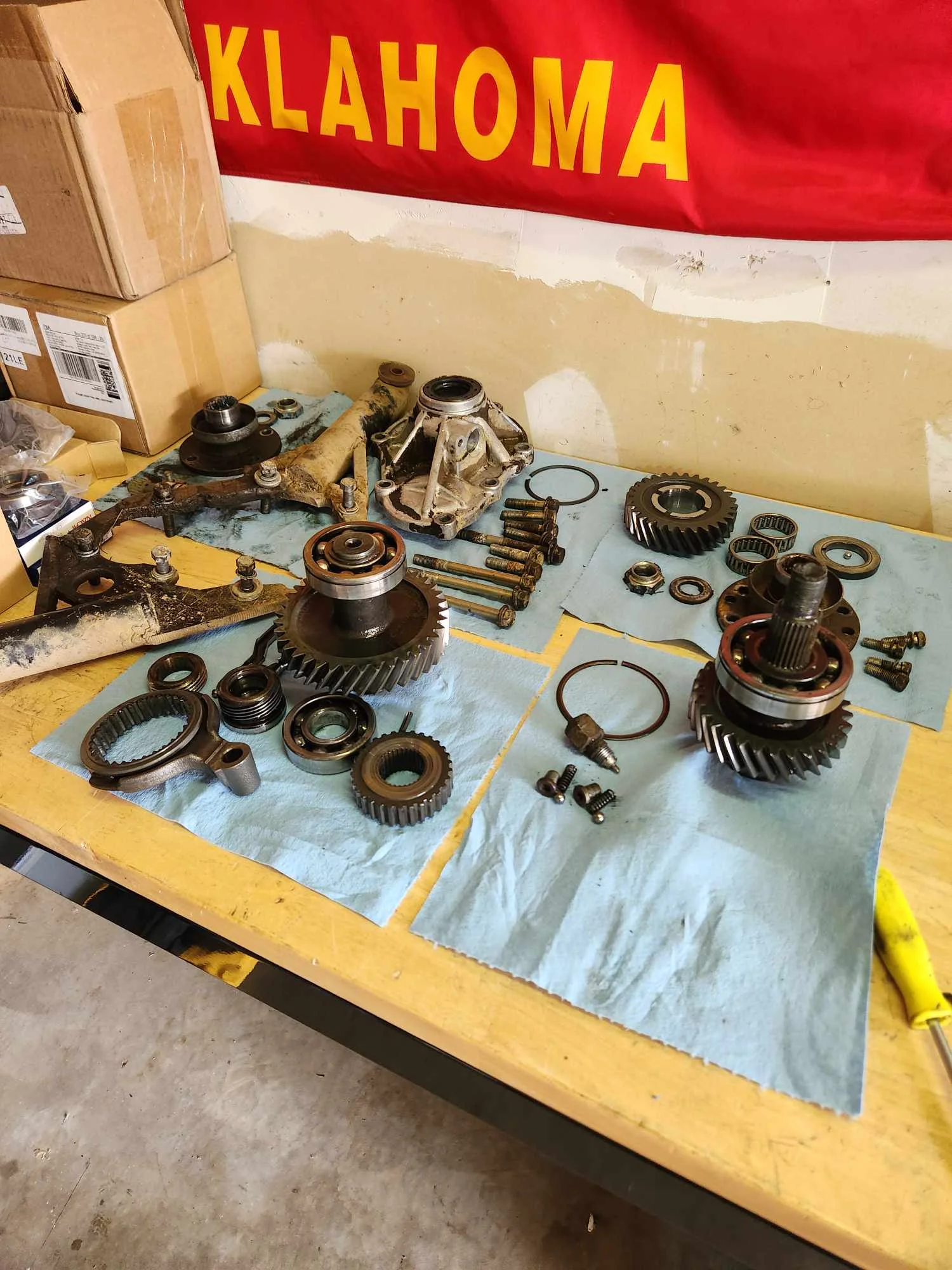

Now the transfer case is laying on the floor for the re-gear (I now have all the parts!), so that is my next step.

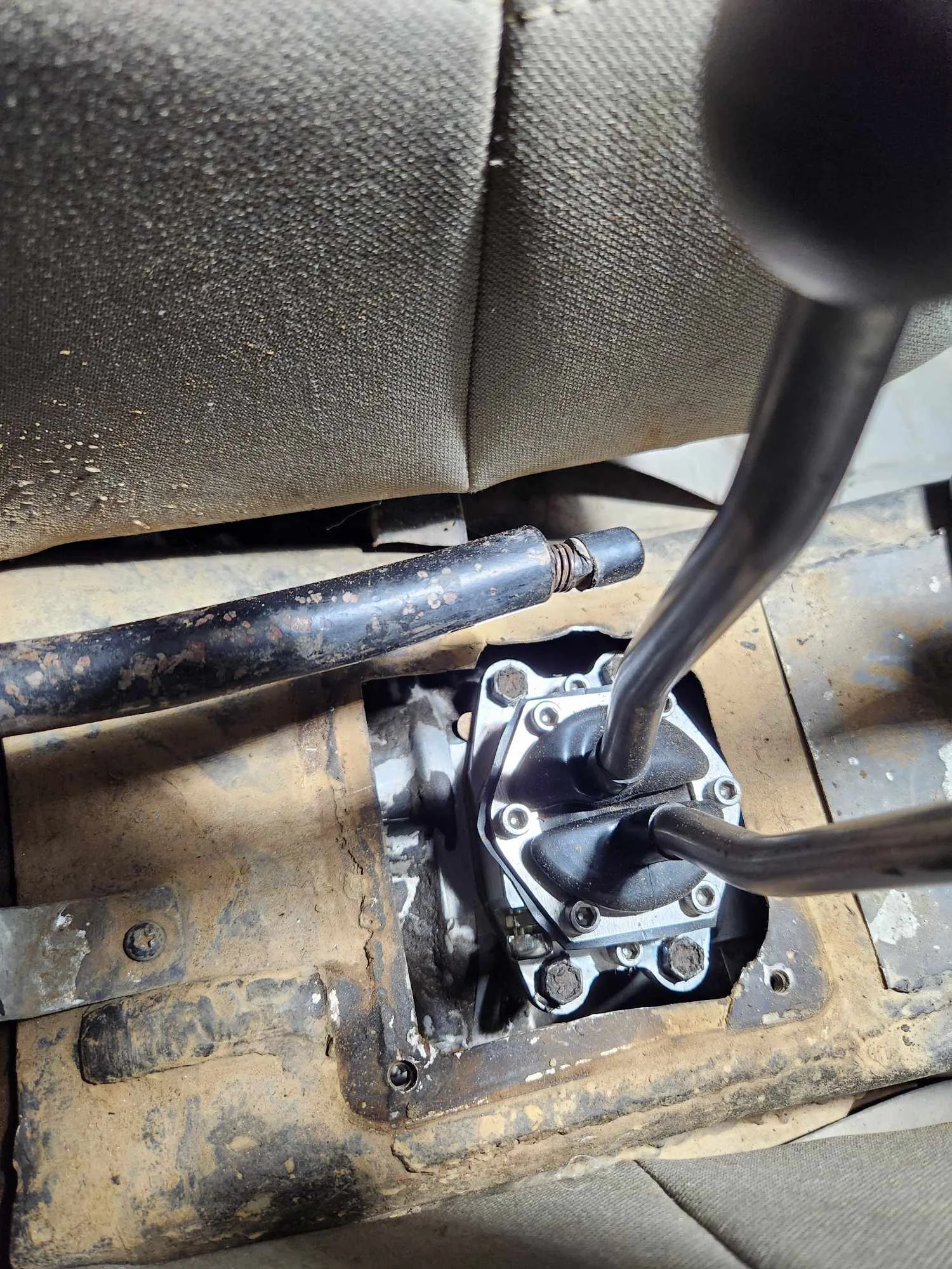

T-Case is back together and bolted up. Last night I got the driveshafts in, rear-end full of oil, t-case full of oil, shifters installed, and transmission shifter bushings replaced. A couple more nights and she will be ready to rock!
I got to say, I LOVE the Front Range Off Road twin stick. I even ordered the wrong one and they swapped it out with no question. Great guys and a great product! It's almost too pretty to run a shifter boot.

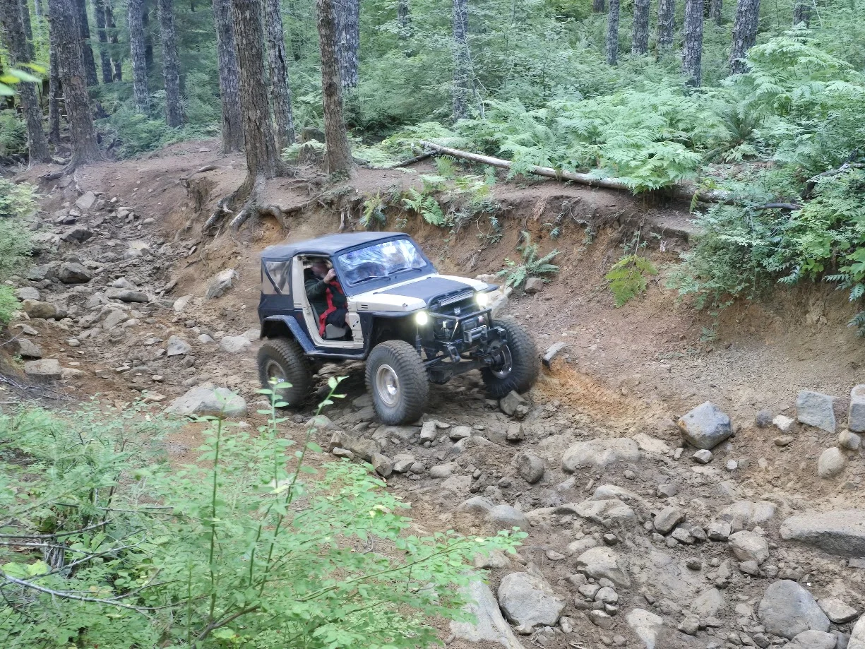

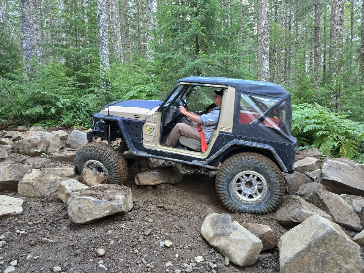

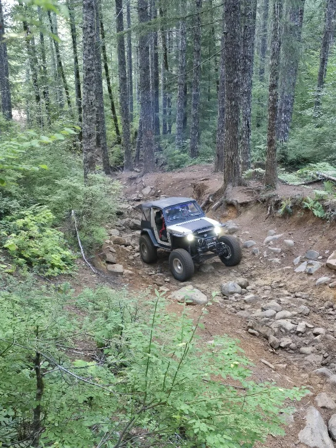

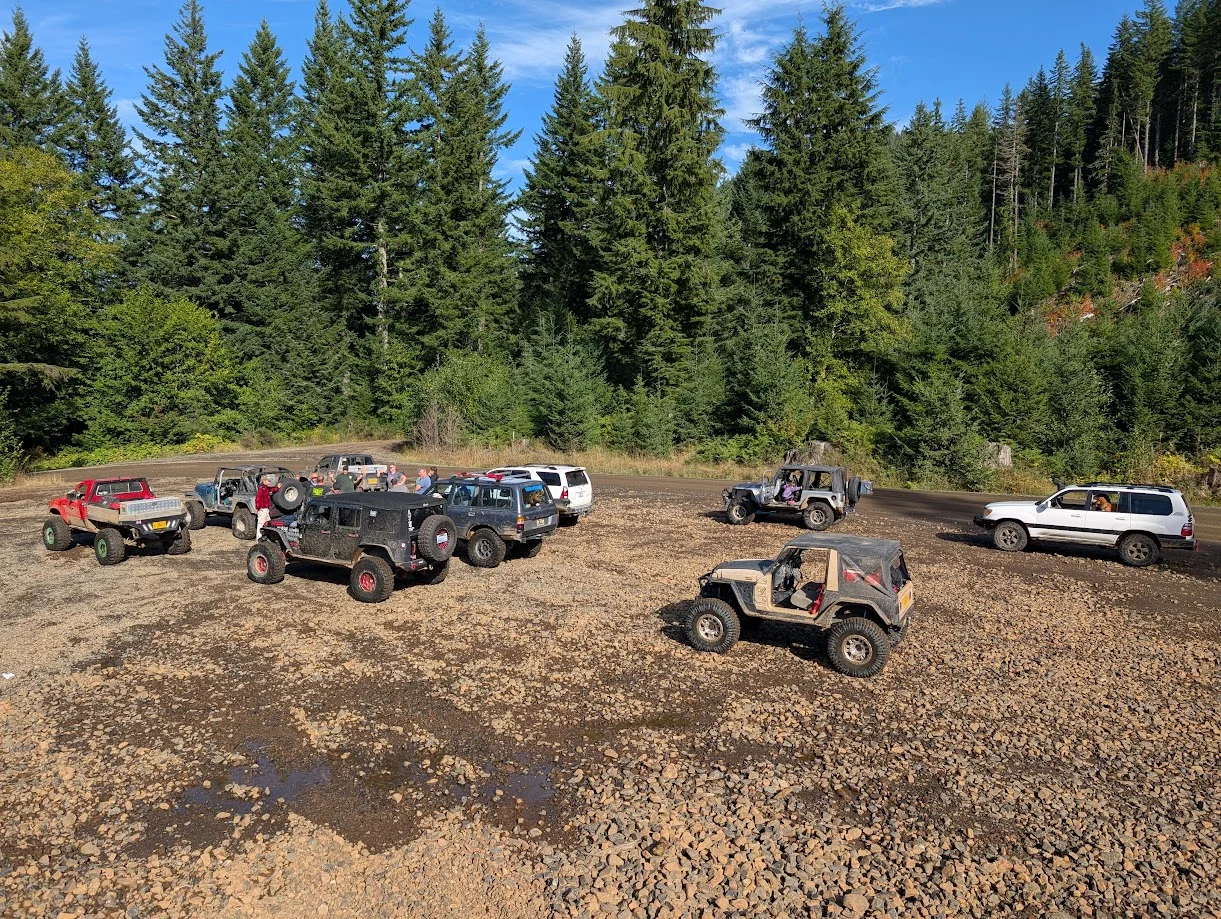

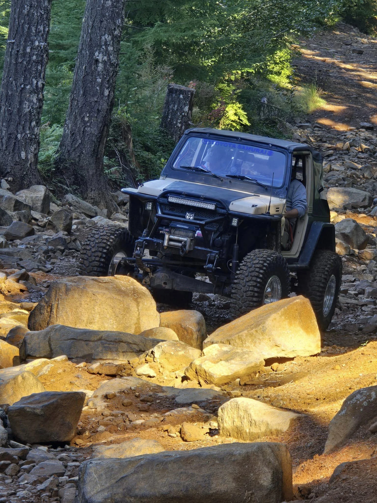

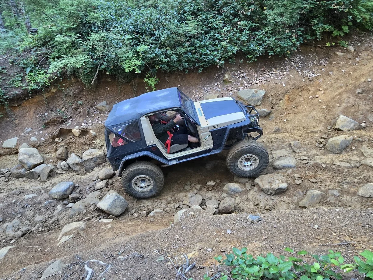

Another epic Cruisin the Woods (TLCA event hosted by Cascade Cruisers)! Snuggs did great, but I definitely need to get used to wheeling something that light and short... And I'm sure the tire will just keep getting better since it is hard to knock the new off stickies in the mud. LOL!
Anywho, here is a photo dump of the Sami:
