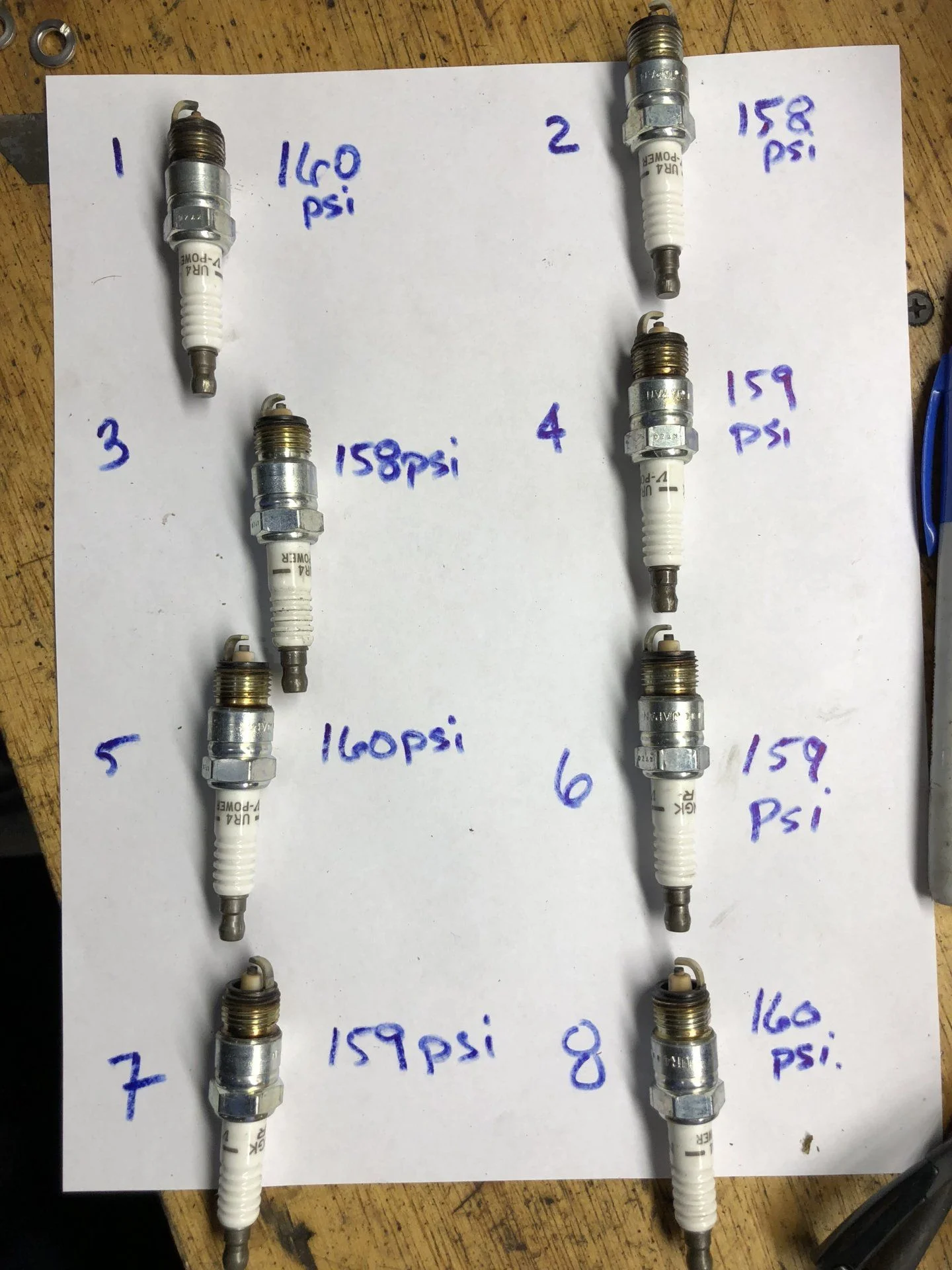

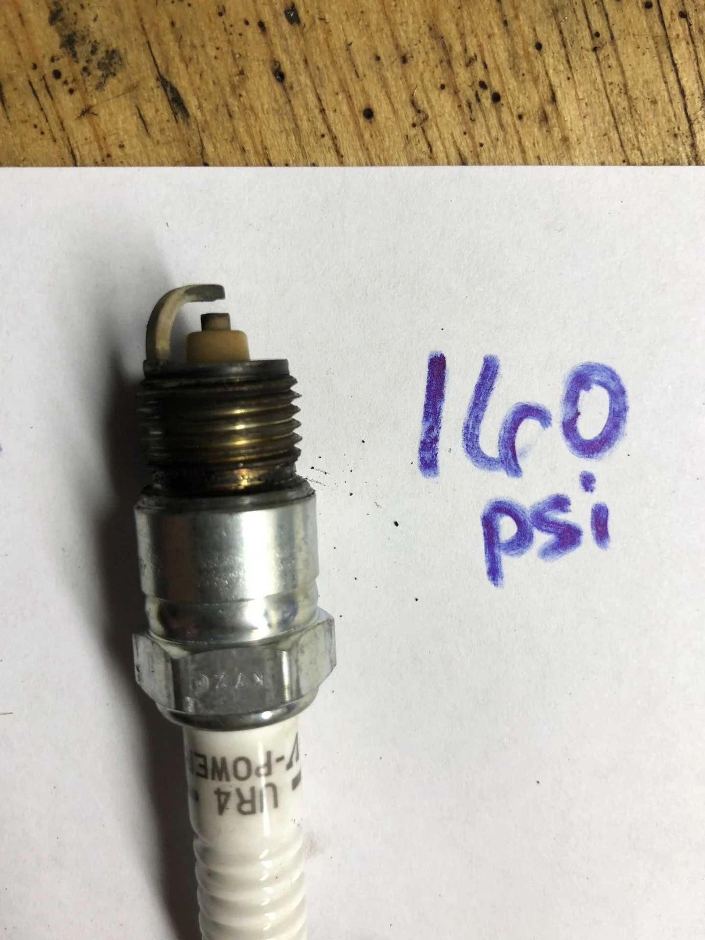

Compression was around 160 across the board - which is about on par for a 8.5:1 stock V8. The plugs all look clean - good tan color on the insulators and gray on the electrodes. Engine seems to be healthy. It is almost through it’s break-in period so, fingers crossed, it should be smooth sailing from here...

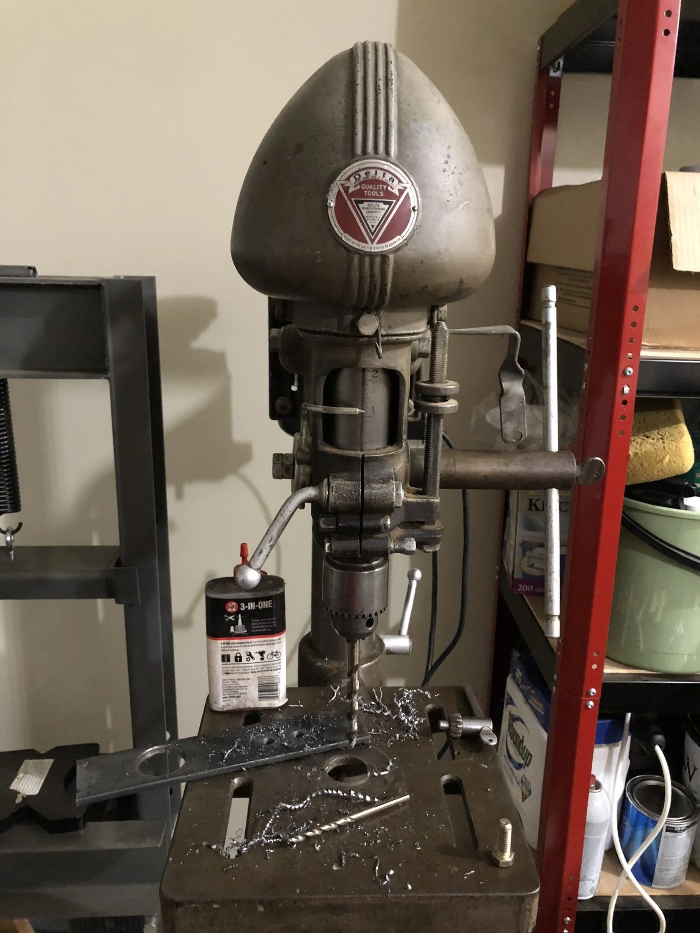

I’ve been putting it to use drilling some holes in a welding cart/table thing I’m building.
Not a lot of progress so far - free time is hard to come by these days!
The press works great, but I definitely need to address the run-out and get a larger pulley setup to bring the RPMs down. 3/8” holes and bigger get a bit dicey.

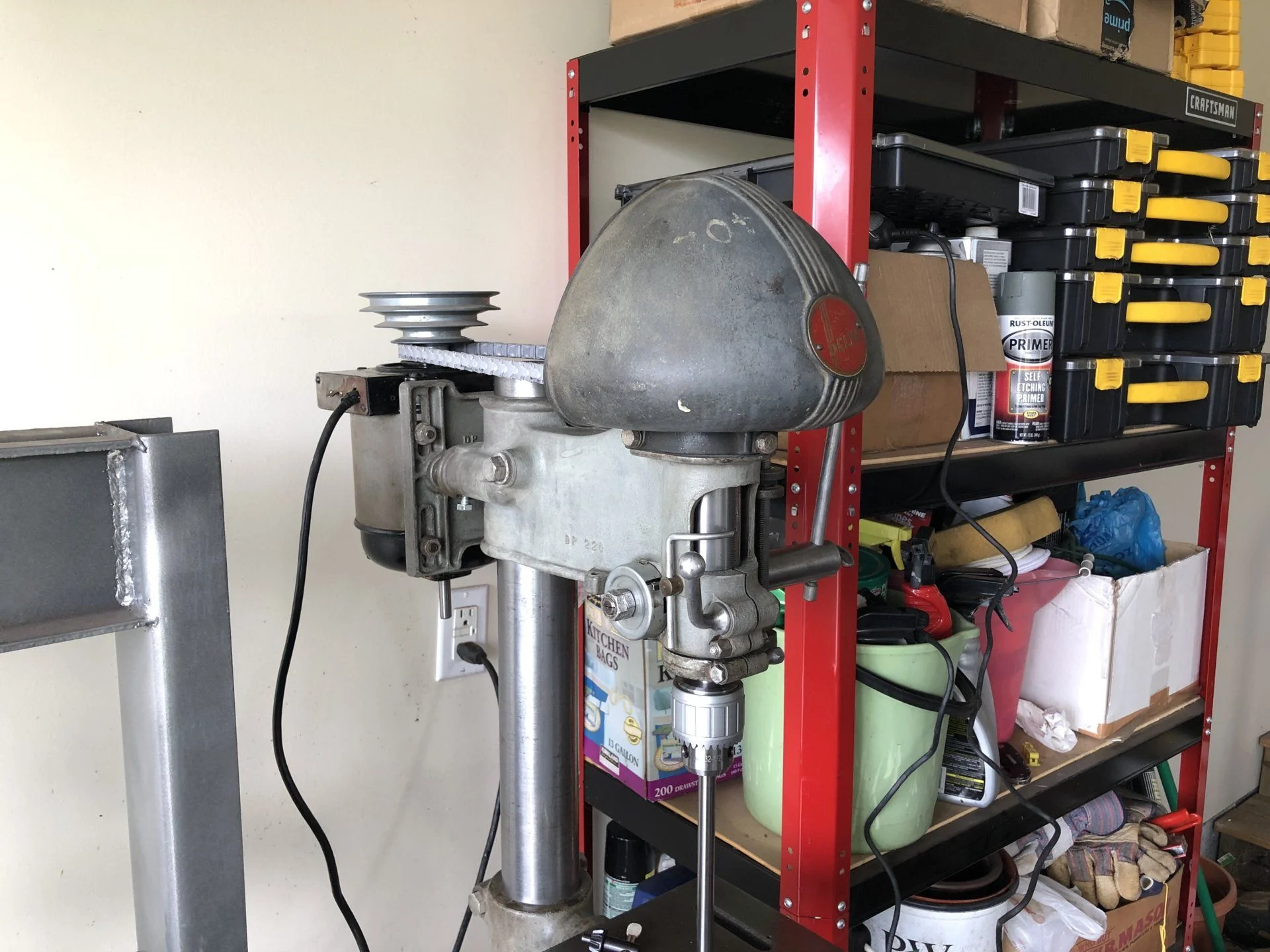

I have a few small projects I may tackle this winter on the truck, but for now I’m focusing my efforts on the drill press -
I found a low speed pulley and pulley cover assembly from a 1941ish era version of the press. The will get the RPM’s down to around 500 - much more reasonable for metal work.
I’ve also cleaned all the brown gunk off, replaced the worn out chuck, and installed all new bearings. I’ve got it running at about .003 run out now. Plenty good enough for what I do!
