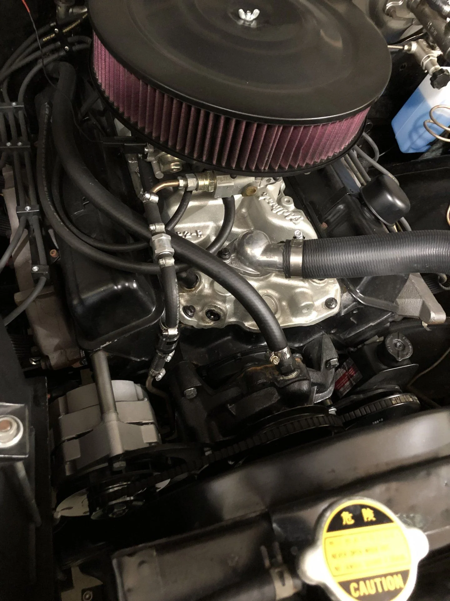

(Third) GM 12si alternator in three years installed tonight. The first two were both remanufactured. I got about 500 miles from the first one and about 800 from the second. The second one was still charging, but had devolved a gnarly groan and would get absolutely scalding hot after running for about 3 minutes.
This time I went with a NAPA “100% new” alternator. A bit annoyed that all the threads were metric, instead of SAE but otherwise it’s installed and seems to be running alright.
Also took the opportunity to try out a Krikit gauge to set belt tension (previously the alternator belt would squeal ONLY when the alternator was loaded up (ie: headlights on).
Dayco recommends ~120lbs of “re-tension” on a used belt - it took a lot of work to get it to about 110ish and even that made me nervous - it’s a LOT more tension than I’d have expected - but, specs is specs. No belt squeal under load so far...perhaps the “calibrated thumb” method of testing belt tension previously wasn’t so calibrated...
