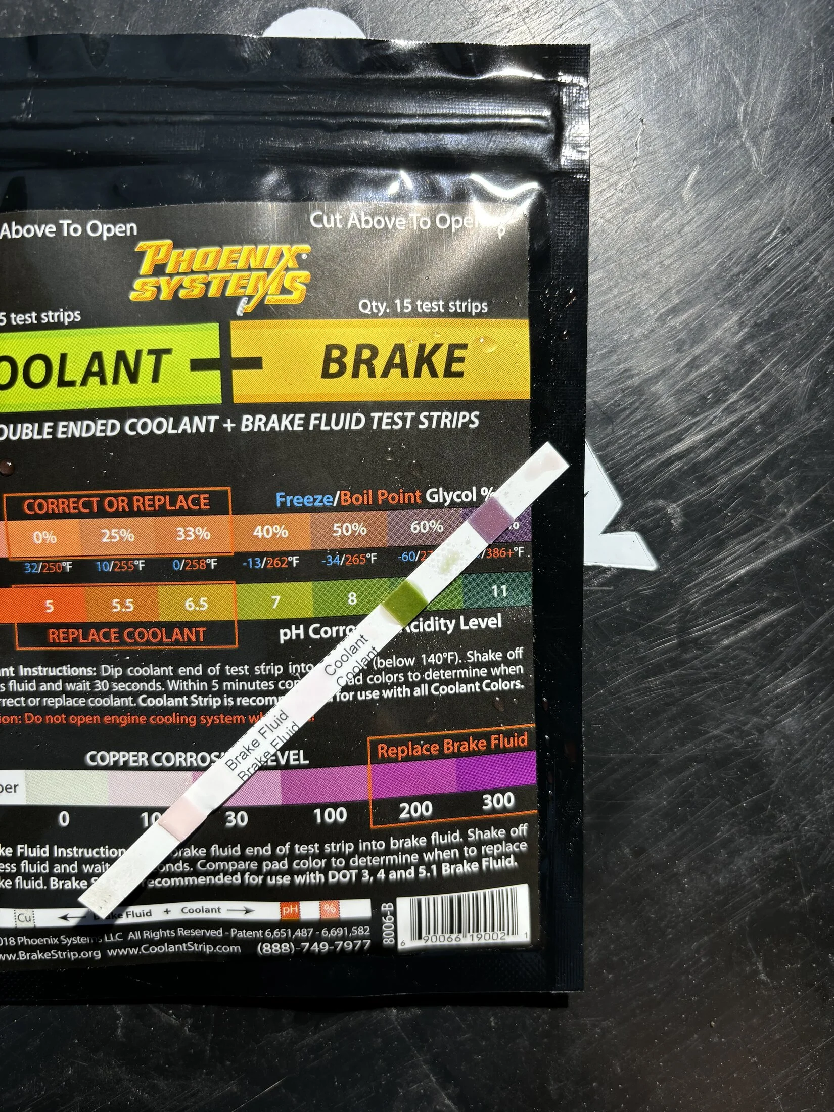

Are we still doing this here?
2017 100,000 miles, original radiator and likely original coolant:
