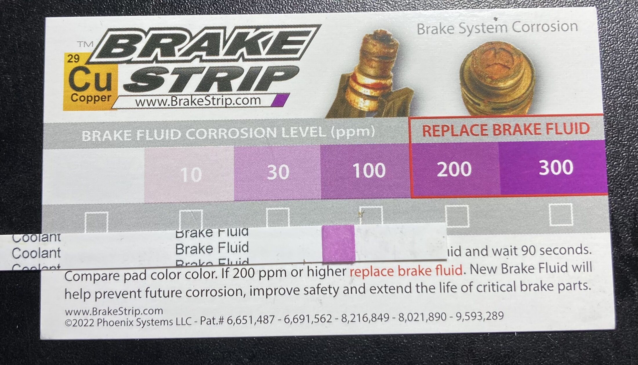

Some more data, just for the FWIW department...
Changed my coolant when I did the radiator at ~115K miles. Bought the fancy Coolant Test strips on Amazon, just to check the old stuff, which AFAIK is the original factory coolant.
Old coolant is on the left. Looks like Glycol content is about 70%, pH ~8.5. Brake fluid (also factory original) is at about 10 on the scale. Tested with a battery tester and it read "acceptable".
New coolant on the right (new OEM SLLC). Glycol ~60%, pH ~8.5. Brake fluid (new DOT 3) is about 5 on the scale, only slightly better. Also tested as "acceptable" on the tester.
I mean... I feel better knowing all the fluids are nice and fresh now, but it sure looks to me like it was a waste, assuming these strips are accurate.
Has anyone had one of these strips test “bad” with coolant?
@gasman4u. Based on the sds showing an ph of 7.4 of the Sllc.
I would think a ph that was “high” would necessitate a coolant flush. I don’t think we have had a test that was low (acidic).
