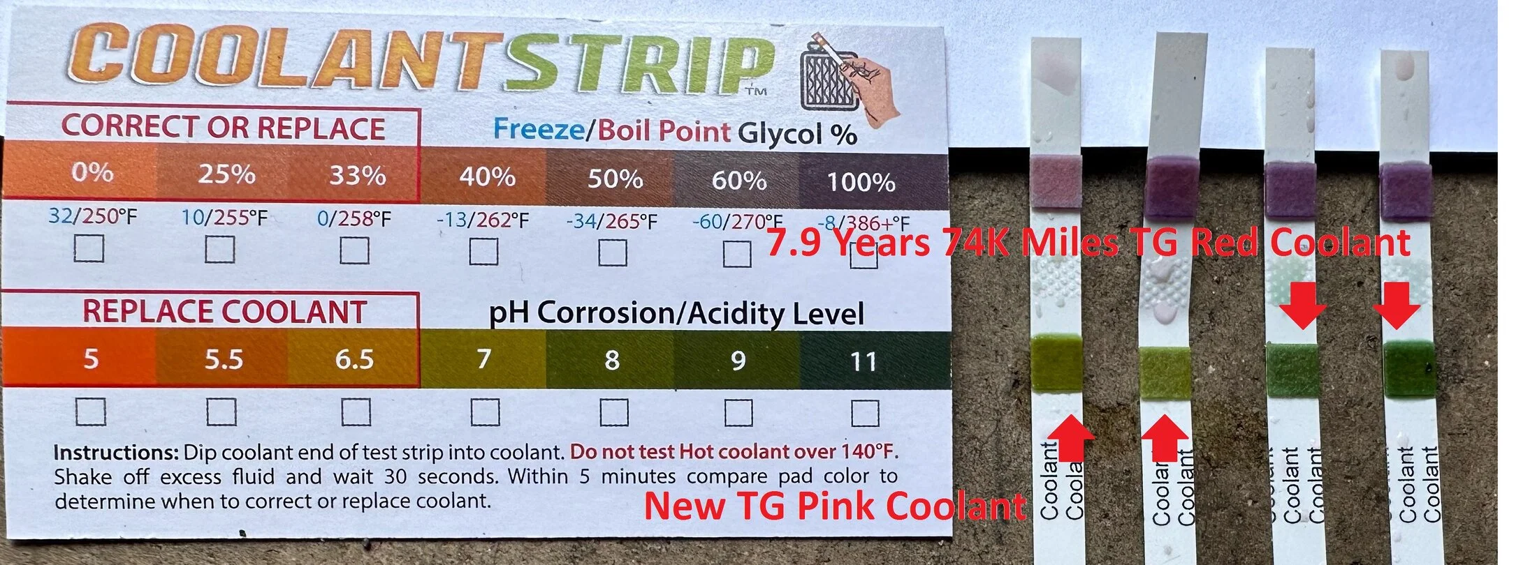

Guys, I jumped on the “band wagon” and did, my coolant today.
Here is a test strip picture. What seems to be added for me is that new coolant out of the bottle was close to natural pH and the one drained was closer to Alkaline first and last strips are control and didn’t dry yet, after they dried the looked like the ones in the middle. Tested two different bottles and in the middle of coolant drain and in the end. LX570 manufactured on 11/2016 currently at 74K Miles all the time in Florida (hot and humid).
