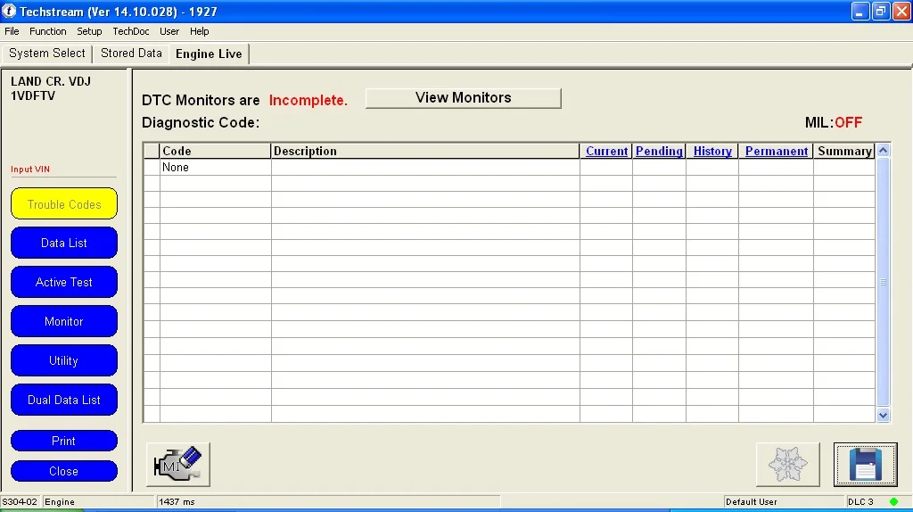

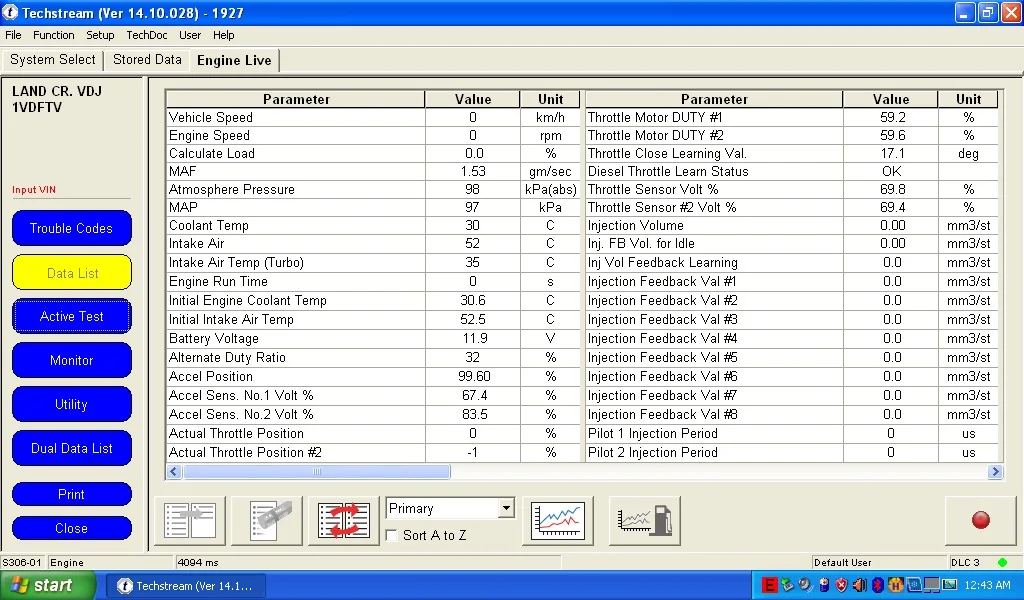

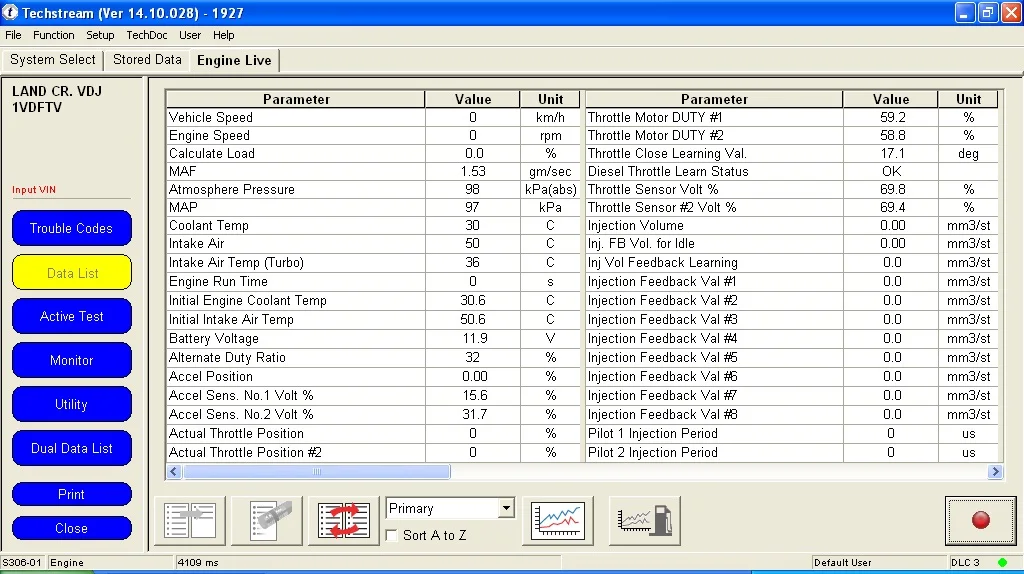

The engine suddenly stopped on the road. Does not run anymore.
It seems it is not mechanically stucked as trying to start it starter rotates it.
Please, I have a few questions in advance as I am not close to the car at this
moment.

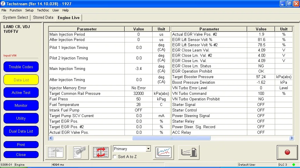

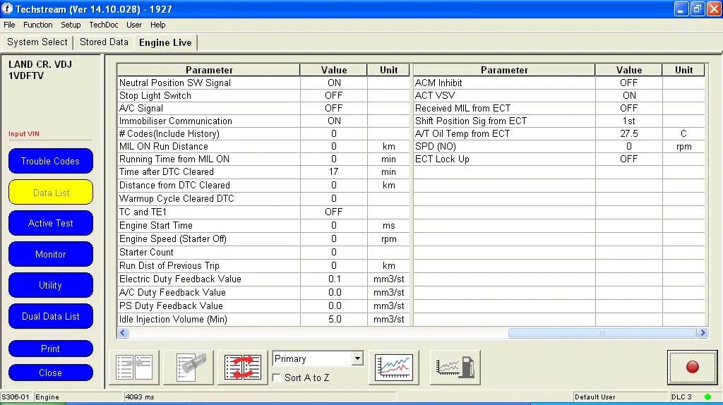

Attached are some diagnostic screens from LiveData. It seems like everything works
and measures correct values. Pressing gas pedal makes correct response, compare p6 and p3 pictures
Here are my questions:
- when I try to start it, would EngineSpeed show some rpm even if it is not running on its
own? should this "diagnose" sensor of crank shaft is working?
- should I see also InjectionFeedbackVal some mm3/st as control unit would try to inject the fuel?
or somewhere else to see it?
- there are unfortunately no DTC, the car was at the "expert" that might delete everything
- would damaged oil pump (as every "expert" predicts from mileage) prevent engine from running?
is somewhere in diagnostic possible to see what oil sensor senses? If there is oil pressure?
Any advice from you would be welcome and appretiated!!
